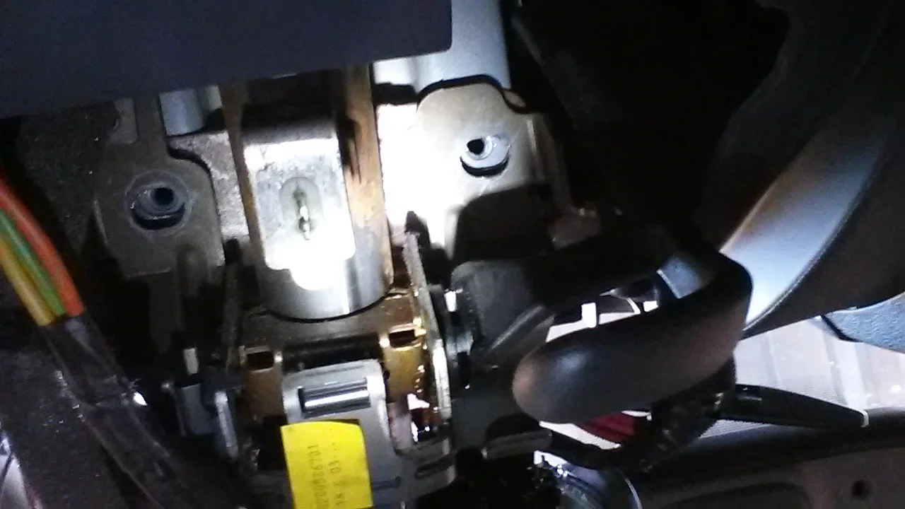

Hi @alistairolsen ,
Had a quick look at this the other day and from what I could see, the column is mounted by two vertical bolts - the ones you mentioned and two horizontal bolts (one captive as per the picture). Is this the same as yours? My car is a 172 cup. From the horizontal bolts, there's limited adjustment, I reckon 10mm might be achievable but I see you've managed to fit 20mm spacers. I could elongate the slots for the horizontal bolts but this would only give an extra 1-2mm. I'd rather not do away with the horizontal mounts.
Have I got this totally arse about face?

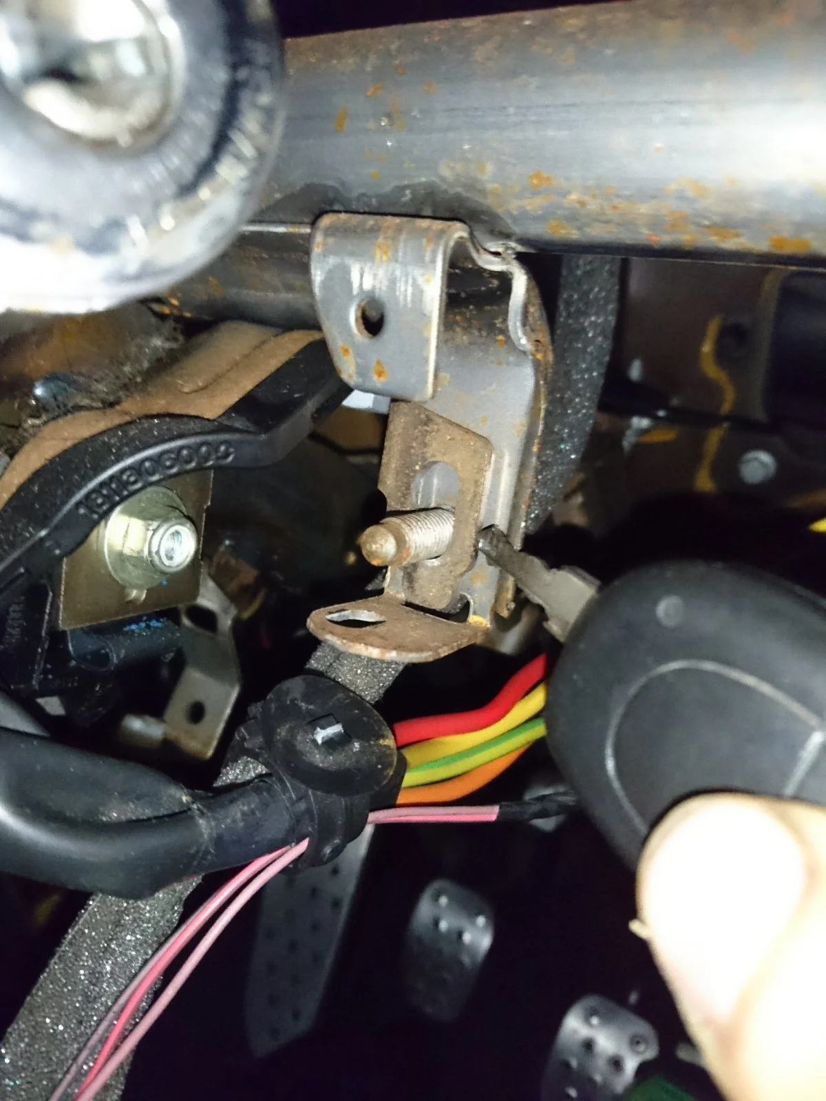

  Megane R26
Revival.

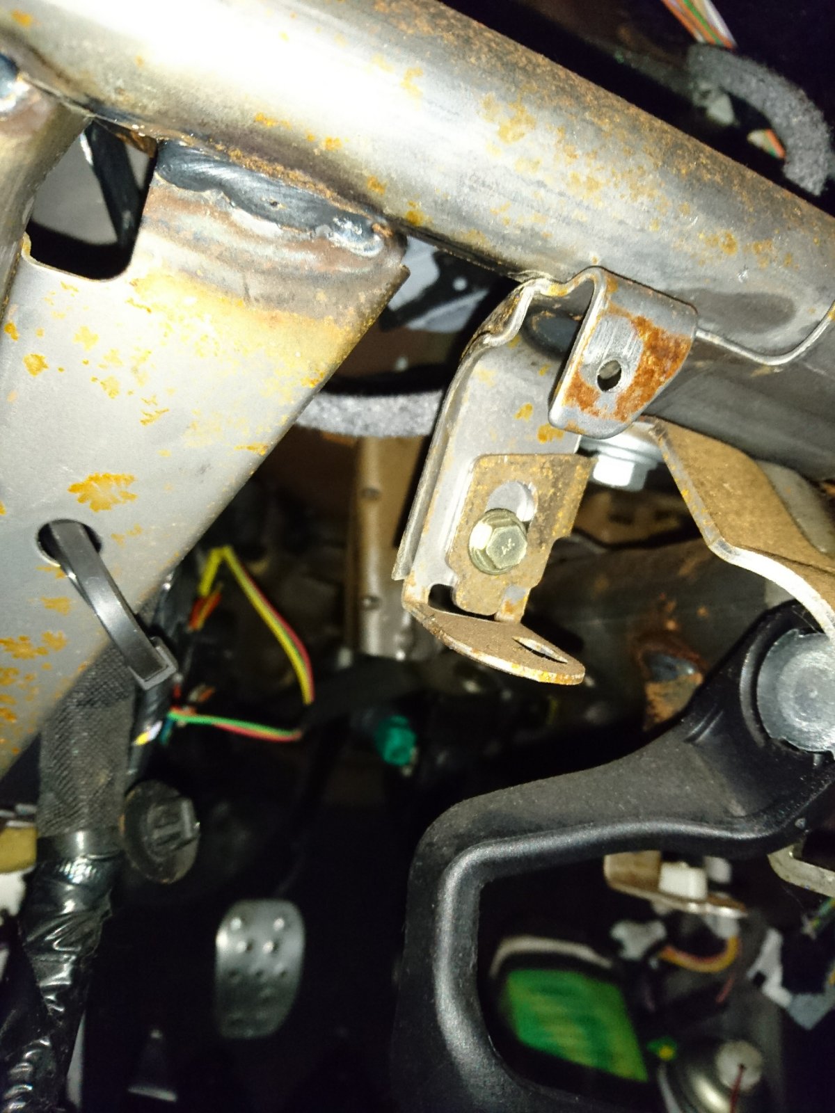

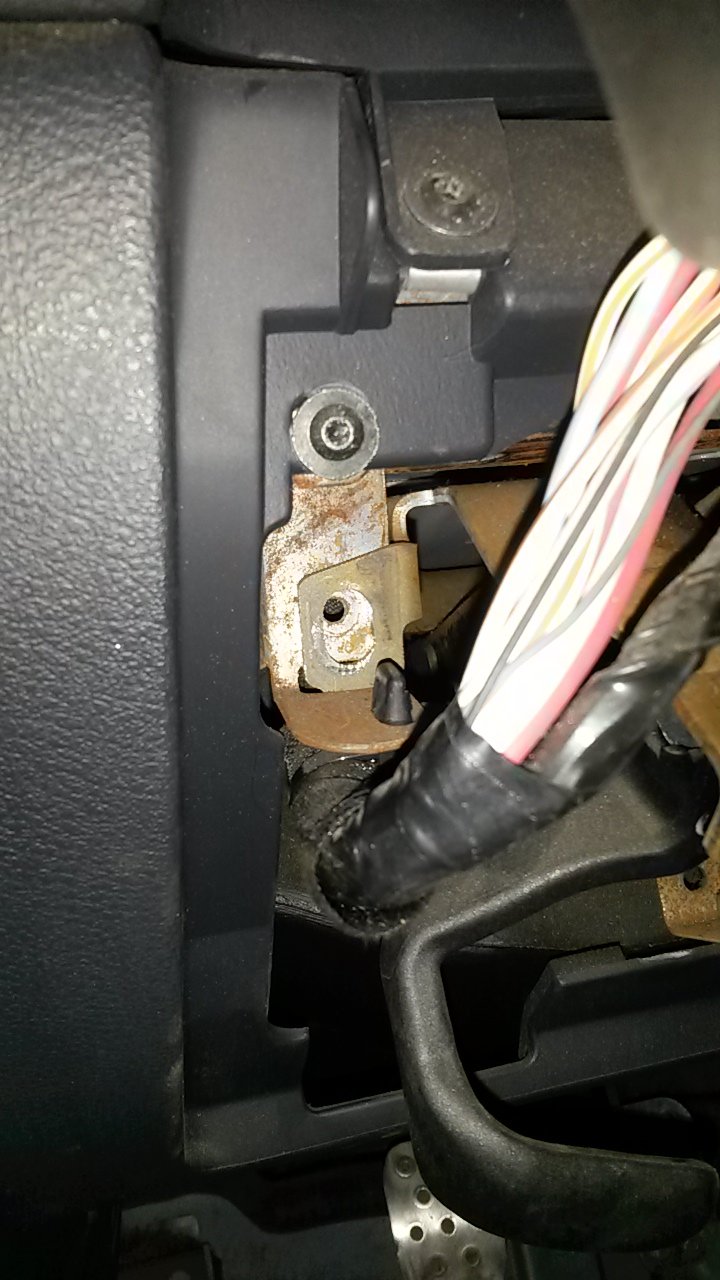

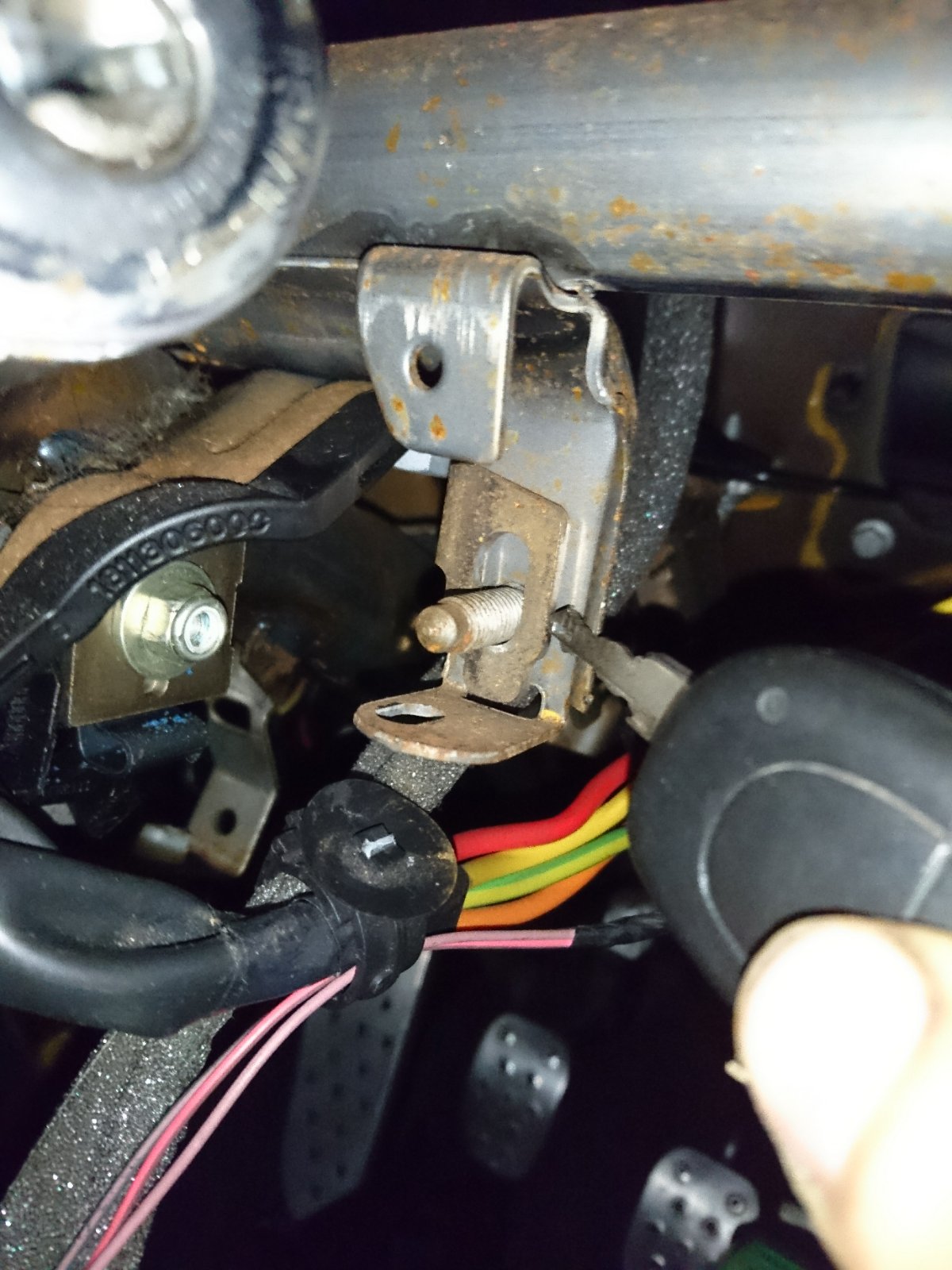

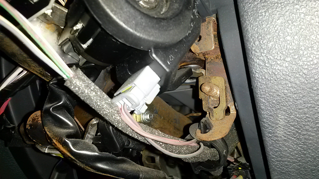

Had a go at this earlier but got stuck.
The 2 front and 2 rear bolts are located and accessible but can't move it down more than 1 cm or so. It's caught on the front, see pics, left & right side.
Can someone please advise what part to bent so I can have more adjustment please?
I had the same, pretty sure I levered it out far enough to get it over the end of the stud. JUst check what its catching on little by little until you get it down far enough.
