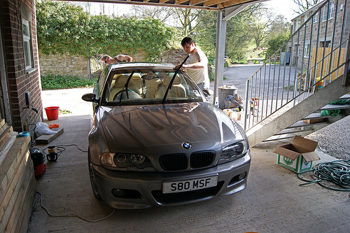

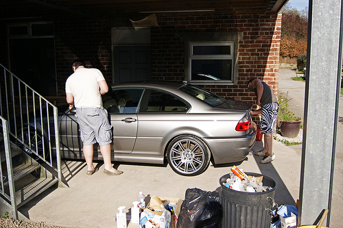

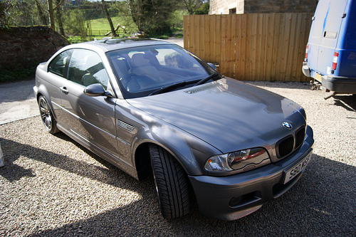

Upon arrival:

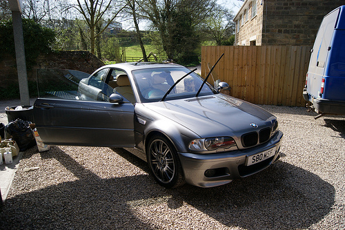

Very clean to begin with, having only been washed the day before.
Today was more about the polishing, and trying to get a decent finish to the paintwork.
Having covered something daft like 130,000 miles, certain areas were worse than others.
So out with all my stuff!
Washed with the 2 bucket method and BTBM, although only one bucket can be seen...

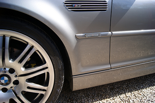

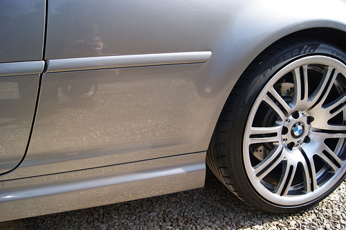

Sills cleaned:
Clean car again

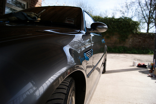

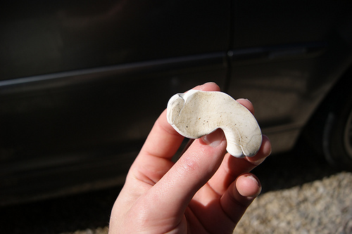

...and now moving onto the clay. I used a megs clay bar, as I prefer it to everything else I've tried. Can't get on with the softer clay bars, as they just fall apart in your hands.
Now, to Jons (owner) knowledge, the car had never been clayed, and he was fairly sure we would find a lot of overspray around the wheels. Since the dealer he bought it from sprayed the wheels while on the car :rolleyes:
Going on this though, the car was incredibly clean. Clay wasn't picking anything up off the roof or sides of the car, worst affected area was along the lower half of the doors, behind the front and infront of the rear wheels.
My roof alone gets dirtier than that!
Claying done. Mr Gray visible in the background, he's dweamy tbh.
Worst affected areas cleaned up nicely!

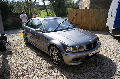

Washed again after claying, using the same process as before:
This time I remembered the fuel filler cap.

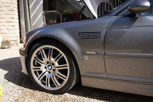

Wheels cleaned with AG products and assortments of brushes. My long reach wheel brush actually struggled to reach the inside edge of the rear wheels! :eek:

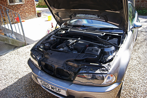

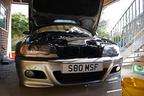

Engine bay was cleaned down with AG engine cleaner and plastics dressed with AG bumper care.
After pictures are a little sparse with the engine bay, since it was late by the time we finished everything.

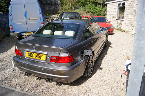

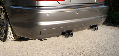

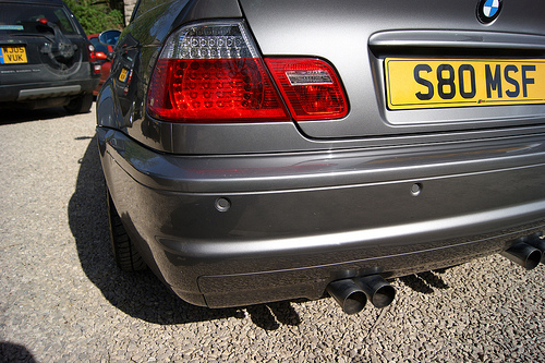

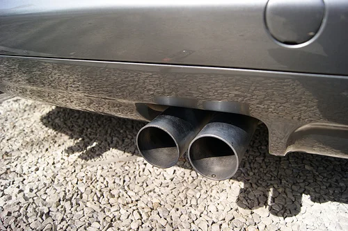

Lovely dull tail pipes:
Again, after pictures weren't taken until end of the day

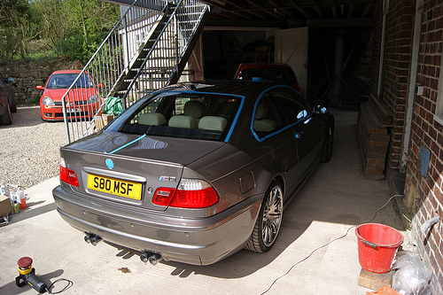

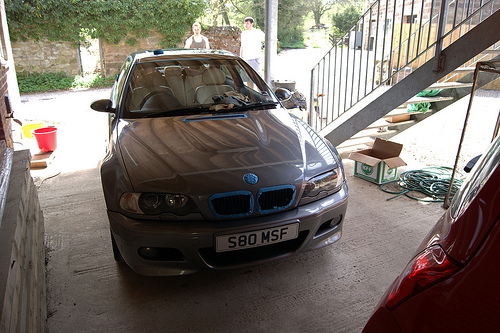

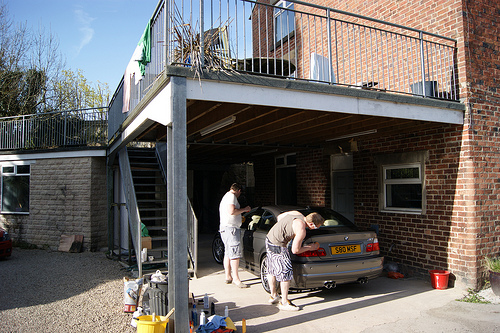

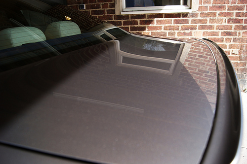

Car brought under shelter for polishing: (normally this is to keep it out of any potential rain, but today it was to keep it out of the heat!!)
Now recently, I've seen a lot of good results using lime prime, so thought I'd give it a try. Ordered in a new megs cutting pad as well, to try and combat the German paint.

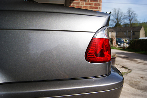

Boot lid finished up:

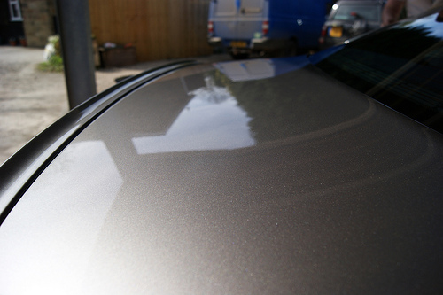

Very pleased with the result.

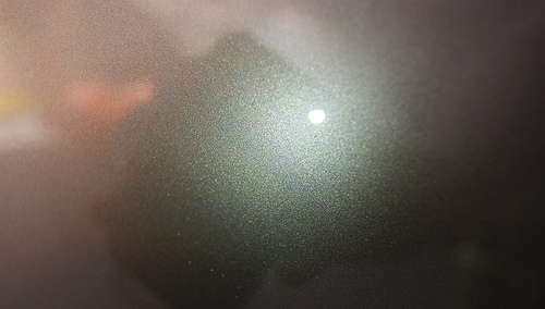

There were very few swirls to begin with actually, but now even less!
Rear quarter done:
Sun gun? There's an App for that.

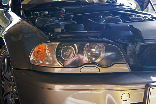

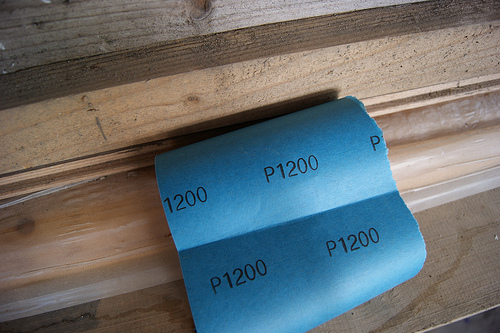

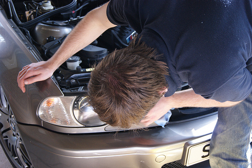

Now. The headlights. They had done many many miles, and they showed that they had done many many miles. Very dull, and the plastic was generally "frosty".
So....
Hai :eek:
Still not quite polished back up nicely^

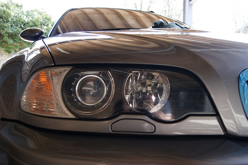

Finished vs not finished:
Polishing all done:

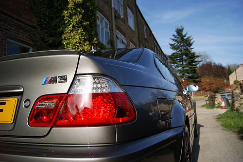

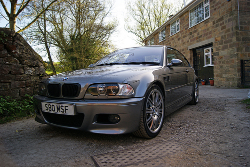

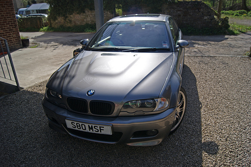

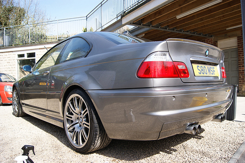

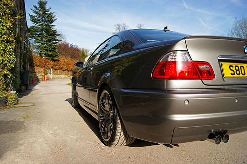

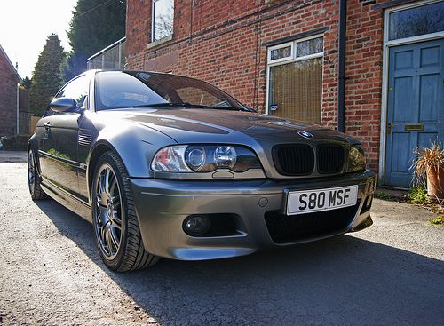

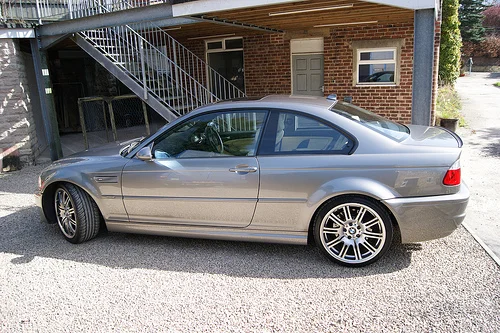

Finished shots:
Depth much?
8 Hours, job done.

Superb Dave, what bloody country do you live in! Shades and vests! Oh and who actually wears a vest! :eek:

LOL weather last weekend was stupidly good! Ended that evening with a barbecue and a beer.

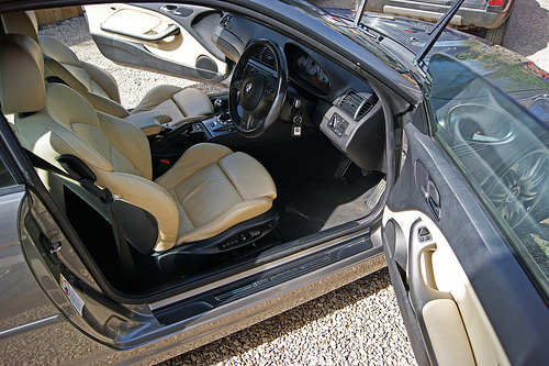

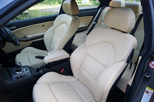

Nice write up, I love everything about that car (but I wouldn't want cream seats).
Headlights were the biggest improvement IMO.

1200 is far too coarse for headllights fella. Far far far too coarse. Look at 2000 as an absolute max. You're not sanding down sharp edges, just bringing back the clarity. It will aid you in the long run as well as you will be able to polish them back up with one hit of a decent cutting compound, rather than a few.
All aimed to help rather than take away from what is truly a superb finish!
Oh, and gang colours? FLOL.
Cheers! The seats were quite a rare option iirc

FLOL... after 3 passes the realisation showed on Dave's face 'It's not polishing up... oh s**t, oh s**t'
Thanks for sharing!
Nice spot tbh, and yes, it did take a f*cking age to get them back again!
Last time I did mine I had 1500 and 2000 grit paper, which will explain why I was scratching my head when the M3 headlights weren't shining up as quickly!
Still, no damage done, just a lesson in time management. No where near as bad as the lad who tried 600 grit first as well!

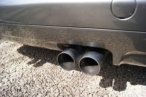

Any close up shots of the exhausts? That's the only thing I really struggle with on mine! I tend to use autosol and an abrasive cloth, works ok but open to other suggestions.
Oh, and the facelift M3 was 53 plate, correct!

JD, you're such a wet and dry hater! (It's probably because you're polish lover)
This is something we really disagree on tbh!
1200 would be utterly fine to polish up if it was nice and wet, like soaking, as for 600 on ph1 headlights, that's standard.
Low grits aren't anything to be scared of as long as you work up through the numbers, some headlights are at a point where it'd take hours with 1200 to get them good (I know these ones weren't but I'm just feeling argumentative).
Not got many good ones, but I know what you mean about the exhausts, they're a really dull finish anyway, made worse by dirt and grime.
That was after autosol, a bit of cloth and a lot of effort. After I finished I buffed them off with a MF and they came up nicely.

the top of my headlights are quite dull, feel quite rough. is there an everyman way of fixing this, ie without an electric polisher?
  S4 Avant
looking clean :cool:
You aren't ever going to get perfect results by hand, but you could try a very light grade sandpaper, like 2000+ and then SRP.
It will take you a while to get them glossy again though if you're only doing it by hand
Haha, you numpty. x
I love wet and dry paper. Love it.
Hate the misuse of it. 600 then polish? Fark off. 1200 then polish? You'll be there for days and might incurr damage that is irreparable (no offense Dave).
The simple fact is, paint correction and plastic correction is an art. And the art of it is to remove as little of the top coat as possible. It is the same for plastics. You use the least aggressive method possible first and up it if required.
I wouldn't polish a Clio with a wool pad and Fast Cut Plus because I had them to hand. I'd work out which was the best cut based on time, results and paint condition.
Same with plastics. I'm bringing back the clarity, not sanding down a few milimetres to gain a smooth surface.
But meh, you're a Southern C Unit and I'll tell you in person when you buy me that "welcome to the Sarf" pint you mentioned... ;) x
