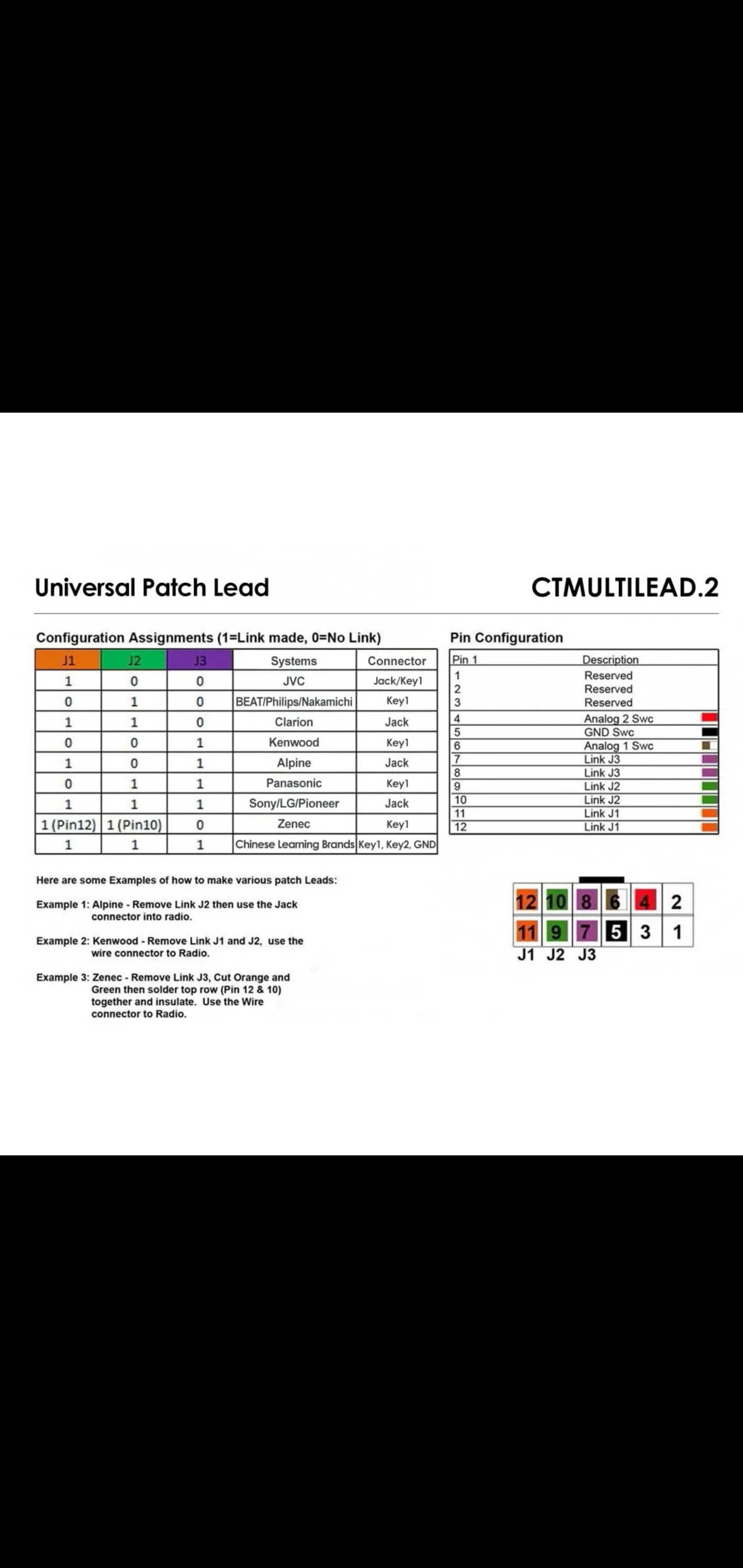

I'm French so I'm having a hard time making myself clear here but basically there was a piece of wiring loom that plugged from the car to the interface, then back to the stereo. Then, each stereo has its own specific plug. Mine was only a plug that looked like a 3.5 jack and the loom included with the interface. The instructions mentioned many different makes of stereos and their specific plugs. I went from a pioneer to an Alpine and had to cut a wire for the Alpine, then I bought an android touchscreen and had to solder the cable I'd cut back and there where two male plug in wires labeled Key1 and Key2 that went to female plugs with the same label. I'll try to link the instructions
