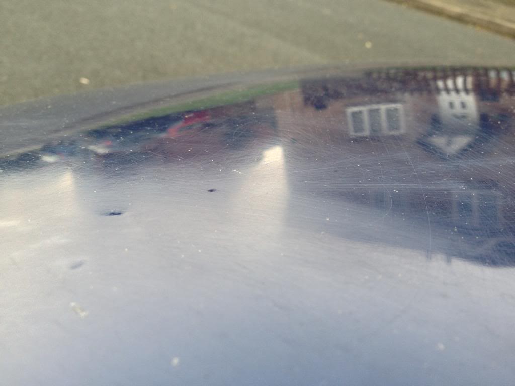

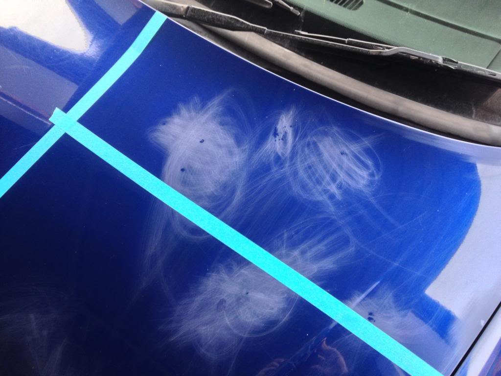

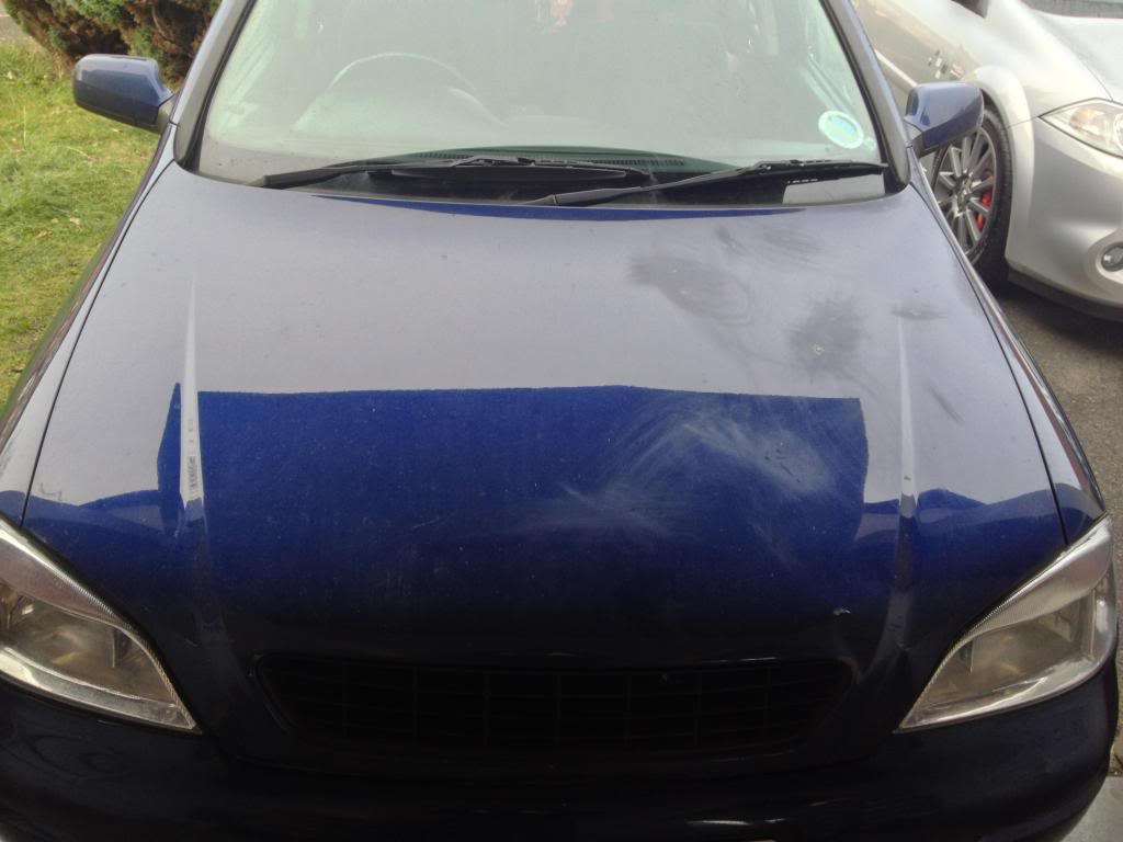

a friend of mine though it was a good idea to use a scouring pad to get rid of some baked on bug splatz last summer. which it was, but it also removed paint lol.
he finally brought it round for me to tackle today.
omg, i didnt realise it was this bad!

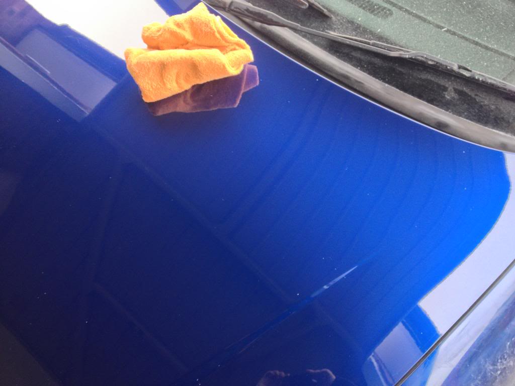

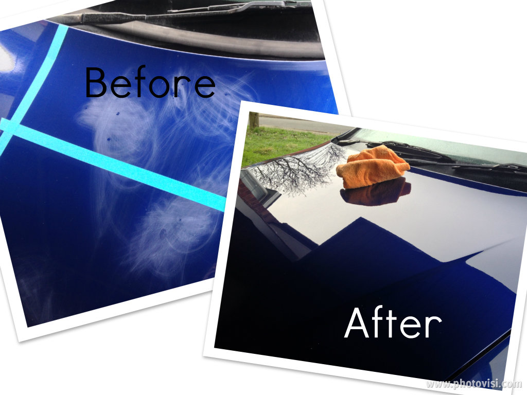

after a wash and clay i taped up some sections, it soon became clear i would need a wool pad and fastcut+ on a rotary, finishing combo didn't do anything apart from make the defects shinier lol
ouch :(

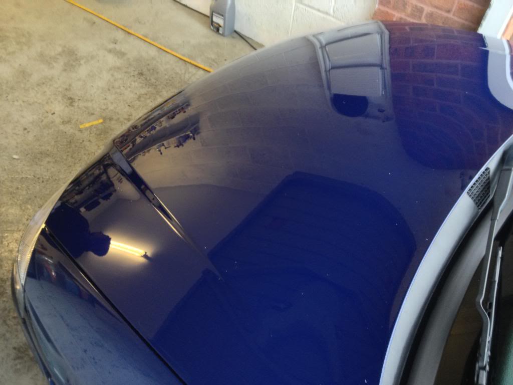

after two sets per section with a wool pad and FC+, then ultrafina on a blue pad....carpro eraser used between each set to make sure no filling was occuring
i managed to sort it! i reckon 95% have been removed, i don't have a sun gun so had to rely on garage and natural overcast light. but i am really proud of myself!

At first glance Look more like flatting marks to me....
I'd say that's been sprayed before in my oppinion & had either some nibs in the paint or possible silicones

no mate sorry, the situation is genuine. he really did use a scouring pad to get rid of bug splatz

They certainly weren't swirl marks, scratches definitely. There will still be indentations in the lacquer under close inspection but that's a superb job mate, guy must have been very very pleased!
