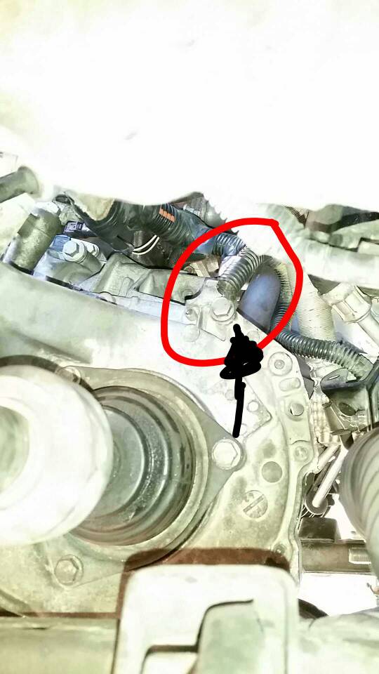

So my gearbox earth is connected to here?! (pretty tight too - not sure if using correct bolt)

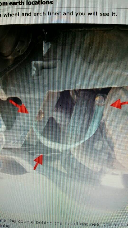

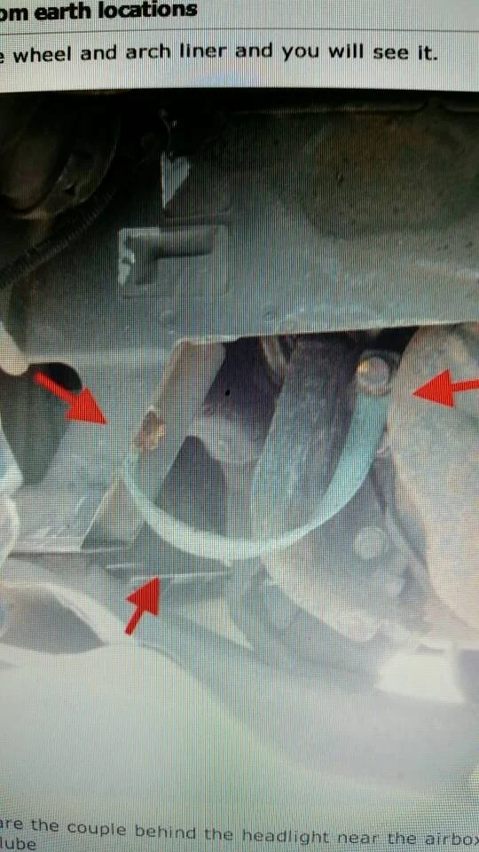

Not sure about that bit but the earth strap is the other side and attaches at the same place as the lower front gearbox mount on the subframe. It's a strap not a cable.

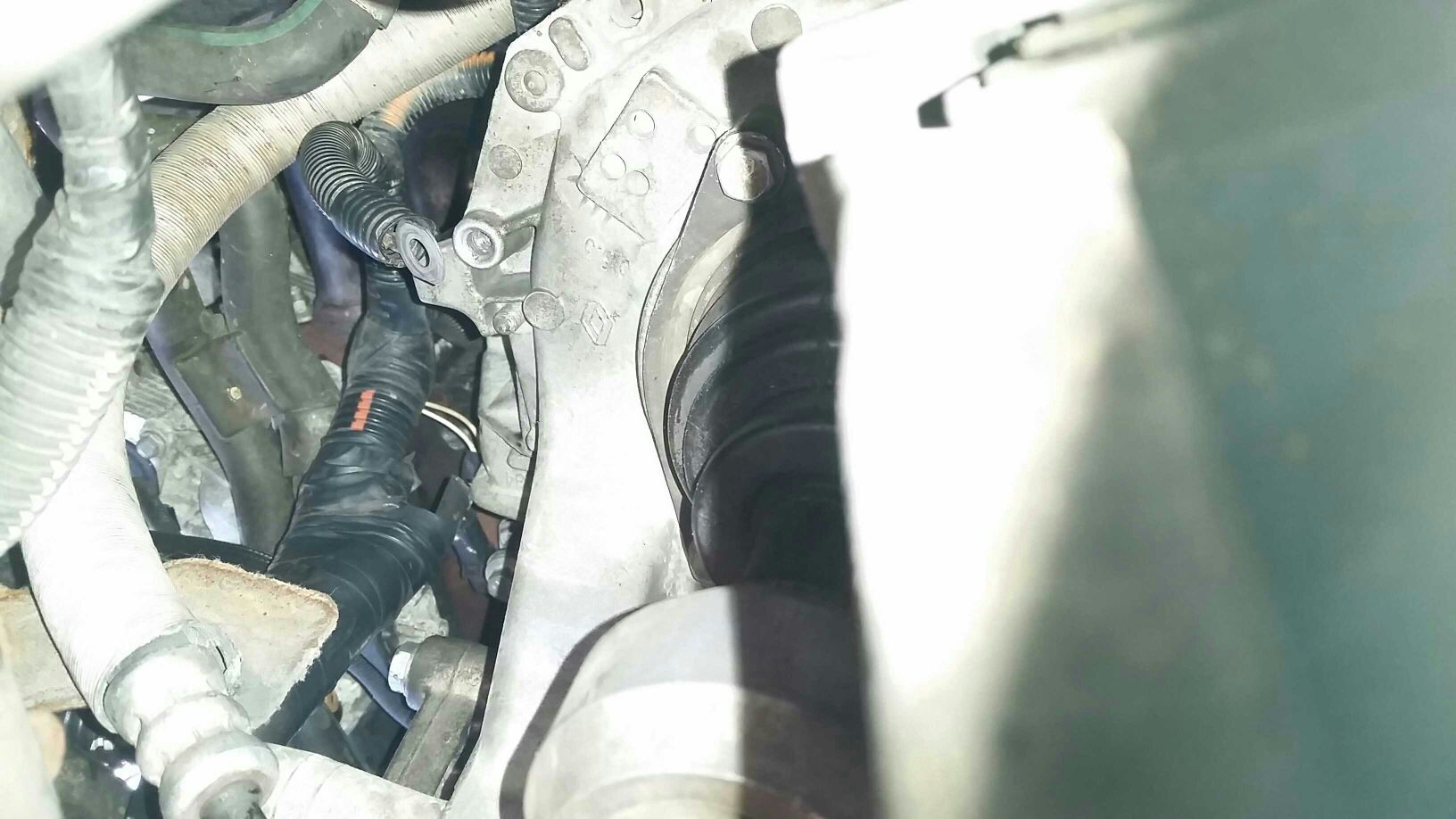

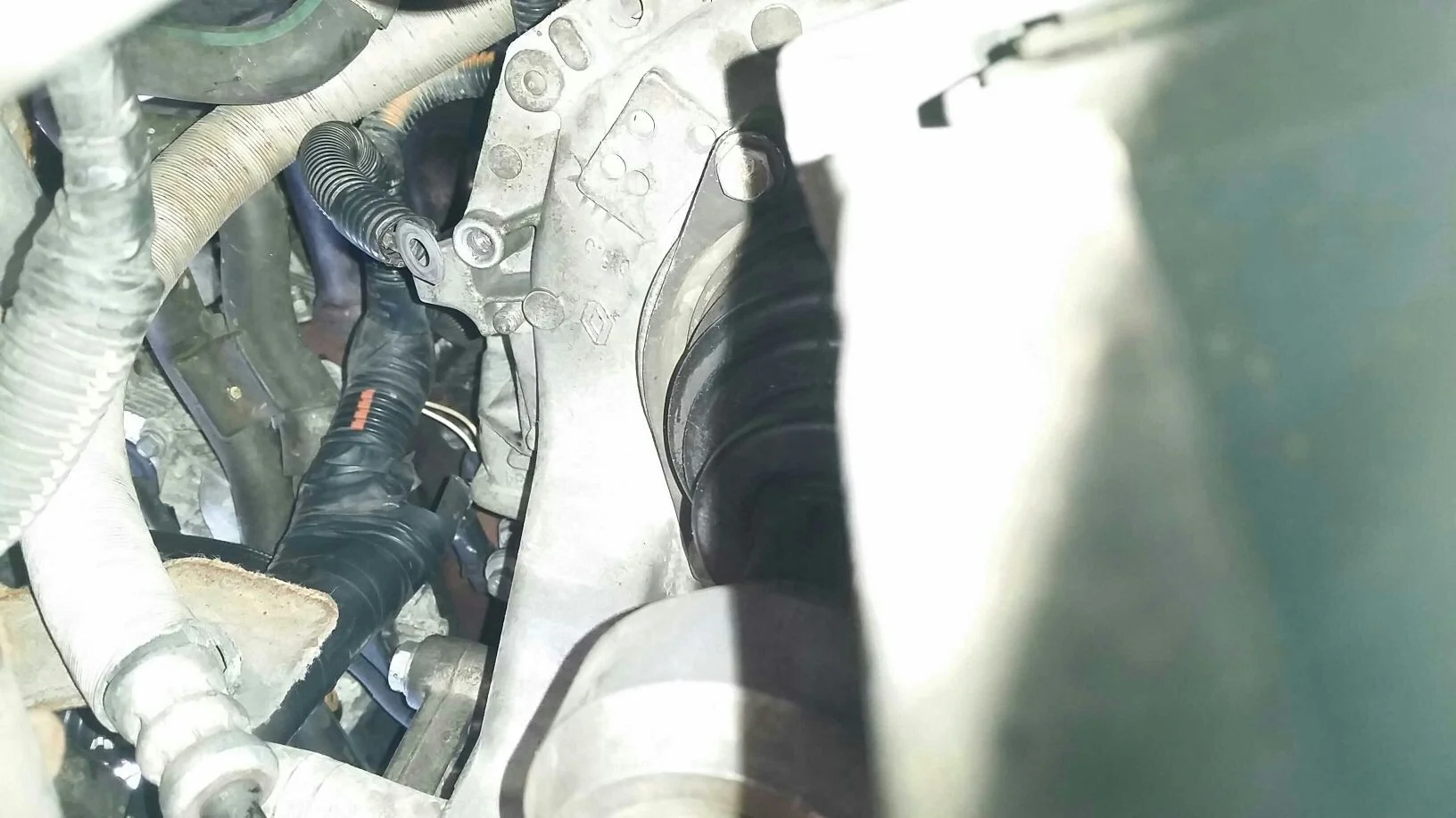

So yep got this bit connected
http://tapatalk.imageshack.com/v2/14/08/22/5ae7073667c02855d4fe2e3d2bf58387.jpg[/IMG
Was wondering if you have to use the nut that came off it, as the one that's on there at the moment is the same size, but yeah any benefits on contact etc...

There is another earth, it runs from the starter to the gearbox. I've just done a gearbox fit and had this problem as this wire had snapped. Back of the bell housing at the top.

Take it off. Clean the ends and put it back like the photo half way down the first page.
If you don't have the bolts just make sure they are tight

So I've cleaned the earth strap on n/s wheel arch, and the one above the n/s drive shaft! Still nothing...
