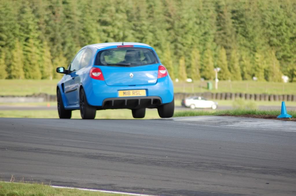

looks really nice that, love black on blue, am i right when i say in the second pics down both drivers side wheels are off the ground! crazy

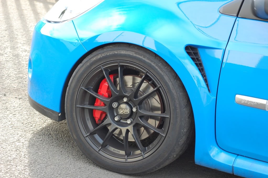

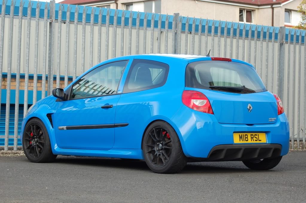

Done quite a bit to it,
AP Racing Bells & Rotors, braide lines and DS2500
OZ Ultraleggera wheels
AST Sportline II with solid adjustable top mounts ( both from Kam Racing who were great to deal with ;) )
PH2 V6 Airbox
Redtop 25 moved to underneath the Passangers seat
Matched Inlets.
R26.R fog light blanks

You running spacers Mark? Love 197's with spacers and lowered. :)
No the offset of the OZ wheels are ET55 instead of the standard ET68
With the Speedine's on the inside of the wheel scrubs the arch liner after one full turn of the wheel. When the tyres are finished on them I'm going to sell them and get different road wheels or use the OZ's as the road wheels and get a different set of track wheels.
