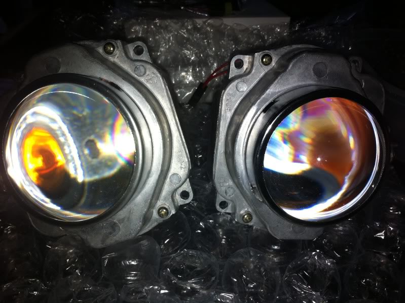

Few pics for now. I'll write it up if I get it finished.
Had to use a dremel to cut the lens as the lens started to melt before the glue. lol

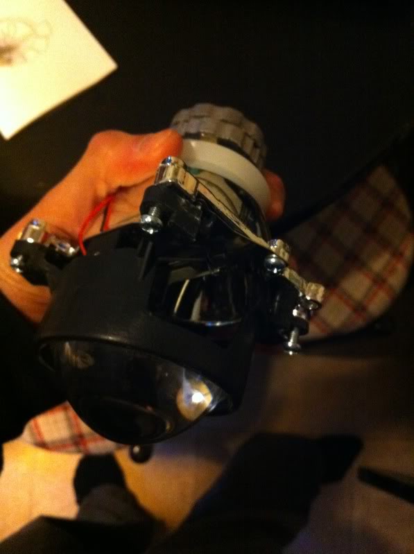

Was going to be fitted with these but they are too big so got some smaller projectors coming.

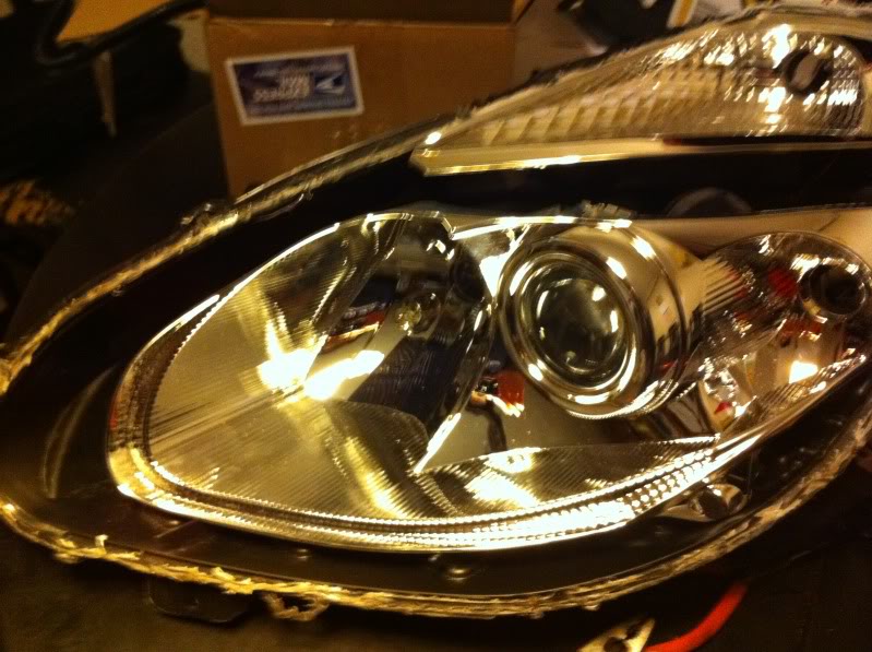

Yep. Dipped and main beam xenon with a shutter that moves up and down. Halogen high beam remains for flashing when lights are off.
I decided to use a projector headlight unit as I have dedicated conering lights. If I used the standard ones then the FXR should have fit no problem.

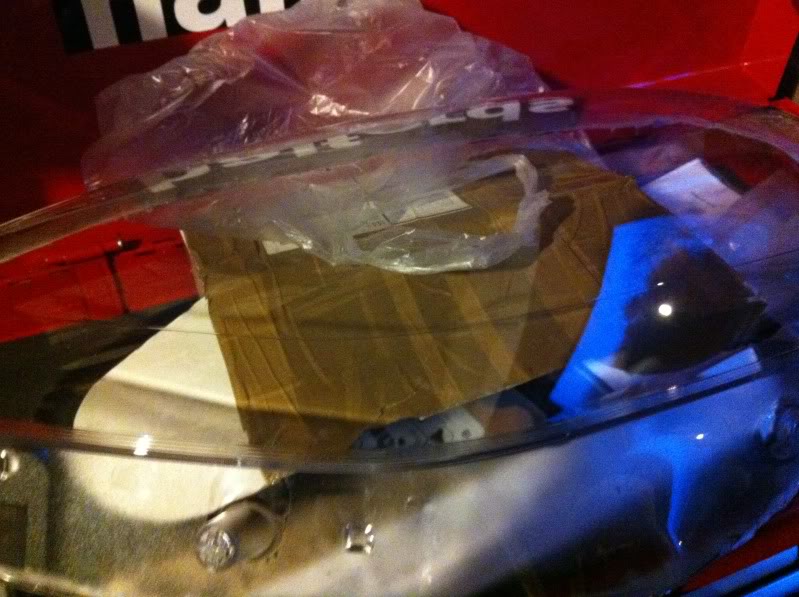

I'm trying to achieve the OEM look so you won't be able to tell any differently when the lights are off. The shield is also getting painted so the projector lens will look coloured when the lights are off.

The morimoto Mini DS2 projector. Just small enough to fit in the space.
