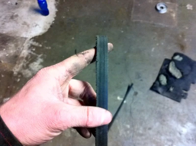

Auxiliry belt had worn down from 5 ribs to 3 and didnt look healthy at all.

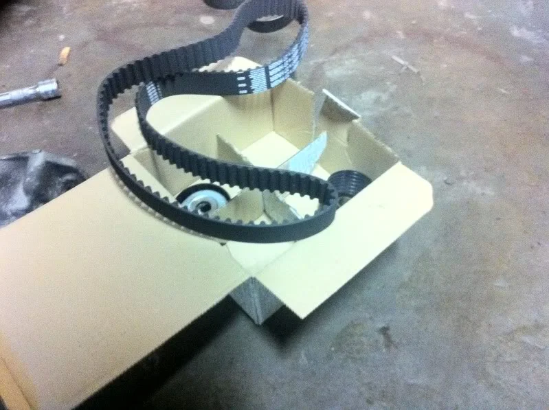

Got on the blower to my mate who's still working at Renault, he priced me up a genuine timing belt kit & genuine auxiliry belt kit, they were ordered immediatly.

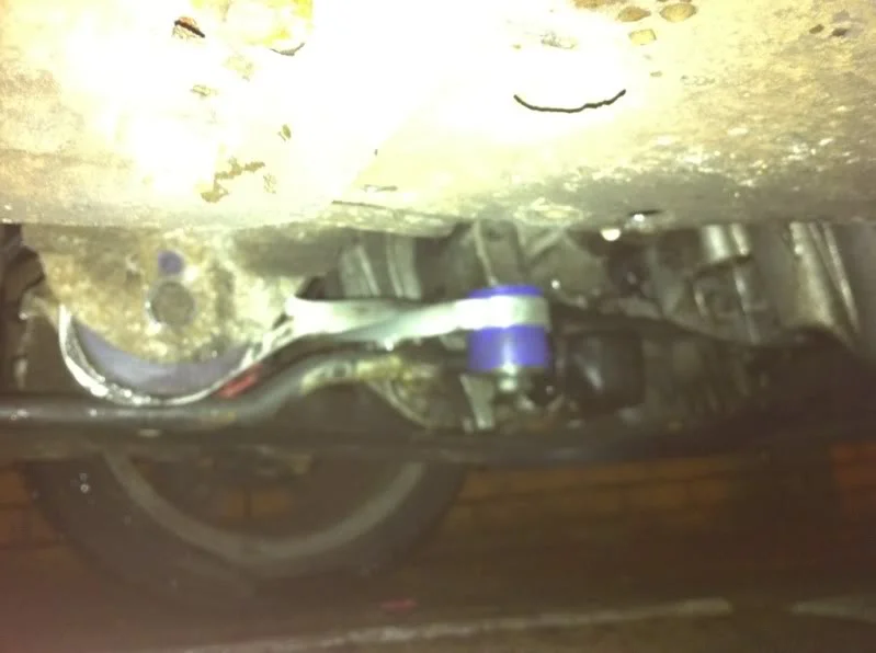

Ordered some Powerflew bushes for the lower dogbone mount.
So here it is how i bought it.
Wee parcel -
And fitted -

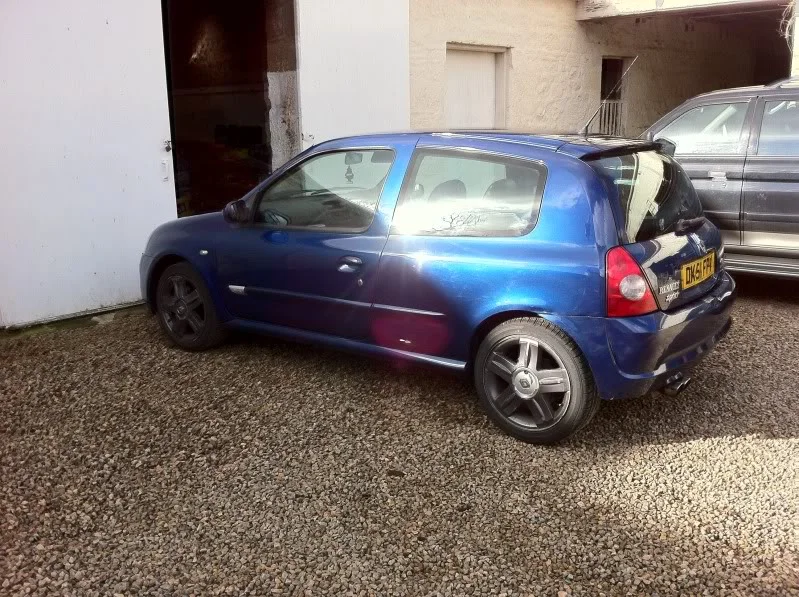

So Saturday past i went up to my mates farm where we get the use of his shed in exchange for mutual respect.
Arrived (The furthest i've driven the car, best 4 miles i've drove :lol:)

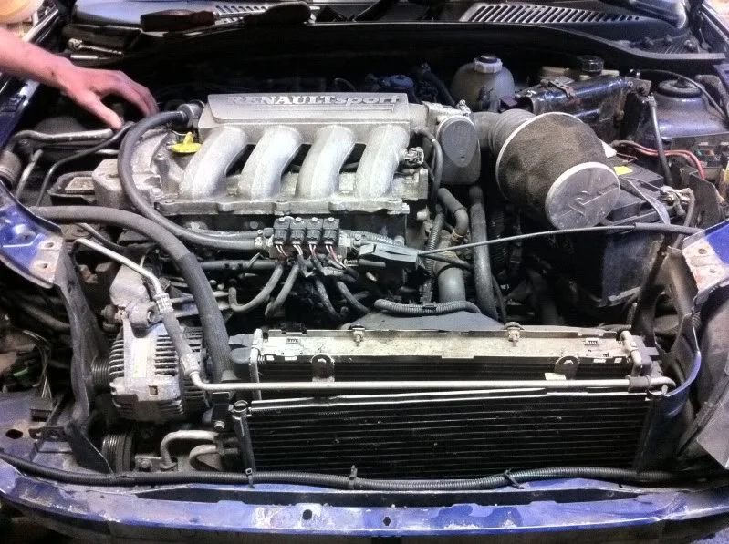

State of the auxiliry belt (Upon removal it became apparent the alternator was sitting like a bag of s**t)

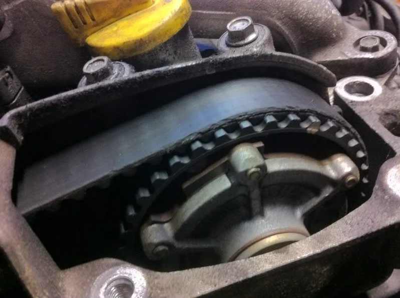

Timing belt had seen better days (And was also fitted the wrong way round, your meant to be able to read the writing from where i was standing, it was facing the engine)

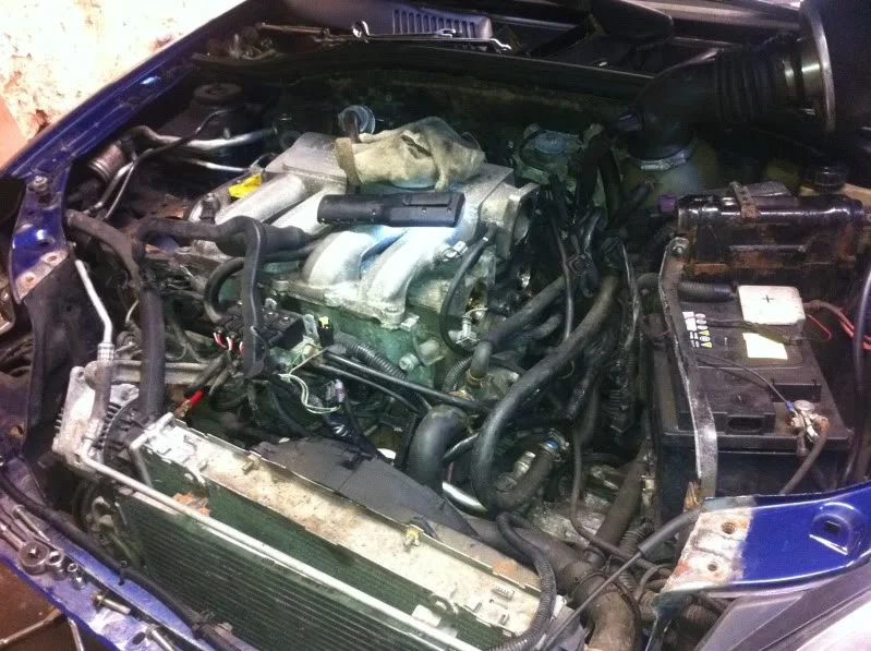

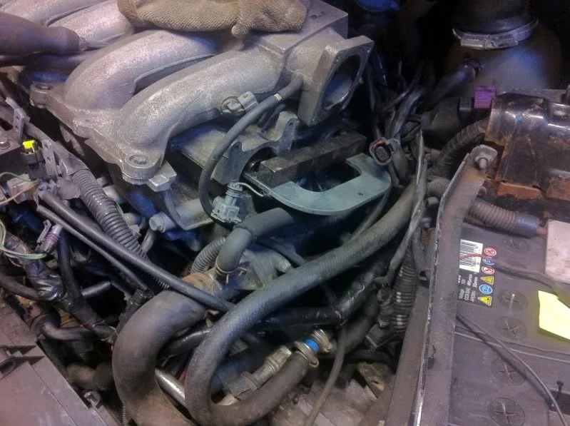

Cams locked up, crank pinned -
Various during shots.

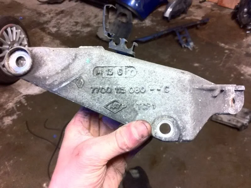

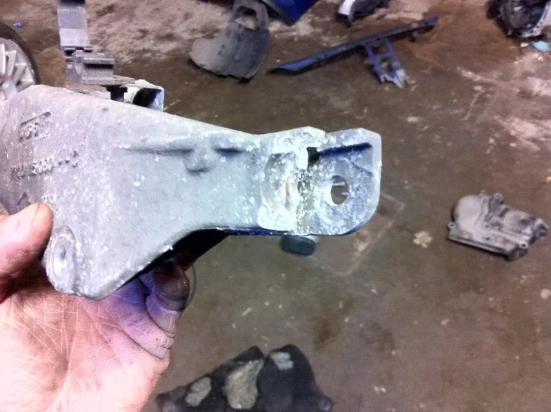

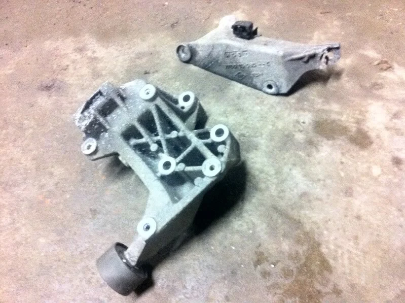

Timing belt is all done, i removed the alternator to investagate it's ill fitment.
Found that both of the mountings points were damaged and had been cowboy'd back together, which would explain the chewed belts.
So it's currently up in my mates shed in bits awaiting replacement mounts. :(
I dont know why someone would put it back together like this.
And the mount in the left of this picture is broken on the top left corner :mad:
Fear not, i would rather do the job right, and the car is not in the way where it is.

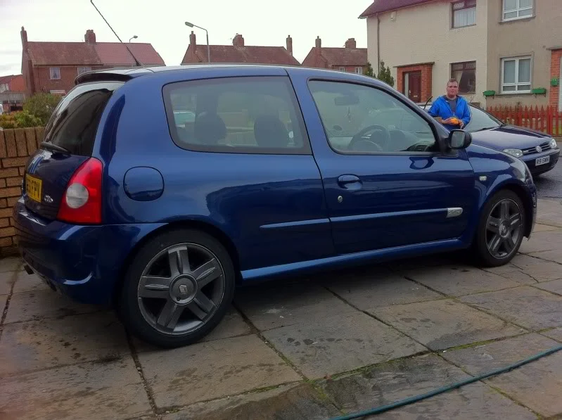

Budgie has some bits you might need up for sale if you get in quick chap ;)

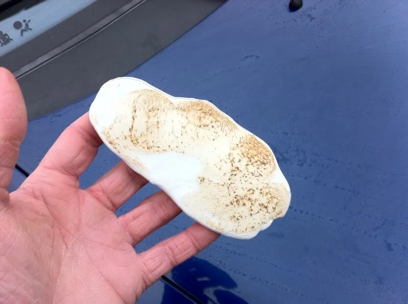

Just a little pointer about the claying - use about 1/2 of 1/3 of that .. if you drop it, it's game over but if it's only 1/3 of the bar you've no need to waste another one :)

Thanks for the comments.
Main reason for doing the belts was because i worked as a tech at Renault and at least once they are done thats them out the way and for the peace of mind, i got the parts at staff price too which helped.
I have a couple of claybar's i've gathered over time, already lost one through dropping in a puddle lol.

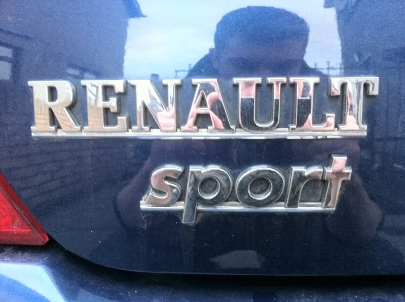

Took the Renault & Sport badges off, just screamed Halfords badge at me :lol:

That dogbone is fitted upside down and you're supposed to remove all of the old subframe end bush before fitting the new one.
Can tell you used to work at renault ;).
  Integra Type R
Yeah i did notice i had put it one upside down after i took the picture i've flipped it the other way now.
I dont get what you mean about removing all the subframe end bush ? The old bushes were fully removed, and i was left with the bare mount minus bushes ? Maybe the picture isnt very clear.

Might just be the picture but looks like the metal outer of the subframe end bush is still in place with just the rubber removed.
  BMW E30 325iiiiii
the man knows wat he's doing, I'd happily let him work on any of my cars...and all he requires in payment is a pint and a sookie, by them fecking ITBs cunto!!
  182FF
It was pissing down with rain, i was soaked to the f**king skin, i took a picture, realised what i had done in haste, corrected it and went inside to dry off.
