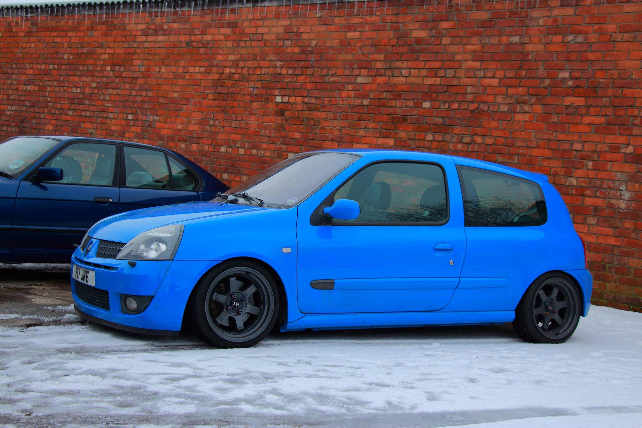

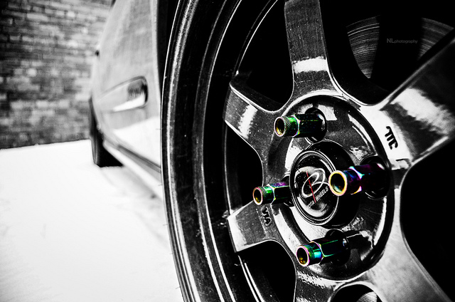

Right then, some pictures have finally been taken of my new wheels. They're Rota Grid-V's refurbished in Gunmetal Grey.
Fitting them was a bit of a nightmare and involved fitting 172 cup stub axles, grinding caliper face and 2 degree camber shims but theyre finally on and I love them.
I've also fitted a stud conversion, polarised nuts, polybushed dogbone, painted bullets & diamonds and thats about it.

Wheel & tyre spec's?
Also how come you had to change the stub axles?
Were the camber shims needed just for the rear?
The cup stub axle's sit 5mm further in iirc
Correct, you will struggle to pull it off without the 172cup stubs tbh.
If I knew how much of a pain it was, I wouldnt of done it haha.
Was no going back after having them refurbed and tyres put on.
Theyre 16x8 et20, need 5mm spacers all round. 2 degree shims at the rear and some bigger bumpstops or else itd rub like f**k.
I've got max camber from the vmaxx coilovers on the front and it's very tight to the front bumper due to 182s extra castor.
I could trim the bumper to get lower but not sure if its worth it.
