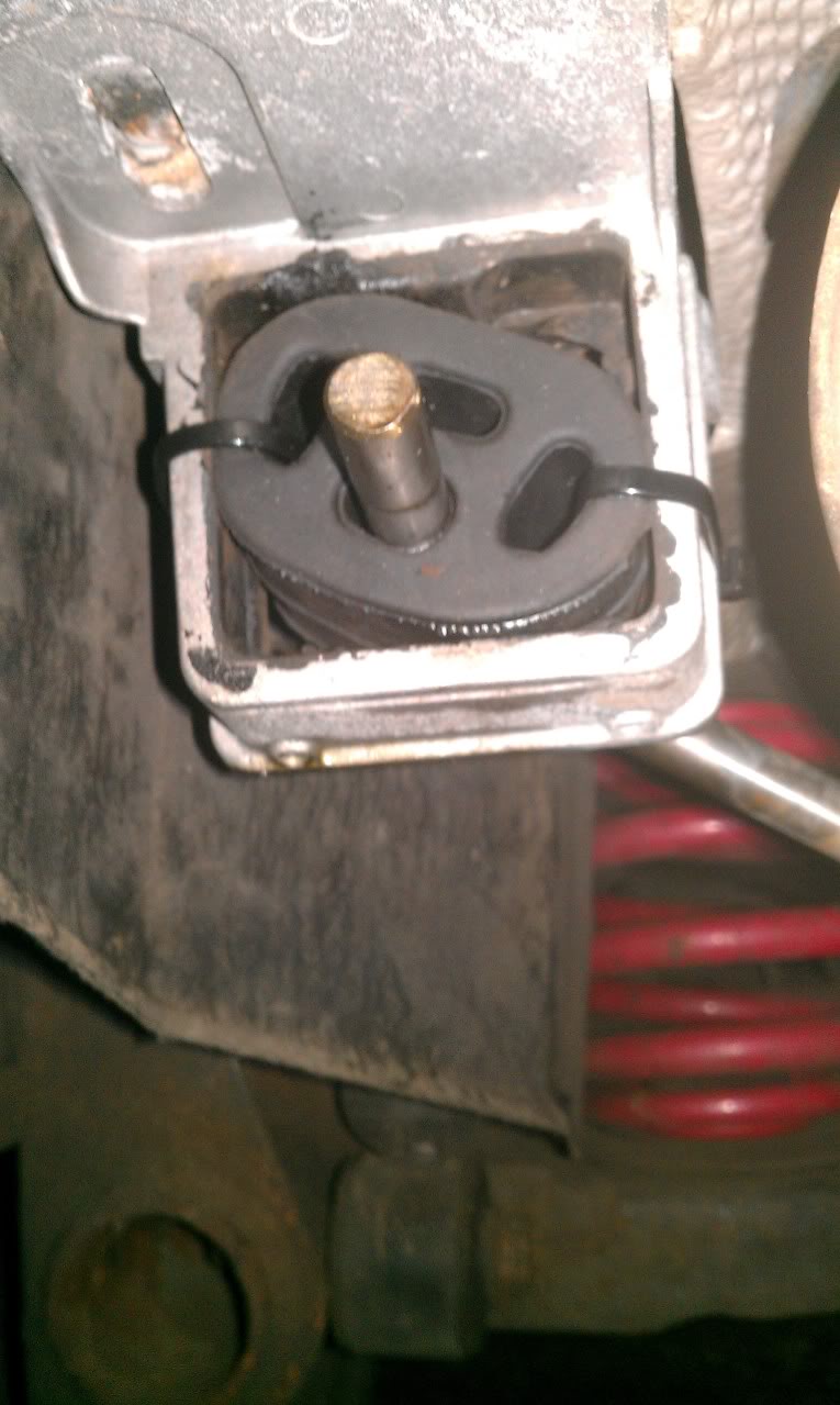

Replaced with my old mangled exhaust mount with a 13mm socket cable tied in to keep it upright and it's spot on.
  GSXR + KDX220
A pic of my modified rear hanger :)
  GSXR + KDX220
Depending on which backbox you have (the weight) will determine how long it lasts. It doesnt "break" as such, but after a few days/weeks it will sag at offer no real support to the box.
