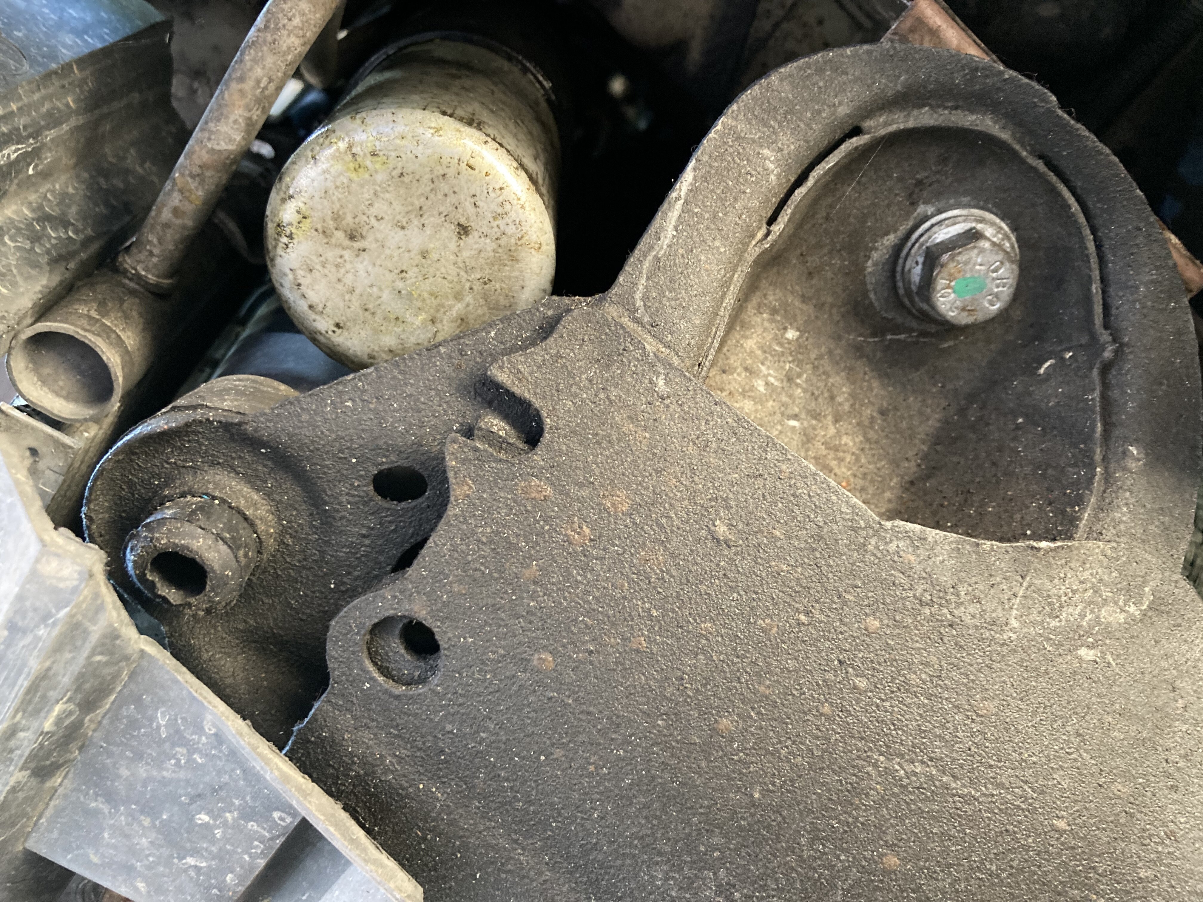

My Clio 182 has developed an oil leak from the front passenger side, specifically it’s apparently coming from this silver cylinder (see photo).
Any idea what this is?

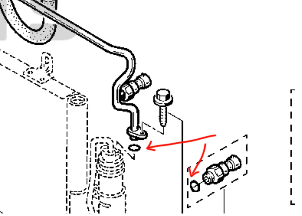

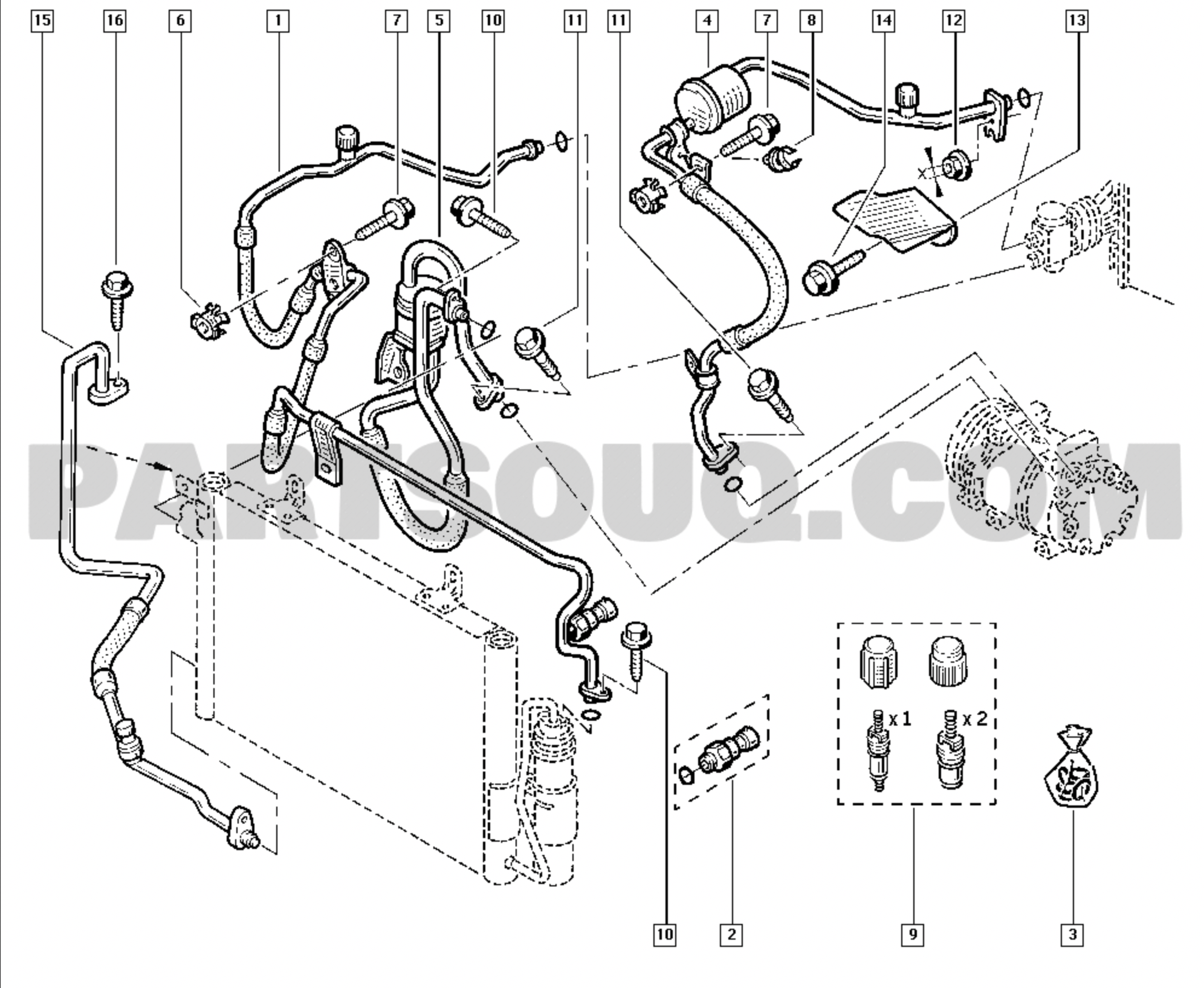

This is the complete system under the bonnet.
Mine is leaking from the seal on top of the dryer and a little bit from the pressure sensor. Then running down the pipe and dripping from exactly the same place as yours.
