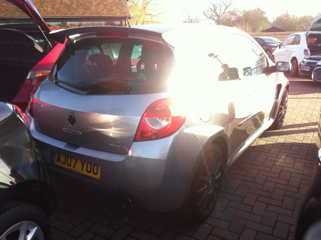

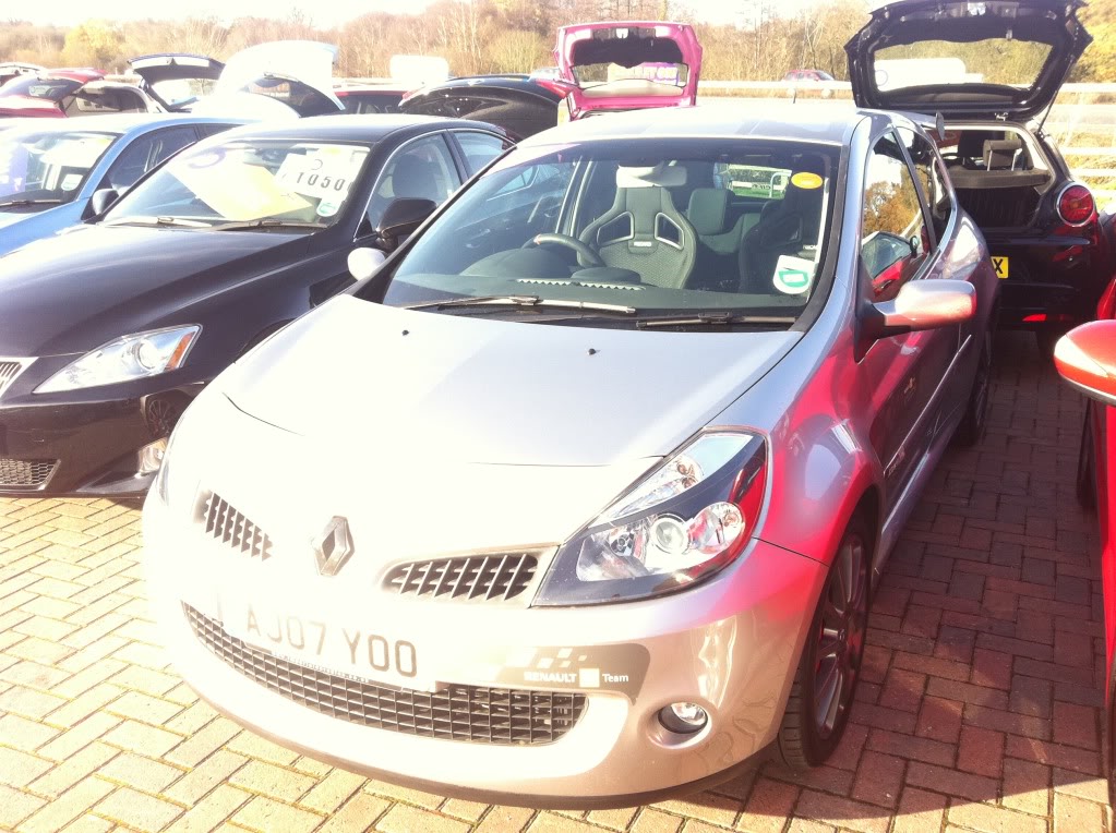

Hi guys, i have recently purchased a silver clio F1, moved from the ford side.
very impressed with the car. it came with a cobra sports exhaust from the cat back, not sure if its a good brand or not tbh but i have a question, the car is very kangarooie in 1st and second gear, the idol is fine but slow speeds in 1st and 2nd im being thrown backwards and forwards. i got the car from a dealership and they couldnt tell me whats been done to it, do you think this could indicate a set of high lift cams? because after 4000rpm the car picks up and revs all the way to 8000rpm

The pics show that this isn't a renault dealership so you could go to your nearest and ask them to check any history that they have on the car to see if it had the software update from renault that partially remedies this problem. Since having it done to my F1 it is very rare that the car kangaroos - although I am sure that my driving style has changed to minimise the chances of this happening. I dont know if they will charge you now as the update has been out for quite sometime, although if the car is due a service or something you might be able barter it as a freebie. As far as I know my car is healthy and I experience reasonable response below 4k (I have the flat spot at about 3.5k) but the car does pick up after that. More info can be had on 197.net. Hope this helps
