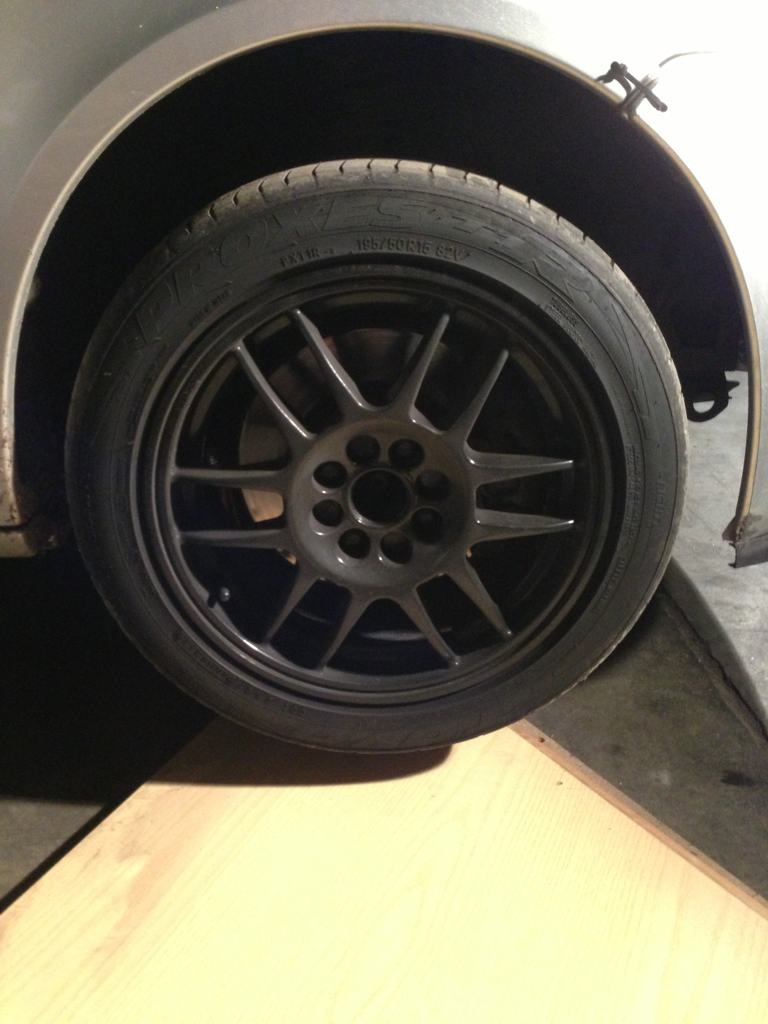

It's just a lot thinner so needs more thinner coats to layer it up. I've sprayed numerous amounts of wheels just in Halfords spray paint and people in the business wouldn't believe it was all rattle cans.
As long as your painting onto a decent heated surface in decent conditions the finish will be spot on.
  SQ5
Only picture I've got of the last set and they're very dusty. You can see how smooth the finish is.
  SQ5
Rattle cans on wheels and grilles are fine, especially on the grilles as its so fine its hard to rub down correctly. Meaning you need more thinner coats rather than fewer thicker coats.
