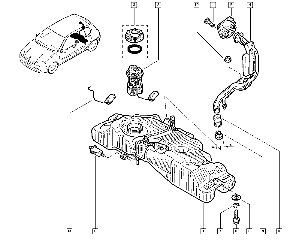

Is it number 13 on this picture you want?
If so, it's 77 00 845 961 it's £13.83 + vat retail.
Thats the phase 1 in that pic, i think some of them the fuel filter could be changed on the underside of the car under the petrol tank,
But on the phase 2s or newer ish models the filter is in built in the petrol pump housing, i think im right but may be wrong.
So i think he needs the new pump housing etc part number.
  182
this ^^^ phase 1s are located under the tank as shown in diagram,same as mk1 valvers iirc.
phase 2s are intergrated into the pump/housing in the tank
