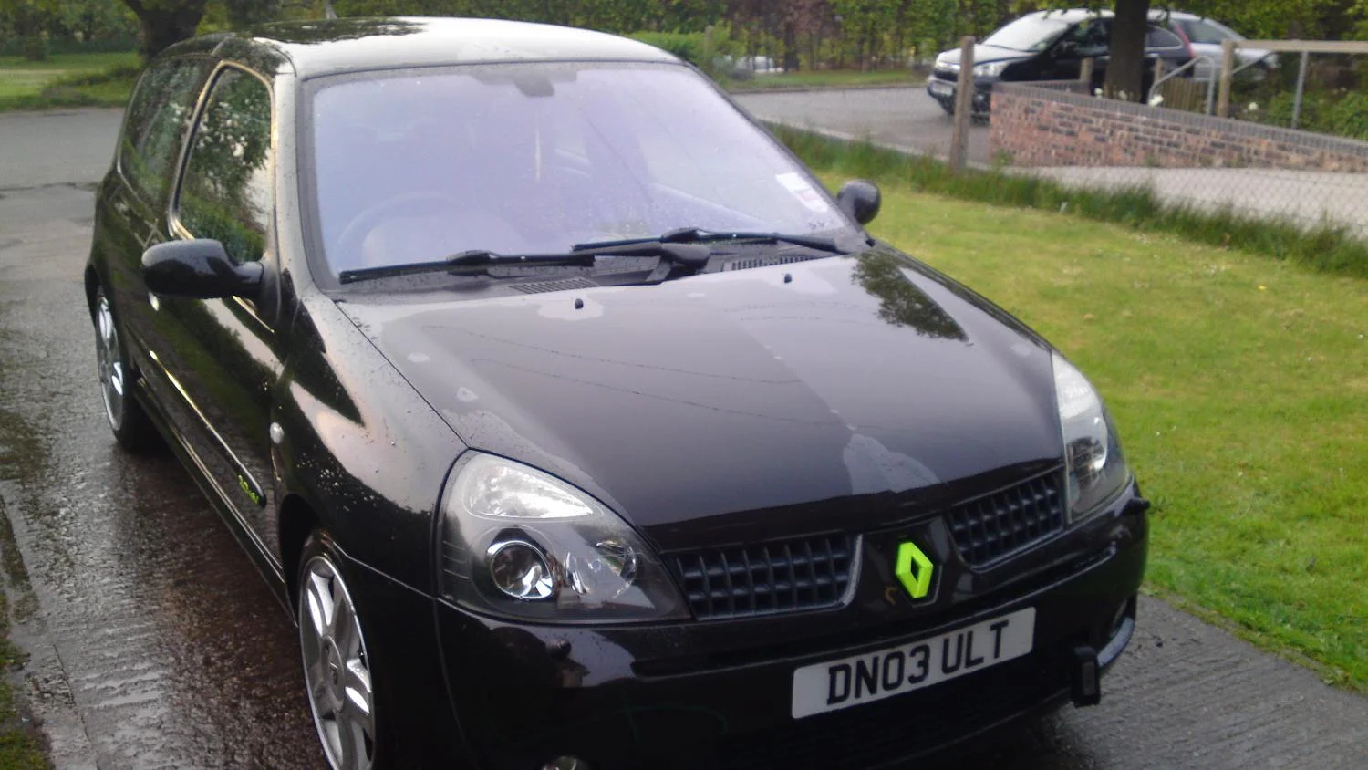

I decided to give the clio a detail this weekend as weather was good and the mrs was working. Still learning alot by rotary so only achieved 80-85% correction. I was pleased with the results though.

Washed the car using 2BM and some Zymol Autowash
Which left me with

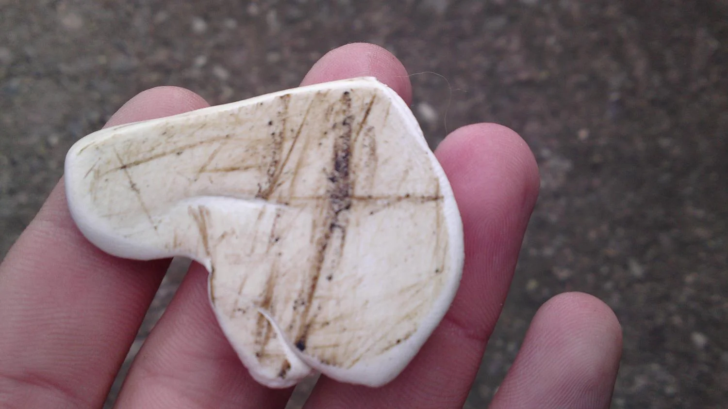

Then got the tardis out and attacked the bottom of the doors, sills and other affected areas. Then it was time for claying. The car was pretty good actually wioth only the bottom of the doors and sills really being contaminated. Worst of it left the clay like this.

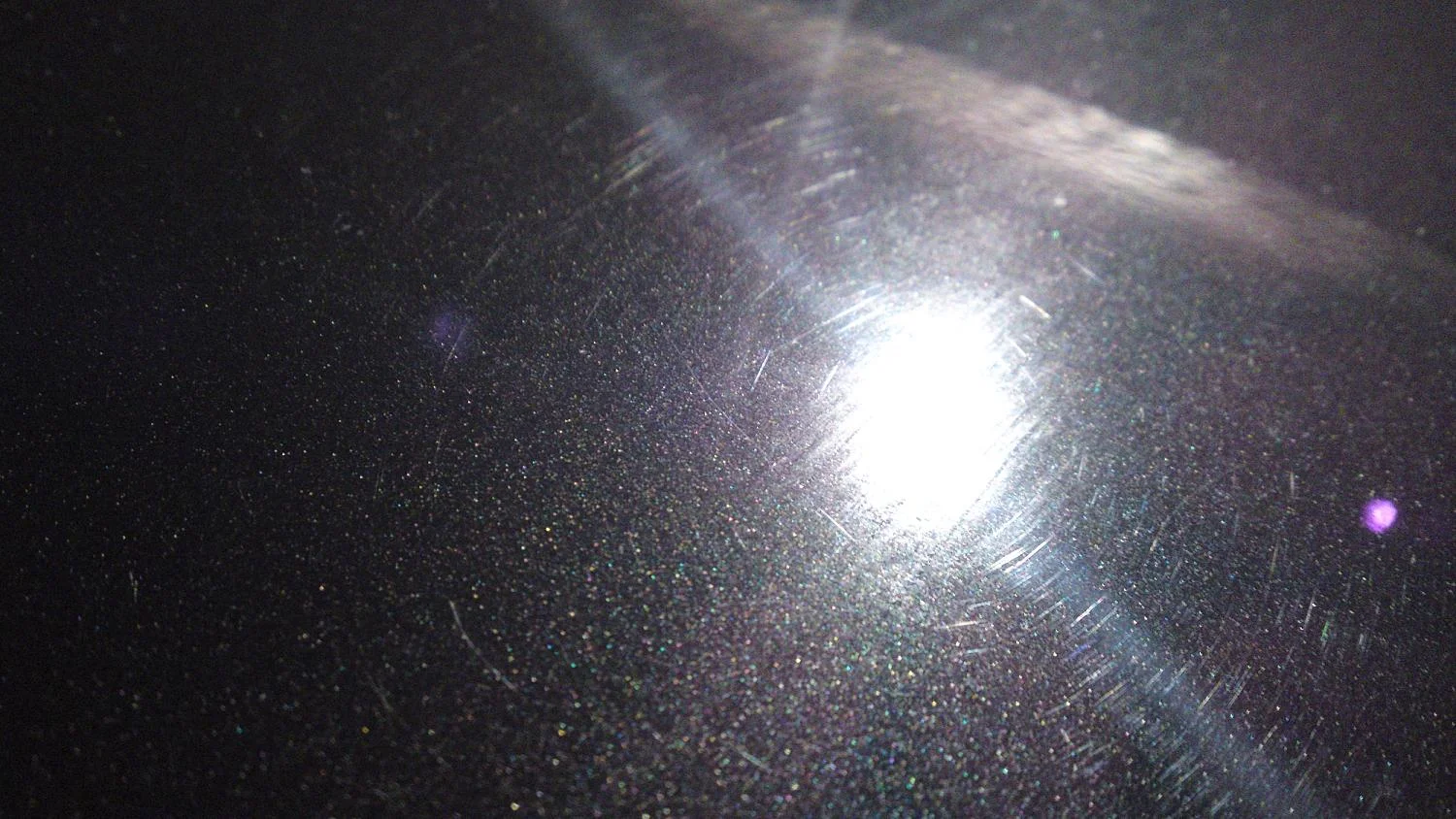

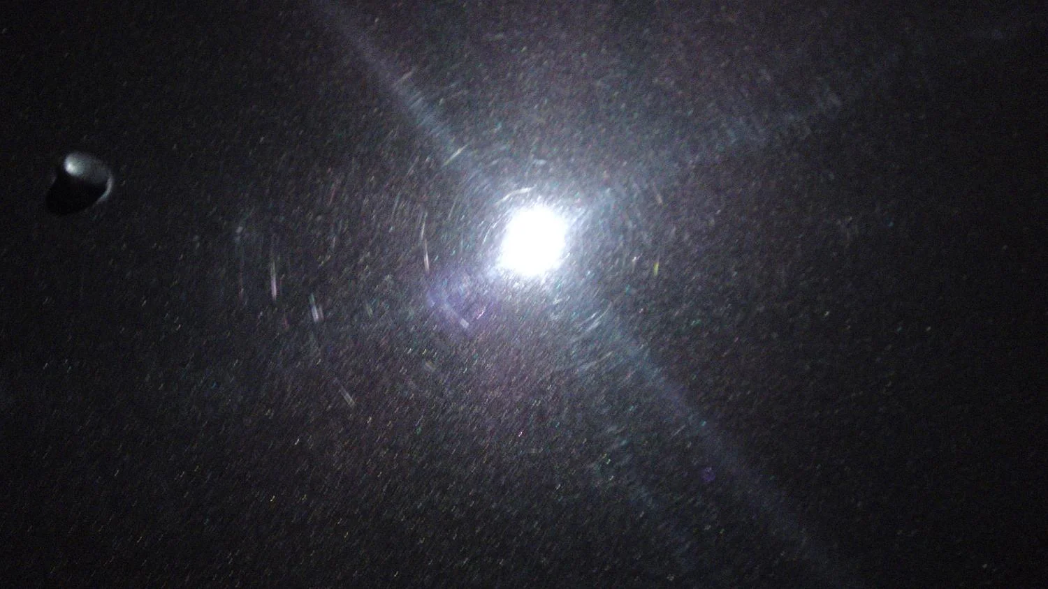

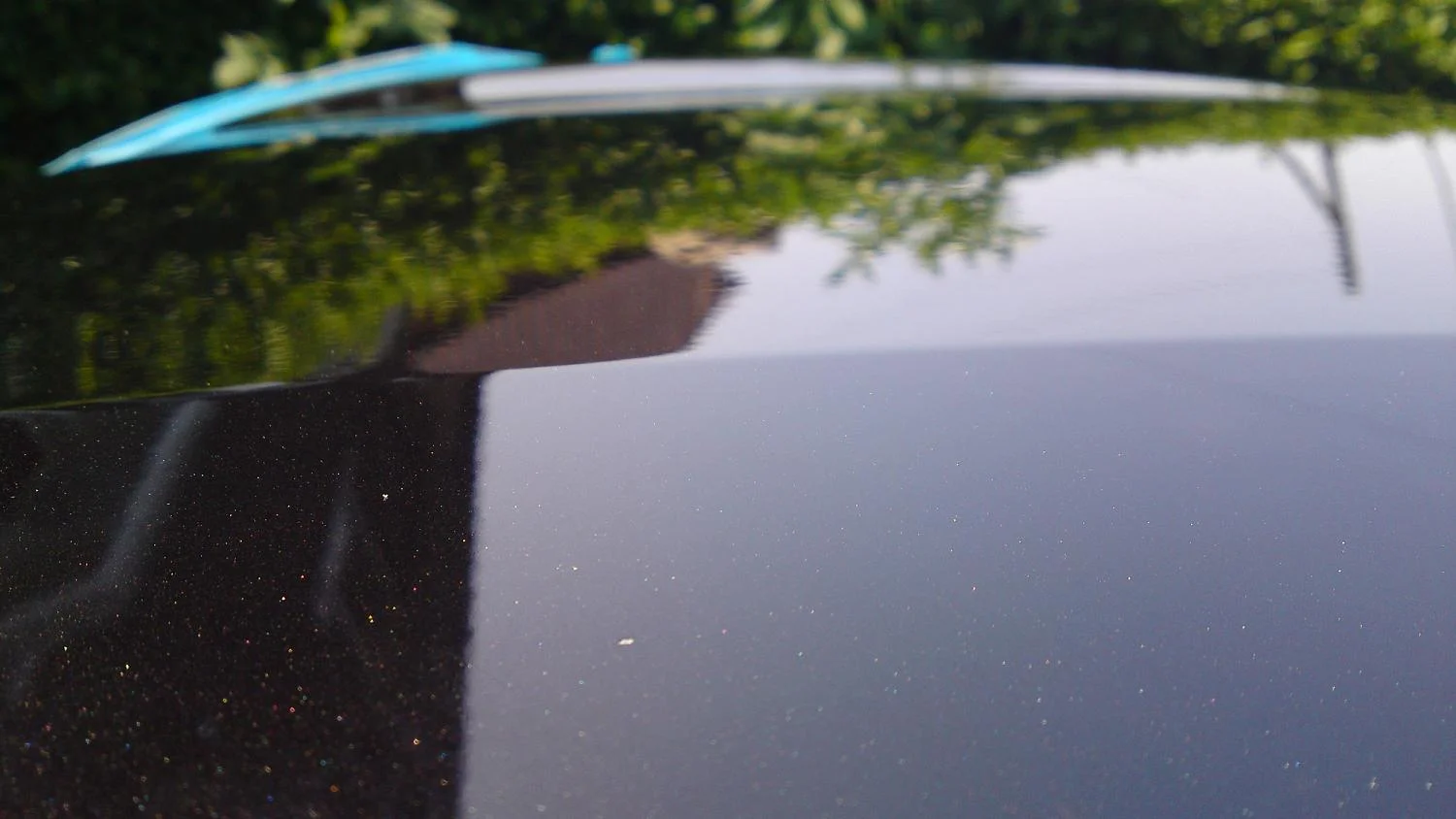

I knew the car had quite a few swirls and slight holograms. Couldnt get a picture though on my phone camera (tried before) so i got some the night before under my security light. General idea of how the car was.

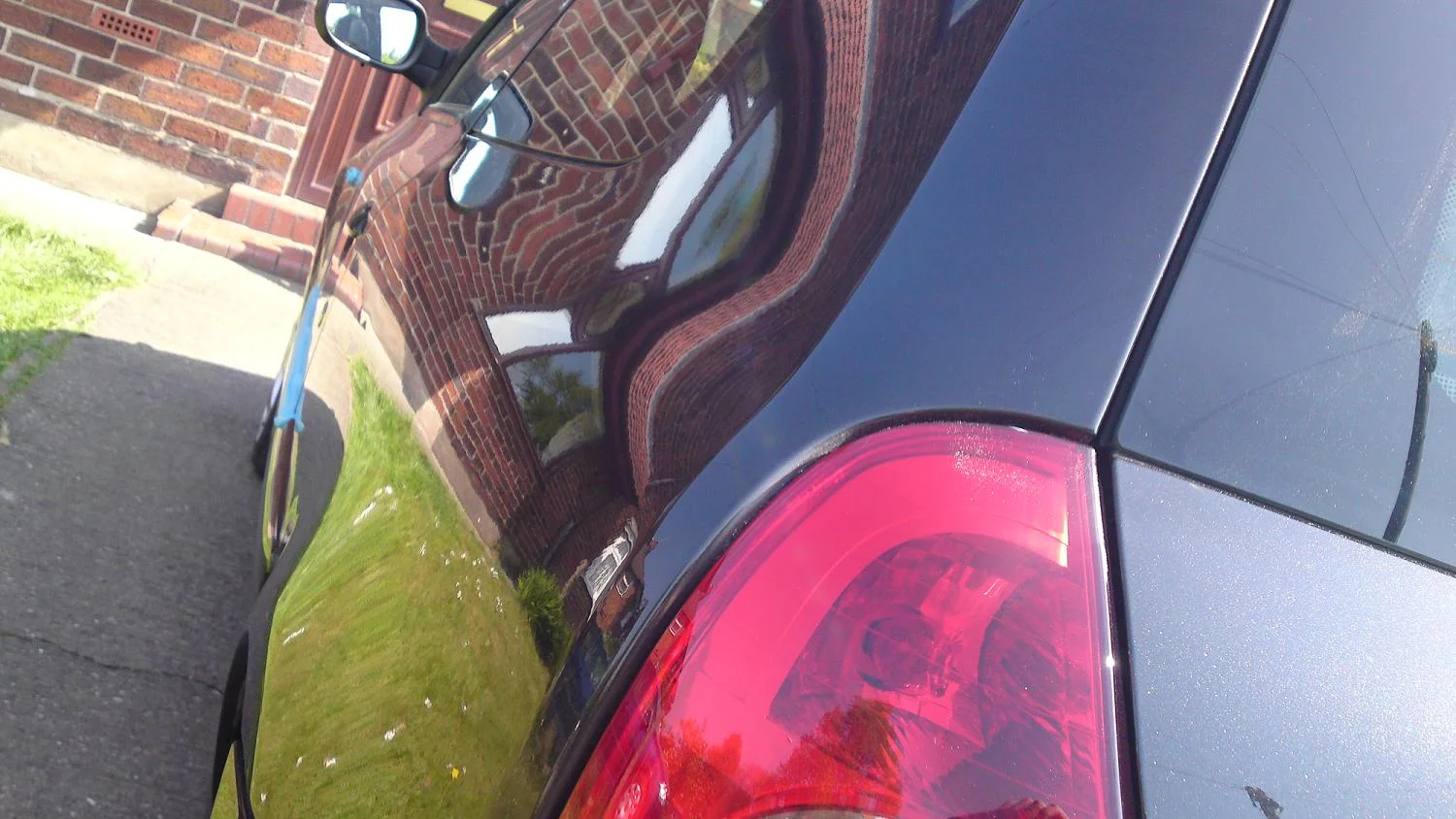

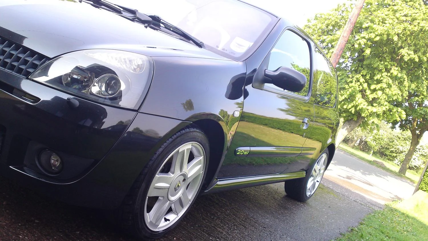

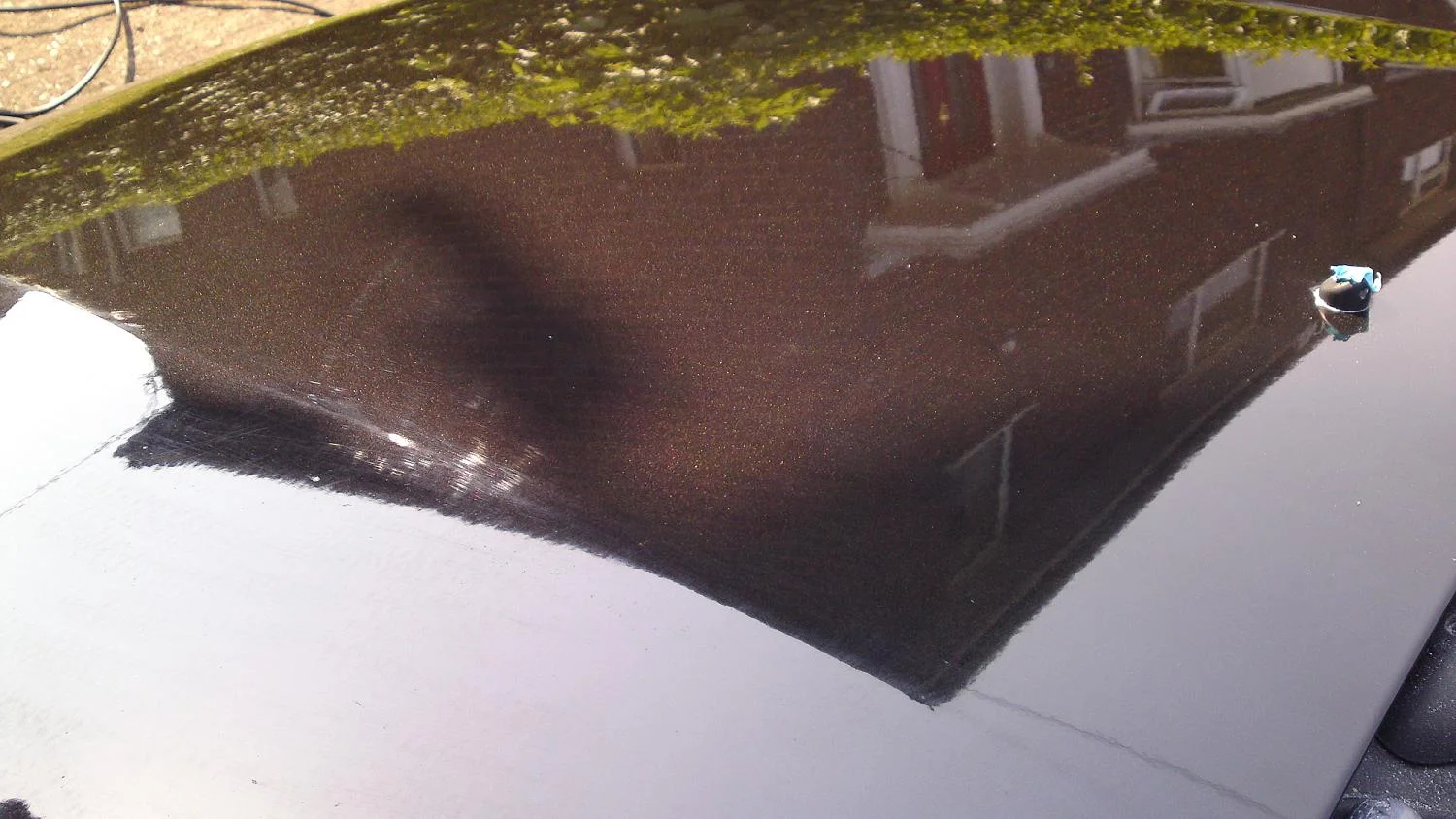

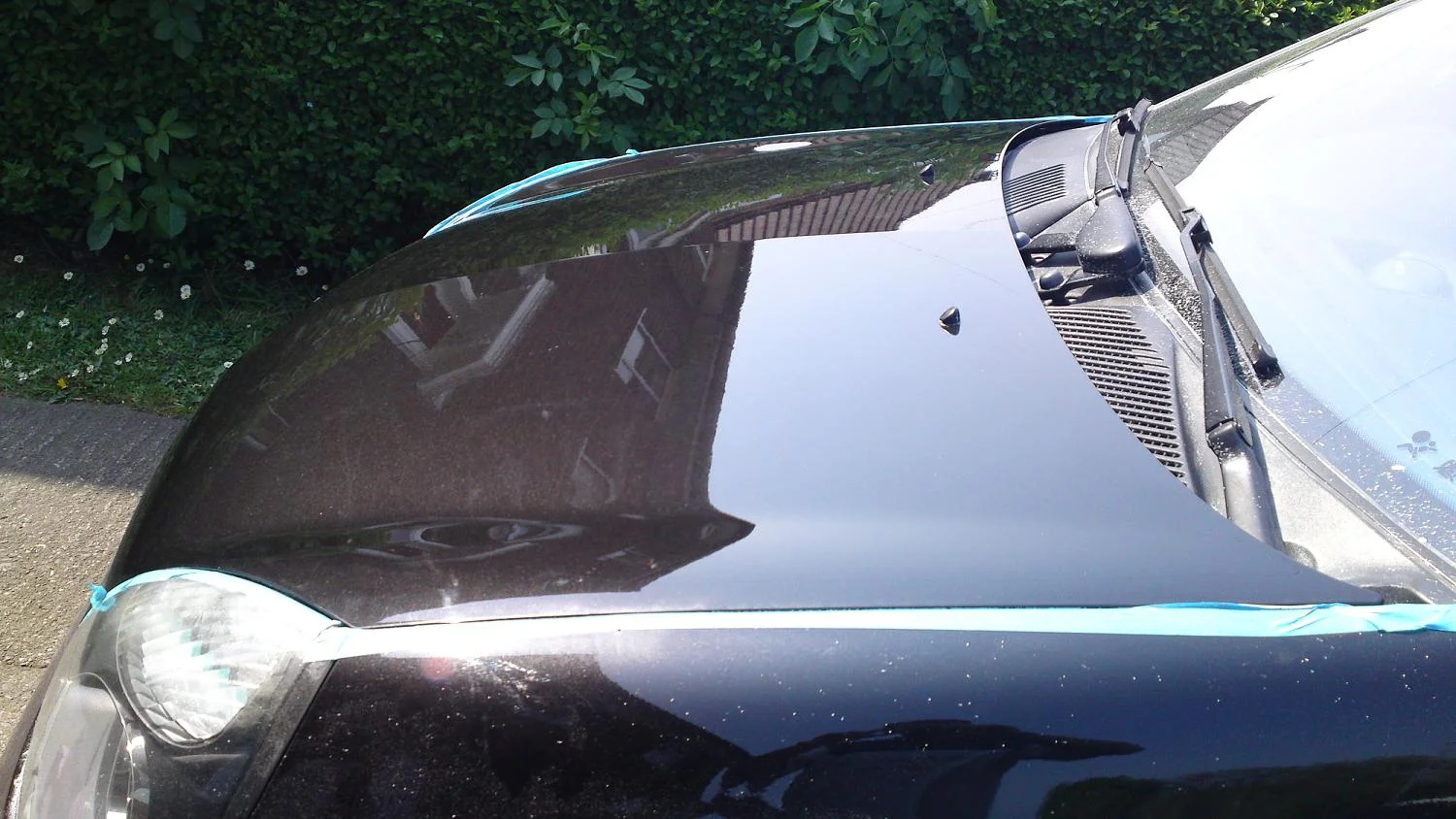

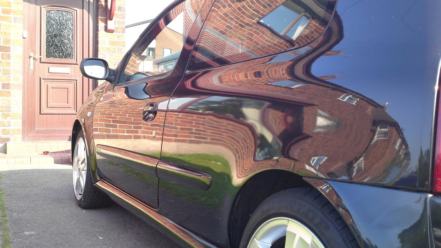

After playing with a few pad/polish combos I found that 3M Fastcut plus was giving me the best results on a yellow 3M polishing pad. I did this over the whole car with various numbers of passes depending on how bad the swirls/holograms were. Refined after with 3M ultrafina on a blue 3M Pad. Some 50/50 and final photos below of the results.
Car was then washed again to remove polish
And then dried again. Next up was 2 coats of Jetseal109 on a megs applicator

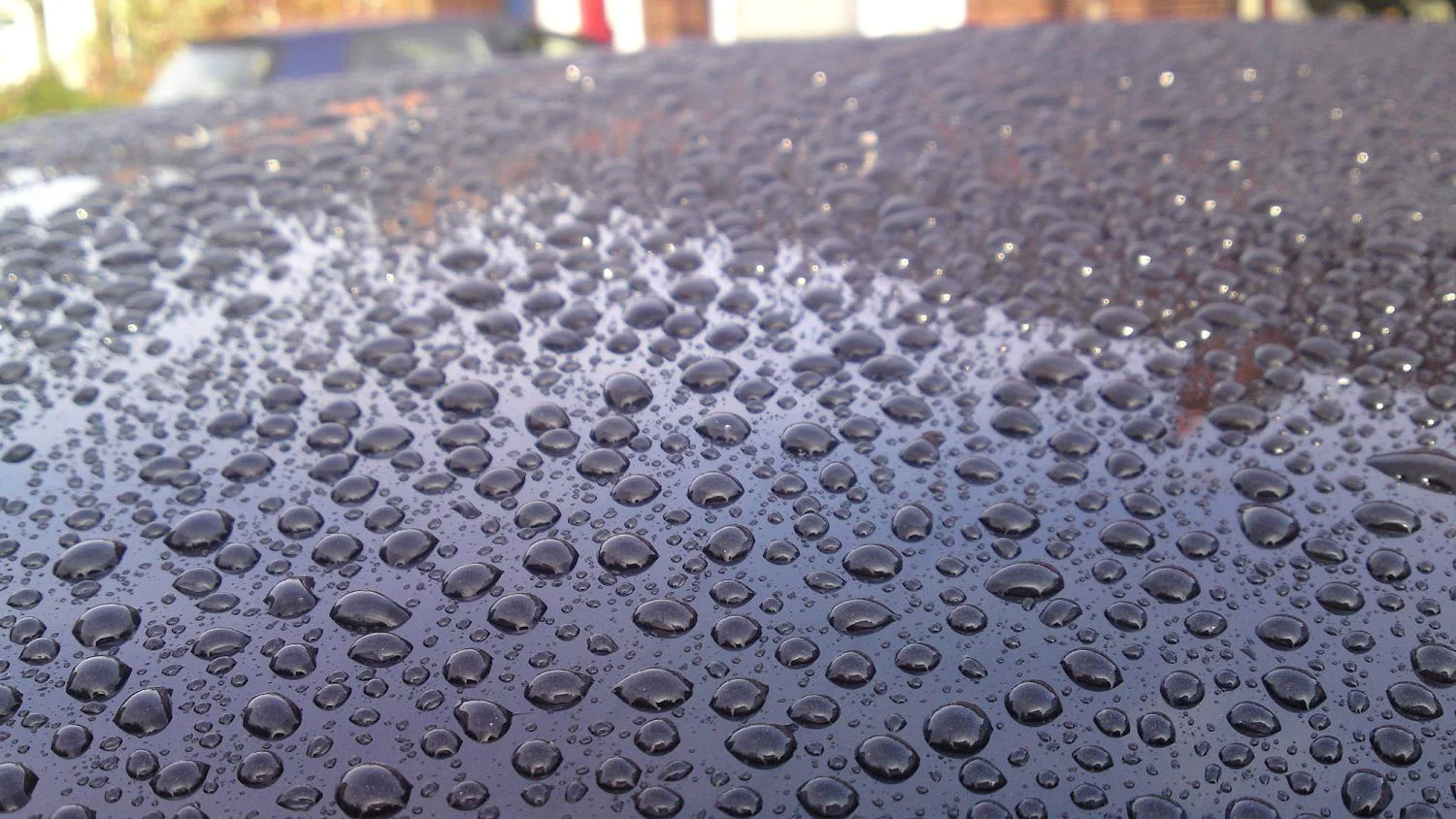

Followed by 2 coats of Pete's 53 on a dodo finger mitt
Final Shots and a beading shot

Maybe spend a little more time with the tardis instead of going staright to the clay mate, the less tar on the clay the better. :D

Yeah cheers gally. I put the tardis on and let it do its thing, it stopped running so i rinsed it and did it again so assumed it was all gone lol. Some of the s**t on the clay was the bottom side of the skirts and betwwen the skirt and the door. Yes it is a very rewarding colour to detail. the amount of flake visible now is great. As said it aint perfect as its only my 3rd full detail with the rotary and im still learning pad/polish combo's etc. I was extremely happy with the results though. The bad back i had after a day with the polisher however :dapprove: lol
Gally
After spraying the tardis on and leaving to work for a few minutes you should wife off with an MF cloth not rinse, then apply again if you know it has a lot of tar, wipe again then wash or snow foam before claying. :)
