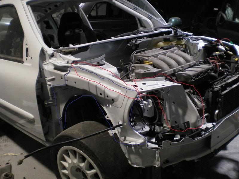

Ph2 front end on a ph1
  Clio's
do you need the ph1 inner arches and headlight surrounds cutting out and having ph2 ones wdled in or can they be changed to fit the wings and headlights?

no mate all bolt on stuff
need wings, bumper, lights, bonnet, grille and i think the slam panel (also a bolt on part) but im not sure on that one may get away with your one

I have all of tht but the ph2 wings dnt line up to bolt to the top of the inner wing and the headlight surround is shaped for the Ph1 headlights
  Clio 182
Iirc you will need the slam panel, wings, bumper etc etc.......... basically everything that comes off the Ph2............... if the ph2 has a headlight surround you will need that as well...
Did you buy all of the parts seperately???

Im guessing you might need inner wings and slam panel aswell? Also the wiring might be different for the lights?
