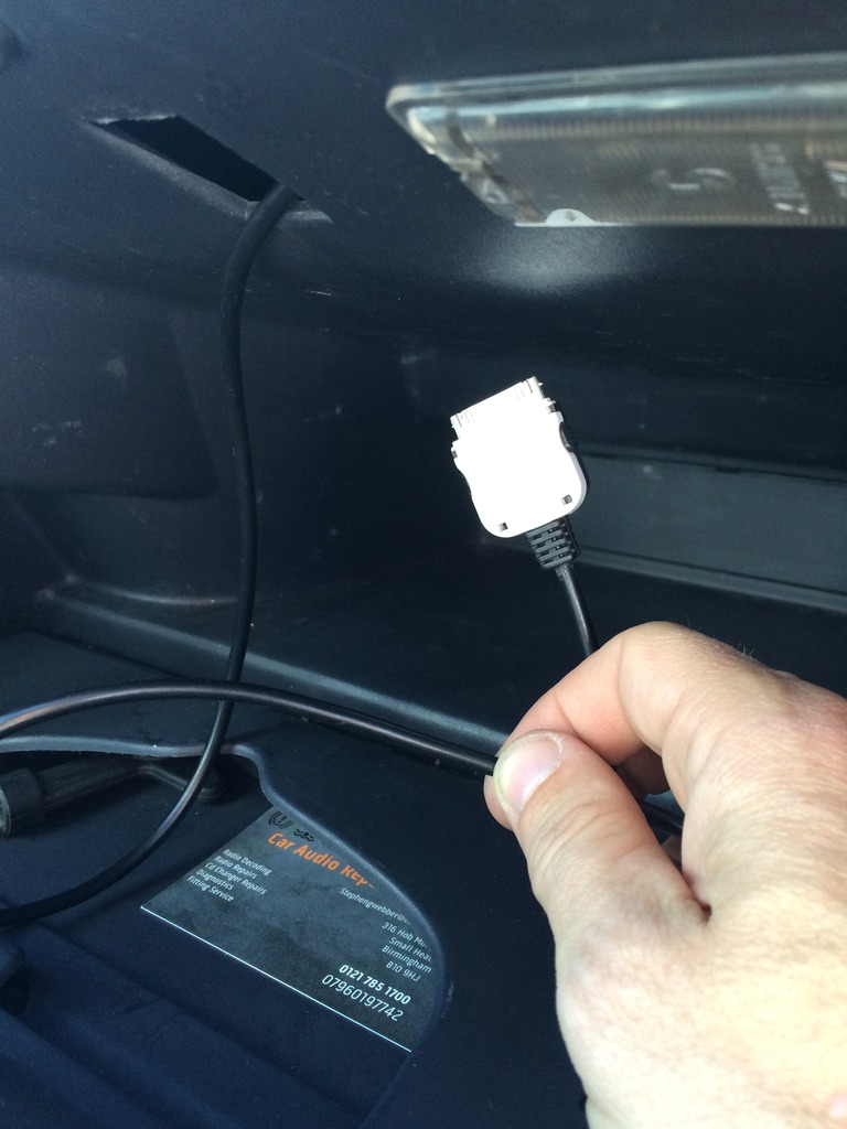

Remember you need some radio removal tools to get the radio out...or a few very thin screw drivers.
As suggested by Don, it's really easy to run into the glovebox, there is a hole in the top of the box already for you to run the cable through.

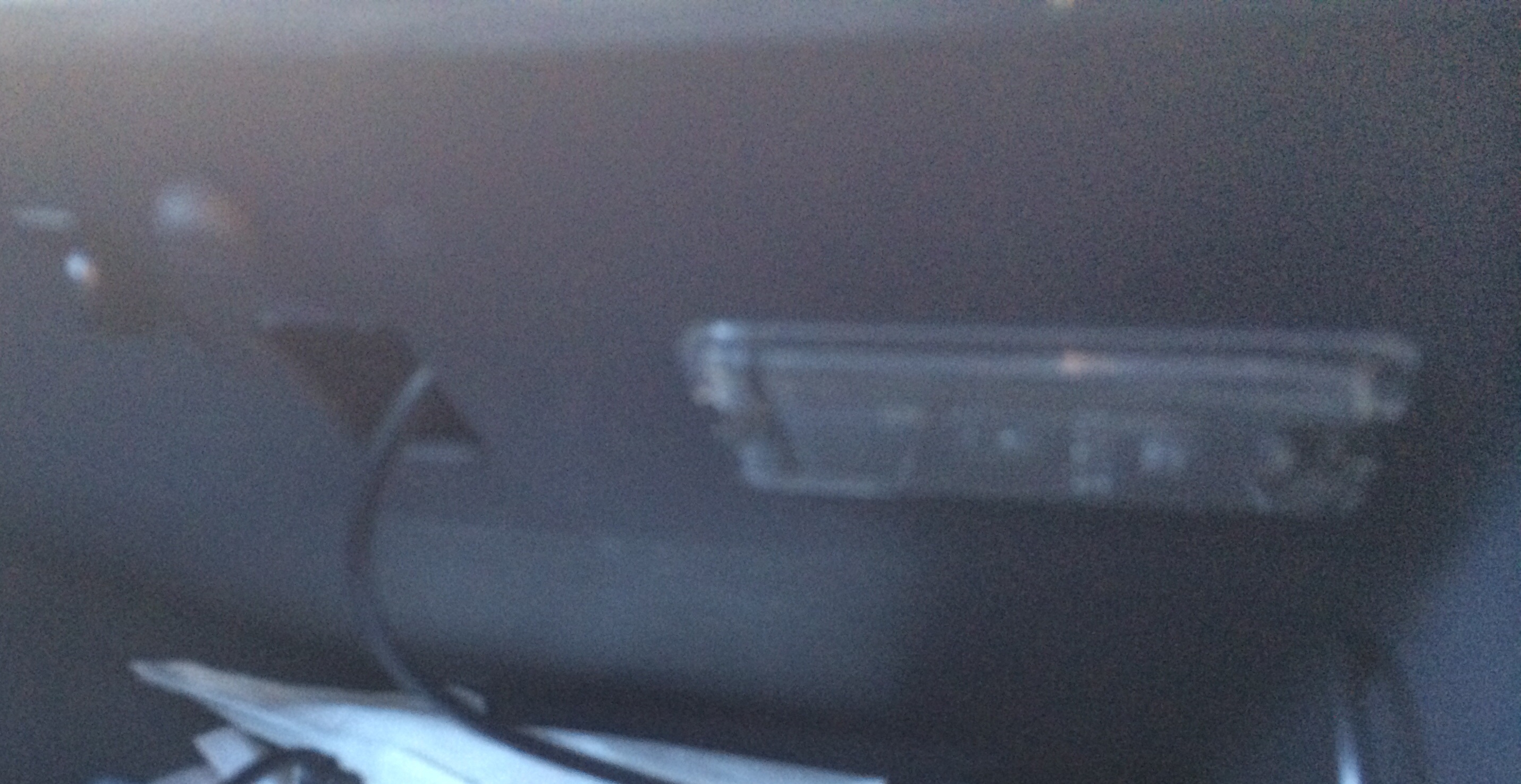

Photo of mine...excuse the poor quality! The black cable is run through from behind, there is room to get your hand in when the radio is out.

Better photo than mine! Should be plug and play...remember that the connects2 will only switch through the 1st 6 playlists if the iPod/iPhone is connected directly (you can think of each playlist being a different CD in the changer). Let us know how you get on.

Hang about, where does that connector come from? I just use mine in the headphone jack
There are 2 options you can buy. One with the iPod connector which means you can use the radio stalks to control the iPod and the other being a simple headphone cable that only plays the sound.
Balls, I'll have to have a look for the other one!
