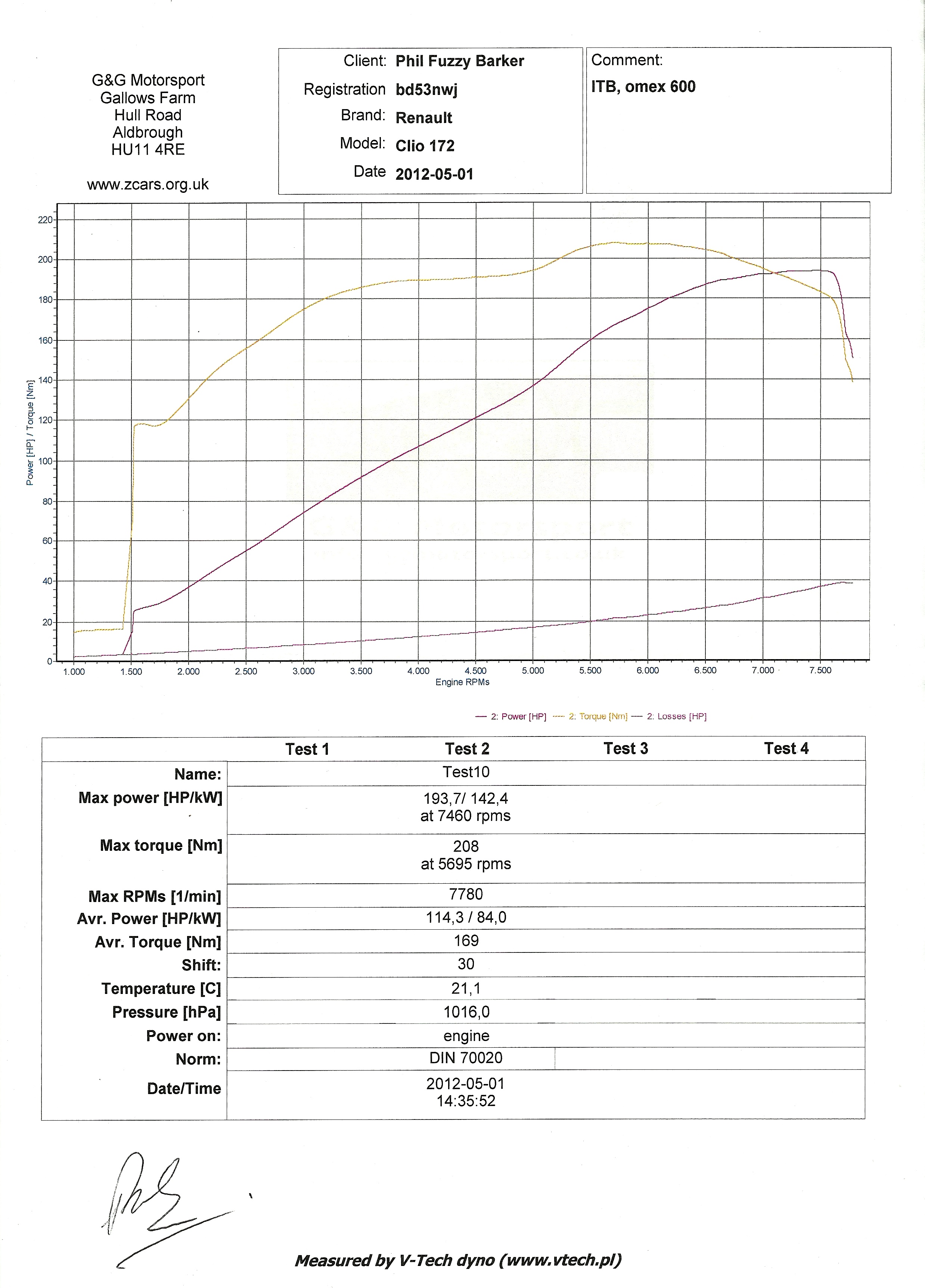

I am on standard cams.. makes peak power at about 7600rpm
  182/RS2/ Turbo/Mk1
Thats higher than I would have expected, although I was forgetting what short trumpets you were on, will be interesting to see if it manages to move down a bit with the longer ones.
Got a graph for yours out of interest?
It's fairly standard from what I've seen of other ITB'd engines running 90mm trumpets

A little lower peak power rpm on that particular graph than you mentioned, but thats a really nice curve that, certainly doesnt tail off as some I have seen, and looks like it should pull well even from 3K.
Hard to justify cams when it already drives that nicely, although obviously you could get around 10% more peak power, but then you might get to find out how good your pistons are or not, lol.
It pulls like a steam train - I'm really not bothered about cams at all :D
