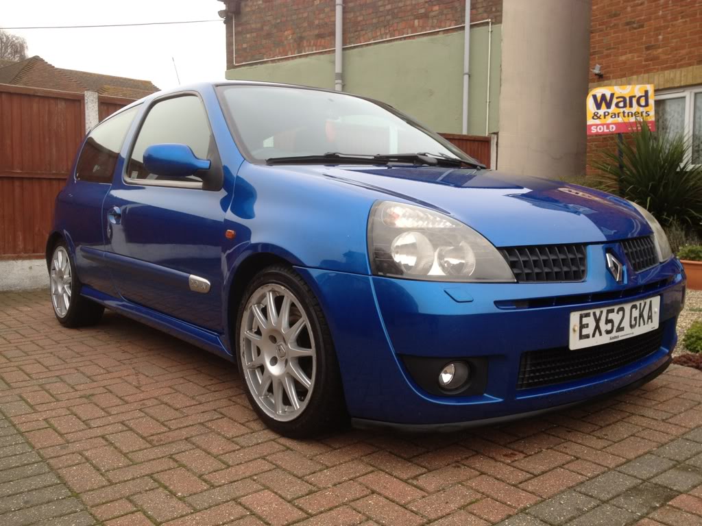

project 155K 172 cup
  BG 182
Project 155k 172 CUP

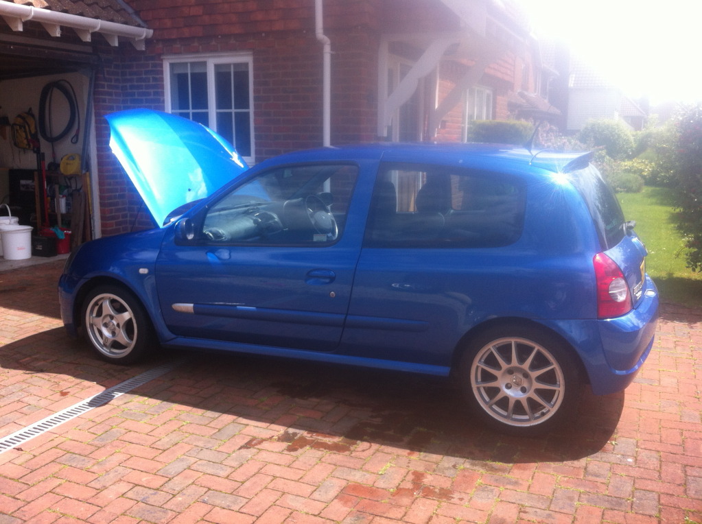

Some of you guys may remember me when I had the supercharged mars red V6
Now thought I best get a thread up about the tidying up of my missus 172 cup, this is our 4[SUP]th[/SUP] renaultsport, 1[SUP]st[/SUP] being a 182 FF racing blue, 2[SUP]nd[/SUP] arctic 182 no cup packs, 3[SUP]rd[/SUP] Mars red phase 1 V6 low boost supercharged, and now this a 172 cup with 155k on the clock.
With this being for sale by a friend it was up for £1300, it slowly went down to £1000, but I kept walking away and after some new rear discs and pads, a bearing, both lower arms, a tyre and fresh mot and tax I then purchased it at £700!! It has been in the same family since it 3 years old. So has 2 previous owners, service history is a little vague with it being stamped into the book from Renault up to 80k.
I was very wary of this but I know it had been serviced and looked after by the guy I purchased it off. However no proof of a cambelt, since Renault done it at 80K.
Suffice to say I’m telling my missus to take it easy in it and With this in mind I have a cambelt coming early next week and will order a dephaser come Monday as it sounds a little diesel like! I have managed to burrow the tools to complete the job myself as I fully intend to do it correctly. I will also do a completed service with new oils, incl gearbox and all filters. With this complete I then have a to do list which goes like this:
To fix:
Service and airbag light came on today when seat was moved forward while cleaning
Wiper stalk only works on fastest setting
Passenger seat cable

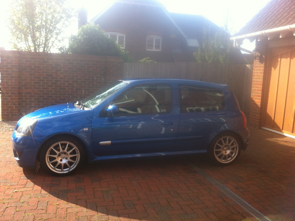

  BG 182

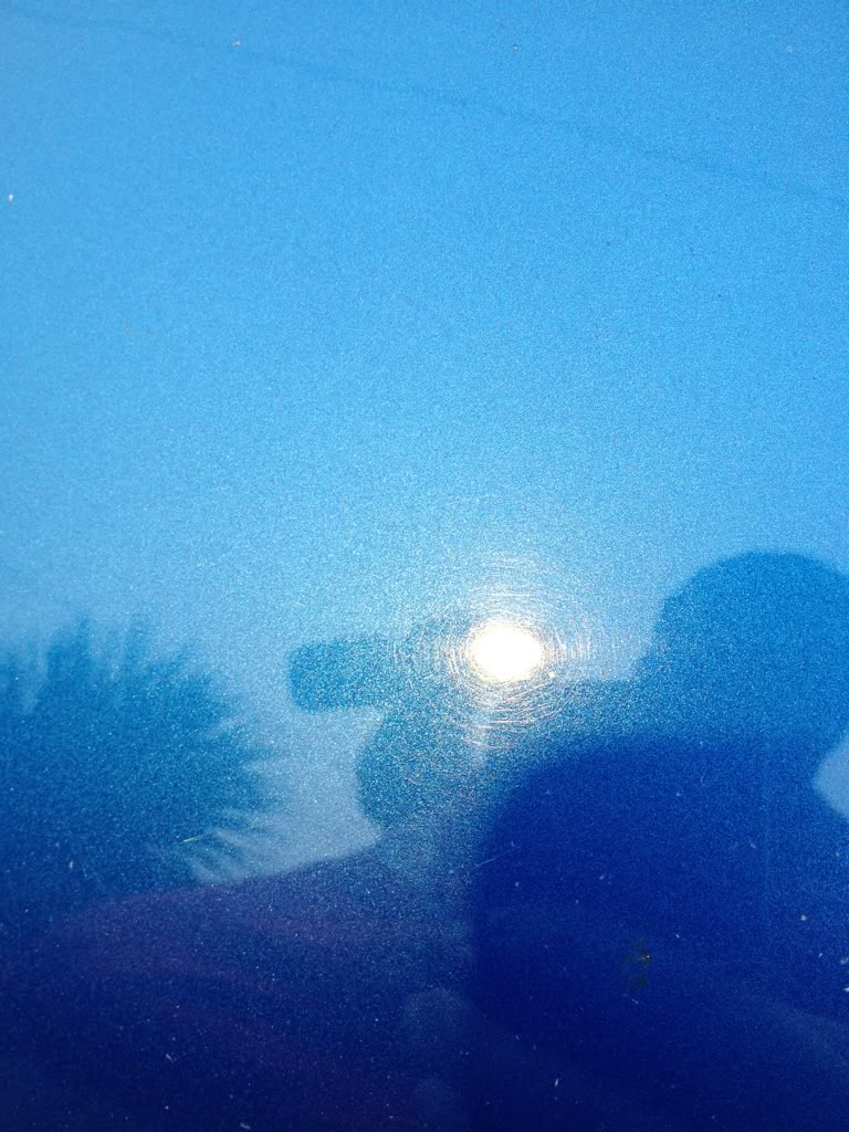

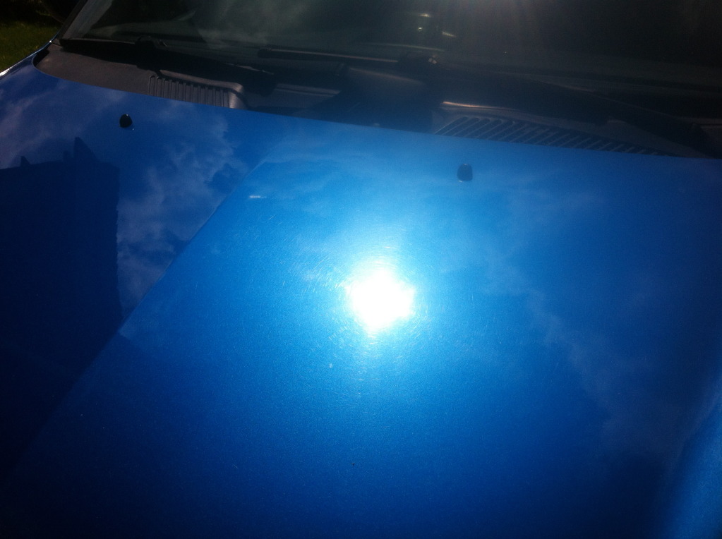

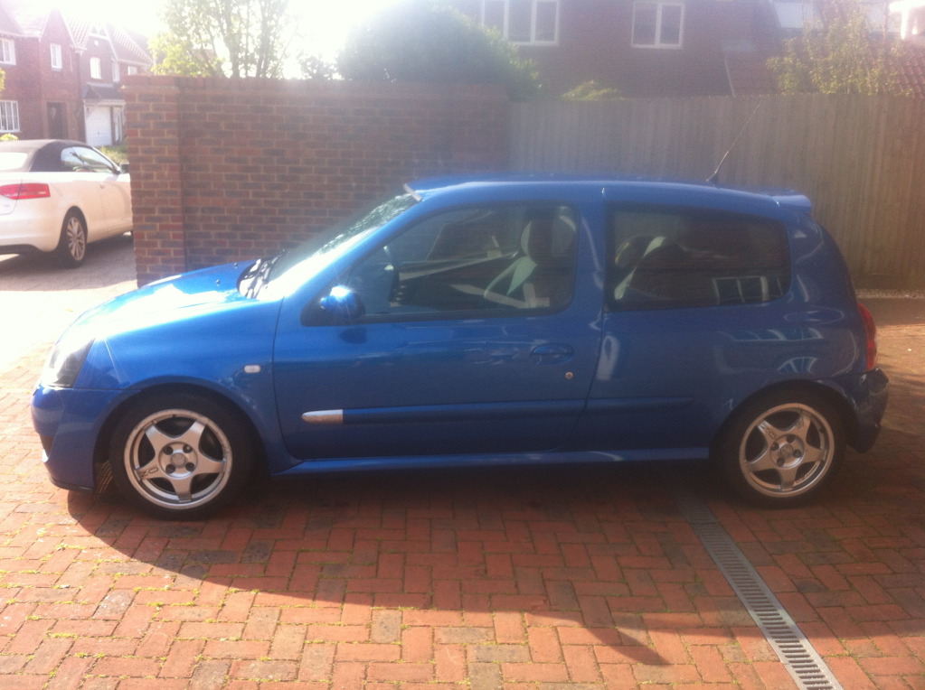

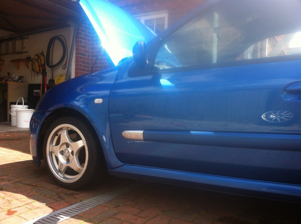

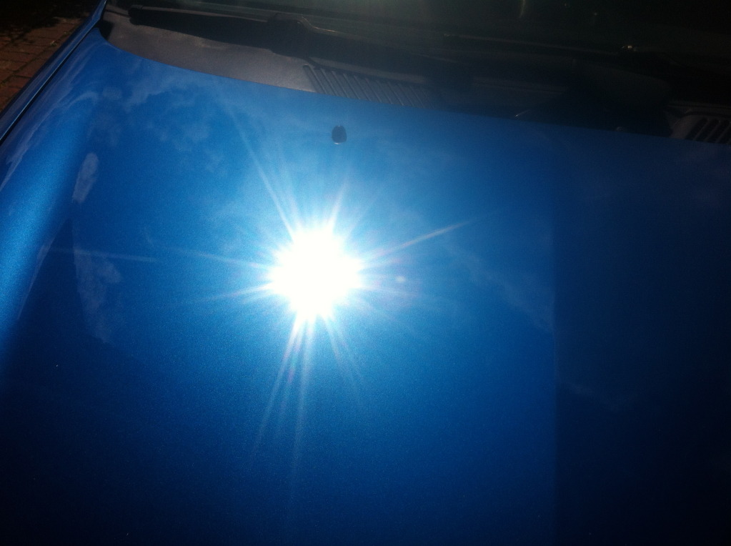

Here are some pics of a brief machine polish of the bonnet to see what I could achieve.
Swirls
50/50
After
To get 2mro as i forgot!!
I intend to do the rest of the car before Christmas so I can work out exactly what panels require painting.

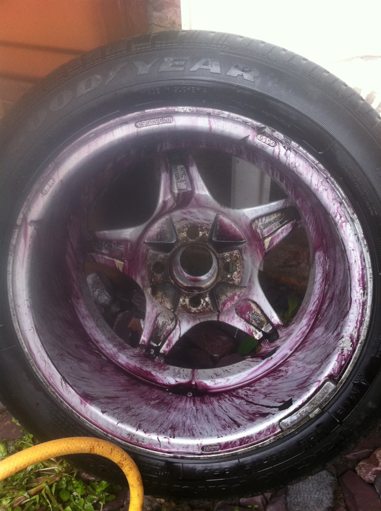

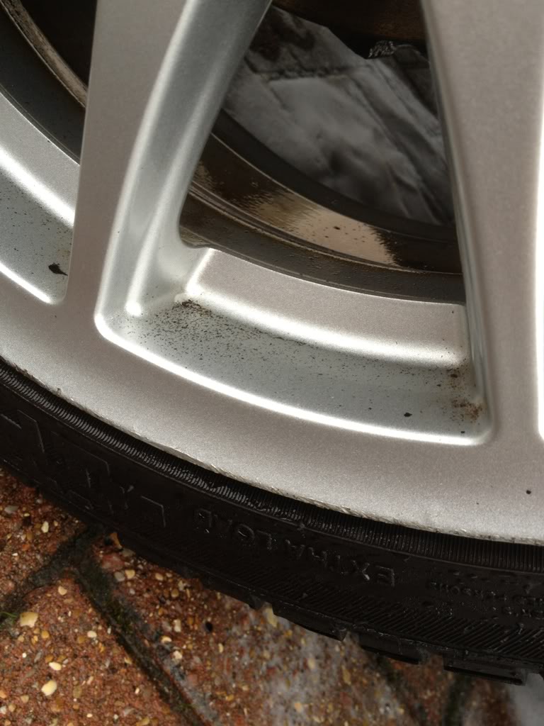

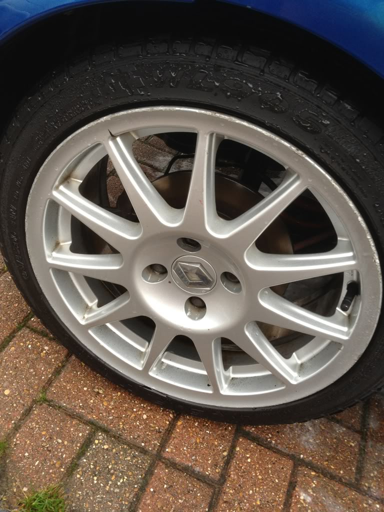

Some Wheels are flaky and covered in brake dust, wolf de-ironiser didn’t quite cut it today, gonna try iron-x next. The pictured below is one of the better ones.
MPG wise my missus has been seeing 30mpg which is combined and I know she hasn’t been driving slow!

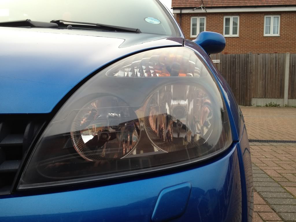

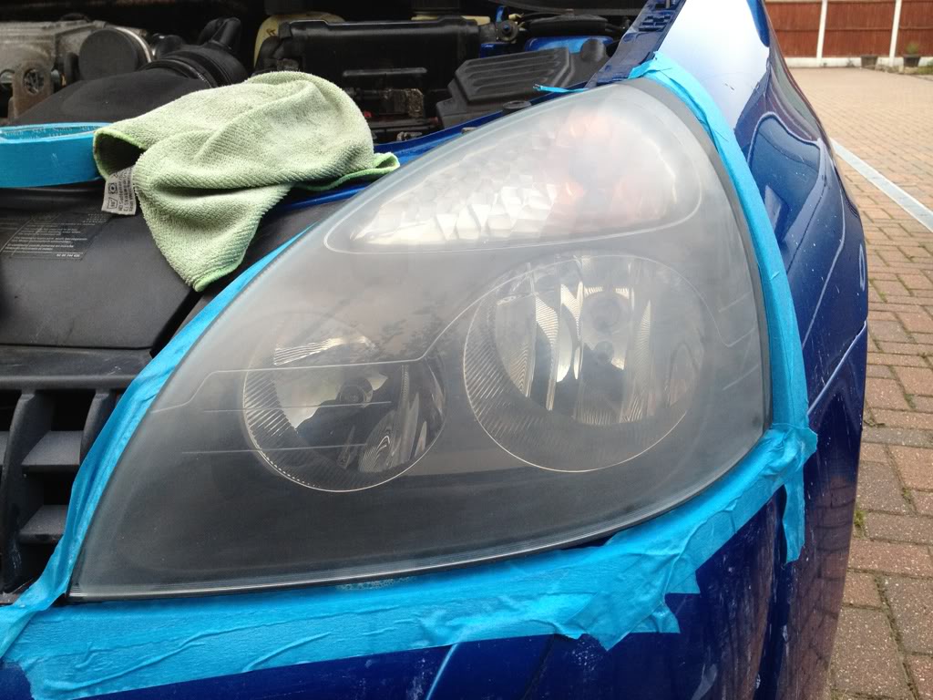

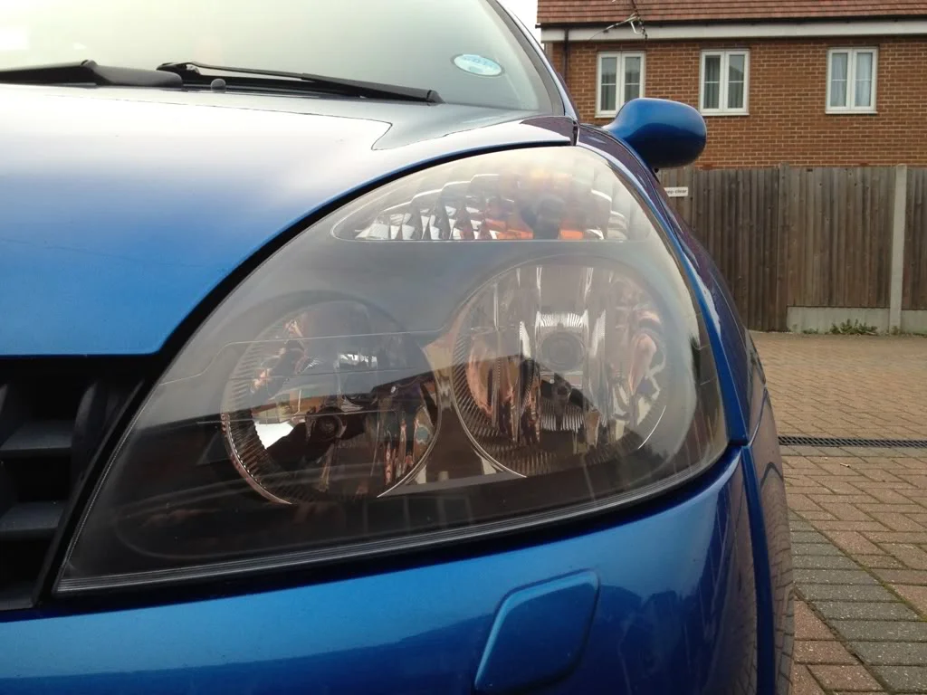

Also had a go at sorting the misty headlights!
Before
During – started with 800grit, 1200, 1500, 2500 then machine polished with 3m fast cut, they’re about 85% corrected but still need another hit with some 1500,2000,2500 I think.
After

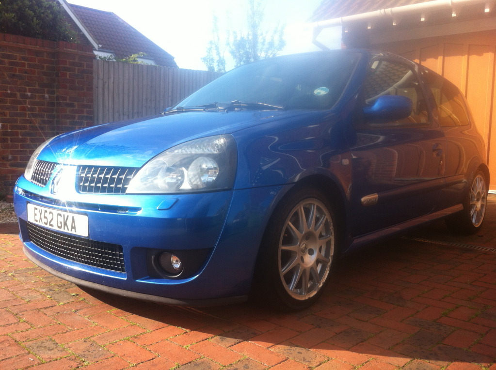

UPDATE
had the car over my friends pit and sorted the blowing exhaust which just needed the clamp re-aligning, there was also an annoying rattle, which turned out the be a washer/nut type combo which attaches the heat shields to the underside of the car. Quick trip to renault and £1.80 later it was renewed.
Also fitted a new wiper stalk, brand new gearnob, silvervisions, clear indicators, ¾ front plate and standard rear plate.
Then the coolant temp sensor was playing me up intermittently, with fan always running from cold and really lumpy idle. I was sat at home waiting for a courier and couldn’t go out or to Renault, so I thought I’d make use of my AA home start. Bloke came round plugged it in and bingo. CTS failure. nipped over to renault in the afternoon and £22 and 5 mins fitting it later, all was good again.
Also fitted a set of front components courtesy of sir_dave, which sound a lot better than the standard crap.
Since the last 'car not starting' problem outside the shop it has happened another 2 times, once outside the same shop!! Suffice to say it’s not been driven for 2 days now as it’s so intermittent. After some research I don’t believe its immobilizer related. The red light goes from flashing normally to coming on and staying on solid when the key is put into position 2. This I’m lead to believe is the key and decoder recognizing itself but a power issue to the ecu. Im off for 4 days after tonight so shall be doing some loom unwrapping to see if I have any broken wires, corroded pins on ecu and various sensors, relays.
Still waiting on a dephaser pulley but purchased a cheeky bargain off here, phs1 cambelt kit. Which i need to get a spacer for to fit our car. Saved me 50% off the price of a new one so made sense.
Also need a new hazard switch which im awaiting delivery and still need rear wiper, washer pump, one side light bulb and panel filter, all to be fitted this month, when the above fault is fixed.
I don’t plan to do the belts and depahser till mid jan now, as I have just secured a unit to work in. Where it shall also be prepped for paint, as the guy im renting it off will paint it for free if me and my father in law prep it which is result.
I also fancy some track time next year, or maybe a little drive down into France. Im not gonna go down the whole strip it out route but maybe some better brakes and tyres when the paint and belts are done. then maybe a stealthy exhaust.

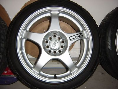

i have tried not buying things for the clio but after a quick ebay browse i found a cheap set of wheels. won the auction for £30 and (a petrol paid for) work van 230 mile round trip last night i now have 4 OZ chronos Evos in 15 inch guise. these i plan to use while the turinis have a refurb in the future and also i would like to shed these in some r888's for some track days. this is a way off yet but do hope this happens!
(the below arent mine, mine are renault fitment not multistud)
i also have some of these for a stud conversion.

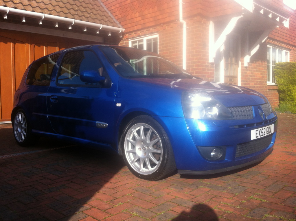

Right update time,
however my iphone has a hazy scratch on the case, hence all my pictures are very poor so i apologize in advance.
Since being back on the road it’s not all been plane sailing. I re-wrapped the loom and re-filled with coolant then done a few test run miles. It had a lambda sensor fault and a TPS fault, this resulting in limp mode. I purchased a known but good 2nd hand bosch lambda sensor and that was that cured. The TPS seemed to clear after an ecu reset and a good drive, it hasn’t been back since. This happened within the first 2 days of having it back. It had been sat for a while so I put it down to just ‘getting to know itself again’

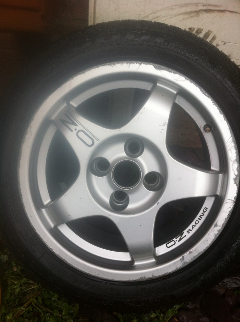

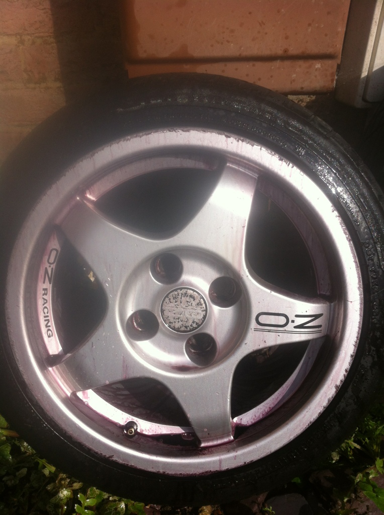

With wanting to refurb the turinis, I wanted some cheap alloys to run for a few weeks, but then be good enough to use as track wheels, but i had some criteria, 15 inch, no centre cap cover which cover wheel bolts, for easy access to the wheel bolts, and fancied something different. After some browsing these came up cheap and were 2 hours away. Anyway, they were too cheap to miss out on so burrowed the works van and all they cost me was £30 and my driving time. they are ET37 off the top of my head so have gained a little poke either side. i love them, they looka bit smaller than they are due to the design, but am very happy with them.
After I picked them up I got up nice and early the following morning to see how clean I could get them and assess the tyre situation.
Tyre situation isn’t great. 2 x 195/45/15’s which are all well legal and will suffice for a month or 2, but are Wanli and another cheap brand. The other 2 are snow tyres! These will be getting replaced in a couple of days, and plan to be used while I refurb the turinis.
They should go nicely with my new studs.
I had last Wednesday off work so treated the cup to an inspection, machine polish and a wheel clean, I only had 10 hours to do this in so didn’t achieve all that I wanted to, heres a run down:
Check of the condition of the cambelt as it really is in need of changing – it is however - ‘serviceable’,(i understand that its not a comprehensive check but its not cracked or split or damaged!) its clearly been changed, as its a genuine belt but i spotted tip-ex marks on the dephaser, assuming they are timing marks!!!!
Oil, coolant, brake fluid level check – all ok – to be replaced in the coming week though for peace of mind.

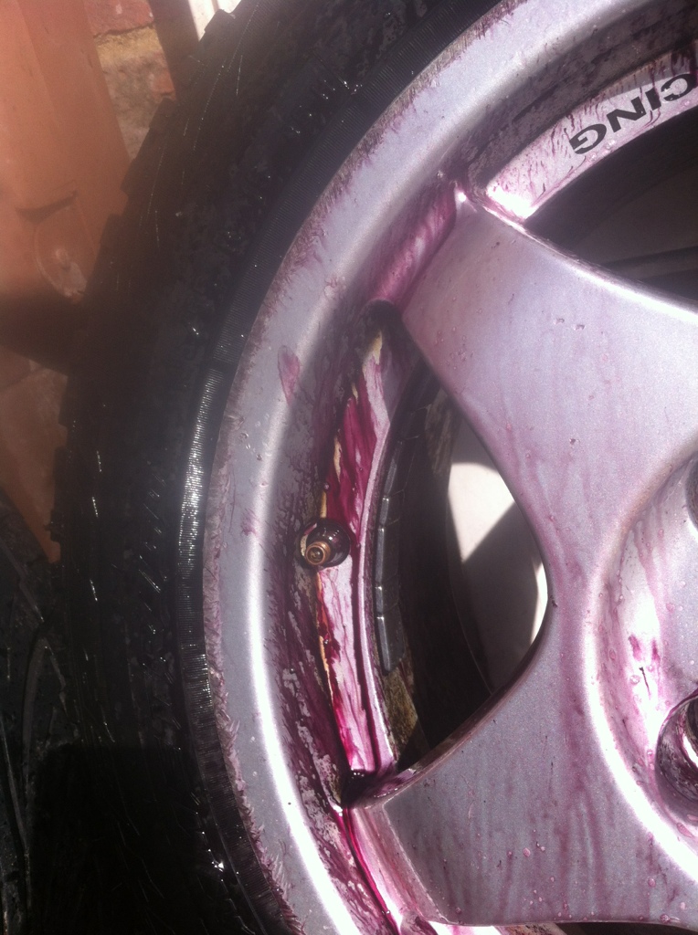

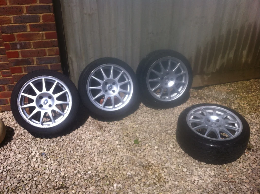

Removal off all wheels for a deep clean – took 3 hours! Bilberry and iron-x cleaned them up nicely but left some tar spots as I have run out of tardis. They are 10 times cleaner so am happy. And saves me doing it before I refurb them next week. the paint is all peeling of with edge of rim curbing, nothing deep or worrying.
while the turinis were off i tried on my spare wheels.

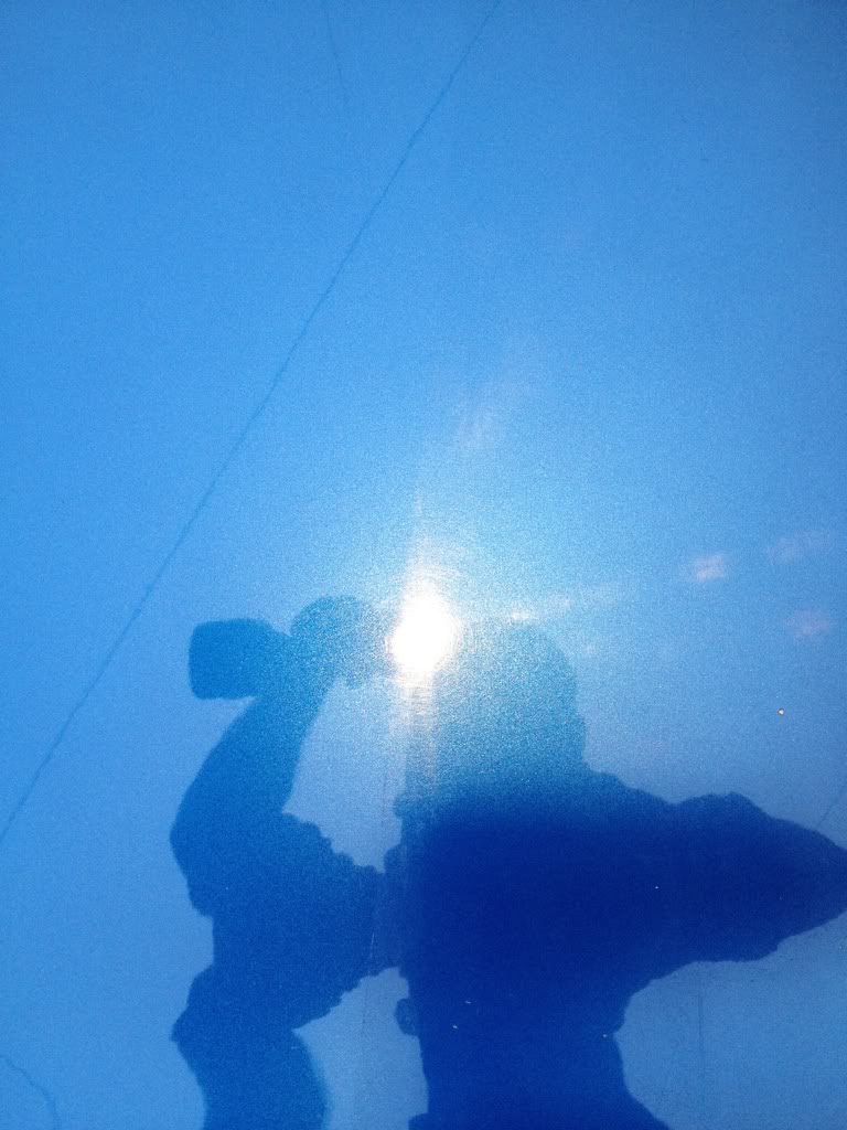

With the wheels cleaned I moved onto the paint work. It had been clayed and decontaminated with iron-x, tardis and clayed when I first purchased it so no need for these stages. this is before:
I cracked out my festool and loaded it up with a 3m yellow pad and megs 105. I got round the car in 4 hours and removed the majority of swirls but left some RDS, the paint work up close is not in very good condition at all.
Even the rear arches have very speckly, small stonechips. I put this down to high motorway usage. The front is peppered and really wants painting aswell. However it came up really nice, as I didn’t have time for 2 stage polishing I opted for poorboys black hole to finish up. Then seal it all in with some swissvax shield. Glass with Auto finesse crystal, and tyres with my old faithful megs endurance, love this stuff.
