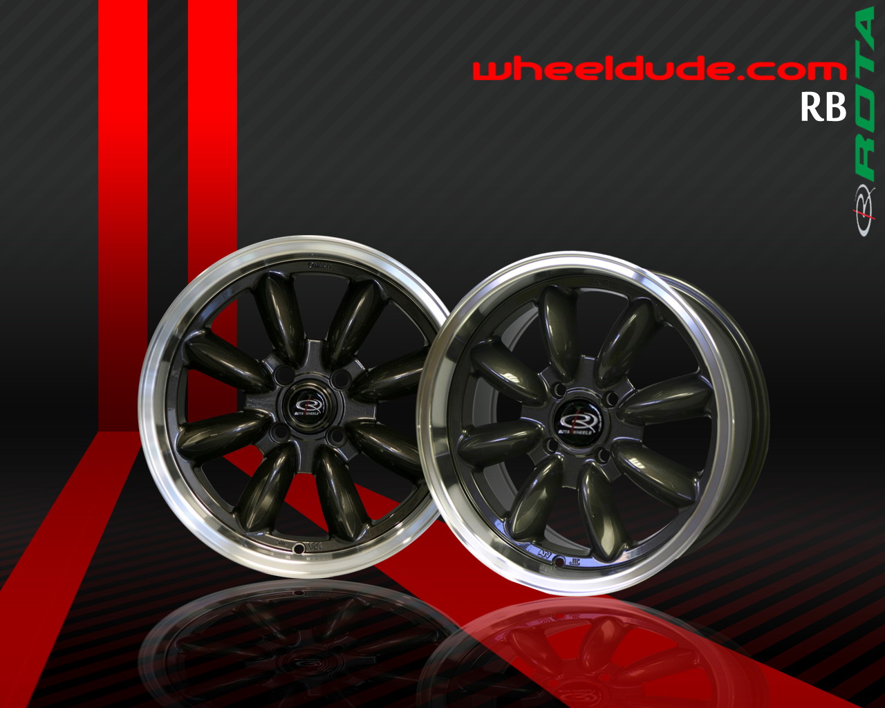

  PH1 172
^^ it will be keeping the ph1 lights and rear end - thinking about ph2 rub strips though...
wheels may be going black with a coloured lip ;)
either that or one of these
in 15x8
or
in 15/16 x 8?
any ideas?
