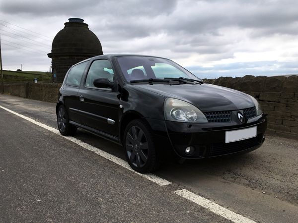

Took a few pictures earlier today.

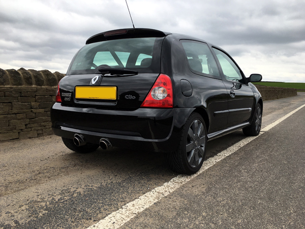

Bodywork is in very good condition, not immaculate but good enough for me. Only washed it so far, will give in a proper polish soon.

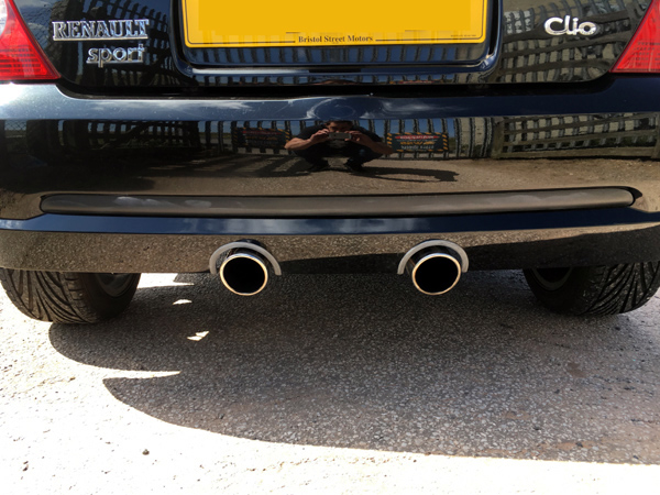

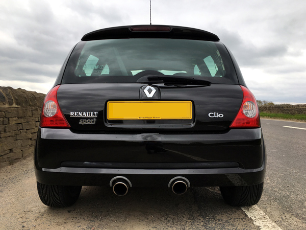

Exhaust rear mounts are shot at! Got Powerflex replacements going on today.

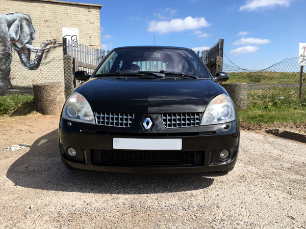

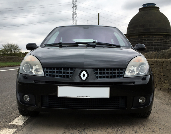

A few stonechips on the front, to be expected for a 12 year old car. Small front plate to fit today.
Might spray the grill, as it looks strange on an all black car, to have a faded/grey looking grill.

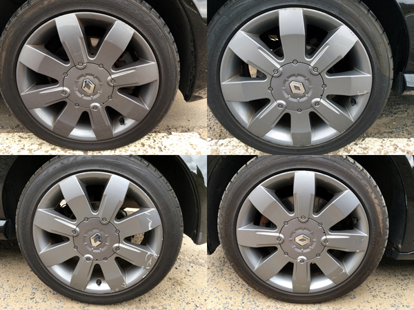

The wheels are in good condition, a few minor marks and one thats got some marks on the spokes. Nearly new Toyo Proxe's all round :)

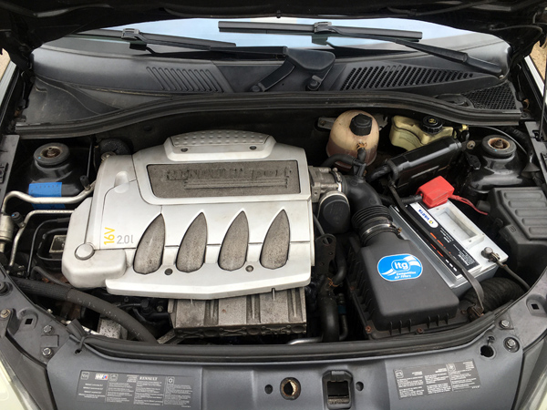

Engine bay is nice and tidy.

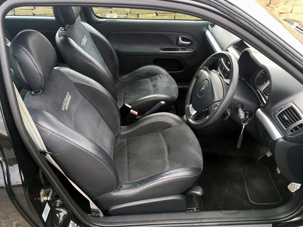

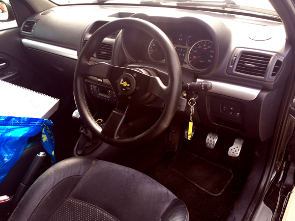

Interior is nice and clean. Seats are in very good condition. The steering wheel will definately be going!

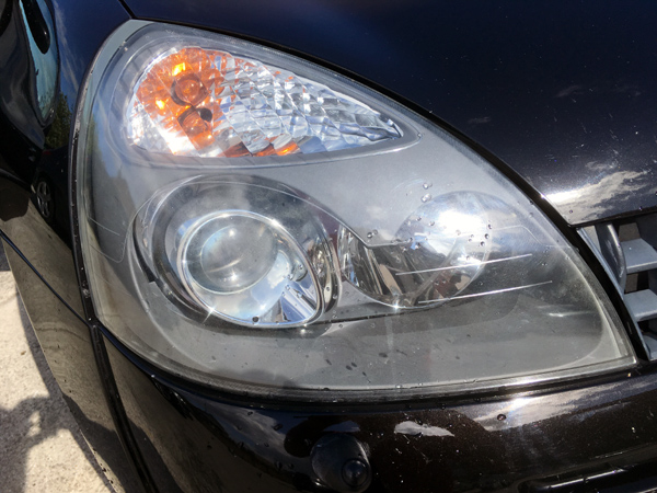

Had a go at headlight restoration today......................with toothpaste :tongueclosed:
Watched a few reviews on youtube, and a few appeared to get good results. Thought why not give it a go.
I got some Morrisons Whitening 'gritty' toothpaste for £1, wetted the headlight after a quick clean.
Then attacked it with a cloth, and a large amount of elbow-grease.
Not much was happening, so added some baking soda and I have to say, it has cleaned off some of the yellowing.(not really visible on the pics, but I can see some improvement)
Not going to muck about anymore though, going for the wet 'n' dry sandpaper or a proper resto kit next time :smile:

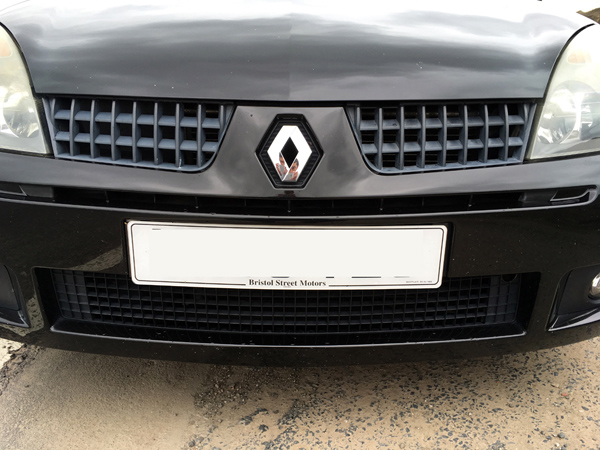

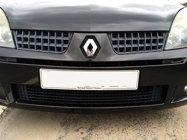

Fitted my smaller plate, cleans up the front nicely.

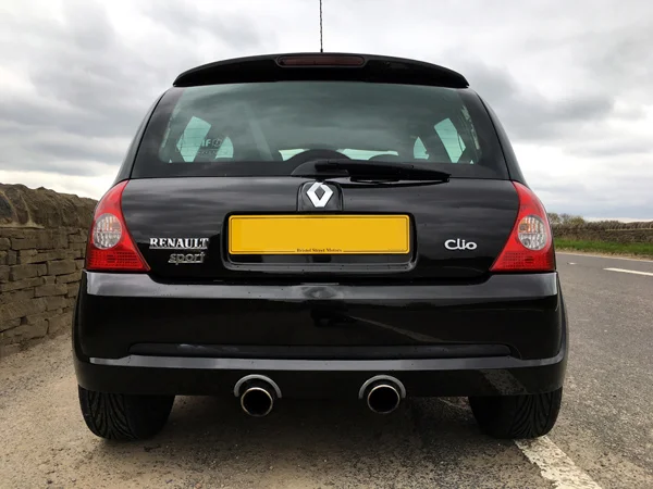

Also fitted one of the Powerflex exhaust mounts (N/S). The KTec S/S back box mounting hook doesn't fit 100%, as its obviously designed to replace OEM.
It has improved the tailpipe alignment, and more importantly the support is much, much, much better than the standard flimsy item.
I'll just have to get busy with a drill bit to make a small indentation (not cut) into the powerflex mount, so it all lines up perfectly.

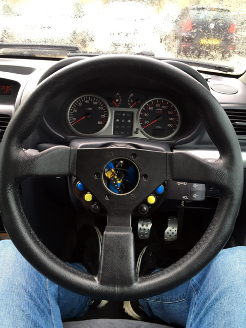

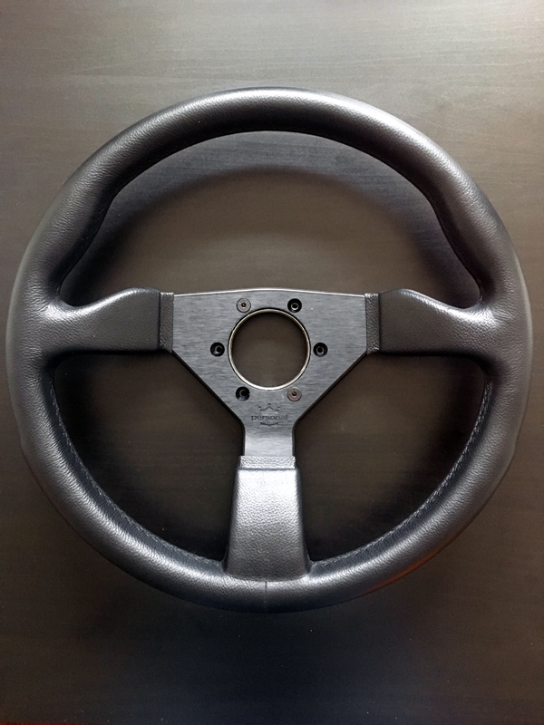

Personal Grinta Polyurethane wheel was delivered this week, along with a 12mm spacer so I can mate it to a Sparco/Momo hub :)
Ordered a hub from Ktec today so hopefully get this fitted next weekend
Jon46
  BG FF 182

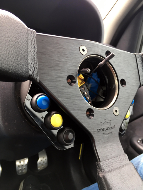

Fitted the Grinta wheel today.
Its made such a difference over the standard wheel.
Gripping hold of something that feels like a wheel, rather than a fridge door handle :smile:
Fitting was very simple, I followed a guide written by LeeRS :up:
Once the battery was disconnected, it was all done in about 45 minutes.
KTEC hub fitted like a dream, splines matched up perfectly.
Trickiest part was sorting the airbag resistors, and the horn. Took a bit of fiddling to get the resistors seated properly.
Then as I pushed the horn into the wheel centre, it short circuited, and I had a very small ploom of smoke 😊
No drama, quickly took it apart and found the burn't wire. My fault, trapped the horn (live) wire against the hub as I pushed in the horn.
I've ordered a cruise control unit from @iamjoel so will investigate once I get this next week :smile:

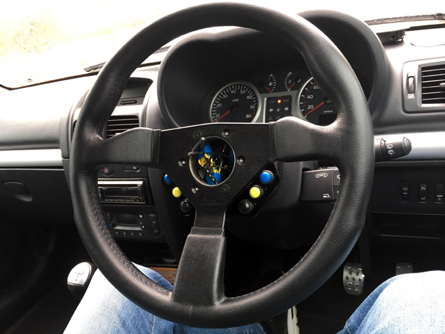

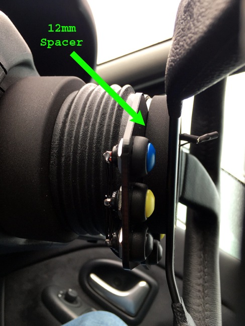

Got my cruise control assembly from @iamjoel this week, really pleased with it, Thanks Joel :up:
The quality is very, very good. Wiring all nicely soldered to the 6No button's, which means I have 4 simple connection's to make. 2No for the horn & 2 No for the cruise control :cool:
Sadly I could only test fit it today, as the extra thickness of the assembly (3-4mm), mean't that the supplied Personal steering wheel bolts didn't seat into the hub properly.
I got all 6No to bite, but only 1 -1.5 full turn's each. I'm not going to drive the car with a wheel like that :tongueclosed:
Easy fix, I'll order longer allen bolts when I find out the exact pitch and size.
Because I have a Personal wheel, the 6No bolts are rotated 30 degrees, compared to the more common Sparco/Momo wheels.
I spoke to @iamjoel about this, and he can do modified assemblies.
I got his standard version, so I have to place the 6No button assembly, behind the supplied 12mm spacer, so it's set back a small bit. (see the last pic)
This work's for me, because the design of the wheel, and @iamjoel assembly are at slightly different angles.
I can touch all 6No button's easily, no problem, but without the spacer they would have clashed.
I'm looking forward to getting this fitted properly, with longer bolts next week :smile:

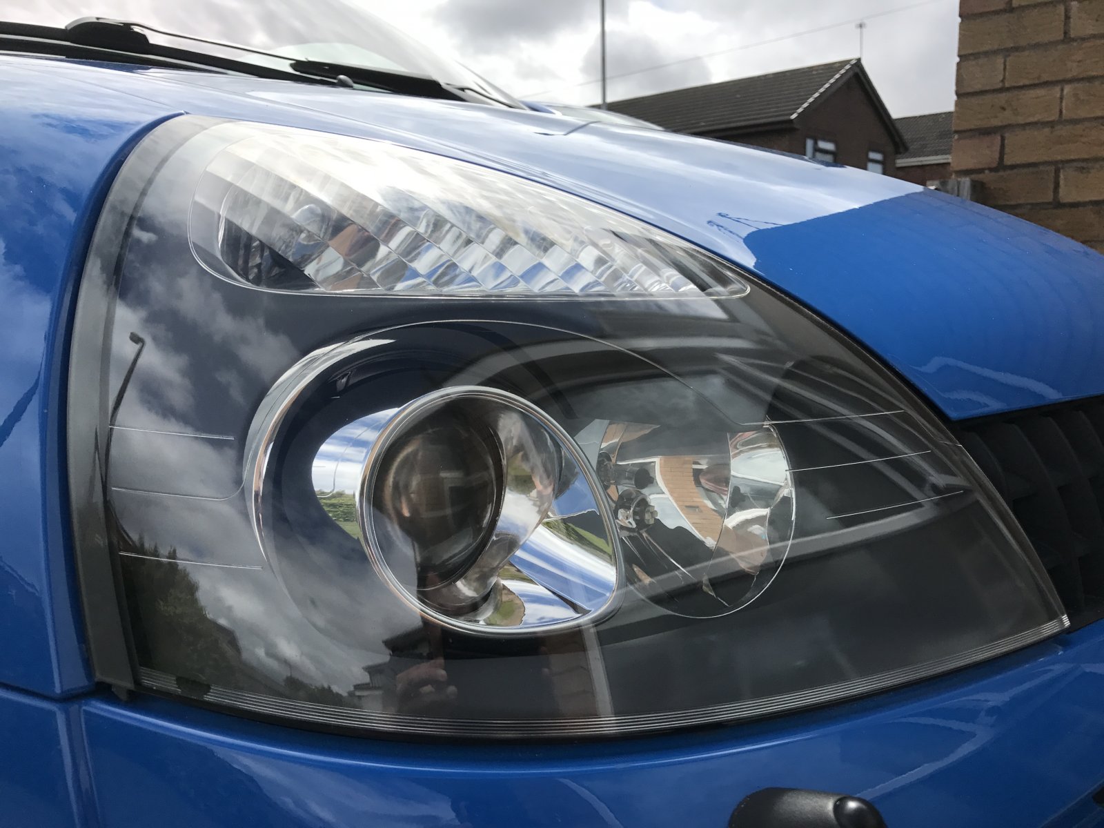

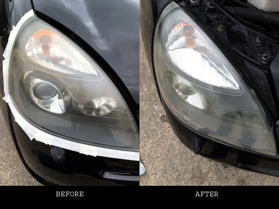

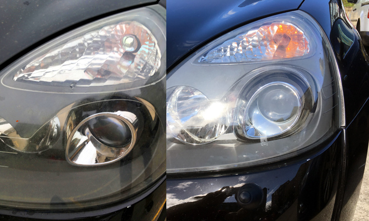

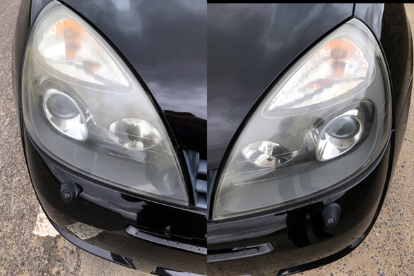

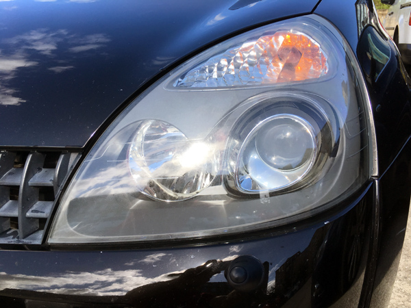

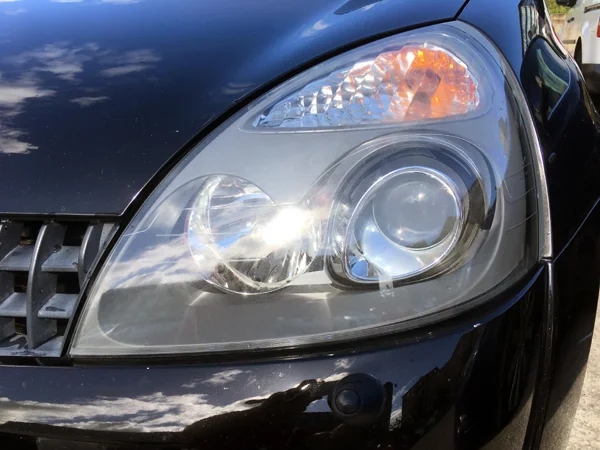

Did a headlight refurb today, and I was surprised by the results.
When I tried toothpaste :laughing: after watching too much youtube, I noticed both the outside and inside of the lense seemed damaged.
Bought an Autoglym resto kit and went to work.
If you're going to do this yourself, you'll need:
  • Cleaned & dried headlights - bucket, shampoo, hot water, towel etc.
  • Headlight restoration kit - Autoglym, M3, Meguiars or whatever takes your fancy.
  • Masking tape.
  • A combi-drill with a speed of 1200-1600rpm.
  • Half a dozen clean clothes.
  • Water bottle with trigger.
  • Patience and a steady hand.
The outsides feel very smooth, almost glass like. A small amount of discolouration is still evident inside the lights. But overall, I'm very happy with the results :)

After the headlight refurb, the orange indicators look pants. So I've ordered 4No Philips Silver Vision PY21W indicator bulbs, for the front and back. Plus smoked side repeaters and a new number plate light as the old one was looking tired.
Hoping it will freshen the look a bit, without going for the full LED approach, which does look good but I've been reading they can be troublesome.
They should all arrive this week, so I will fit them as soon as :grinning:

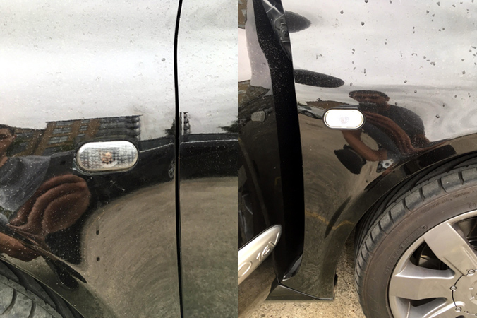

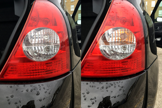

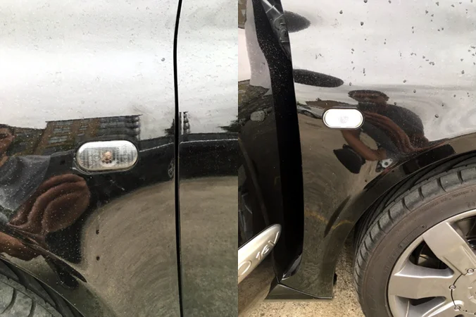

Finally got around to fitting the new bulbs today.
Got 2No pairs of Philips Silver Vision, all in they were £26 off ebay.
Got a pair of smoked side repeaters for the front wings too, from eurocarparts.
Also got a new number plate light too, old one was looking tired, I will fit this once the new brighter bulb turns up.
Side repeaters http://www.eurocarparts.com/search/477745051
The side repeaters need cutting down though. There are 4 small plastic fins, that support the bulb tunnel thingy. I butchered them with a stanley knife to get them to fit, easy and quick to do so no drama's.
Number plate light http://www.eurocarparts.com/search/482740011
Used the discount code and got the lot for less than£12.
Pics are a little too close, does look much better from a distance, very subtle, just what I wanted :smile:
The red around the new front is not from the bulb, its a reflection from a red car opposite.
