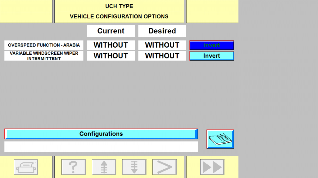

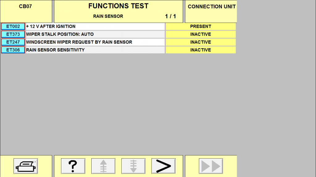

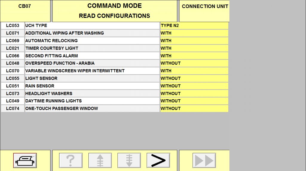

Fitted a rain sensor screen to my car, serial line to uch, electronic earth and the other one which is part of the system in the roof. Also got a rain sensor/variable wiper speed stalk.

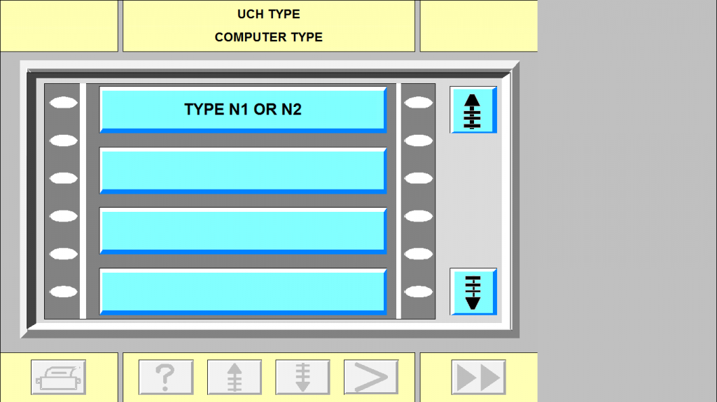

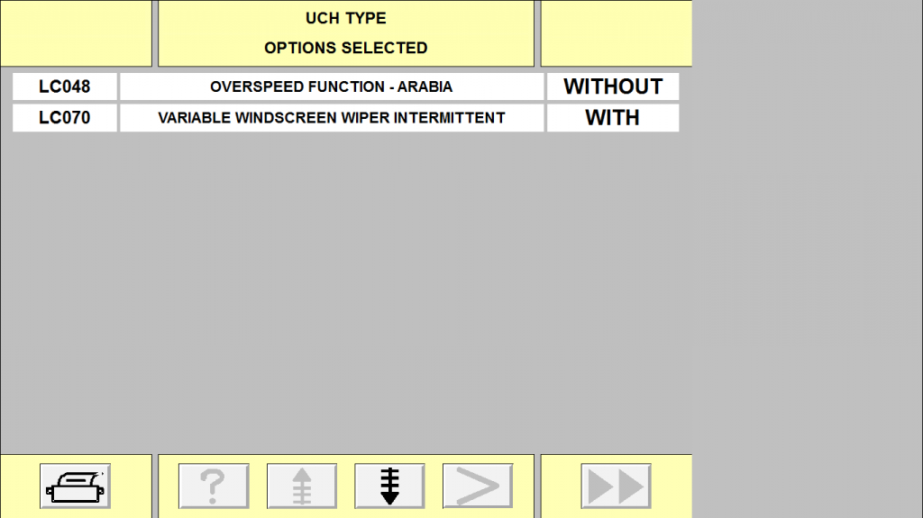

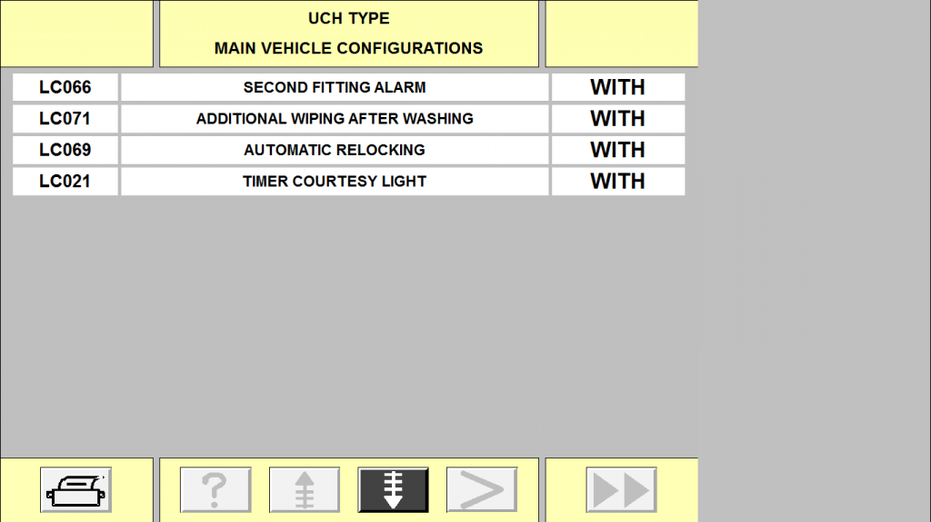

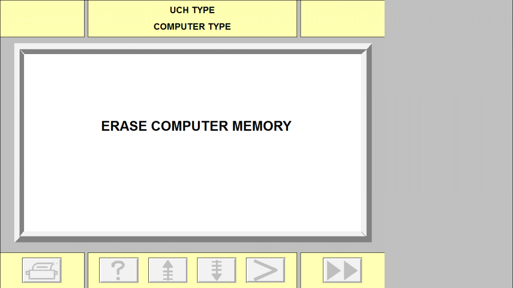

Gone into clip, says it's not set to have rain sensor which is what I expected. When I go to reconfigure it doesn't give the option to invert the rain sensor bit. Step by step below. Tried with ignition on and off
UCH is N2
Listings in the UCH actuators give the impression I can sort this with the computer!

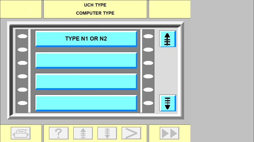

This is what I get in the rain sensor bit

Thanks Mick, thought that may be the case. I'll sort one out this week!
That solves that for anyone wondering then

Honestly didn't know it had to have an N3 for rain/light sensor

Good luck mate, I tried to get a 80 set from renparts and they haven't got a single N3 set in.
Hence why I got a new N3 uch which I don't need but Ahwell lol
