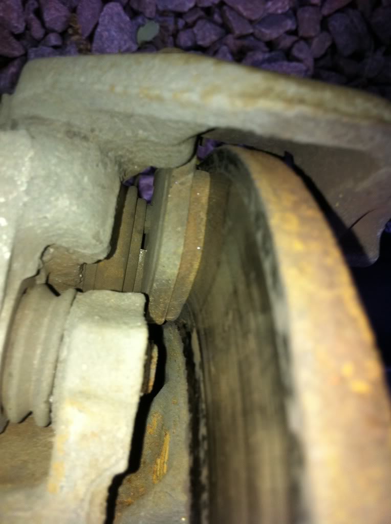

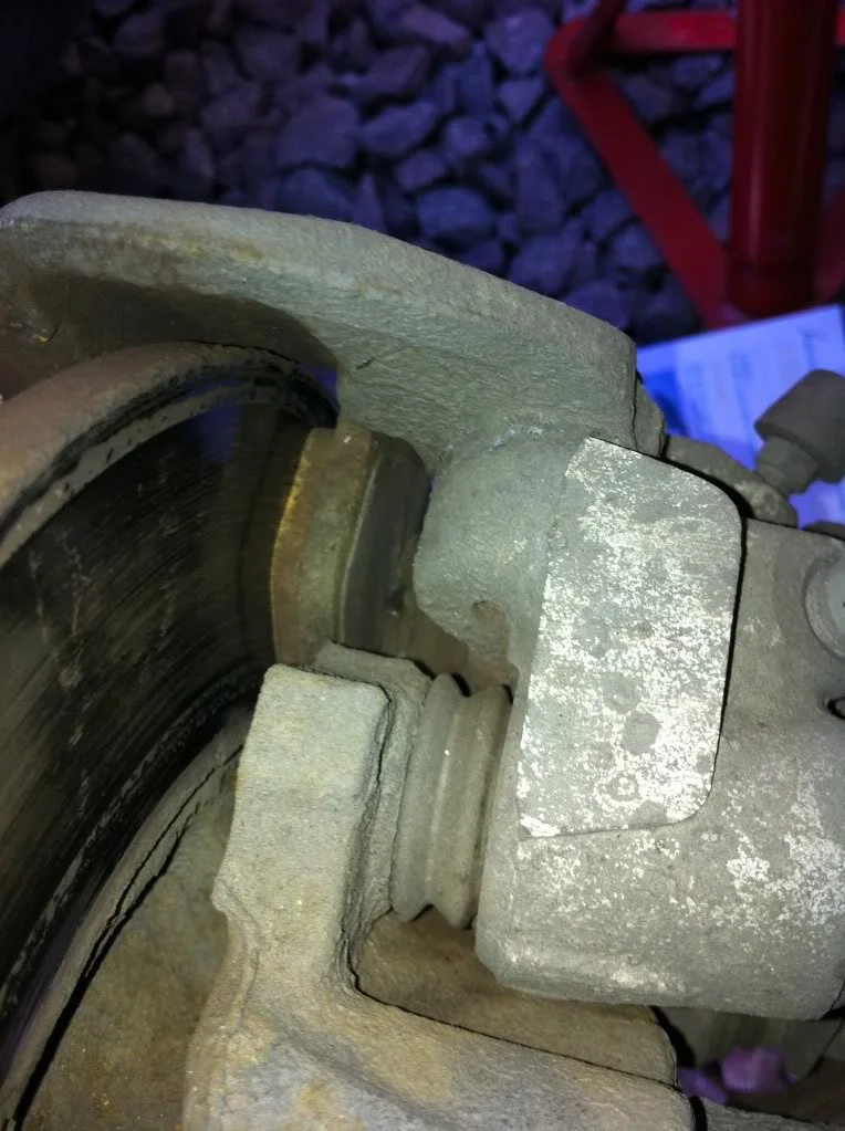

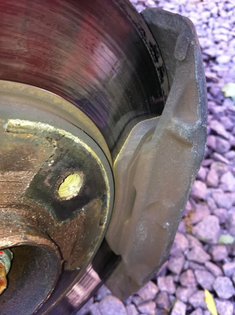

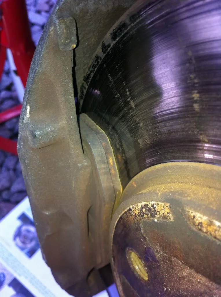

Had my MOT last week and there was an advisory that the rear brake pads were wearing thin. However when I had a good look at them they seem to be not even half worn? Is this right to flag them up on an MOT so early? Is it advisable to change them fairly soon?
Car is a 182 trophy and only on 30k.
O/S pads:
N/S pads:
  Dodgy one
your disks arent in teh best of condition, but the pads are hardly worn.

New they only have 6mm on them - loads of life left in them and all Renaults with this rear calliper setup seem to get picked up on this... nothing to worry about.
