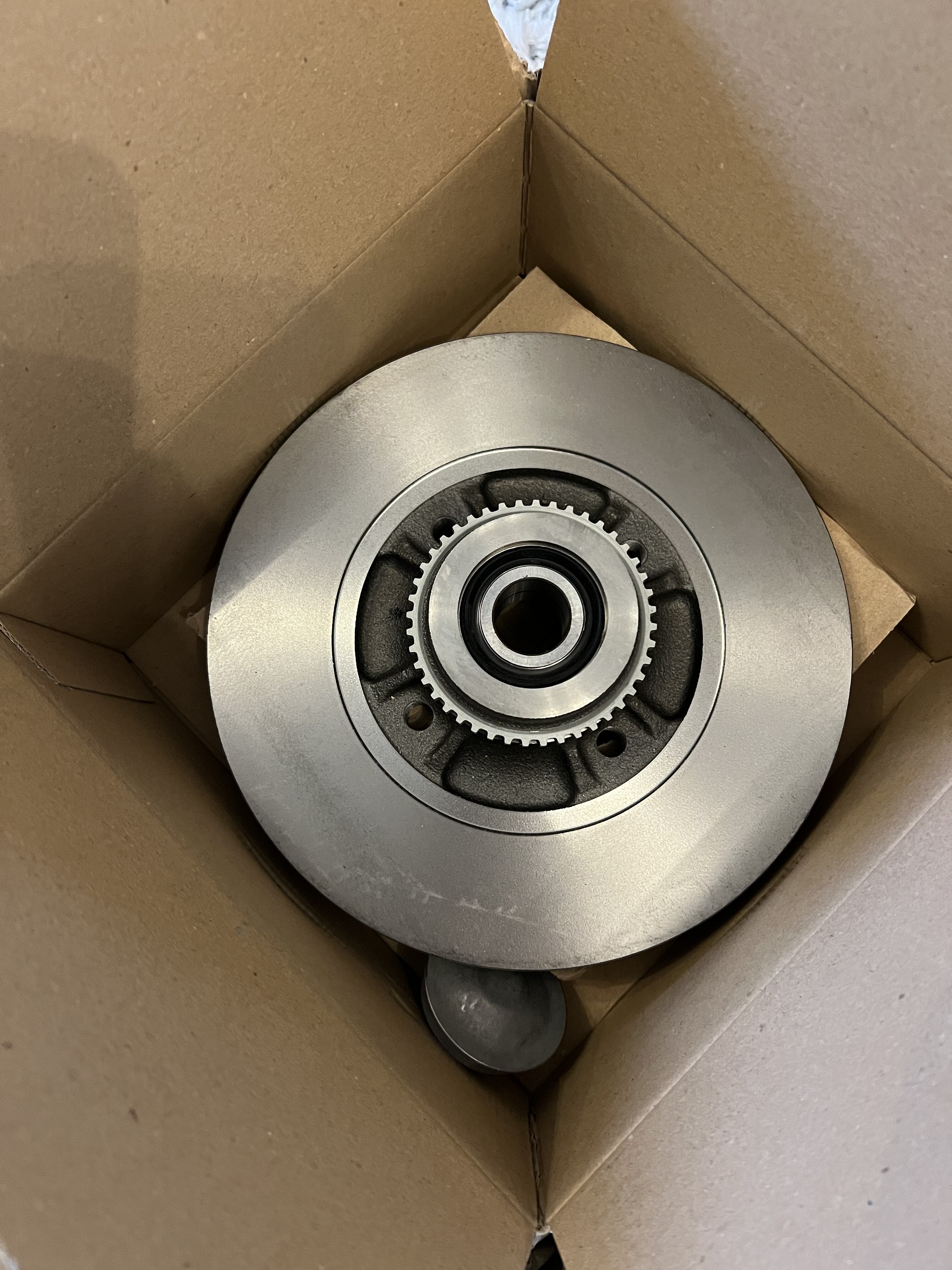

Can get the snr ones on autodoc for peanuts in comparison to the Renault boxed discs
I’ve just got a set myself. They’re always running offers. I paid like £40 odd quid a disc the other week

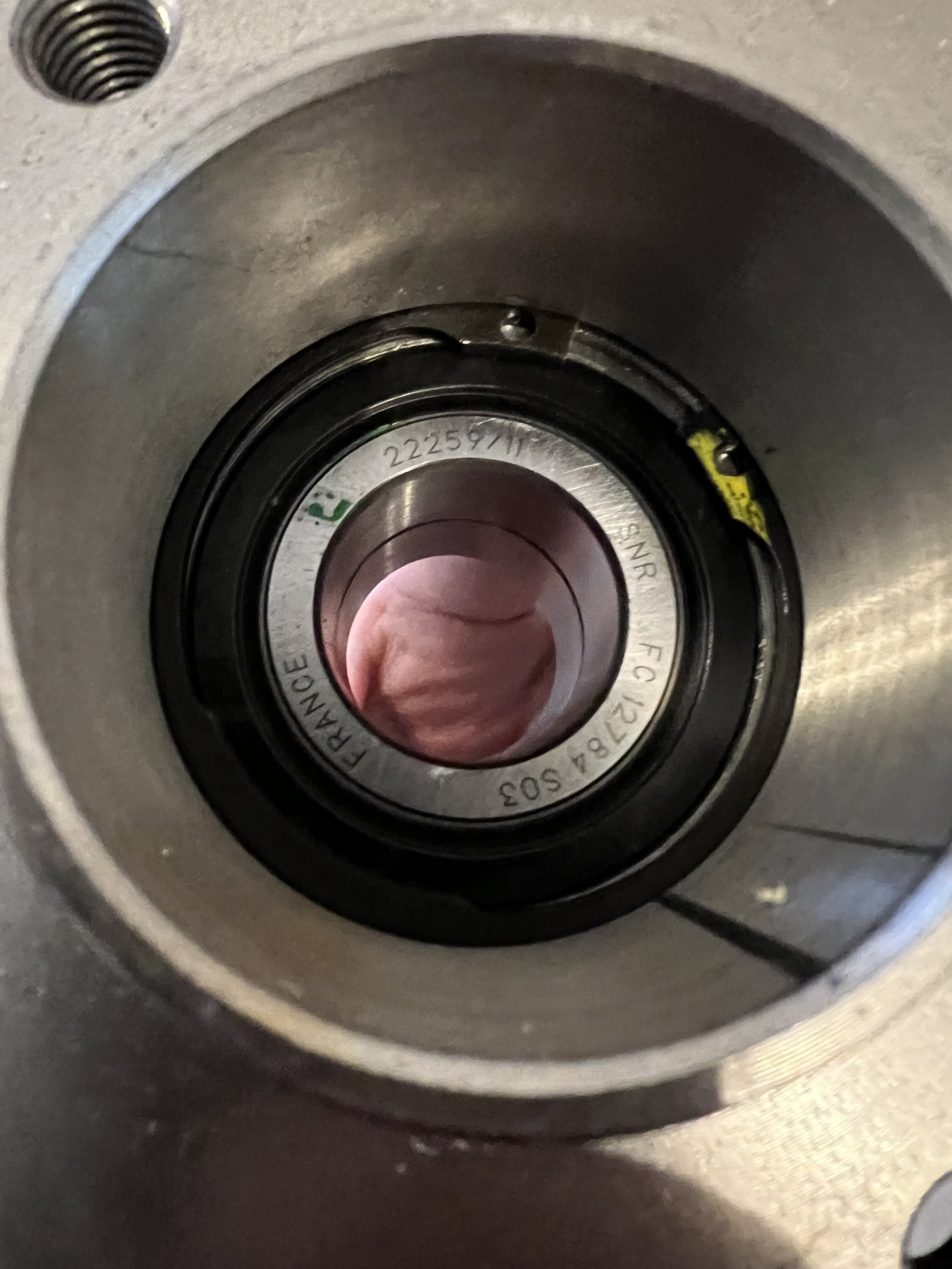

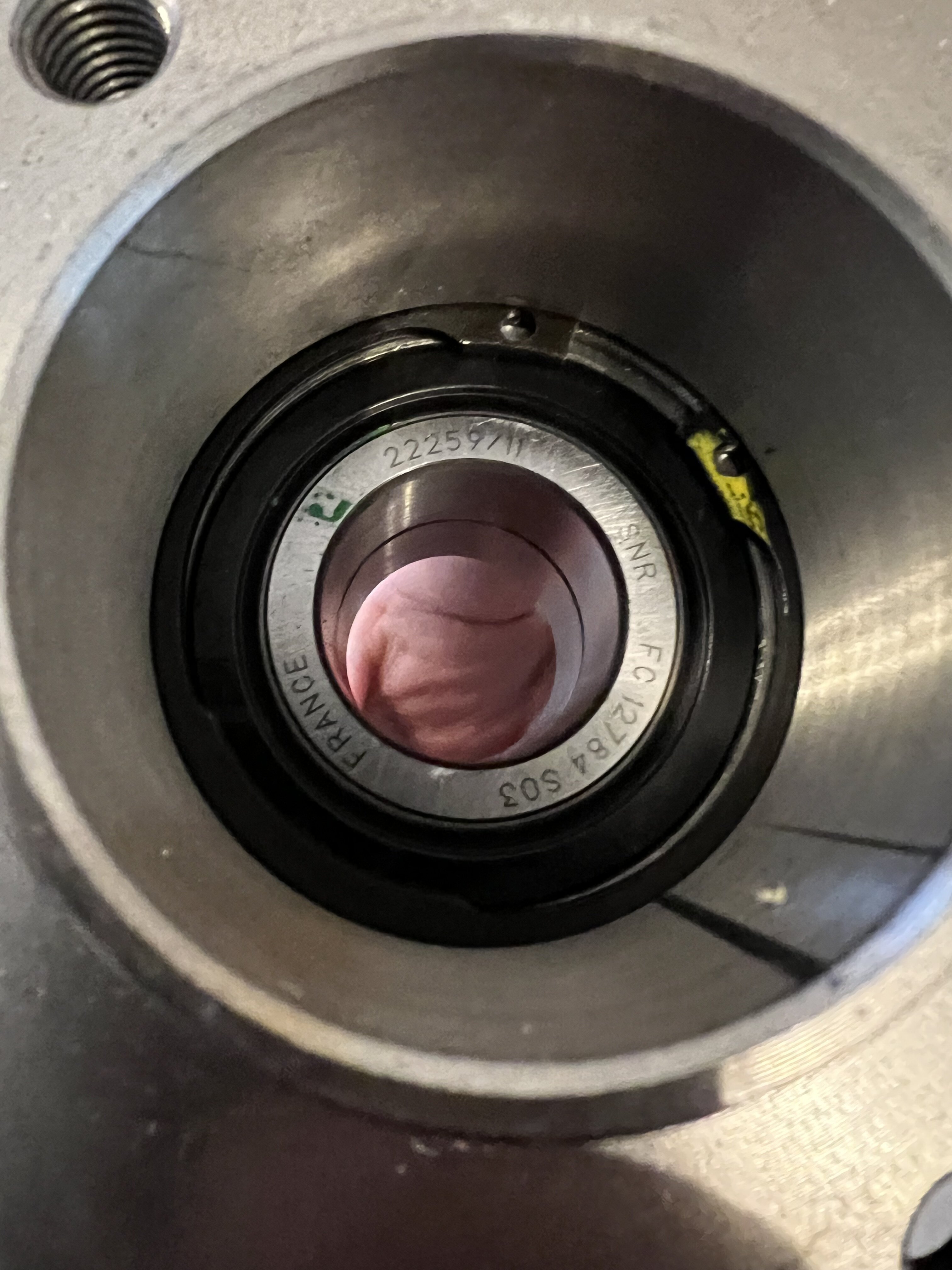

Did some background research with some people in the trade I know who say it is the same unit just reboxed. Disc has never been the problem really with rears, it’s the bearings that are crap as you well know.
The bearing is the same anyway so that’s one thing :)
The bearings are the reason I’m changing them to be fair. There’s hardly any wear on the disc.

All I’ve ever read is that snr make the oem bearings and they’re the only ones that last…
They are in the Renault boxed discs, snr (obviously) and the brembo’s apparently.

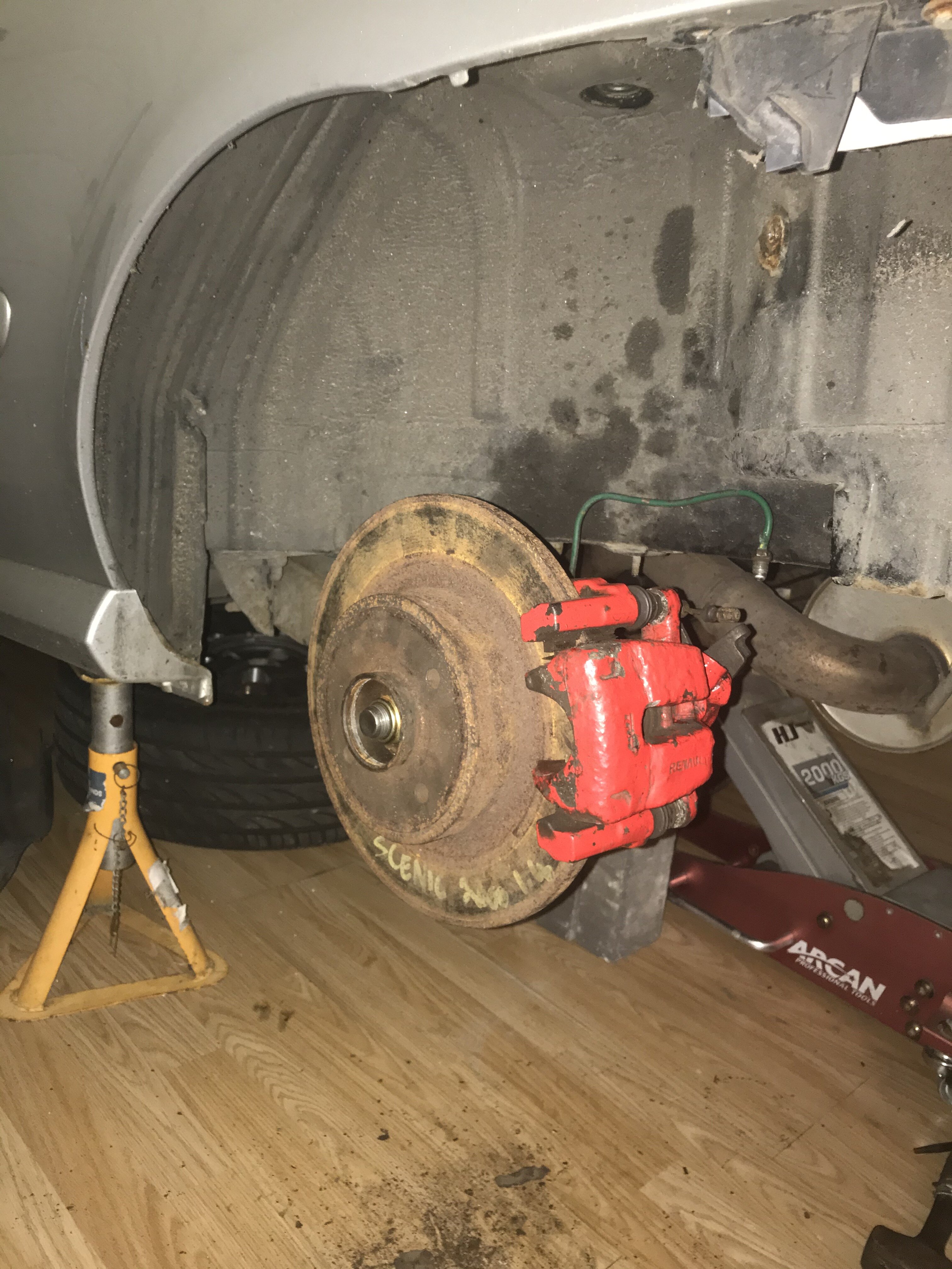

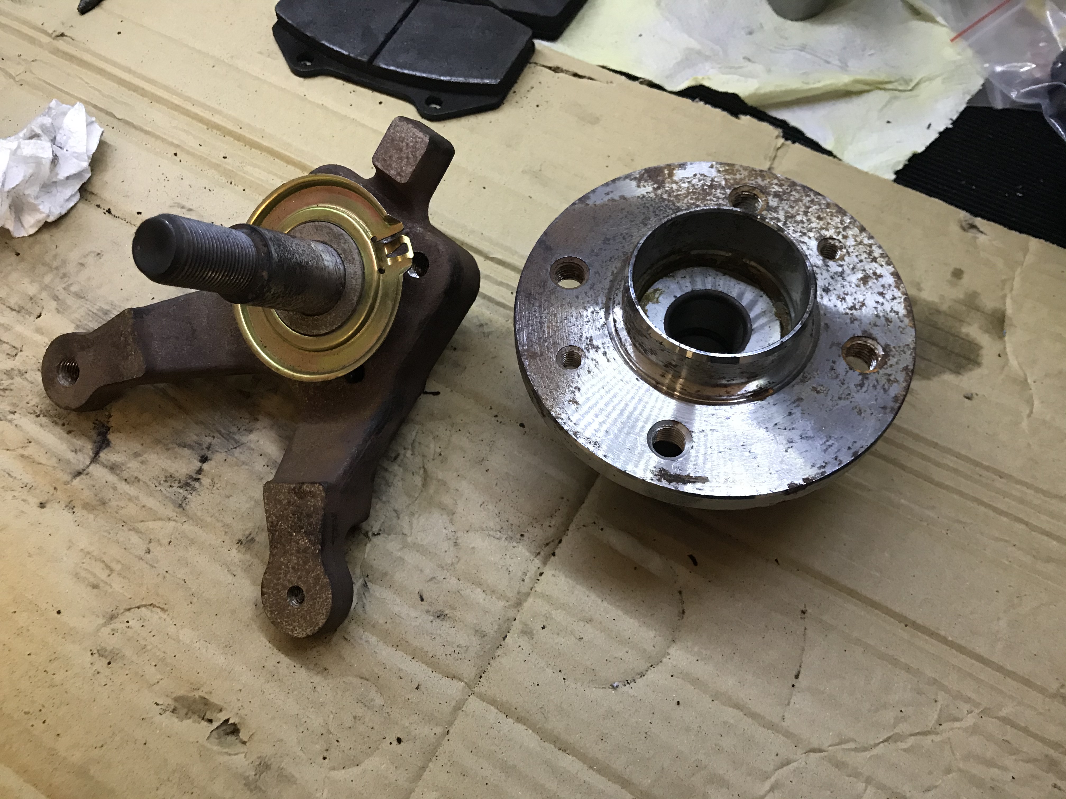

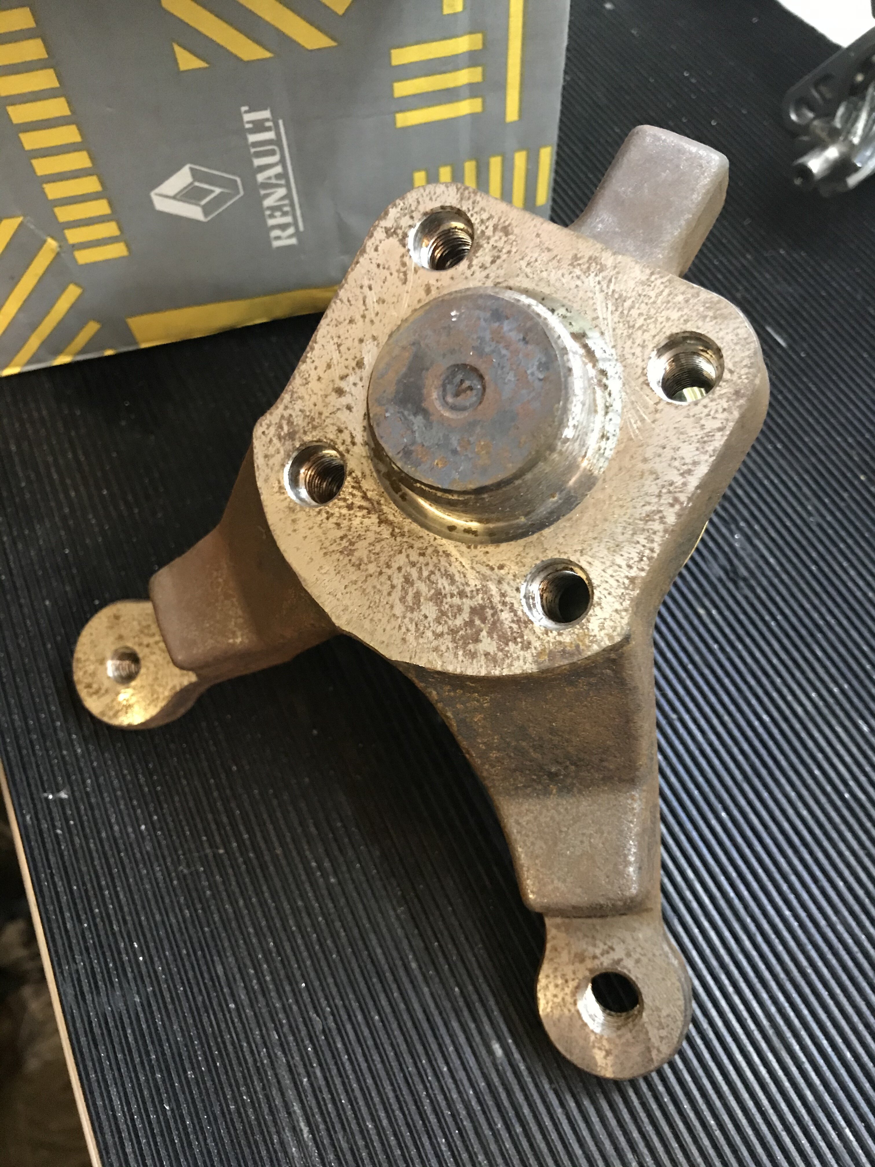

I have scenic stub axle and discs with larger bearings on the rears along with 197 calipers. I also have a new laguna stub axle and hub (separate disc to bearing) laying around, its the same fitment as the scenic. I heard they used the laguna setup on the cup racers because of the bearing going before the discs.

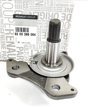

Any more details on this conversion? Is it a straight swap?
Beauvais Motorsport
You need to grind the bottom 2 mounting holes slightly in the beam. Its been a while so I cant remember about the lines but I made my own braided ones anyway. The o/s handbrake cable needs to be longer ideally for the scenic hub, not sure about the laguna hub.
The laguna setup is the best option because of the separate disc to hub, they have different calipers to the scenic setup which use 197 calipers.
Something to consider is the clio 3 (modus I think) rear setup which is a straight fit to the beam, uses similar size discs to standard but with bigger bearing. The same discs on the pms rear conversion.
Laguna mk1
Clio modus 8200386064 and 8200386063

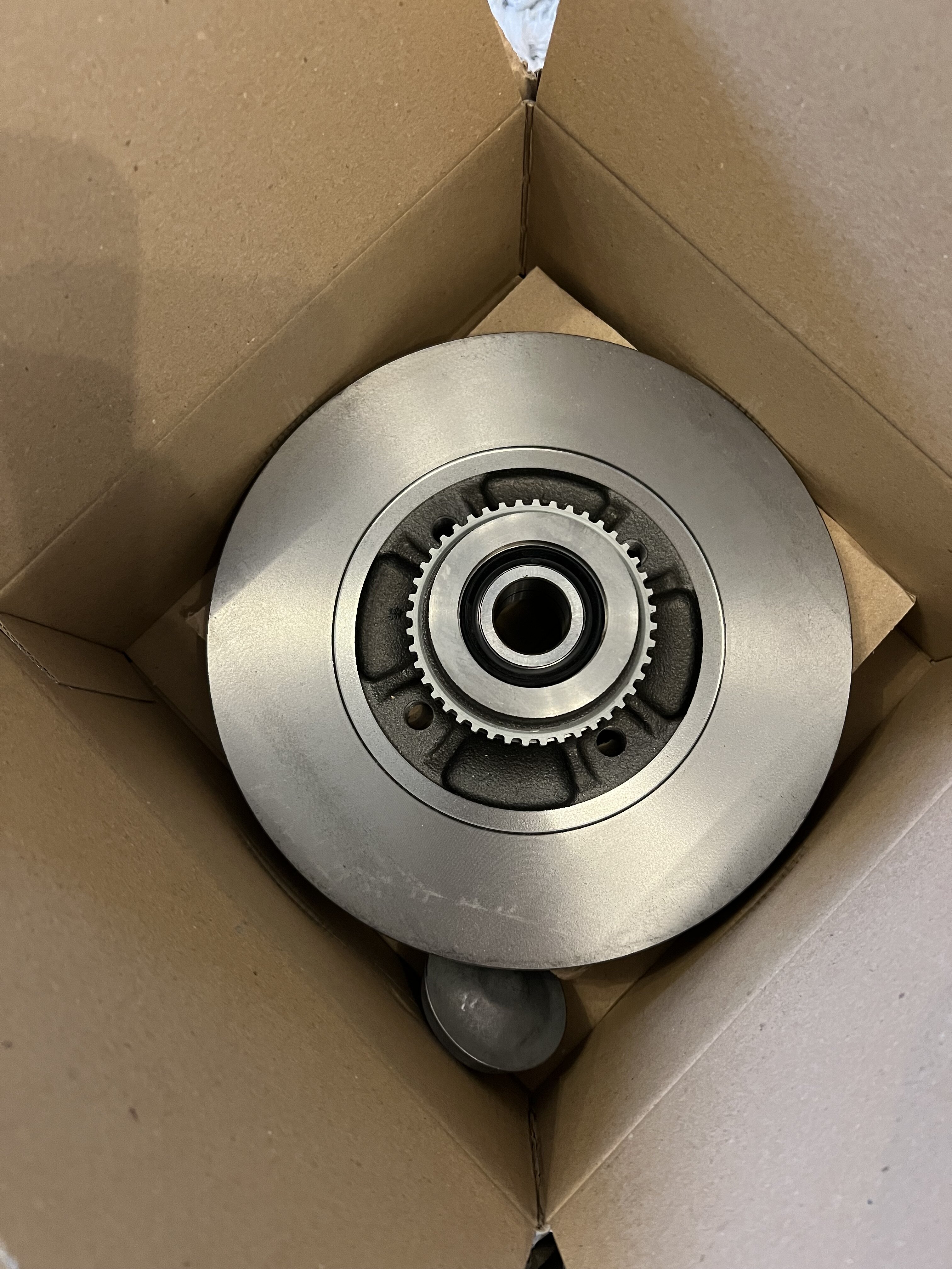

OK so I've gave up on waiting for the SNR ones, can someone confirm (08.5834.25) is the correct brembo ones? Ta
Mr Underhill
08.5834.27 is with ABS rings
08.5834.25 is without ABS rings but has been superseded with 08.5834.27, so those are the ones you need.
