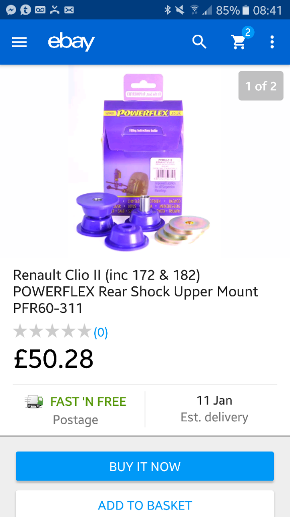

Hi,
I want to buy a set of Bilstein b14 for my 172 Clio and from what I've seen in pics, it does not come with the rear shock mounts like standard shocks. My shocks are oem since 2003 so the bushes may not be in a great shape. Only from Powerflex I could get a set? No stock available?
It is my daily car, so a little soft bushes are just fine.
Thanks
Radu

Or see if someone who's breaking a car will sell some but they may be in poor condition although the ones inside the boot will not have been in the elements so use those with yours.
