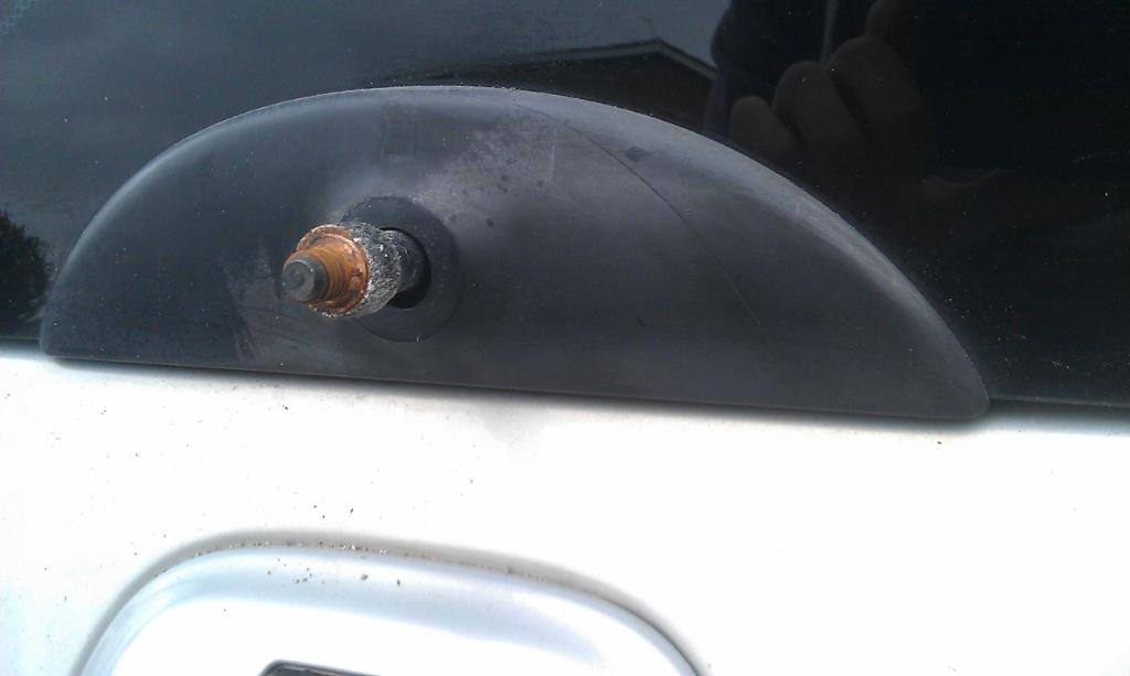

the wiper is already off the car..... i can see a big bolt behind the plastic sorround, how do i take that off?

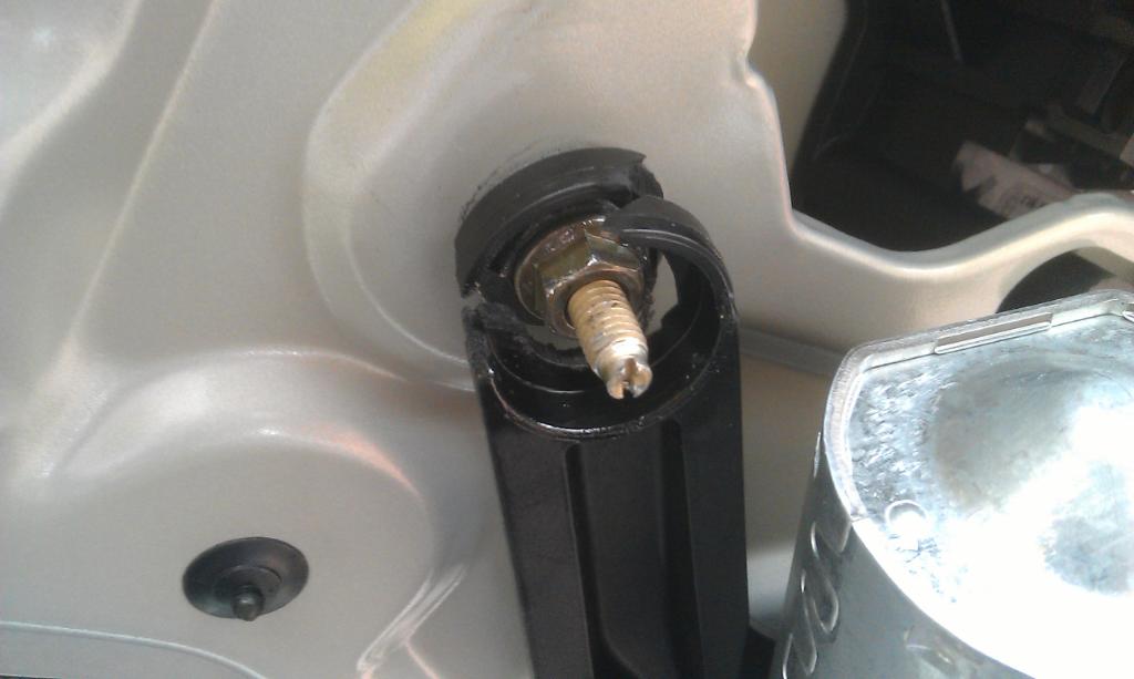

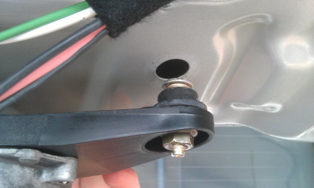

There's like a rubber washer thing stuck to the end of the bolt mate, I assume you've got the nuts off but the bolt is still stuck in the hole?
Whatever you do, don't pull it. This is what happened to one of mine :(
Managed to get a screwdriver underneath the other one and squeeze the washer through the hole:
Hope that helps mate :)

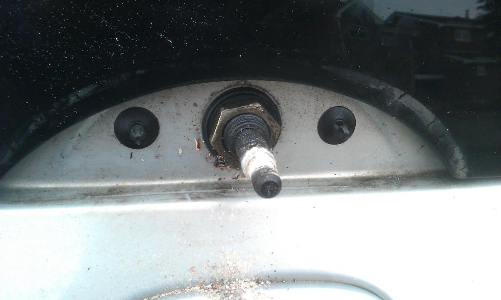

You see in the first picture there is a little metal thing stuck on the shaft? Get a pair of grippers and twist it off. Then you can get to the bolt (like in the second picture)
