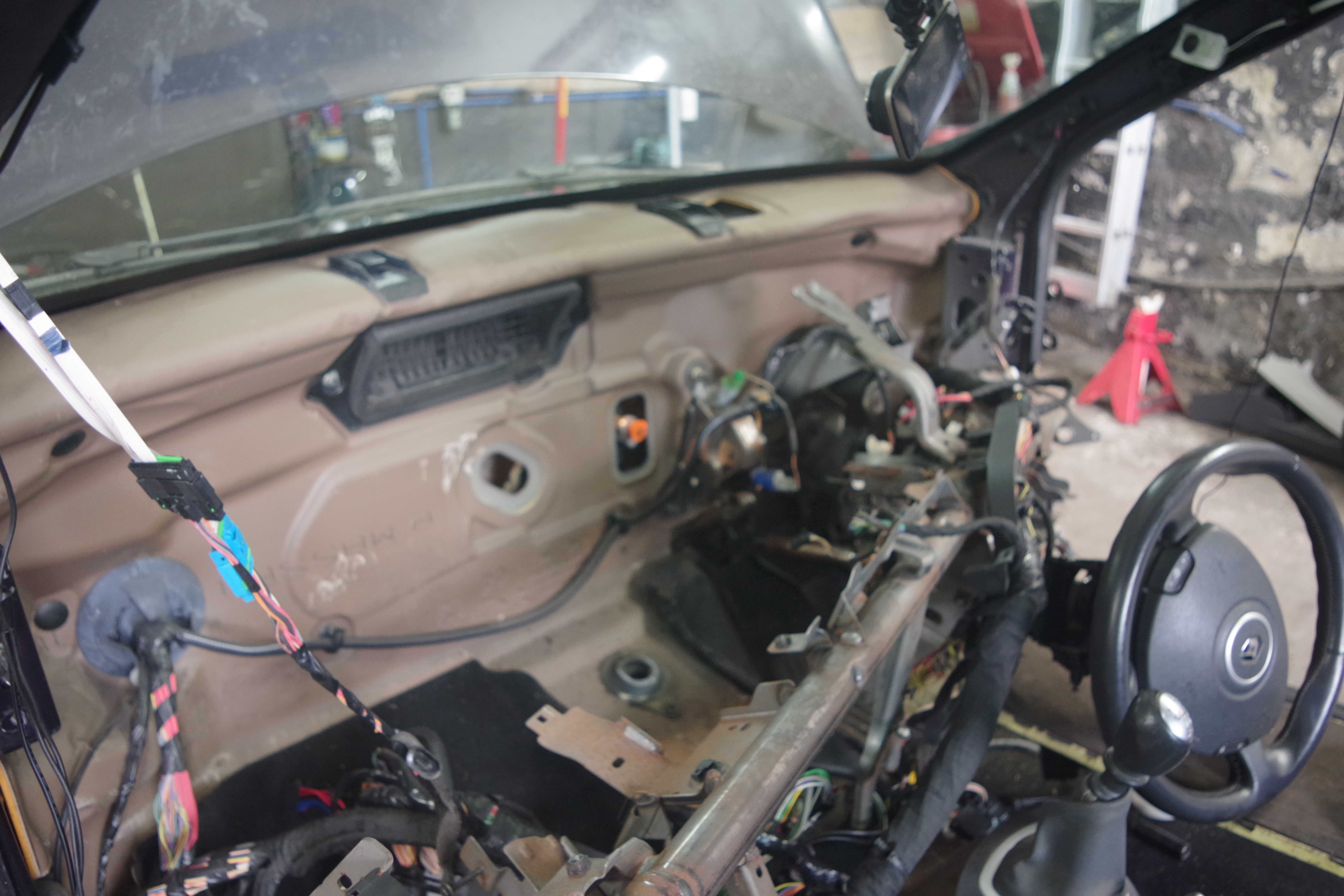

More progress today. Stripped out the ribbon cable network in the roof/headlining than runs to the cabin air temp sensor. It's part of the interior lighting/sun visor lamps network that plugs into a black and a blue socket on the lh windscreen post, hope my car has those plugs in place, but lacking just the 2 connections for the sensor. The roof lights are idenical to both cars.
I'm assuning the unused plug on the rh screen pillar of the parts car is for the rain sensing wiper system which it lacks?
Going to be cutting thro the crossbar to get the HVAC unit out, too much hassle to remove the doors and wings to access the fixing bolts!

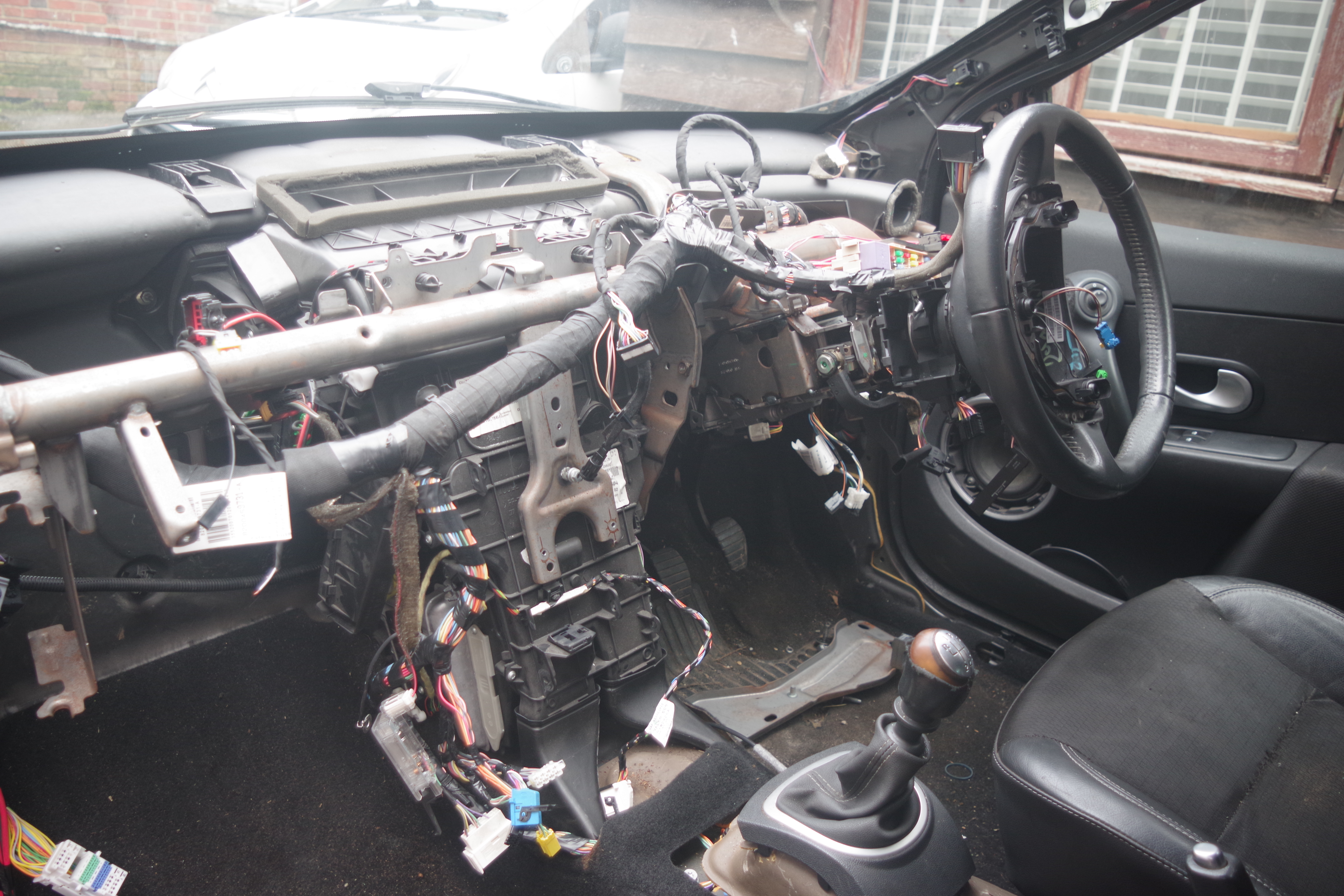

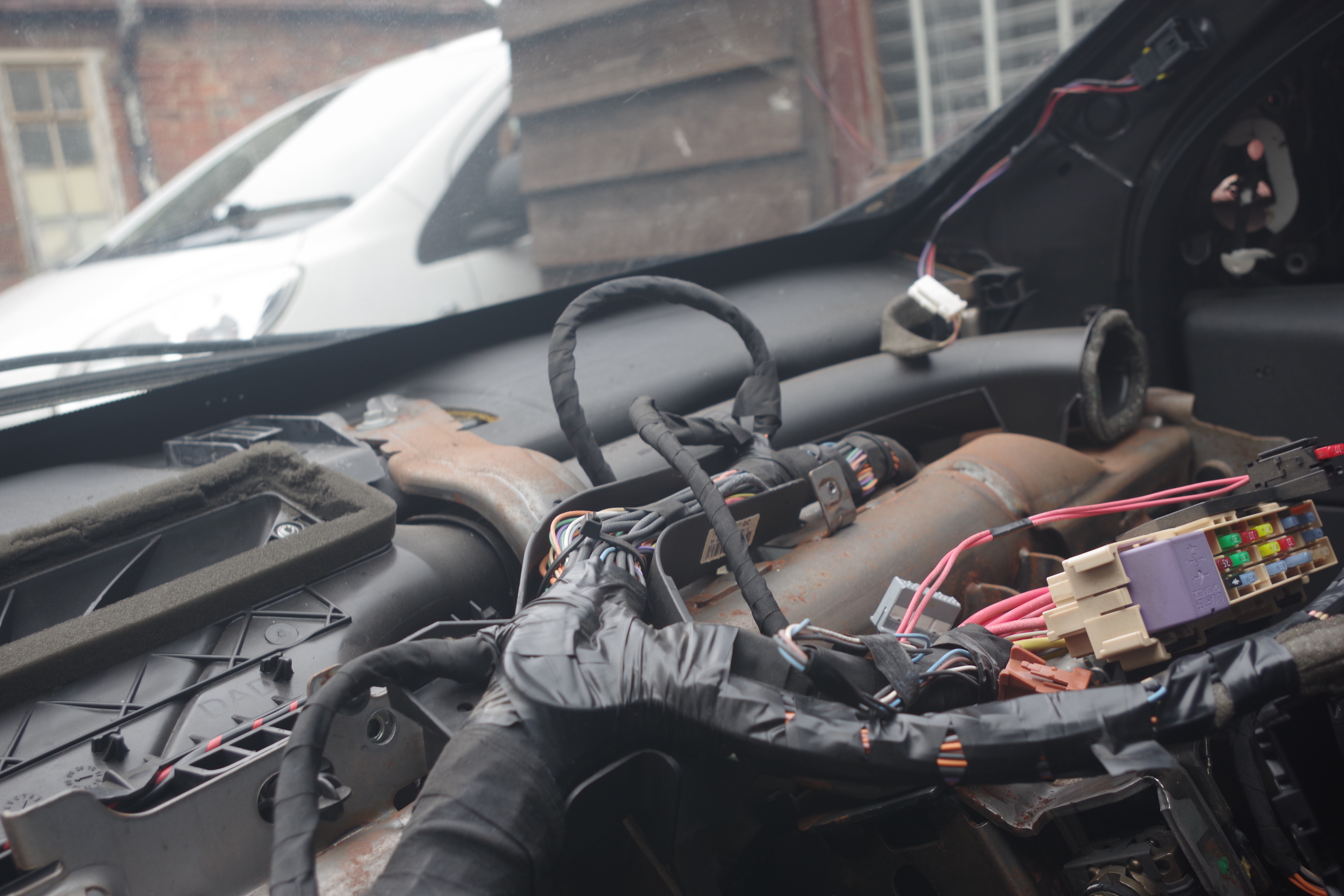

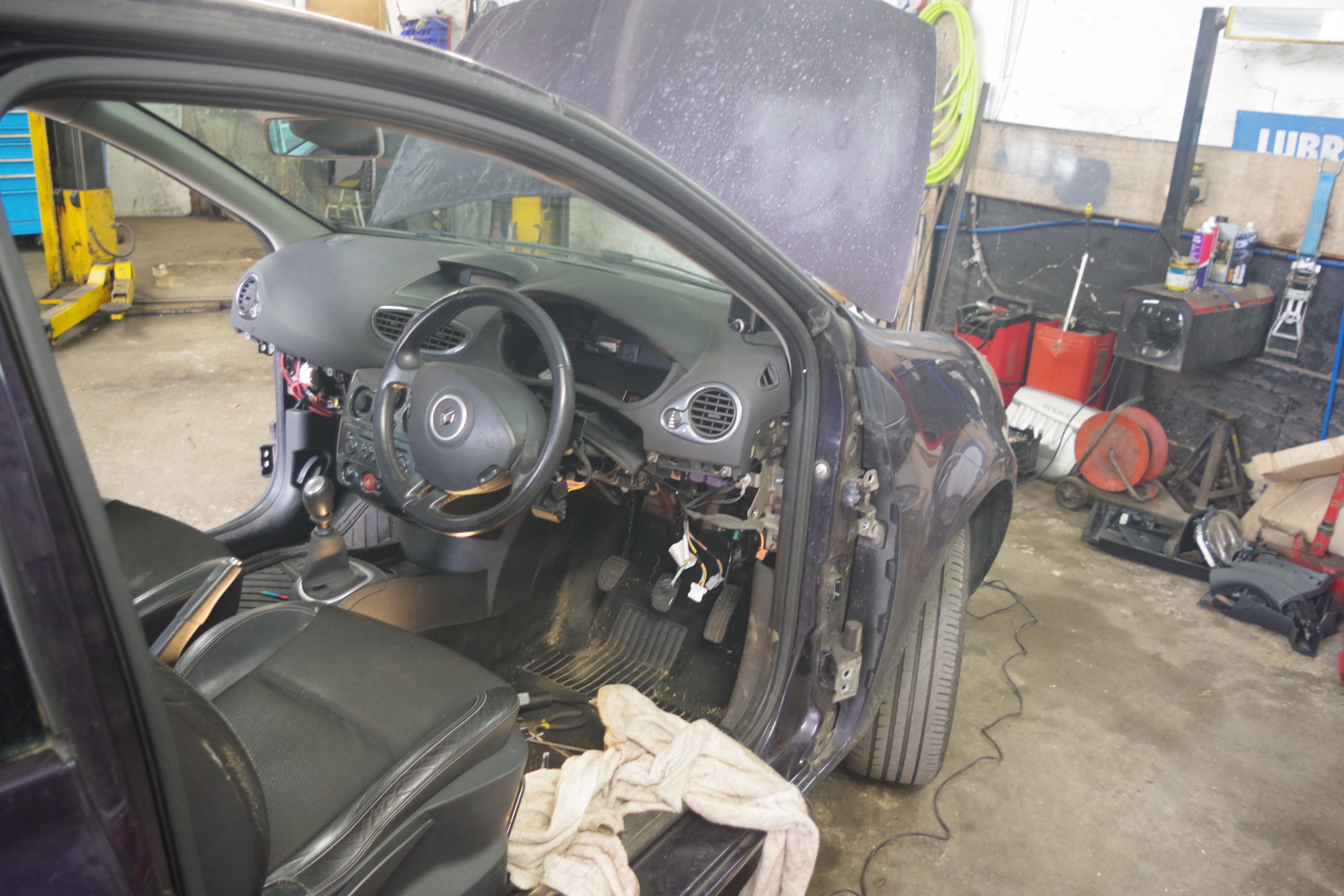

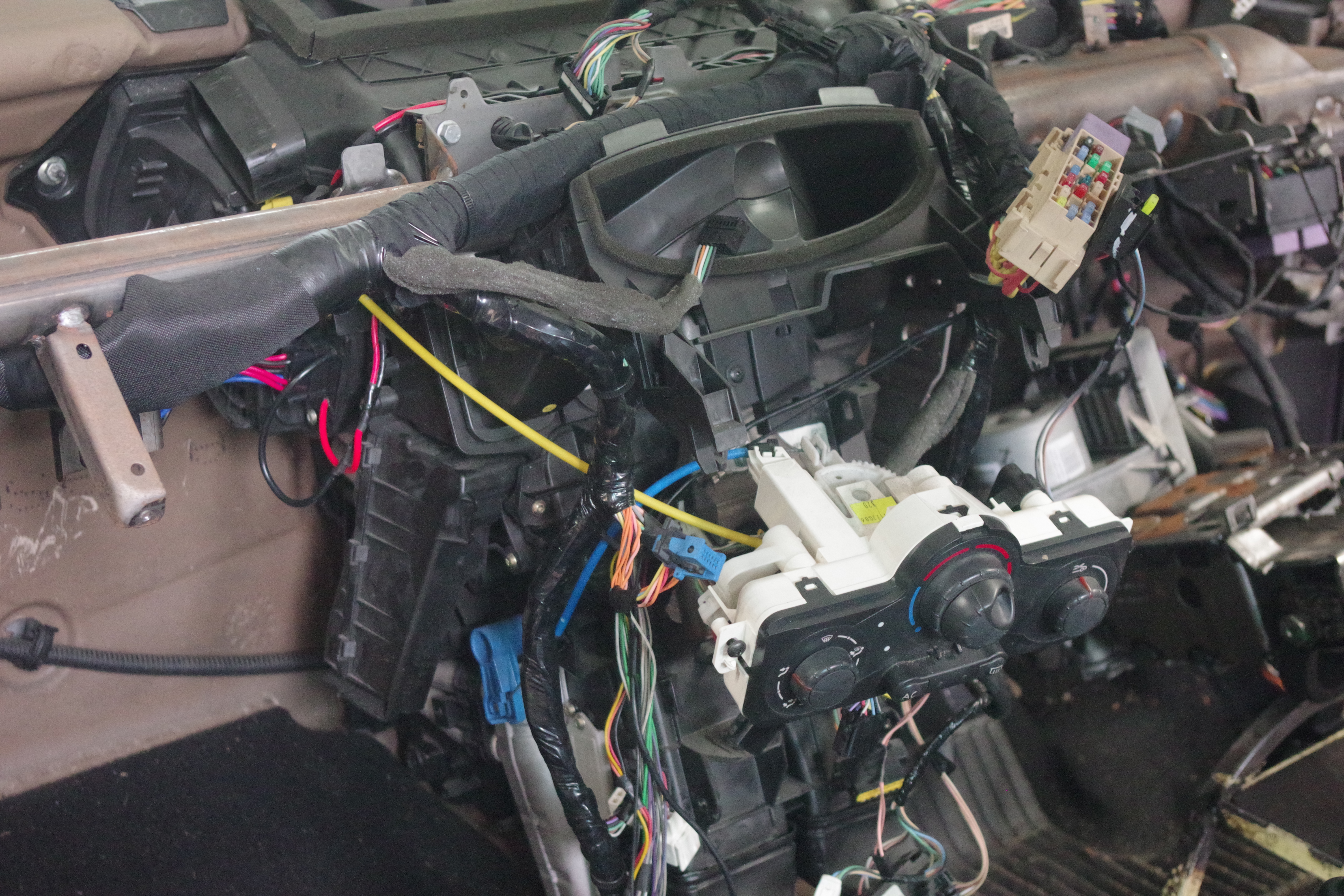

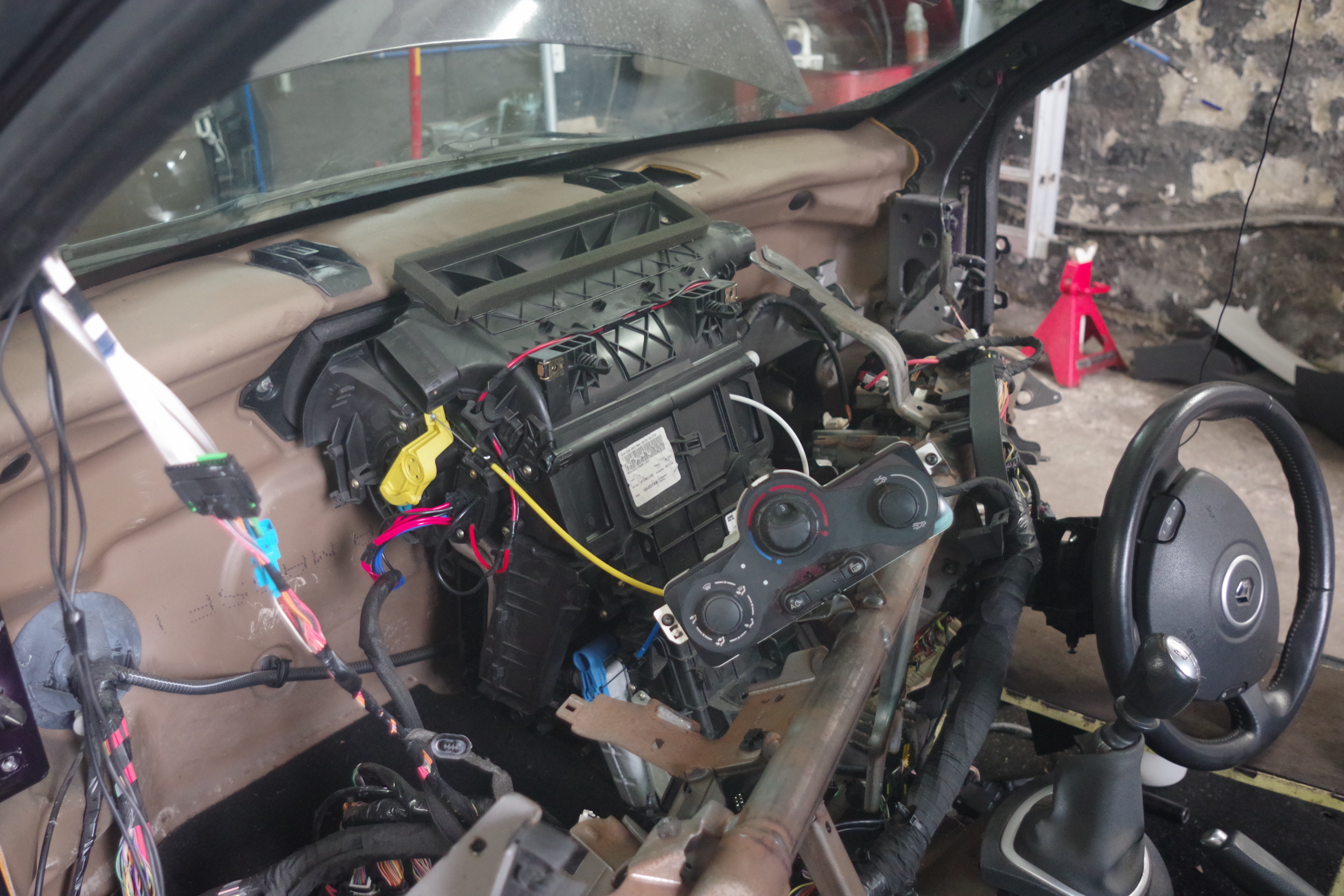

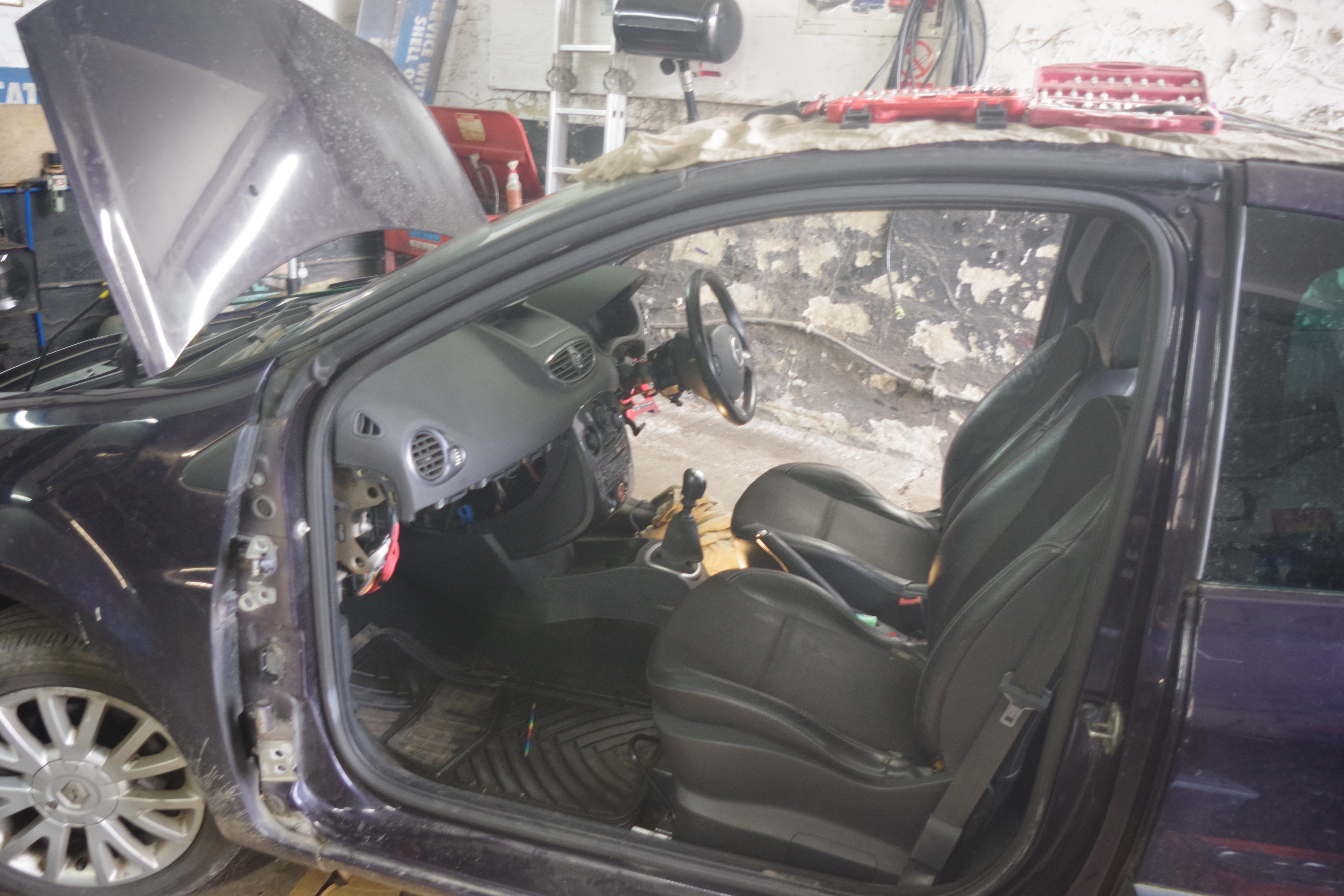

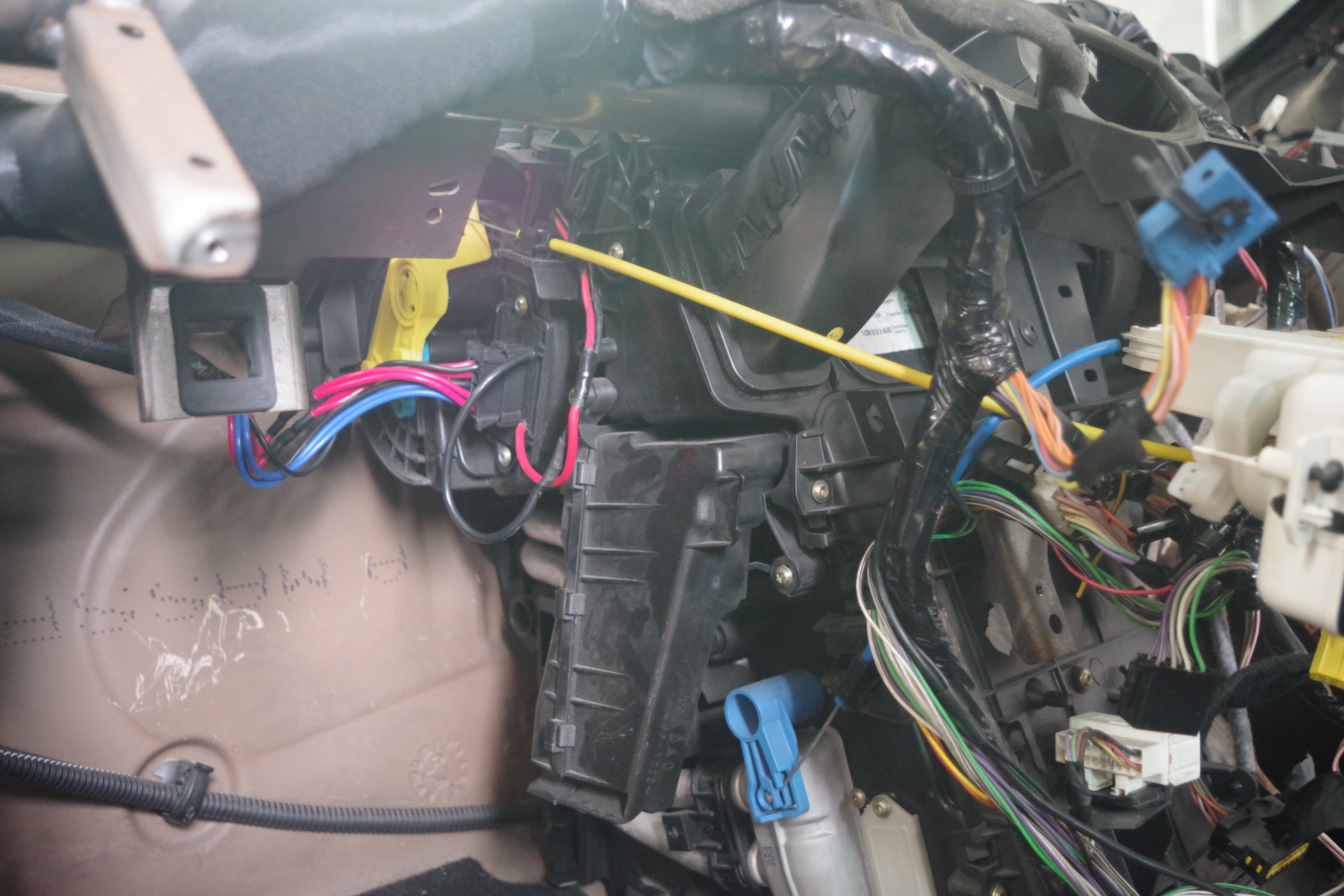

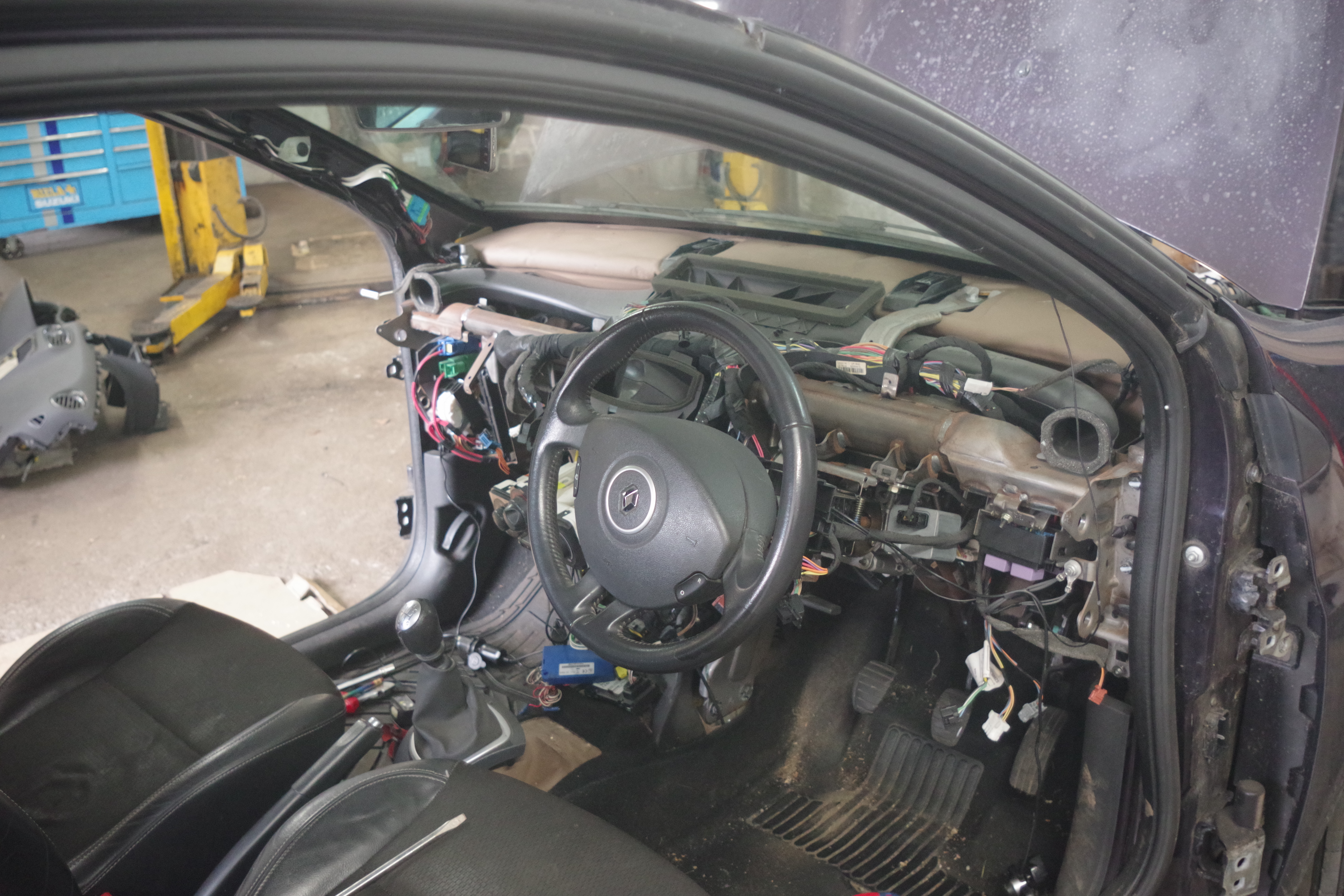

A few pics of work in progress gutting the donor car.

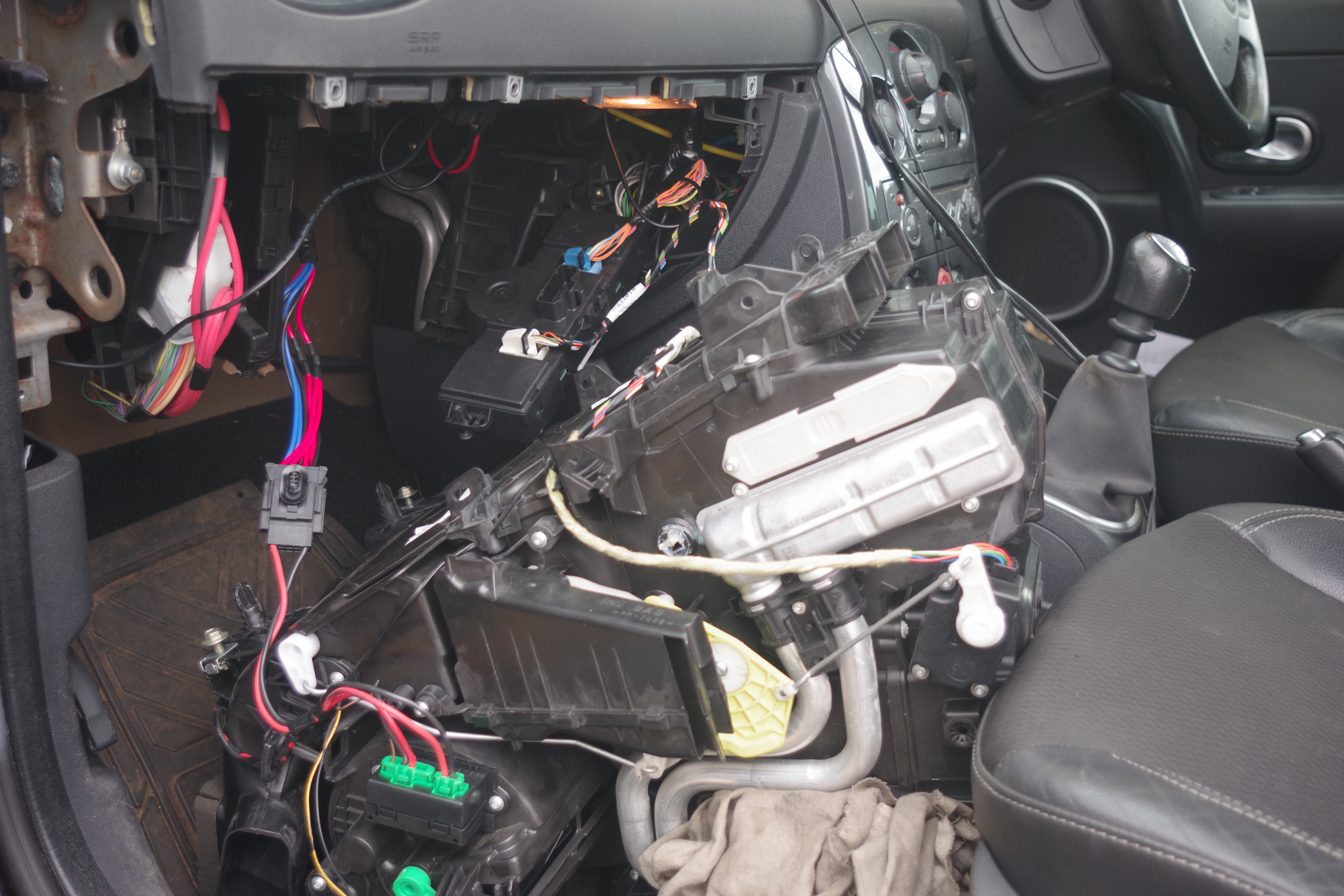

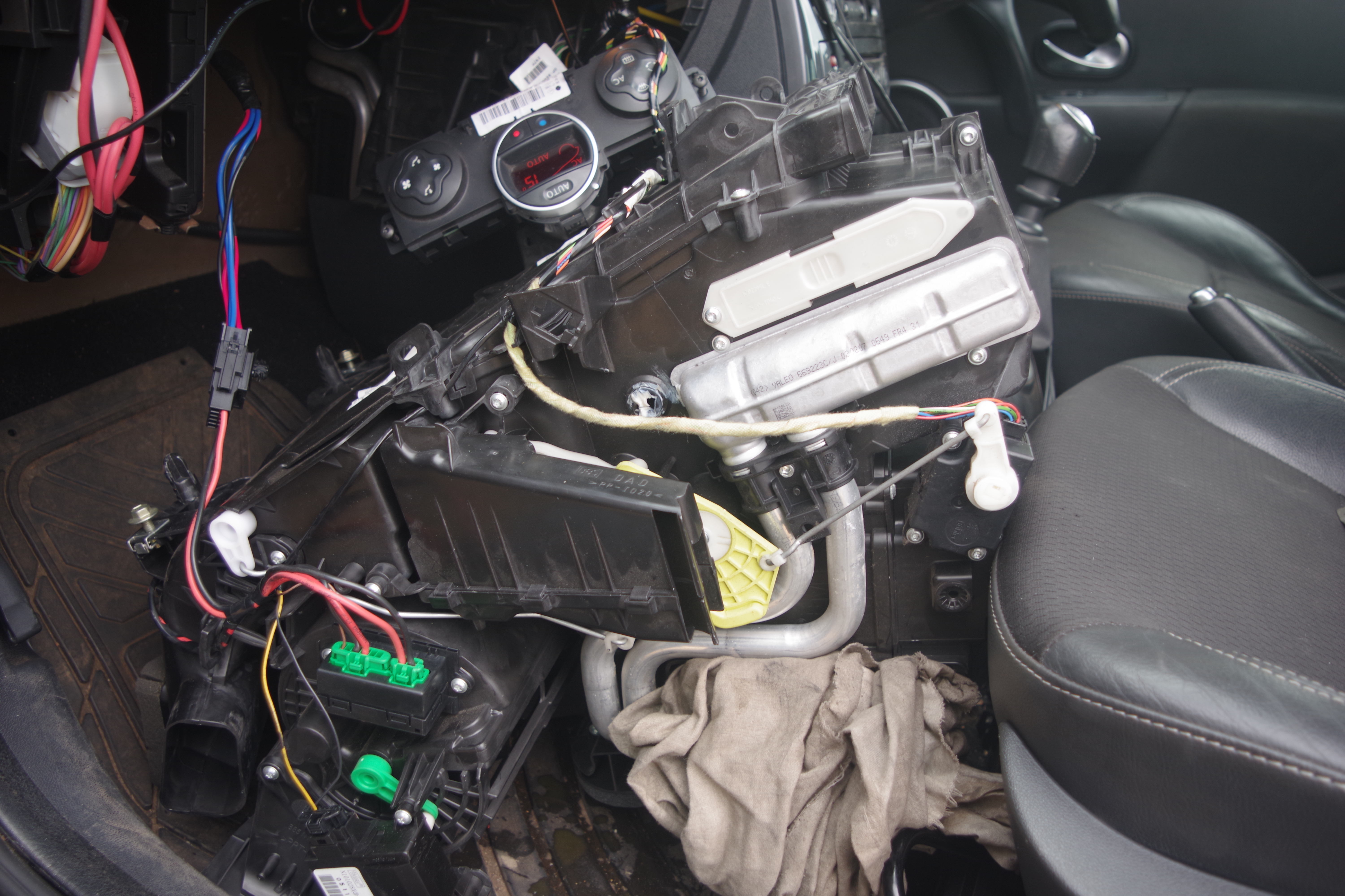

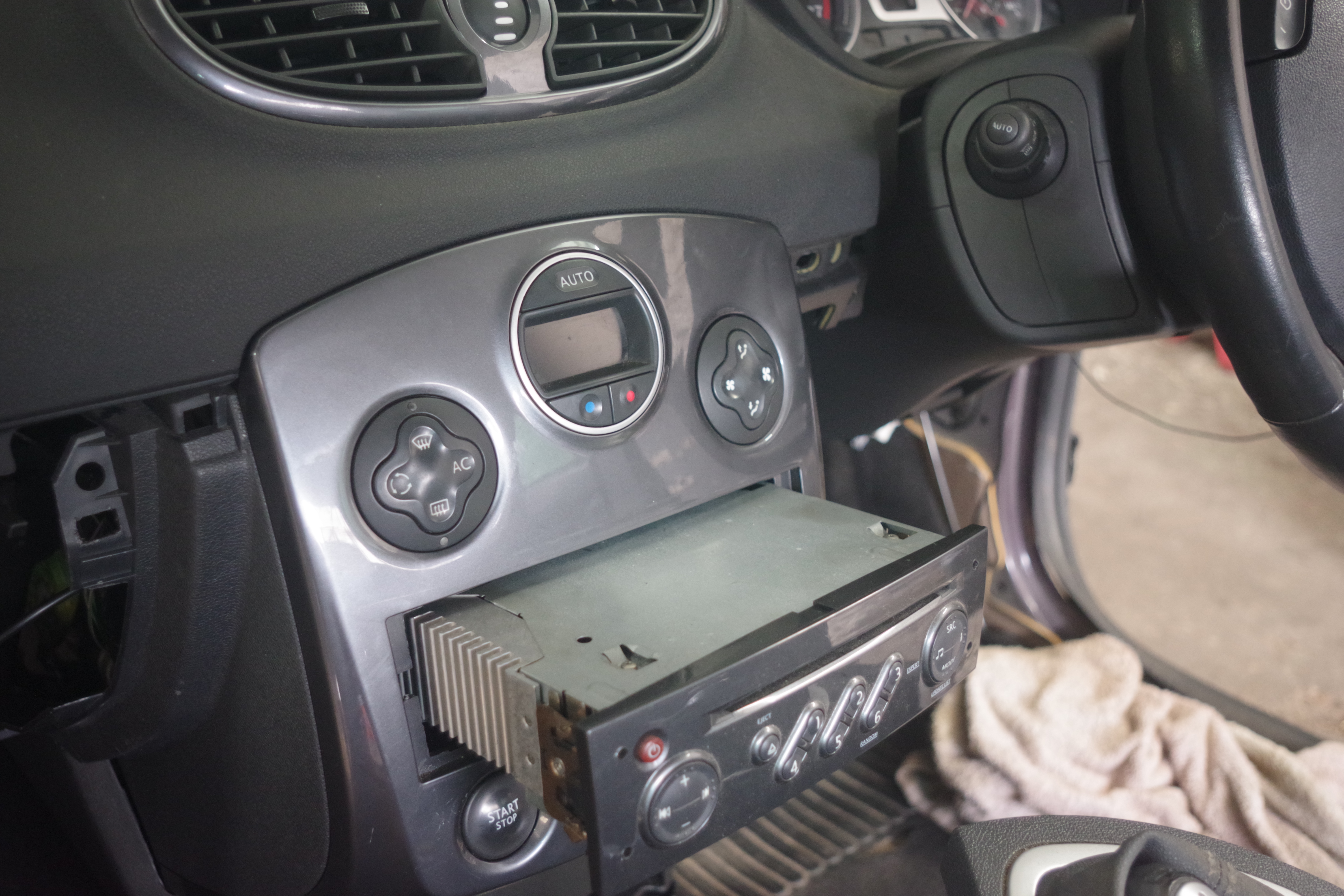

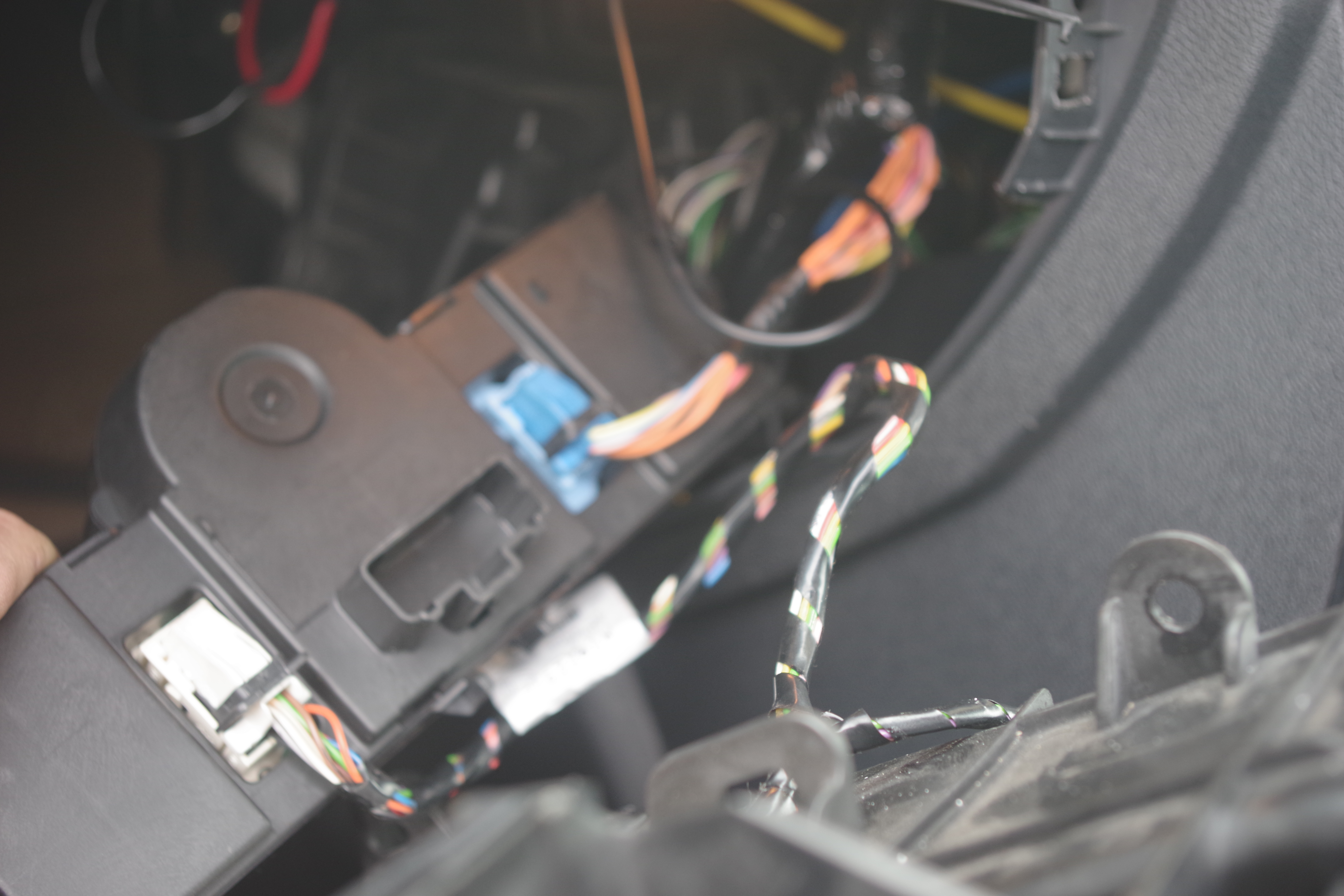

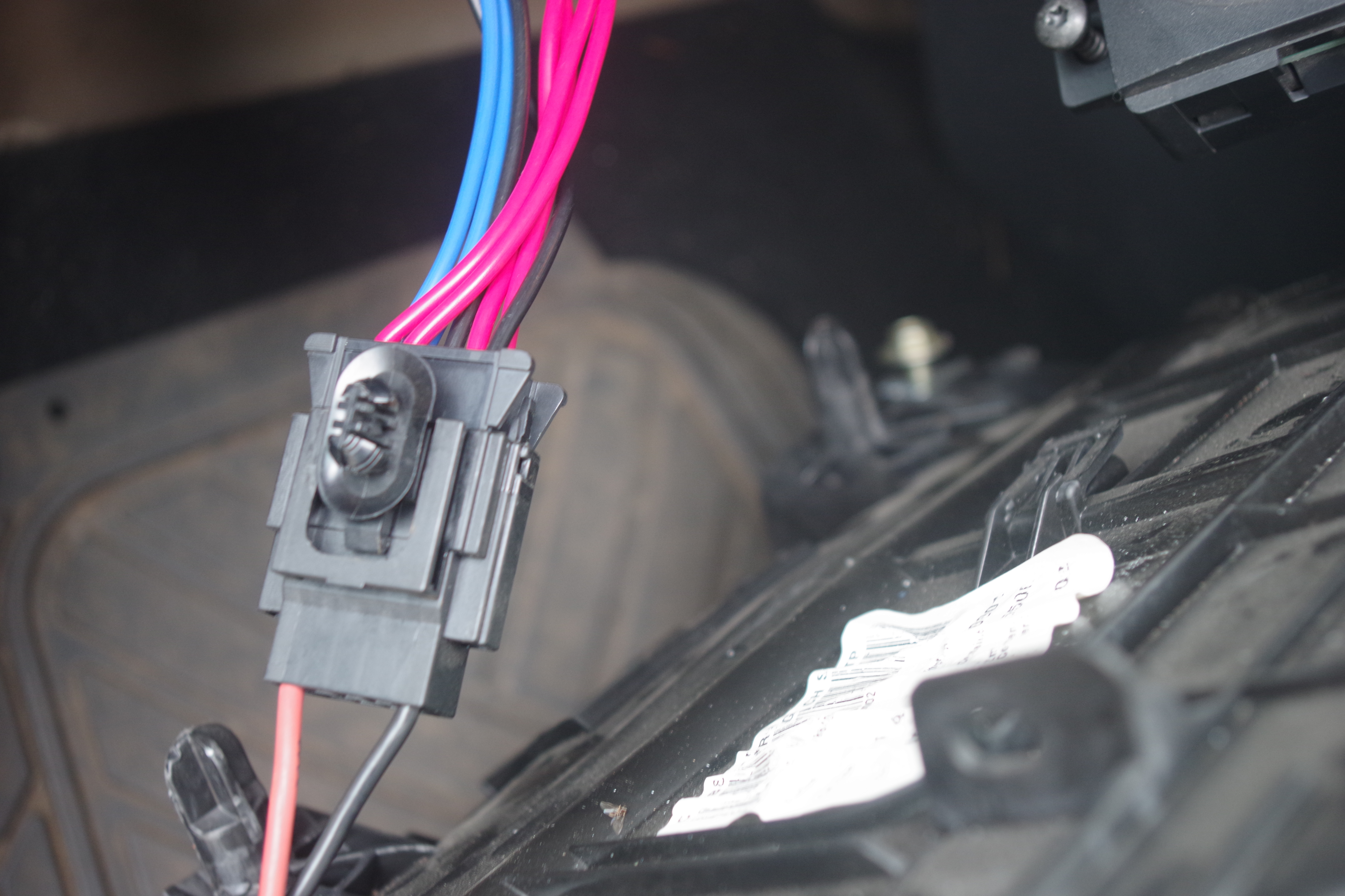

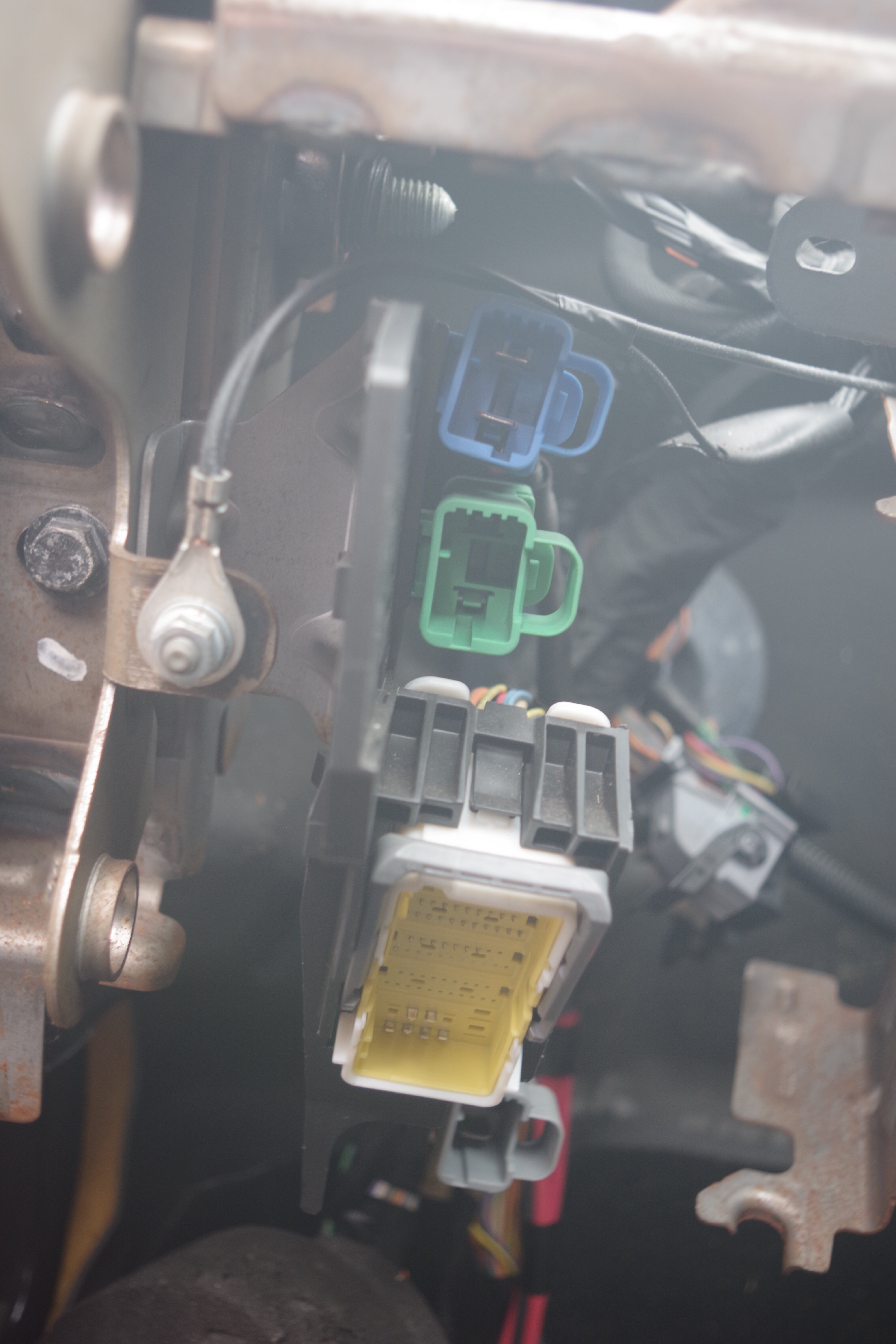

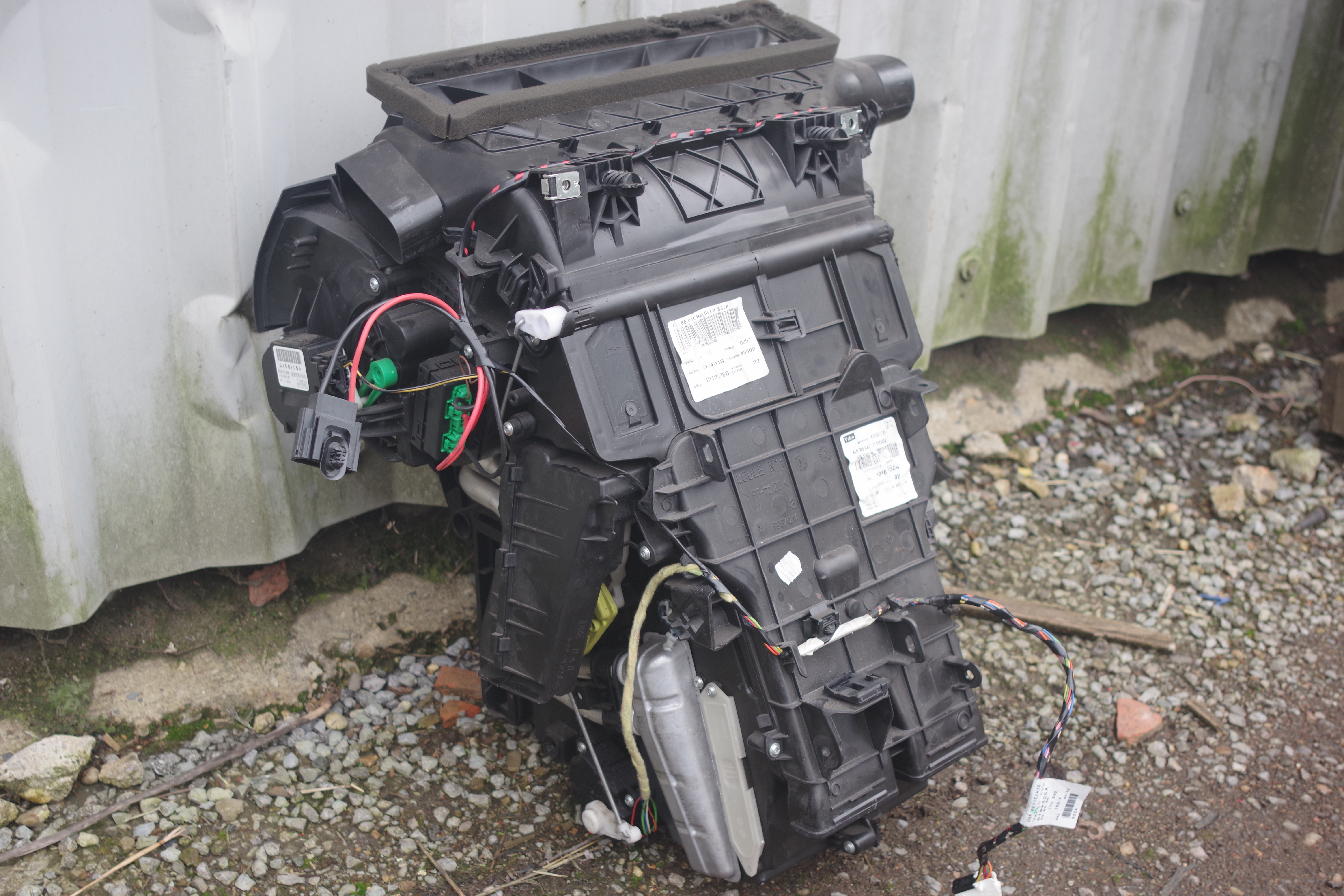

As it's a nice day, thought I's experiment on the climate control modification.

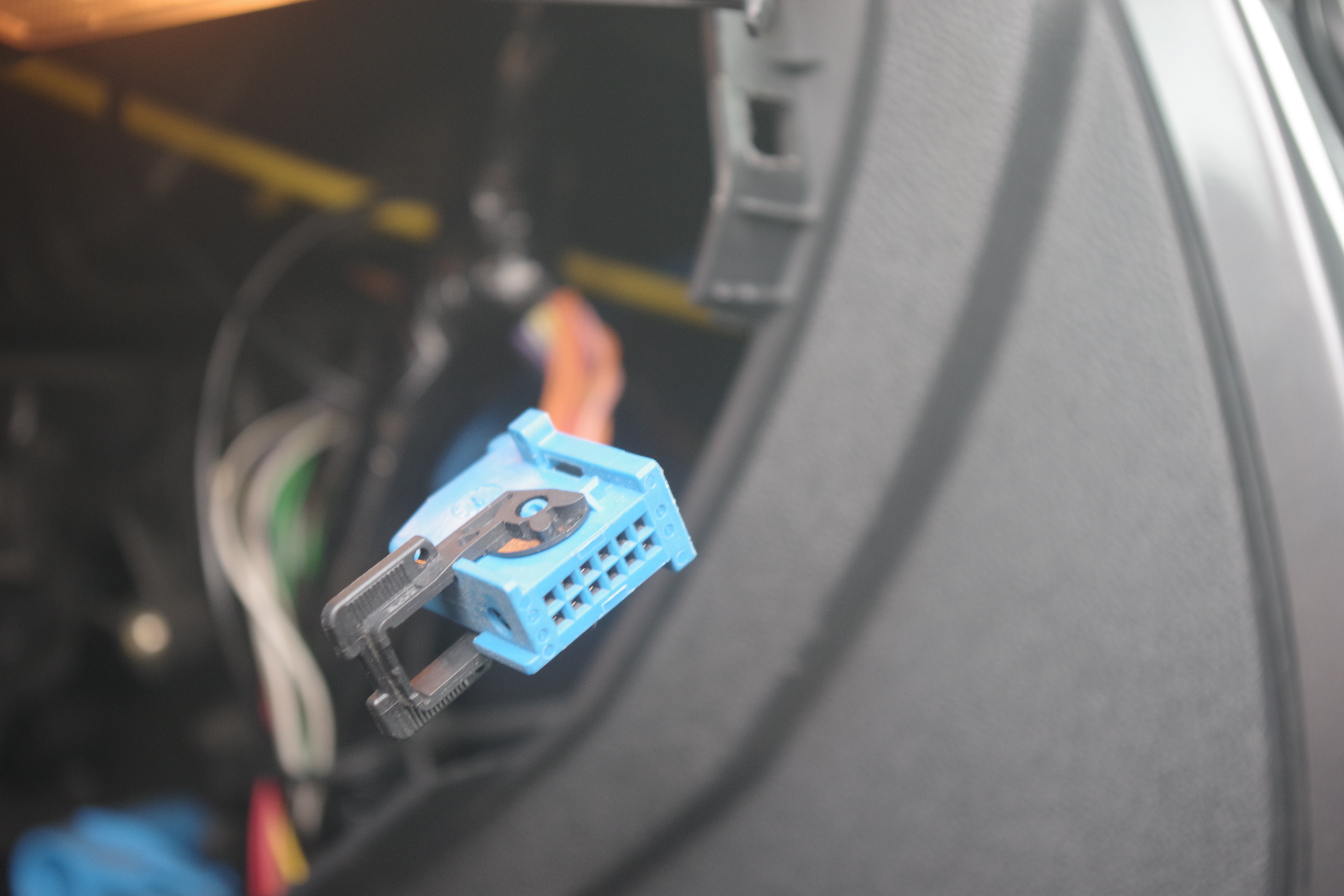

So removed the glovebox and lay the replacement HVAC in the footwell. Removed the plug from the heater resistor and connected to the HVAC unit, that supplies power and earth to the system.
Plugged in the climate panel's white and blue plugs (the one tucked in a hole to the left of the glovebox).
Fired up the car and the new units heater blower kicked in! I was so surprised I turned the car off as I thought the UCH would need altering.
But on starting it up again I was happy to see everything seems to work. The display lights up, the blend motor works hot and cold, the direction motor moves and the recirc motor functions. Plus the heater blower, a/c and hrw all work ok. Happy days indeed!
All that has to be done now is gut the car (doors, wings and dash crash bar out) to fit the new HVAC unit. But at least i know it will all work without reprogramming the UCH.

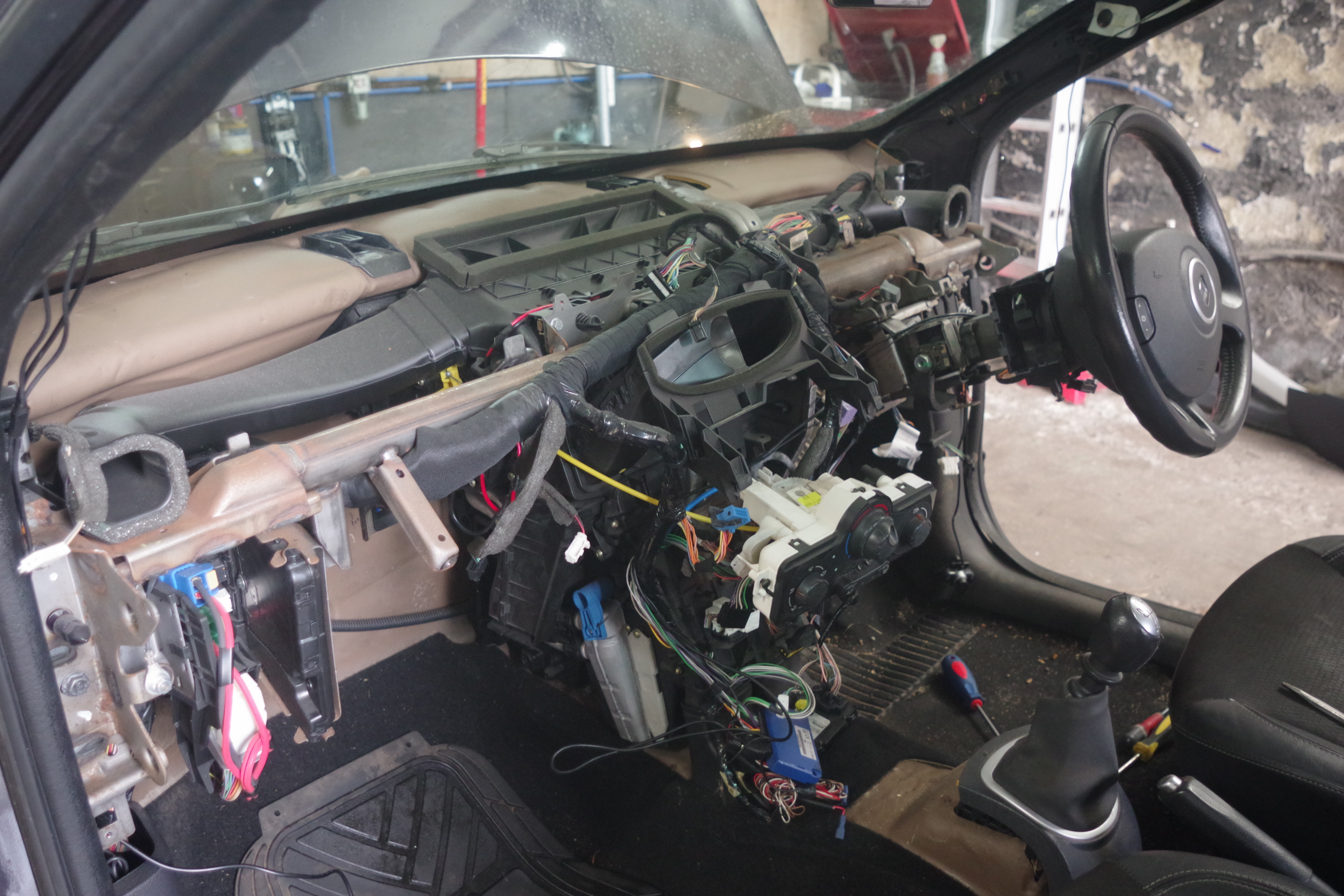

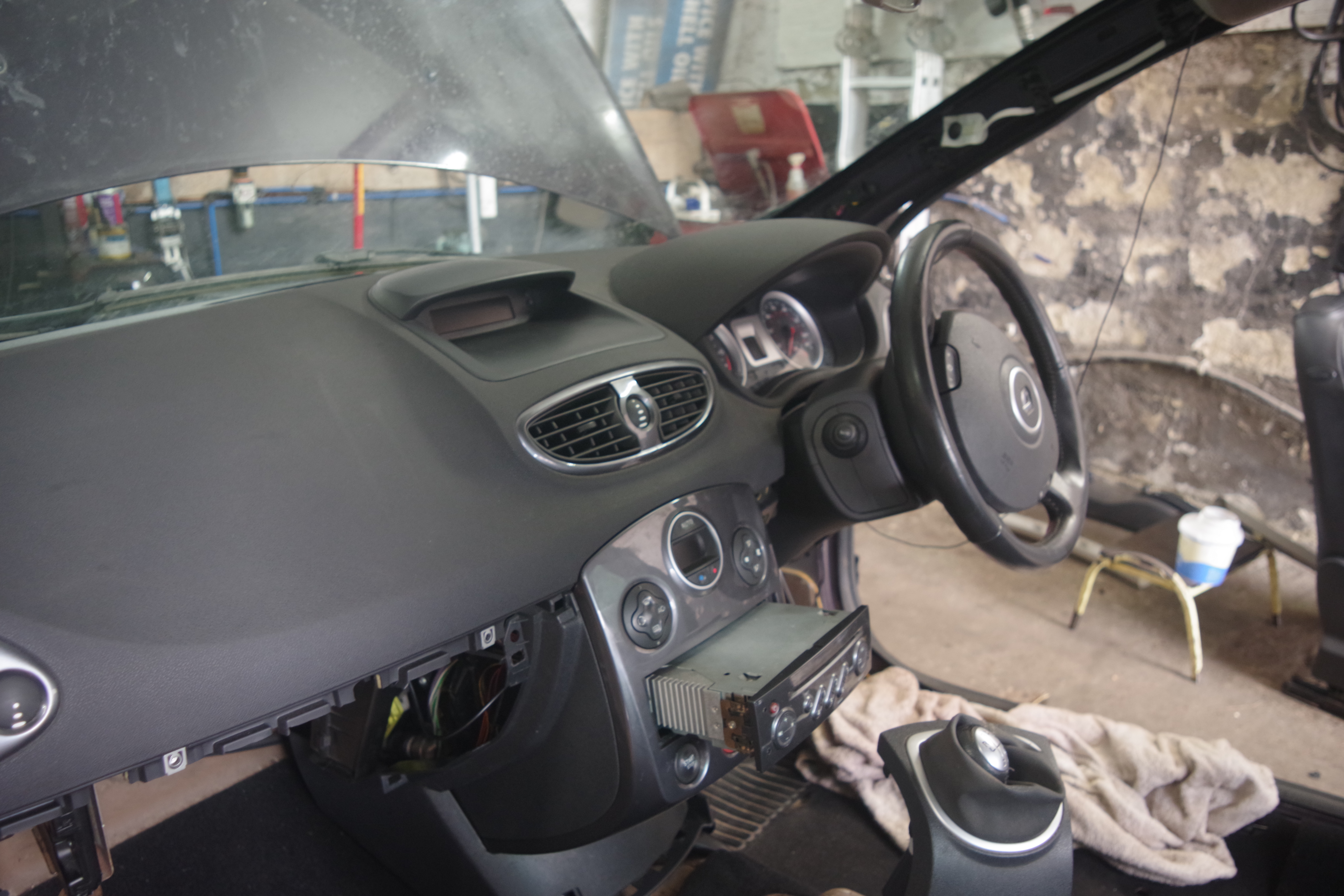

Started the heater swap task today. Went quite well really.
Front doors removed, seats out, fascia removed, carpets and under seat air ducts moved aside.
Crossmember bolts out , drop the column and partially disconnect the wiring harness.
Replacement HVAC unit dropped in and a few bits bolted back in.
Finish off tomorrow. Fingers crossed it all works!

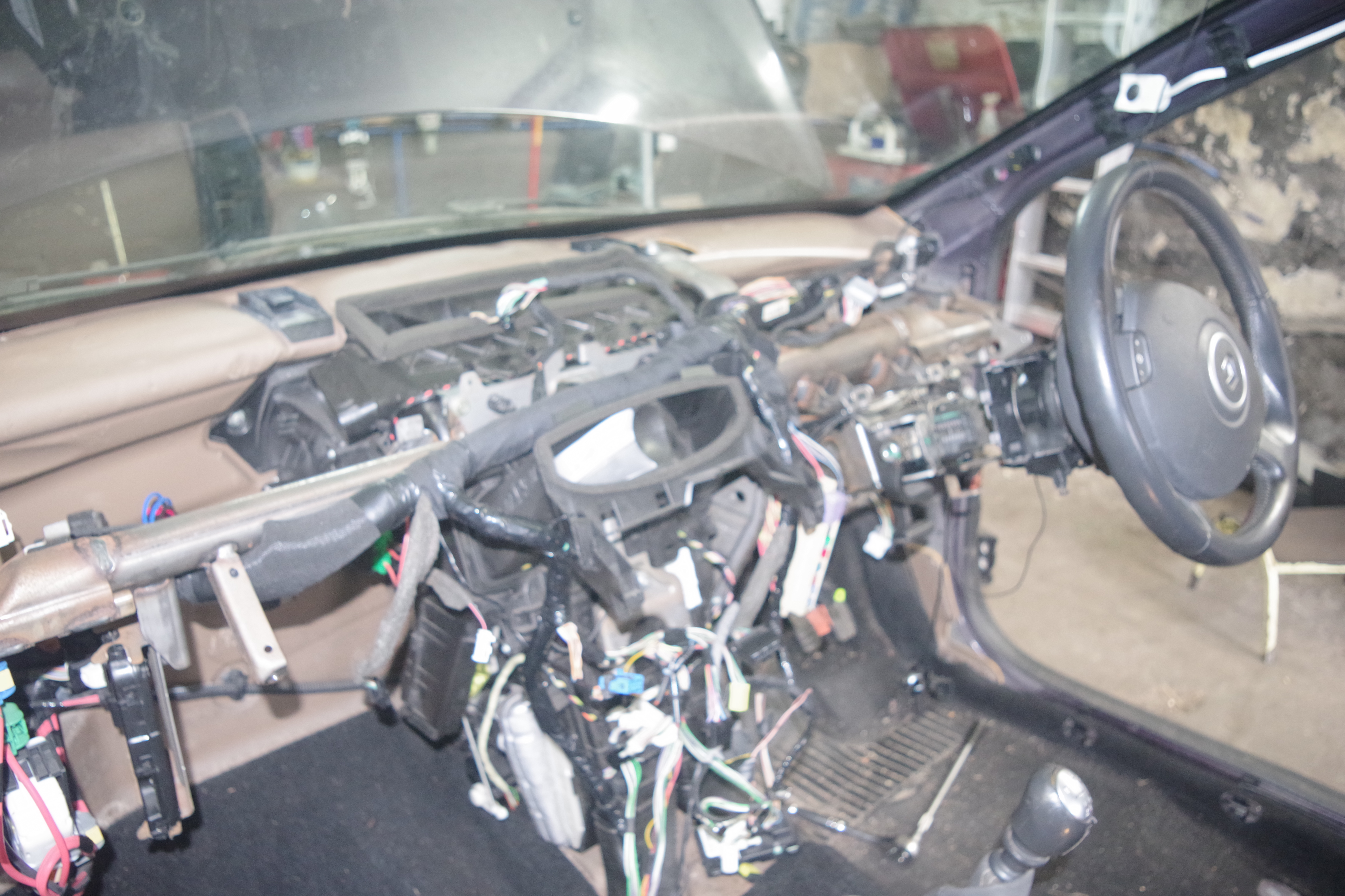

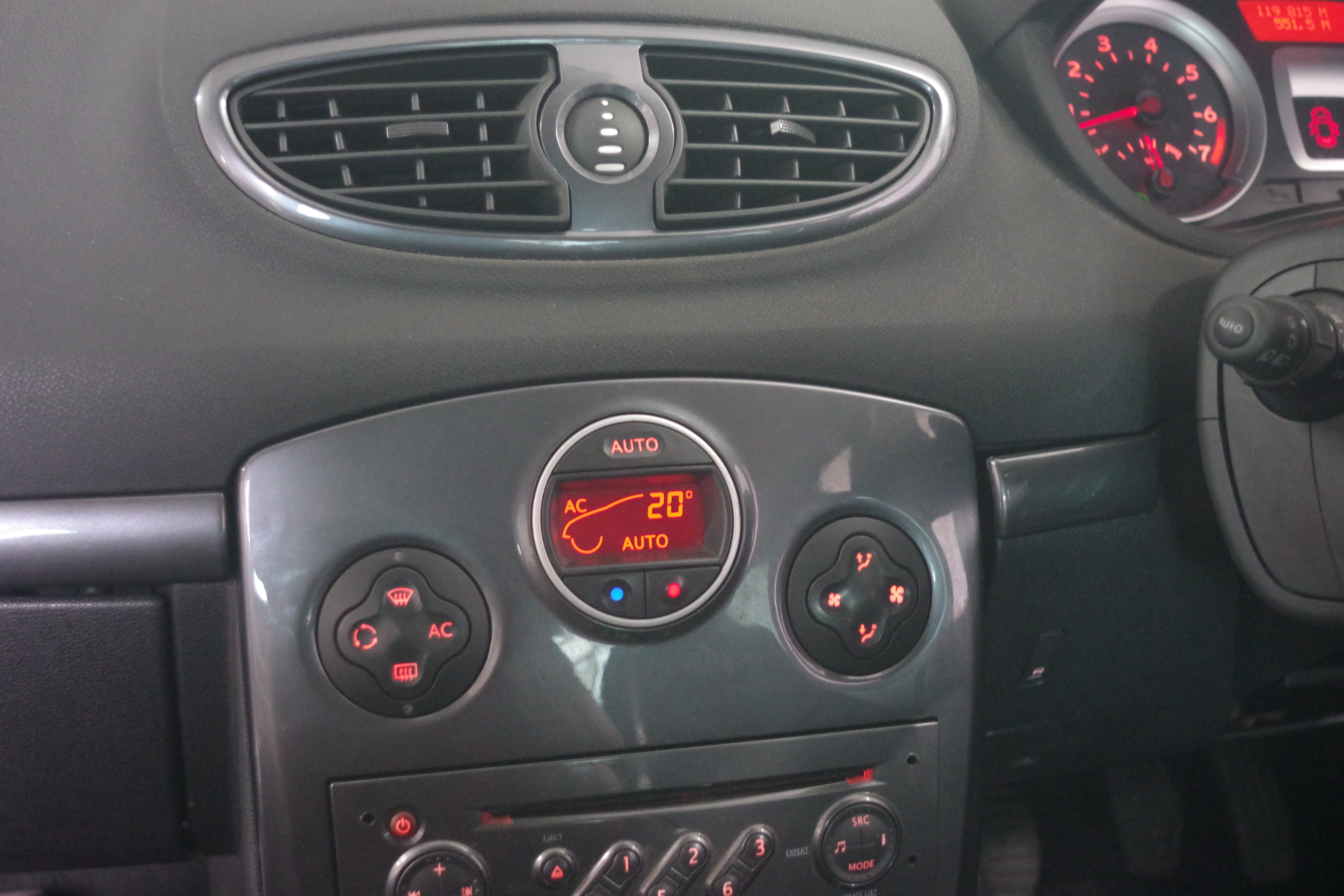

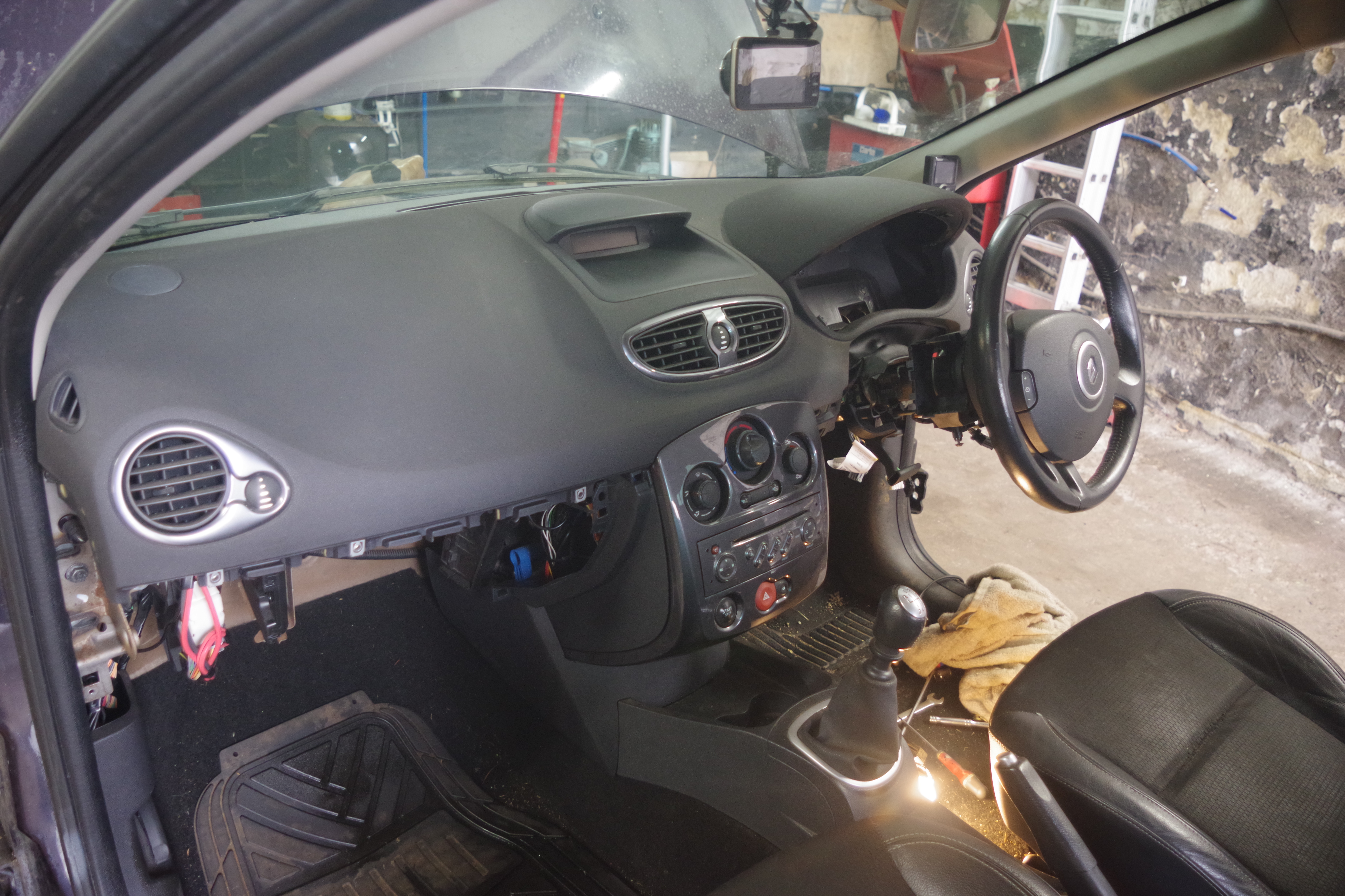

  Clio 3 2.0litre
Finished off today, all good and working ok.
So it can be done.
Contrary to what many said the looms are all the same and the extra connections for the dash solar sensor, climate panel and cabin temp sensor are all there. The only loom that needs adding is from the lh A post multiplug up the pillar to the sensor in the rear view mirror trim plastic housing.
As long as the HCH is to N3 levet it's plug and play.
I was lucky to have a complete car to rob all the parts from.
Just got to gas the A/C system now.
