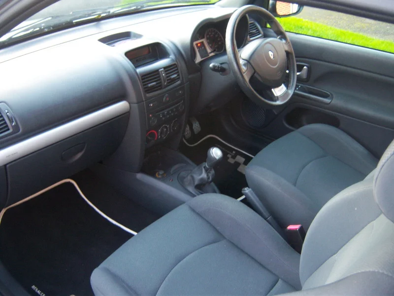

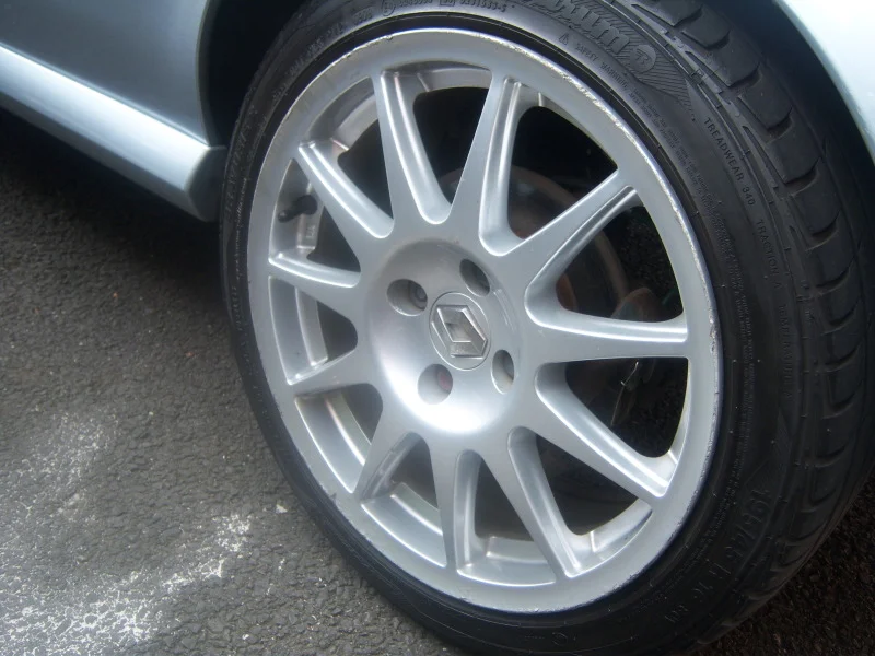

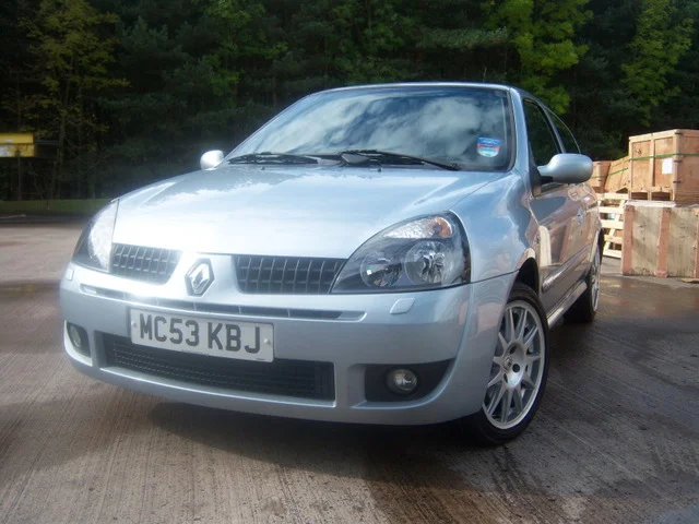

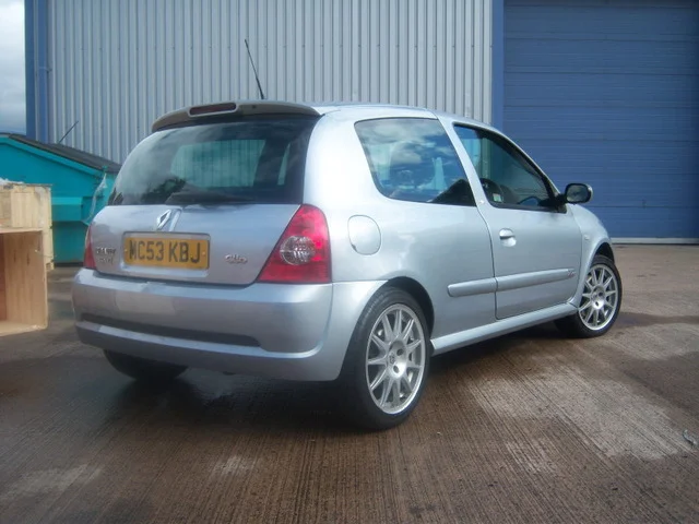

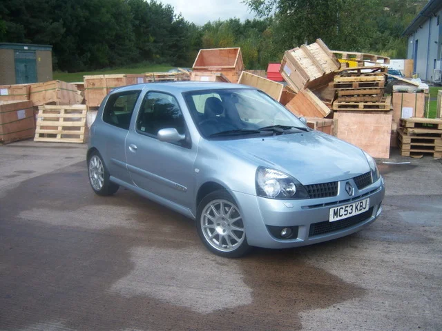

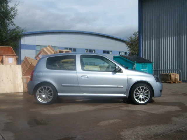

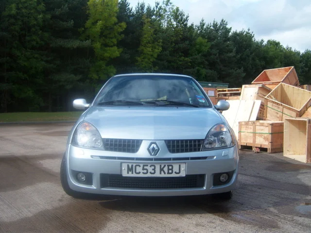

Hi,
After buying a 172 cup last week I thought I would put up a bit of a diary thread for what's going on with my car.
This is the first car of my own I have had on the road for a while due to having a company 4x4 and messing about with a race car project.I moved house a little while ago and as there wasn't enough room for the race car and mountain of bits that go with it I decided to sell and buy myself a new toy with some of the proceeds.I had a look around to see what I fancied but couldn't go too mad as I wrote off an impreza wrx about 5 years ago and the insurance man is still not my friend!
I decided on a 172 cup preferably in iceberg silver and started to have a look around for a decent one.Unfortunately as there were none for sale within 200 miles or so I had a look at a few blue ones,most of them turned out to be dogs so I gave them a miss.I eventually came across an Iceberg silver example locally and after viewing it a couple of times to be sure I took the plunge.Its a 2 owner 50,000 miler with full service history and belts done at 38k in 2008.Body work is pretty good and with a visit from the dent man to sort out a couple of very minor car park dings it will be great.Drives nicely and the only real issue was a leaking power steering sensor which was replaced as part of the deal.
Here are a few pics after giving it a little clean (excuse the slight blue of the photo's,my five year old left finger prints on the camera lens and didn't notice till I downloaded the pictures).
Plans for the car are pretty simple in order to keep the insurance man happy.First up was to change the dogbone mount bushes to powerflex ones as the standard ones were shot meaning the exhaust was hitting the subframe and probably not doing the other engine mounts any favours.This sorted out the knocking altogether and the extra vibration is barely noticeable to be honest.Im planning on giving it a service in the next couple of weeks and also change the induction kit for a standard airbox as it sounds great when you boot it but the noise gets on my tits when driving at a steady pace.
Once those little bits are sorted I will be doing a bit of headlight correcting as it has the usual haze at the top of both lights that spoils the front end slightly.The turinis will be getting a refurb as they have light kerb marks around the rim and corrosion has started in a couple of spots,they will most likely be done in the standard silver.Last on the list for now is to get it sitting a little lower (or more level even),so will be saving for a decent quality set of coilovers and solid top mounts.If my impatience gets the better of me I might just chuck on a set of sportlines to get the ball rolling.At some point down the line the belts will be done along with the dephaser and water pump as there is no record of either being done last time and I might splash out on a decent exhaust as well if im feeling flush!
Thats about all to report for now but will update as I go along.
Cheers Ross.

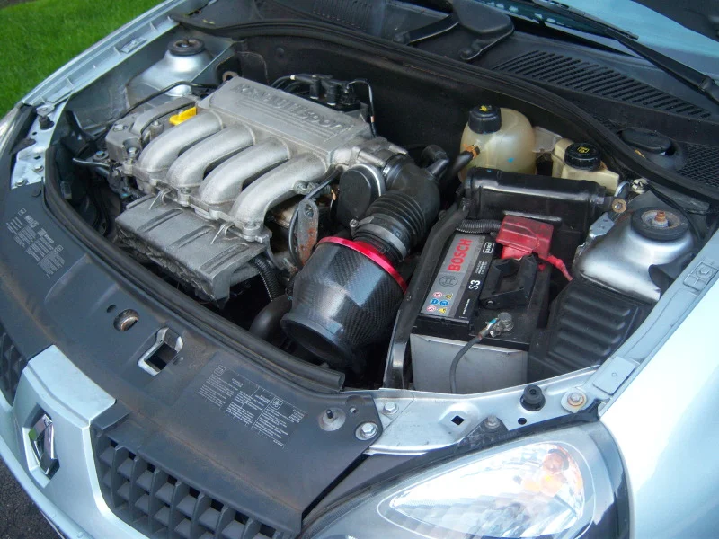

Another less than stunning update but here we go nonetheless.
When I bought the car it had a viper filter fitted but the cold air feed was missing.I wanted to replace it with the standard air box but had a bit of a saga to get hold of one.As it happened a lad at work has recently bought a cup so I asked if I could look at his to see where the feeds went etc and he mentioned he was going to buy an induction kit.Seemed ideal for both of us so a swap was done,leaving me with a very dusty air box and cafs.
Cleaned it up and gave it a coat of trim wax
Replaced the filter as the old one was BLACK and dated 04!
And lastly fitted into the car.Took it on a 270 mile drive to Scotland yesterday and while it doesn't sound as good low down it gets rid of the boominess while at cruising speed.
