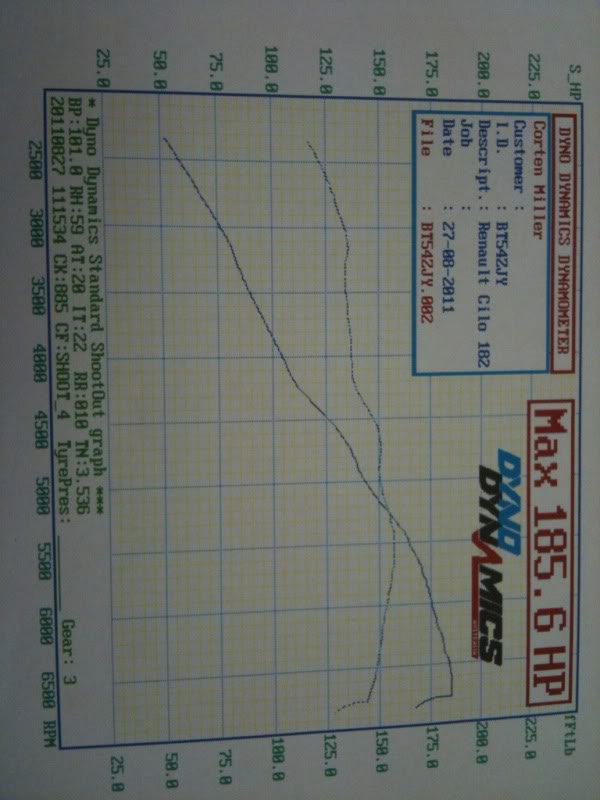

  RS2'ed 172 Cup
Rs2
Ktec Supersport stealth
182 manifold
Decat 182 link pipe
RS Tuner 98 Ron map (Temp until MWM can book me in for mapping)

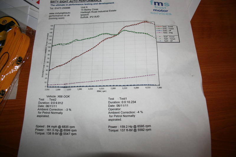

Standard 172 Cup
162 bhp 148ft/lb torque.
standard map/standard inlets/ paper air filter.
BTB system gained 2hp at the top.
All done at RS tuning's RR in Leeds 31/01/11.

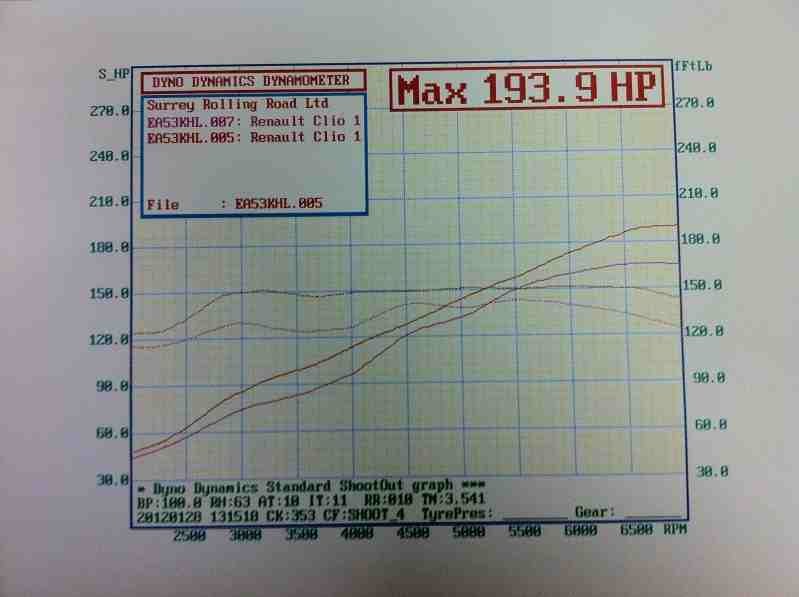

Ph2 172 cup, TDF's Dyno.
- 161bhp K&N panel filter, piper cat back.
- 193bhp & 151ftlbs of torque, jenvey 45mm ITB's, 45mm trumpets, slam panel remaining, piper cat back.
- 202.9bhp & 169.9ftlbs of torque, jenvey 45mm ITB's, 90mm trumpets, slam panel removed, Pipercross airfilter with fixed back plate, 182 manifold, Decat, Oreca group N exhaust & recent service

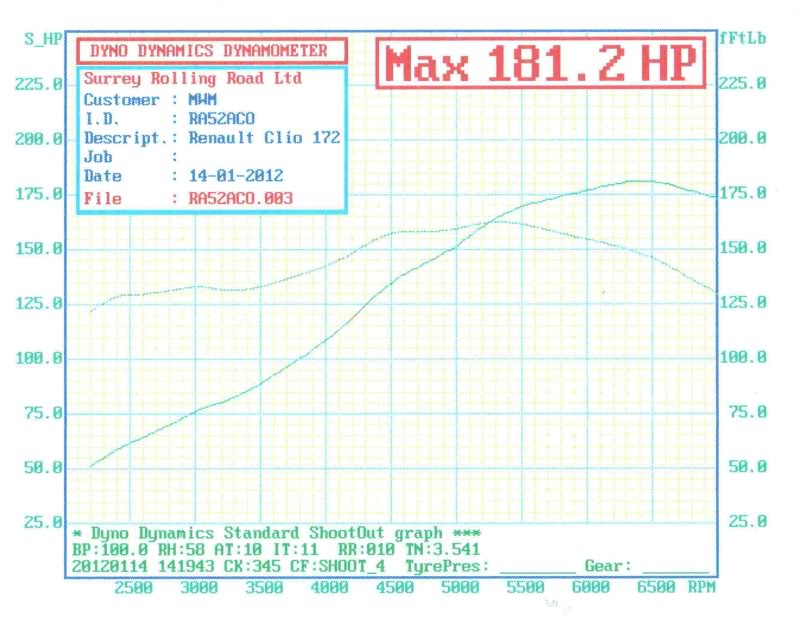

  172 Cup 181bp 165lbf
2002 172 Cup:
181 BHP / 165 FTLB
K&N Pannel Filter
De-Cat
Ktec Stelth Exhaust
JMS Performance Remap

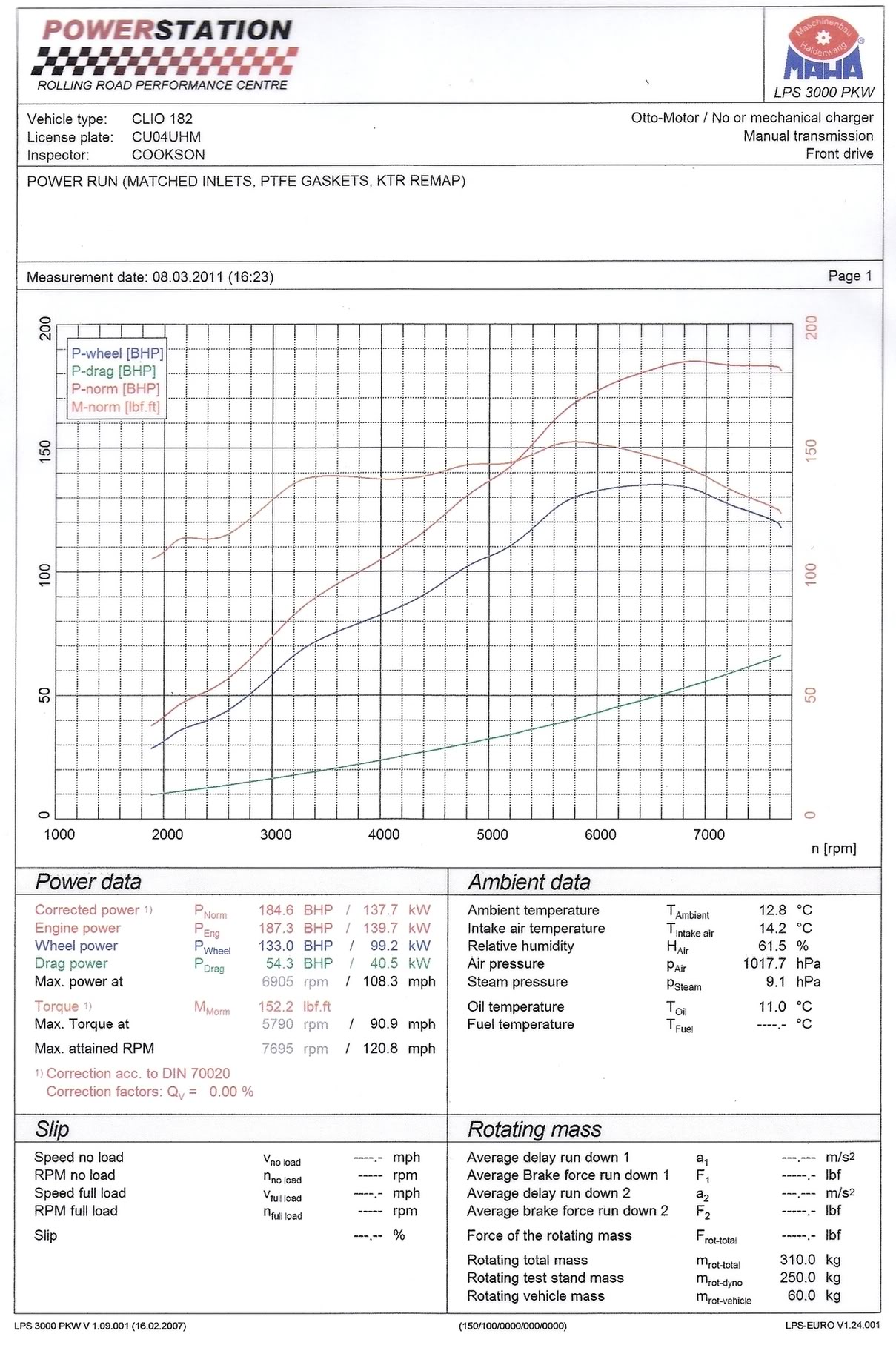

182 04 94k matched inlets full yozza with deact k&n 57i gen 2 induction kit and ktec remap
184 bhp
152 lbft
