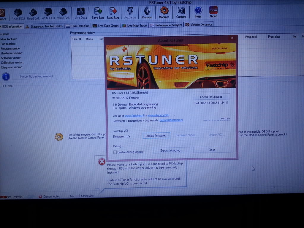

downloaded to software off the fastchip website but when i open the program it keeps saying FASTCHIP VCI NOT FOUND!
[FONT=Verdana, Arial, Tahoma, Calibri, Geneva, sans-serif]Also i dont have the option to unlock the rs tuner so i can use it on my car. so i can not Unlock VCI” or get a 19 digit code unlock code. Also can not access any ecu info on the rs tuner program.

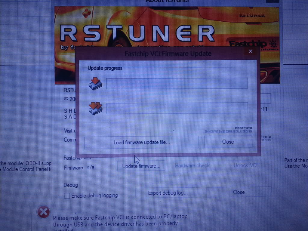

This is what comes up when i click 'ABOUT' The only think i can click is update firmware then it asks me to Load firmware file what i dont have?

Just read on the website that they dont run with windows 8 :( had to run the program through my dads laptop with windows 7, all seems to be running ok at the minute.
  197
They DO ! From firmware 189 onwards. With firmware 189_102 or higher you don't even have to install a driver any more under Windows 8.

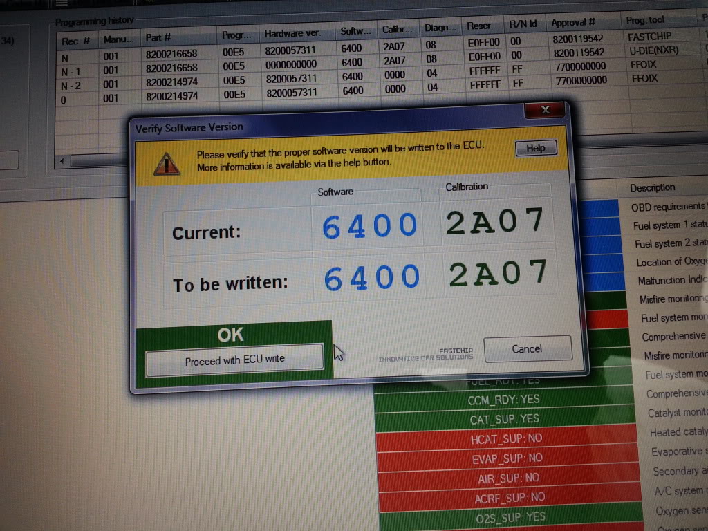

I have Clicked on “write ecu” and my documents folder popped up. i selected the new RST file:
RSTuner_EL_6500_5404_Decat_Overrun_RON98_1110_2162.cal
All was fine and said go a head ect... in the green box but reading through the guide on here it says thats the file i should put on the Write CAL. Will there be any problems with me installing that onto the Write ECU or will it be ok and just upload the other file i have to the write ECU:
8200293034_6500_5404.rst
All was working fine, Write ecu went through fine and said successful ect... reconected and started with the write cal file. Came up with the green continue and started writing file. got to the end of the file and said failed!

You need to manually you install the rs tuner driver thats why its not recongnising the vci . As for the correct file henk should of sent you the right one for your car from the screen shot off the ecu info you need to send him .
Also if your trying somone else's map dont bother because there all encrypted to each car now . I,e cant share maps anymore .

Write ECU with the rst backup you made or order a performance cal from me.
The file i uploaded was:
RST_6400_2A07_2013-01-31_08-07.RST
What brought up this what looks to me to be already what is on the ecu am right?
