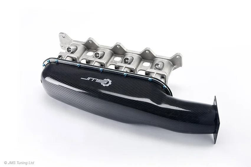

Looking at photos of the JMS RS2, there seems to be two versions. I don't mean the RS2 Extra (the longer one that can have issues with radiator/slam panel/grill). But rather I mean the regular RS2.
If you look at the photos of them fitted, some of them are made of two parts. There's the Jenvey base manifold, which bolts to a manifold that looks just like a hollowed out set of ITBs , and then the carbon inlet plenum.
But on others (newer ones?) the Jenvey base manifold and the part two manifold (what I call the hollowed out set of ITBs) are merged together into one piece.
Anyone got any info on what/when/why the changeover was? Does the two piece design have a longer length than the single piece design?
  Clio 182 FF

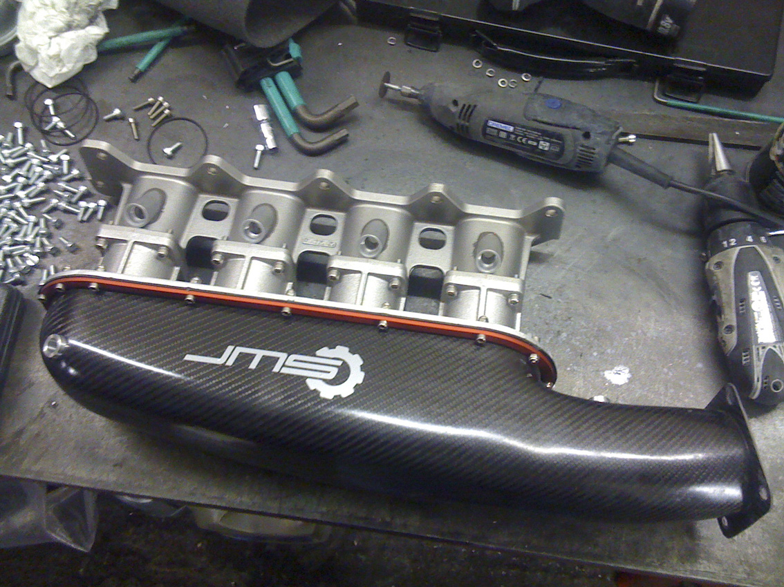

The original two piece design with the join clearly visible:

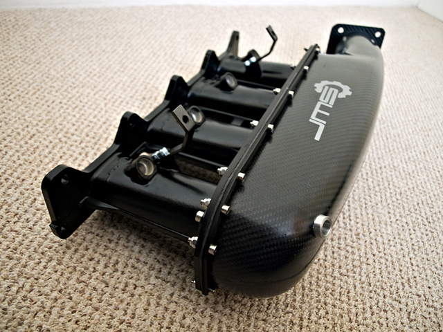

The single piece design:
Wondering if the length changed between the two designs with the removal of the join, making it an "RS2 extra half" or something?

From memory, re: your pictures, the first version was two "off the shelf" parts spliced together, whereas the second was after they had a custom part made by jenvey from their cad designs.
The inards were pretty much the same iirc, it was just a change in manufacturing.

As above, the original batch were a Jenvey F4R manifold with spacers pieces to add the required length. The second gen had a custom manifold cast but I don't believe there's much between the two types when it comes to power results. The only thing I don't like about the first gen is the injector ports as they're JB welded in place and can snap off (I had it happen on mine) and had to fabricate a proper fuel rail mounting solution to save it happening again.
This isn't an issue with he second get either.

So I guess it was the usual Jenvey MR23 Manifold (75mm length), with injector pockets welded in, and spacers of I’d guess about 50mm length. I don’t suppose anyone still has a original RS2 around to actually measure? Just intrigued to know if there was any change in manifold length between the original two piece and the later single piece.
When making it out of two pieces, I wonder why JMS assembled it that way round? Obviously they wouldn’t want anything too extreme like remote fuel injectors out of the airhorns… but I’d have thought moving the injectors a bit closer to the plenum rather than the head could help with fuel mixing?

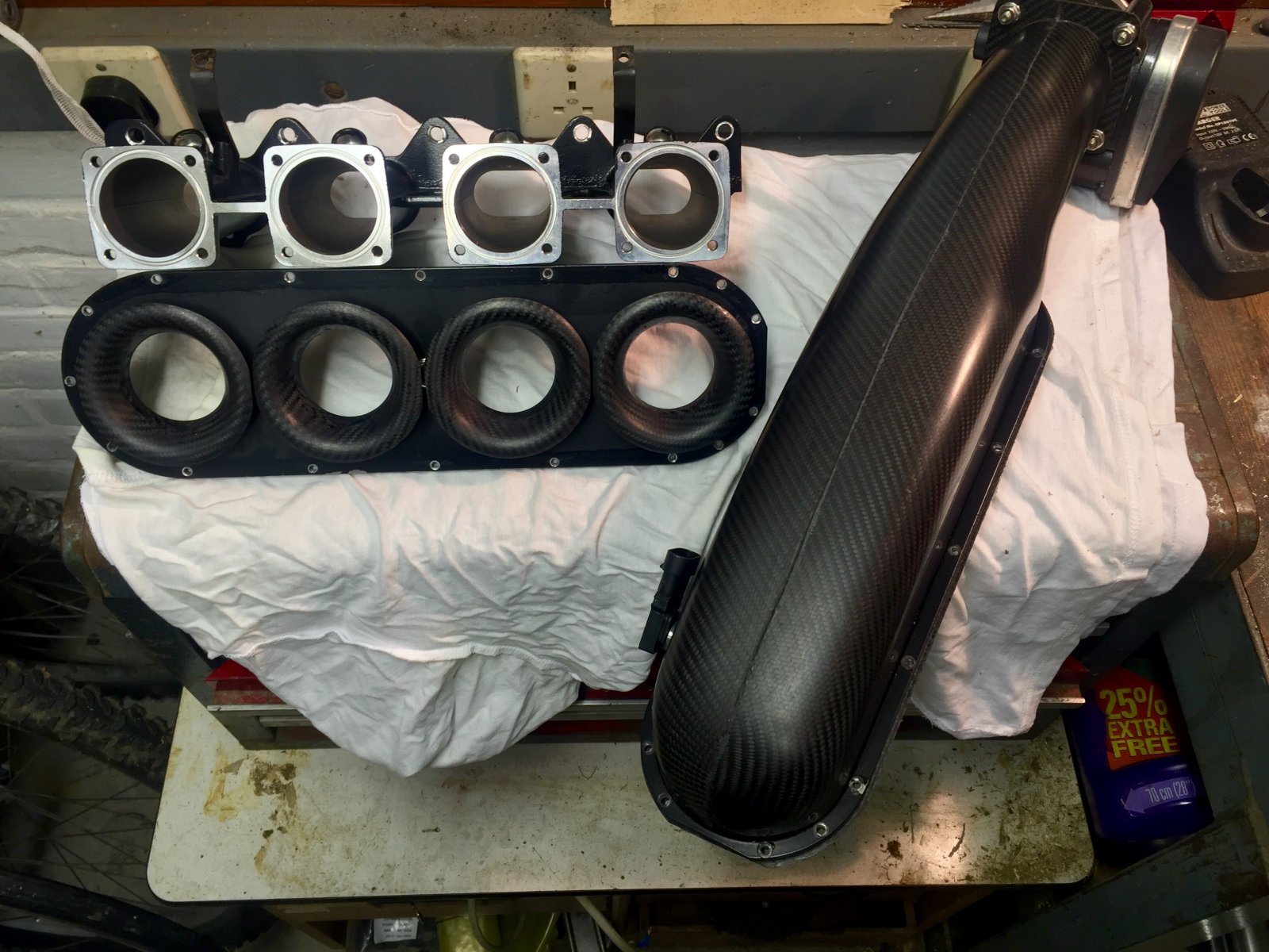

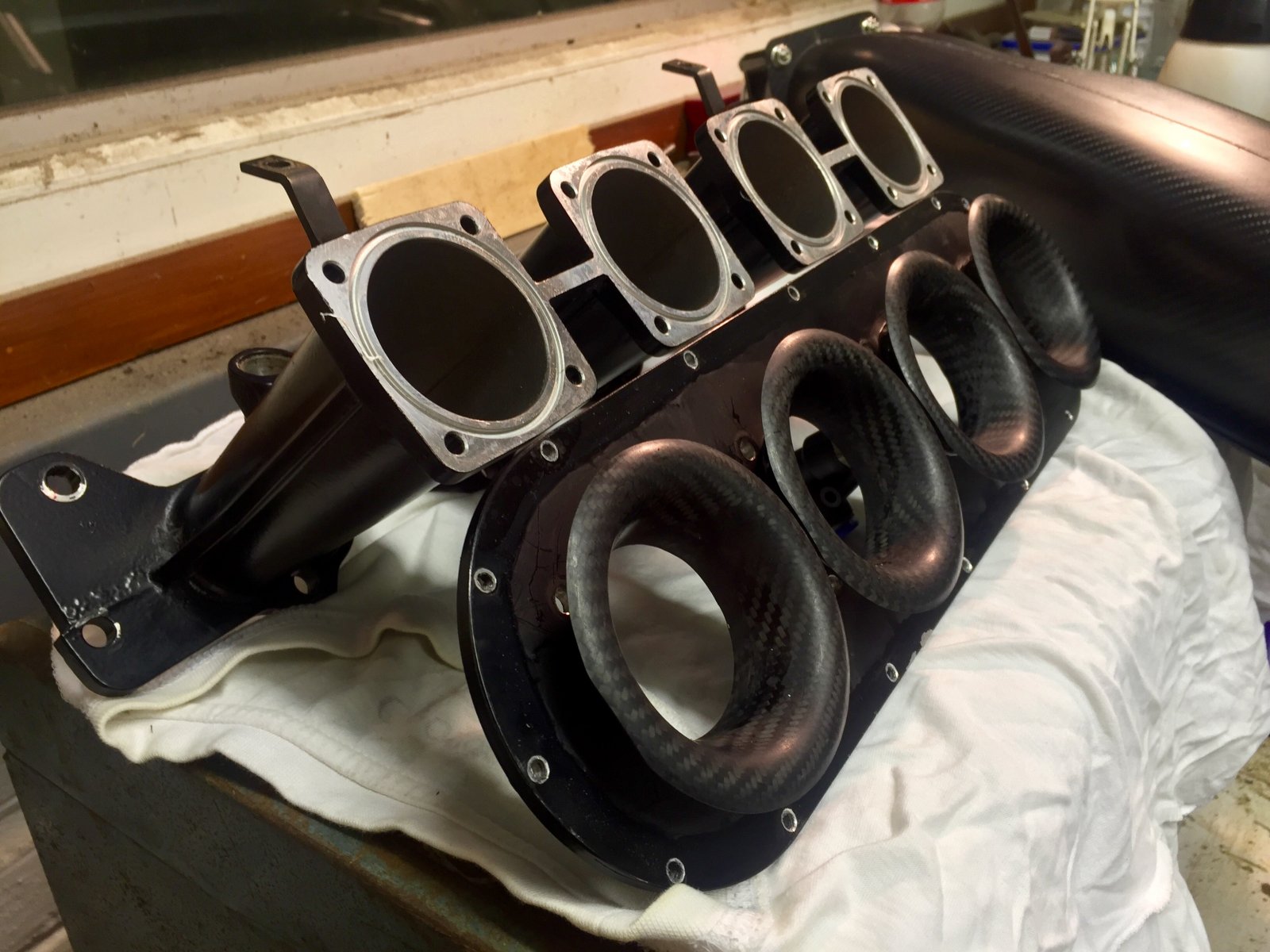

Here's mine all in bits for anyone interested.
Always <3 carbon trumpets!
I've got the same set up as @Chambers_RS and was wondering what type of gasket there should be between this manifold and the head. Doesn't look like there's anything in at the moment (unless it's o-rings).
Also got the RS2 Xtra extensions to go on when I sort out a radiator and bonnet catches. I'm assuming there should be o-rings to seal this onto the manifold too.
