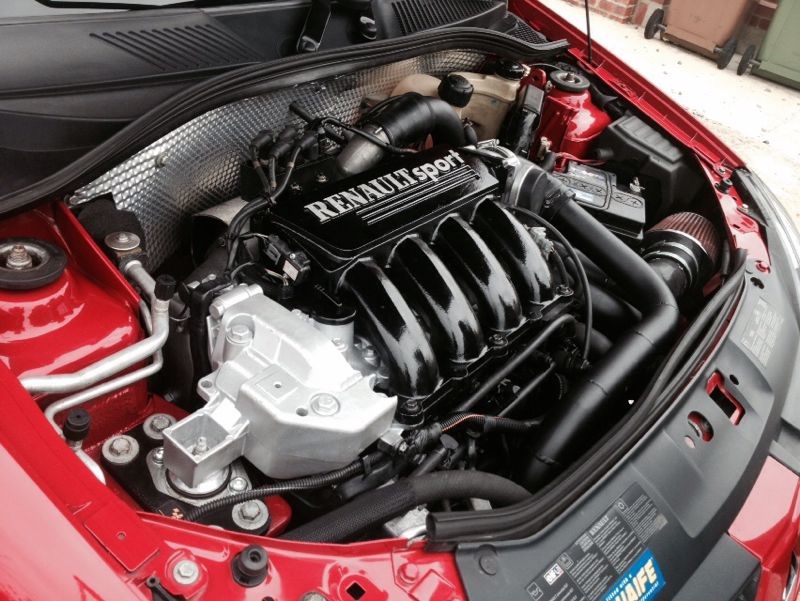

Right!! I've heard a few rumours that the rs2 inlet won't work with boost but I can't see why? Only thing I feel the problems would be is keeping the sensors in and that can't be hard to overcome?
Has anyone ever tried it?
I like the idea of it to be honest and want to see if anyone has any facts on the subject before I waste my money
pretty sure the principle is spot on, but that the reality is there is nowt to gain by doing both. If there was a gain to be had, chip would have done it by now ;)
  Cup In bits
It would work on a low boost turbo safely I would say but the walls are crazy thin on parts of them RS2's and would worry me, its also not really needed as the a turbo forces air in so doesn't see the restrictions of an N/A engine. It would create more lag too as its just another area that needs to be filled with air.
The sensors in the standard inlet are no issue on boosted cars so these will be no issue.

This come up in convo before, the conclusion was, it's not worth it with boost, a standard mani will be just as effective.

I think it would work quite well and the quality of the carbon is very good so I think it would stand upto moderate boost ok, if you ever try and drill through it you will see what I mean.
certainly be a bonus on a turbo having easy access to the plugs as well. But all that said its a lot of money when the standard inlet will easily do 400 bhp with boost anyway and if you use a 197 one (with the head) you can get at the plugs anyway.

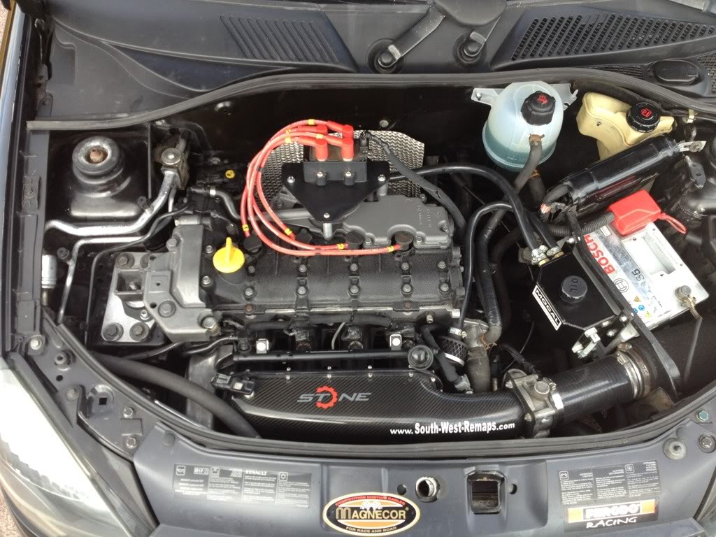

Low boost applications would be fine I'd have thought, Dan's supercharged one is seeing 10psi and the sensor hasn't popped out the stock inlet, so wouldn't be any different on the rs2?

We had a customer purchase an RS2 Inlet manifold to run boost last year from Russia, We have never run test's in house to guarantee the safe operation but the only changes made were to the M.A.P & A.I.T sensor locations, instead of being installed to the plenum chamber they were fitted to the aluminium backing plate with brackets to stop the sensors being forced out under positive pressure.
The customer has still not completed the build so I can't comment on the outcome but his reason for choosing the RS2 Inlet manifold was to be able to run a decent exhaust manifold/ Turbo set up that would otherwise be impossible with the location of the standard inlet manifold, those that have boosted the standard inlet know how tight the manifold coming from the turbo exhaust side to the cat-back/decat is.
