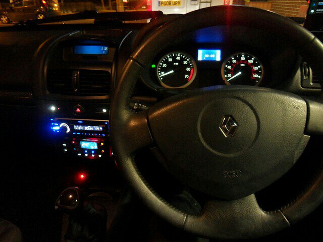

I have done the dash conversion myself, never buy a kit they're overpriced.
LCDs normally have a filter but these don't you just need to change the SMDs to your preferred colour and they take on that colour.
Try searching for led dash conversion. There's also a video on YouTube :)

Do you have climate control too? They need loads of SMDs, like around 20.
Normal heater panels need to have a filter removed from inside then change 2 T5 'dashboard' bulbs then bingo.

I want mine to look the same as urs but not got climate control.

What bulbs are needed for this that acctually looks really good hate the boring orange dull glow lol

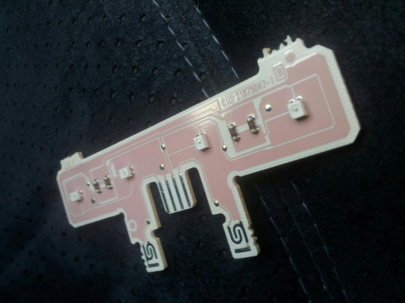

Should be fairly straight forward, your stereo is update list with it being 05? Just that this may change the way the center LCD is lit either 2 T5 again or a little pcb board like this.

What do you want from the kit i.e. what lights do you want to change. This can also change as above with the clock display & heater panel or climate. I suppose it's convenience more than anything to buy it in a kit.
I'd say for joe bloggs it'd take a good day or two to do the conversion. As you would constantly have to check whether the SMDs work after soldering.
Plus you'd need to buy a decent soldering iron if you want to be sure.
