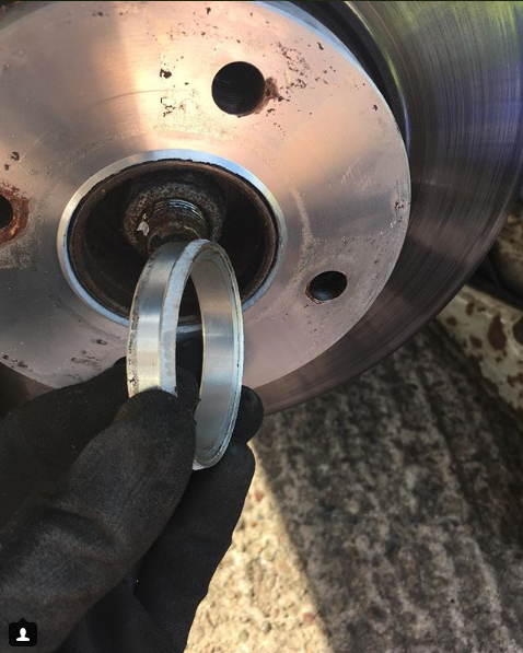

Hi, since fitting the b14s to my cup the front wheels look a bit lost in the arches. I'm thinking of getting 15mm hub centric spacers, looked on pms site which states for Clio 2 rs minimum spacer is 18mm? Anyone used the pms 15mm ones with longer bolts? Will fitting them adversely affect the handling? Cheers.

The minimum spacer is for the rear as the lip from the spacer will snap off if used on the rear mate
Pic attached is my 15mm eBay specials after 10 mins lol. I think the spigot lip on the rear disc is 17.3mm so 18mm is needed to clear that or risk cracking the spigot off of the spacer like I managed to ahaha
