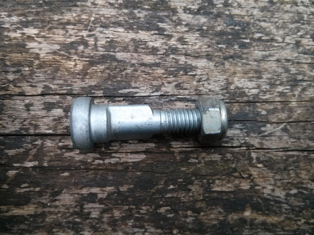

Finally changed my gearbox. The car is all back together and the last thing I need to do is put the pinch bolt for the steering rack to column back in. But can't find the hole that is meant to go through :eek: And done it blind when I took it out so didn't see where the bolt come out of, which isn't helping.
This is the bolt I mean:

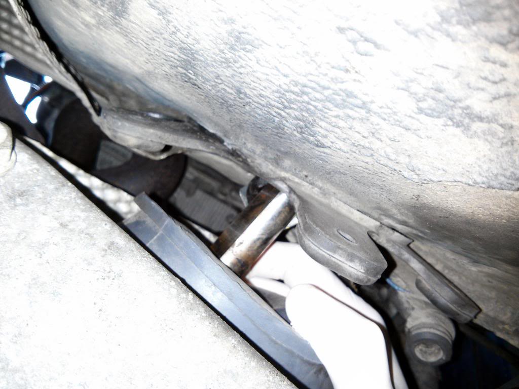

This photo is taken from under the car, looking up at the column.
Where should the hole be?

On the end of the column is some kind of "clamp". That must clamp the "entry shaft" on the steering rack. Bolt "clamps" the clamp. FLOL
I hope you didn't turn the steering wheel or rack while they weren't connected...

i had this problem doing my manifold change, and i spun the steering wheel to try and get them lined up again.....doh!
I dropped the back end of the subframe to give some clearance to get it back together in the end, lined the wheels all up straight then had a fight to get it all together.
patience and perseverance is all i can offer.

front was all done up, i took the supports out from the wheel arches, and removed the gearbox mount and 2 rear bolts, hadn't got round to re-fitting the brace plates by that point.
supported the subframe on a trolley jack, then went in over the back edge of the subframe on the drivers side with the bolt.
