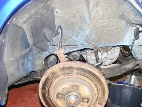

i attended my first track day with the car like this, and disaster struck. i lost a wheel going into the hairpin at knockhill
it was caused by no spigot rings and spacers, wheel nuts loose, bye bye wheel!
the damage caused meant the car was off the road for a wee while so i got to work turning it into what i really wanted it to be!

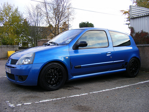

the finished article
002 by h3ppy, on Flickr
and thats how it stands just now!

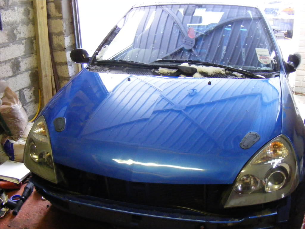

bit of an updatethen.....
i decided i liked the previously black on blue theme so decided to go back to it!
DSCF1753 by h3ppy, on Flickr
DSCF1754 by h3ppy, on Flickr
DSCF1756 by h3ppy, on Flickr

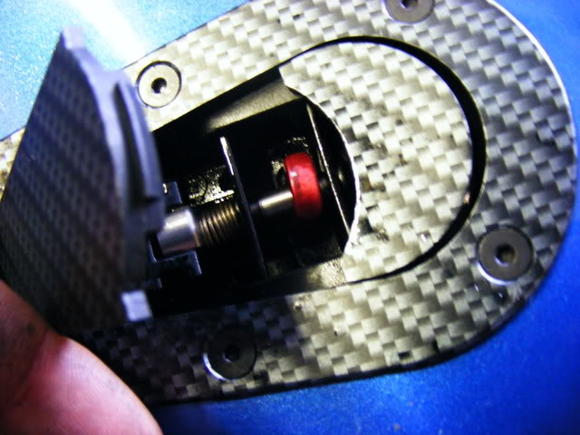

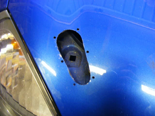

colour coded the mirrors and painted the wheels :cool: all done with rattle cans and patience!
will get some better pics up soon, next job is to fit these

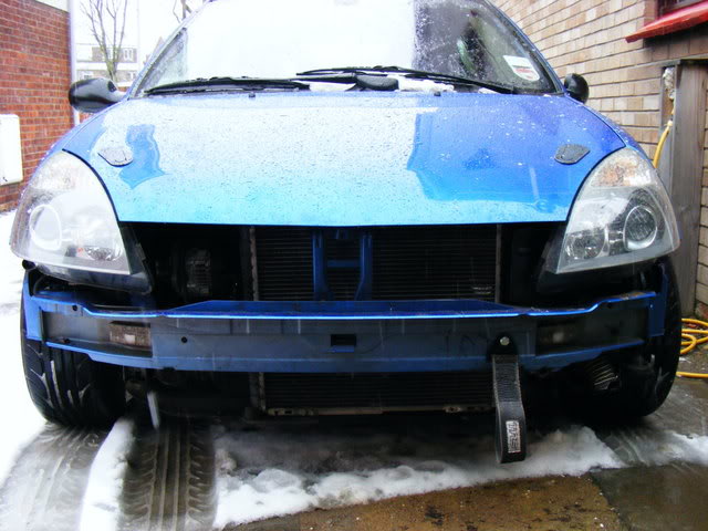

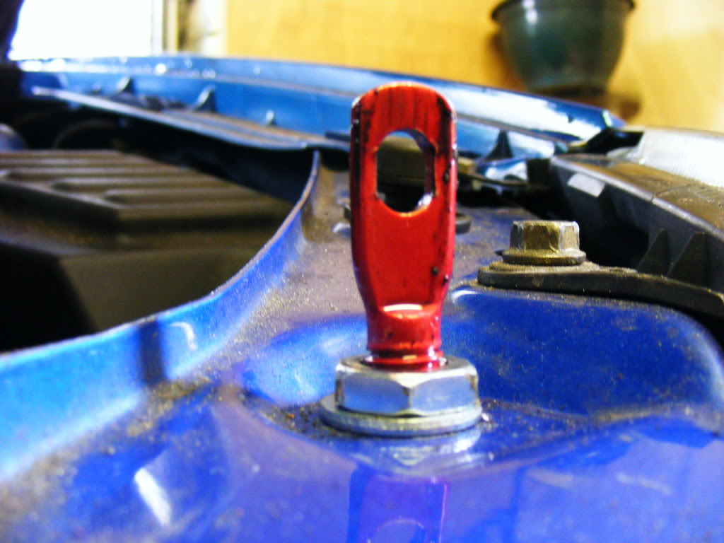

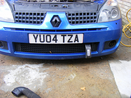

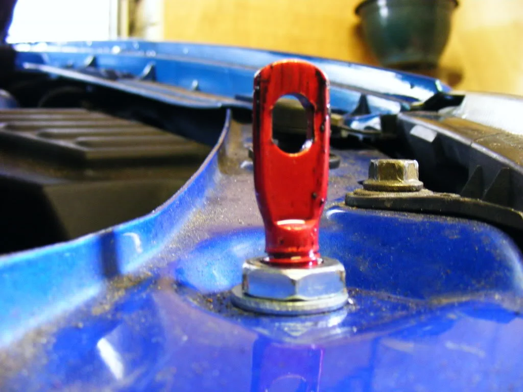

fitted my trs tow strap
342 by h3ppy, on Flickr

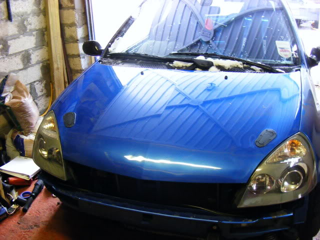

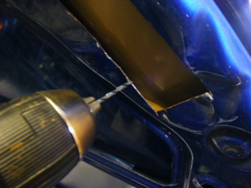

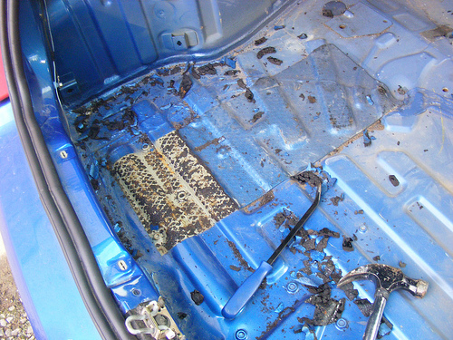

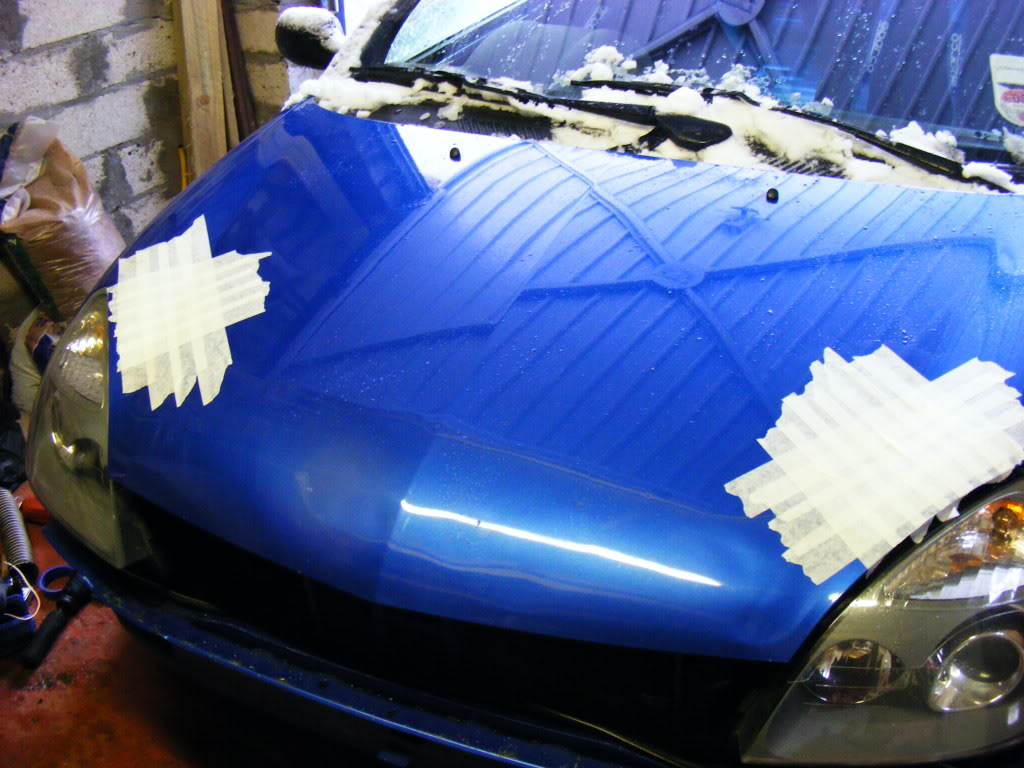

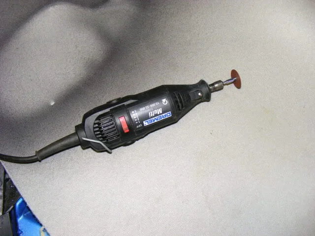

then got started on removing some of the dreaded tar! advice for anyone, do not heat it up, simple hammer and chisel first gets most off without the sticky mess, then for all the little bits left heat it.
343 by h3ppy, on Flickr

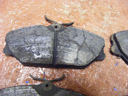

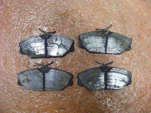

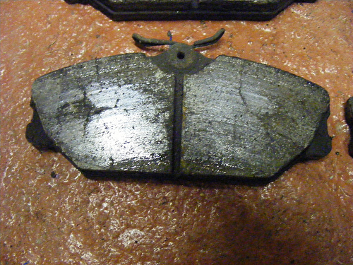

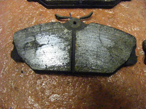

and for those who use redstuff pads this is the experience i had with them, after 3 10mins session on knockhill
332 by h3ppy, on Flickr
333 by h3ppy, on Flickr
334 by h3ppy, on Flickr
as you can see there is still plenty of life in them. take from that what you will but i would need alot of convincing to use EBC again.

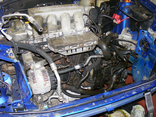

Well i never update this so thought i would bring it up to speed....

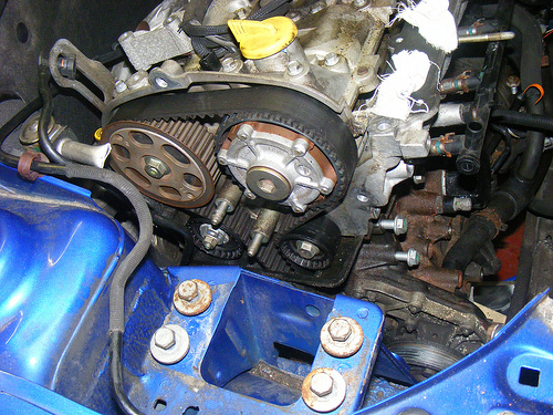

i got to 3 track days last year and the bug has definately bitten! so about a month or so ago i stuck the car in the garage to make some changes....
008 by h3ppy, on Flickr

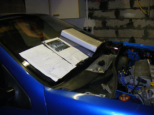

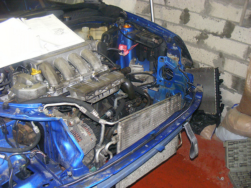

Bonnet off ready to be taken to pieces!
012 by h3ppy, on Flickr

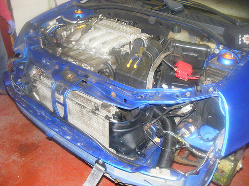

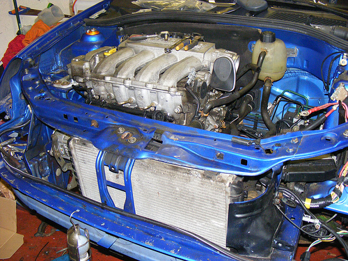

Front end removed
016 by h3ppy, on Flickr

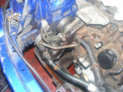

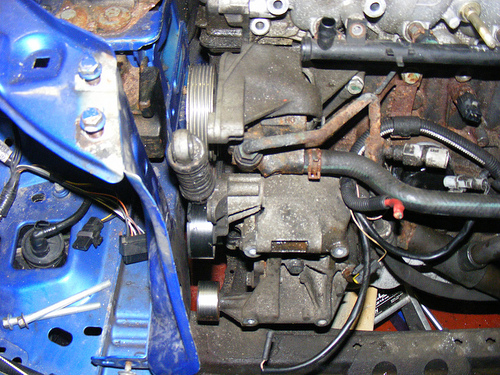

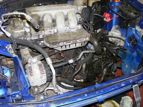

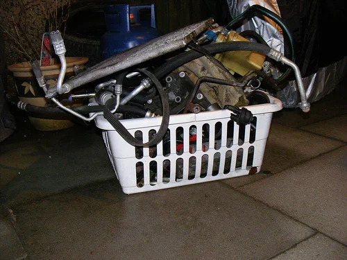

Radiator out and started removing aircon
020 by h3ppy, on Flickr
022 by h3ppy, on Flickr

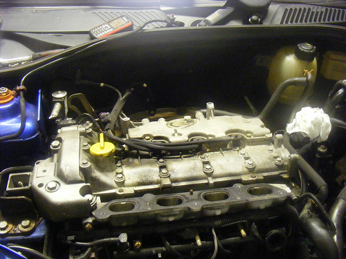

Top inlet removed
024 by h3ppy, on Flickr

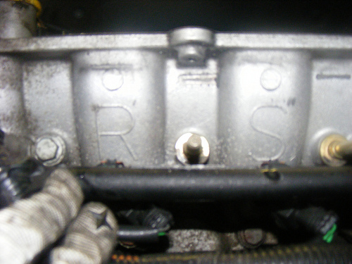

RS stamp FTW
026 by h3ppy, on Flickr

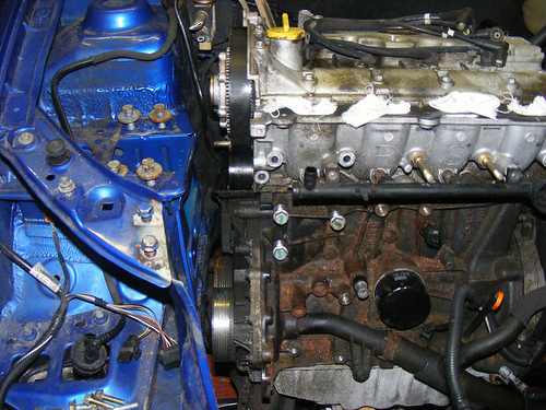

alternator out
033 by h3ppy, on Flickr
Aircon, PAS and top engine mount out
036 by h3ppy, on Flickr

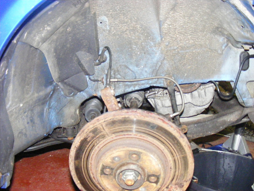

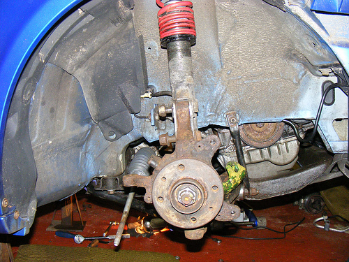

Suspension removed
038 by h3ppy, on Flickr

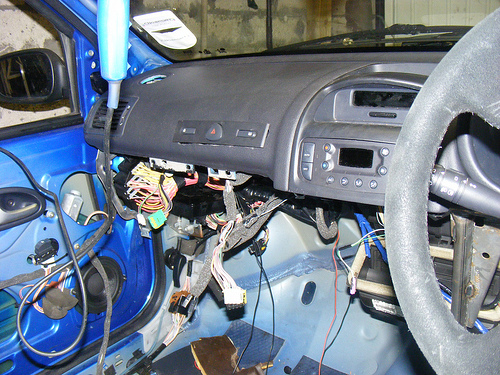

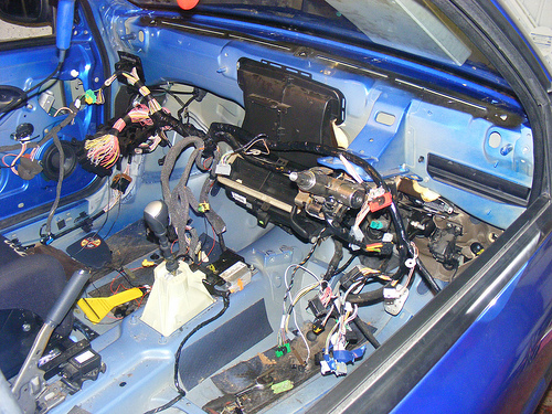

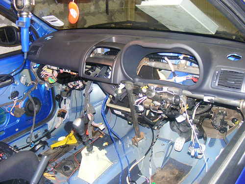

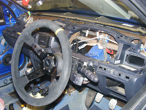

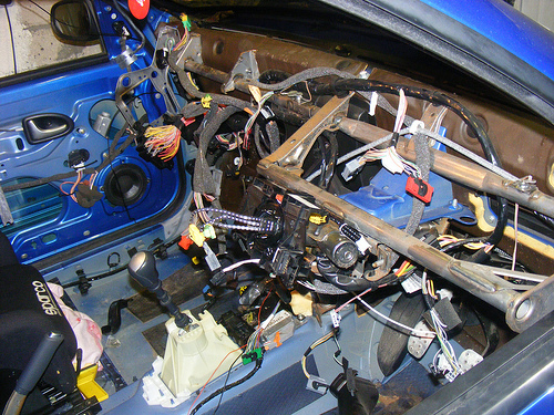

onto the interior....dash out
051 by h3ppy, on Flickr
053 by h3ppy, on Flickr
sound deadening out
055 by h3ppy, on Flickr

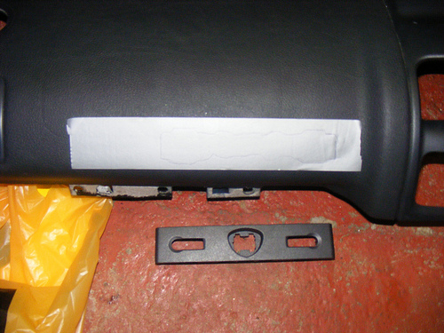

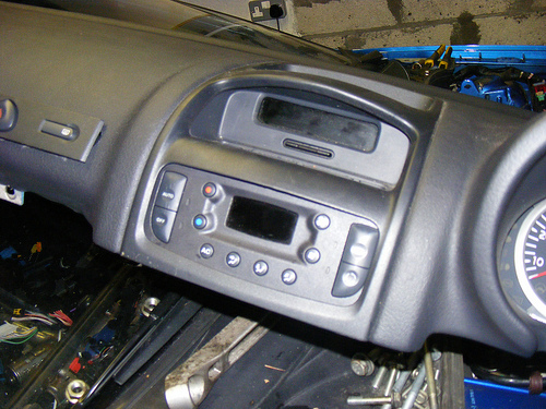

At this point i decided i would try something a bit different with the dash....i will let the pics do the talking!
058 by h3ppy, on Flickr
059 by h3ppy, on Flickr
005 by h3ppy, on Flickr
009 by h3ppy, on Flickr

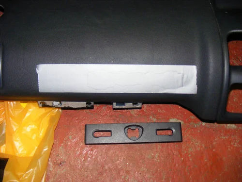

the dash is fitted with some brackets i made, im not too happy with the switch panel i cut out but apart from that it serves its purpose! will do until the stack dash and MK1 dash top go in later on in the year

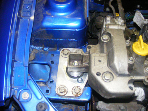

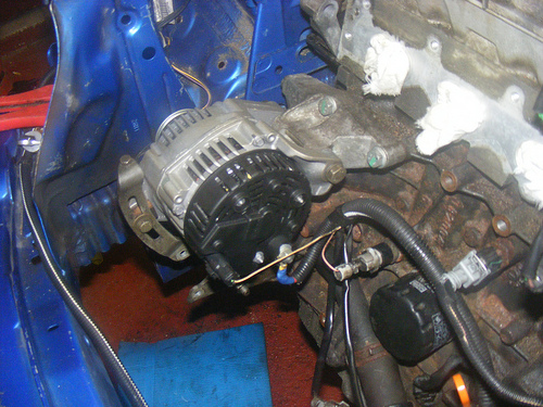

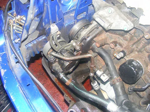

Also picked up some volvo brackets from the scrappy and tried fittin them with the PAS, failed miserably!
013 by h3ppy, on Flickr

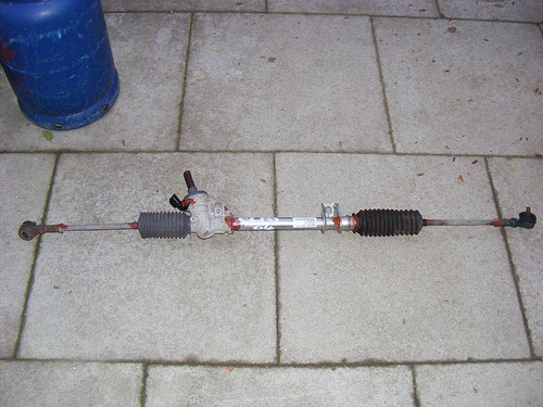

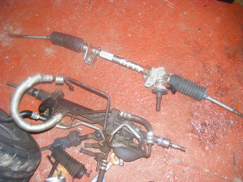

so i scrapped that and got myself a DCI rack!
018 by h3ppy, on Flickr

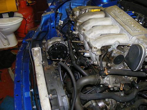

so cup alternator it was, volvo brackets work a treat!
201 by h3ppy, on Flickr

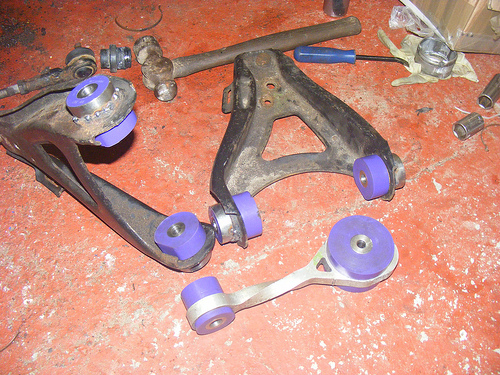

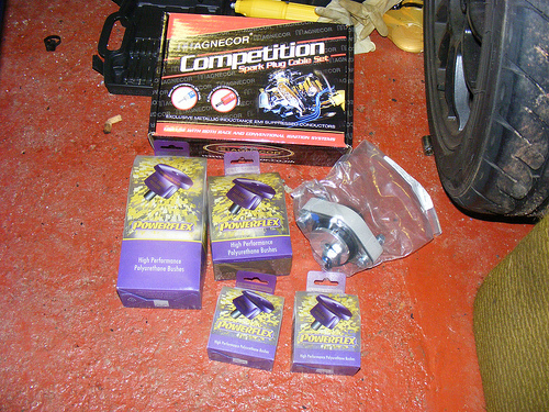

New vibratechnics mounts
023 by h3ppy, on Flickr

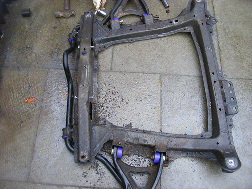

Powerflex bushes for the front end
212 by h3ppy, on Flickr
216 by h3ppy, on Flickr
Swapped the 182 track on the DCI rack, fair old weight saving here
215 by h3ppy, on Flickr

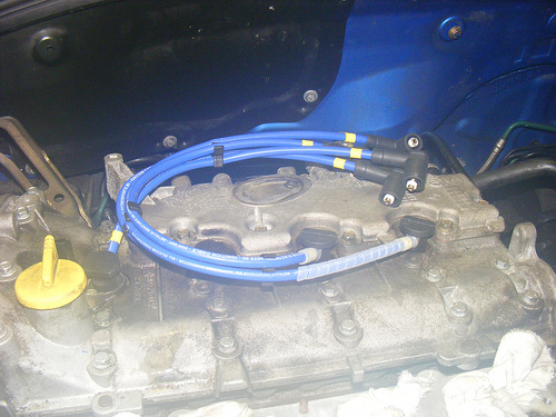

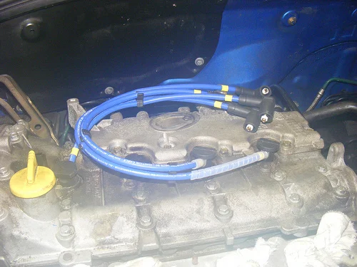

New plugs and leads
213 by h3ppy, on Flickr

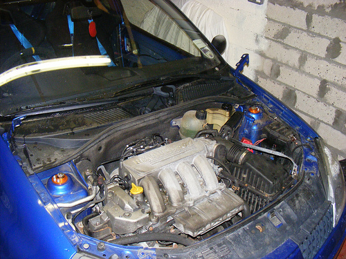

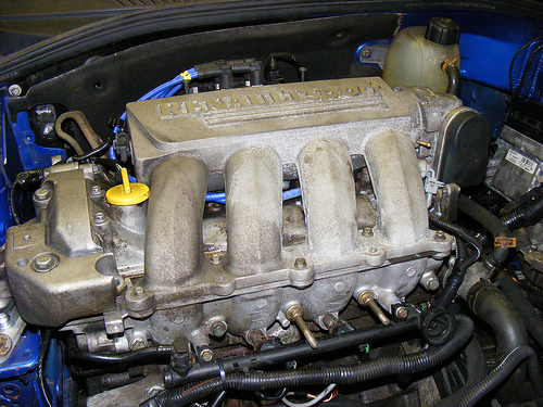

Inlets back on
226 by h3ppy, on Flickr
Radiator back in place
228 by h3ppy, on Flickr
Suspension built back up
230 by h3ppy, on Flickr

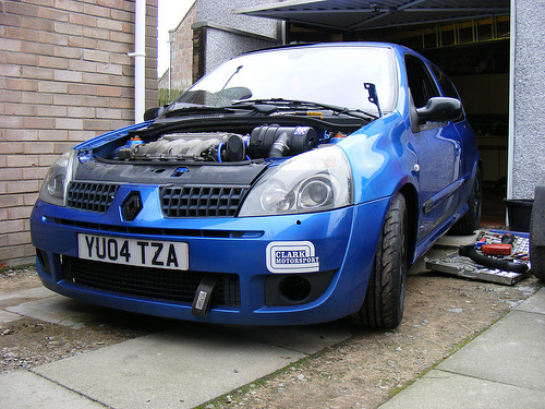

there is still so much to do, and i will update this thread as i go now instead of doing it like that crap above (sorry:rasp:)
comments/thoughts/questions welcome!

its a DCI steering rack which is a manual steering rack. Removes the PAS. simple as that!

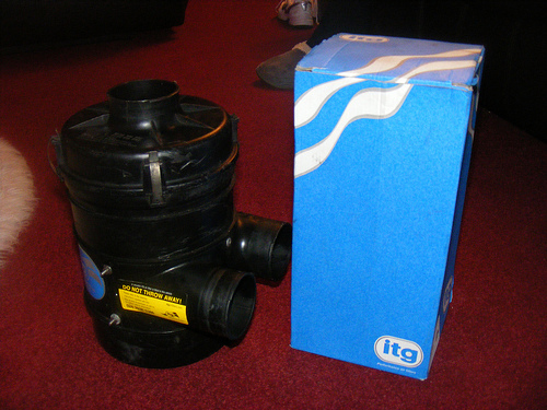

Gto the ECU securely fixed down last night, picked up my 172 airbox and ITG filter (huge thanks to Gogsie!) and started building the front end back up again!

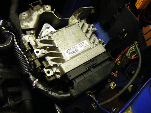

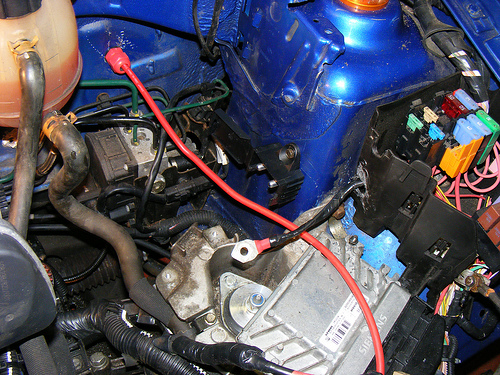

Update

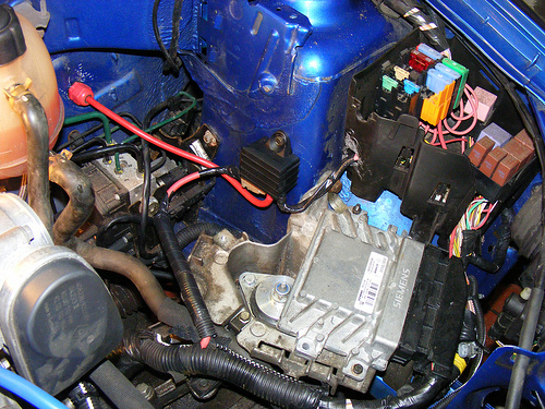

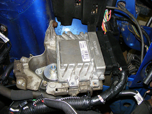

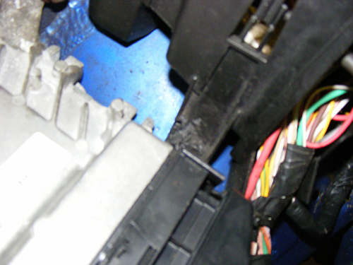

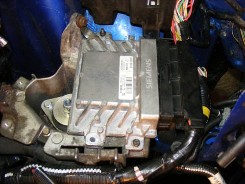

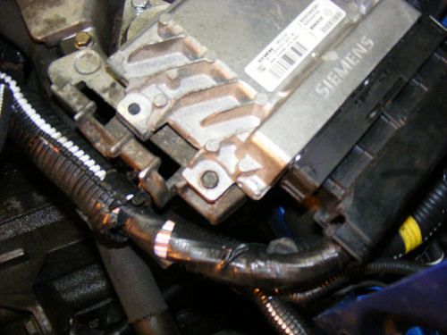

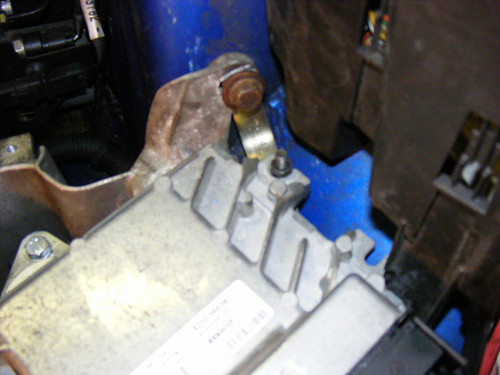

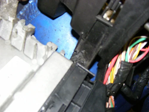

When removing the battery and the standard airbox the brackets that hold the ecu are removed as well so i had to devise a way to fix it down again. Loads have people have done this, so heres what i done...
it naturally wanted to sit like this so thats how its going in!
001 by h3ppy, on Flickr
firstly i found a bolt that fits into an old thread for the battery mount, on the gearbox mount

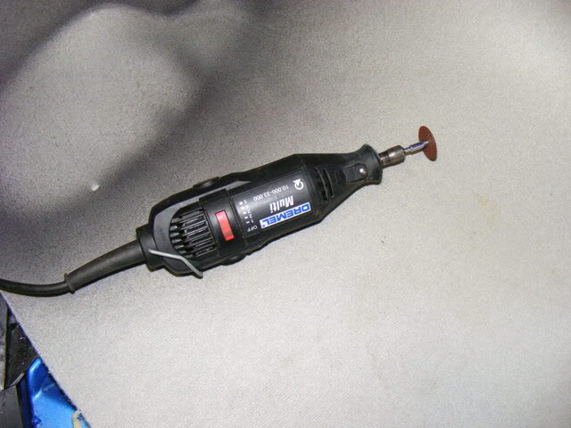

i then found that the fuse box was in the way a bit so trimmed a few mm off, rubbish picture but you can just make out where i trimmed it
003 by h3ppy, on Flickr
i then made a small bracket to hold the other side of the ecu and bolted it down
006 by h3ppy, on Flickr
007 by h3ppy, on Flickr
Job done! i also put some foam like material i found lying about underneath it to take some of the vibration just incase!

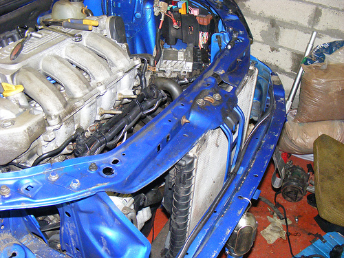

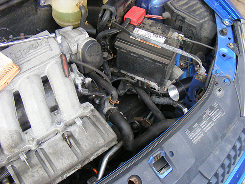

next i built the front end up a bit more, radiator now fixed in properly
010 by h3ppy, on Flickr
011 by h3ppy, on Flickr

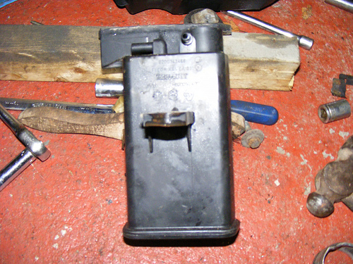

Carbon canister also removed

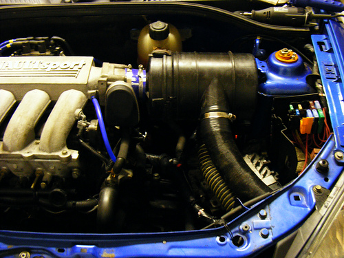

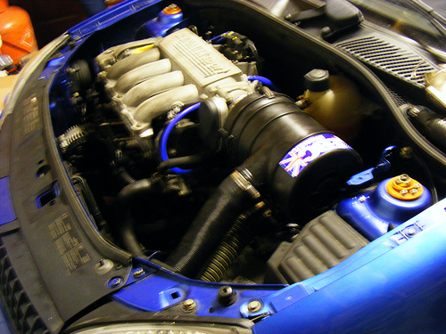

Then i went and picked up a few bits....
New induction setup courtesy of Gogsie :approve:

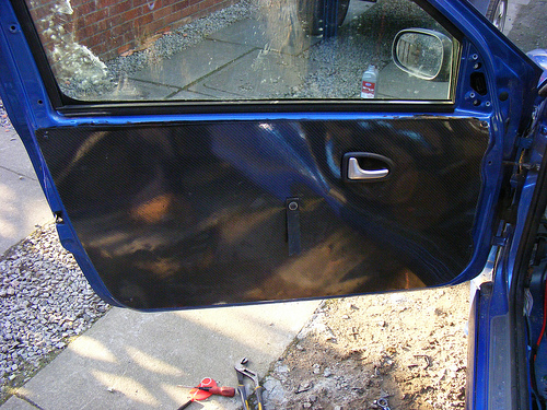

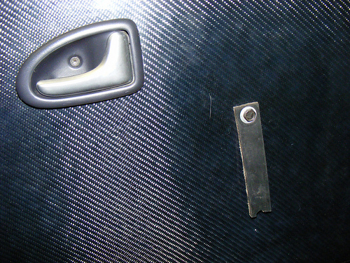

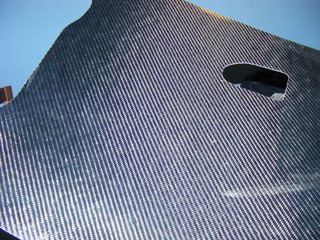

and my carbon doorcards, pish picture again!
Thoughts/comments welcome

Great work mate, Are you going to be running the airbox straight off the TB? I had that set up and it was great :)
  clio 182
I know I know, its a decent camera as well! I'm just useless! Lol if I had the patience I would do it properly and thos thread would be better, but I'm lazy when it comes to these things :rasp:
Cheers chris, its getting there slowly! Yea I will be running it of the throttle body with cold air ducts! Much better than the standard airbox :approve:
I'm leaving the engine at that with the decat and exhaust until I'm happy with the rest of the car, then I will have to decide if its n/a or boost ;)

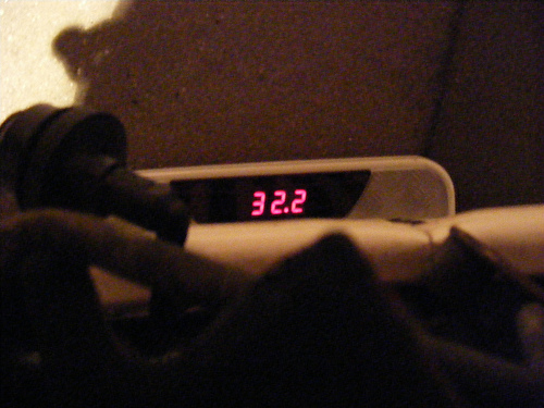

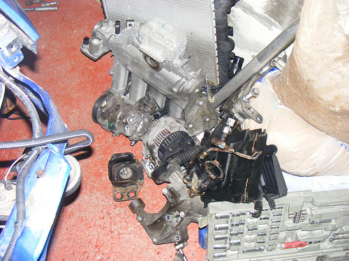

I weighed everthing I removed from the engine bay last night, aux set up, air con, pas pump, pas rack etc............
30.1kg!
That's just the engine bay as well, still got all the dash and interior to weigh! I'm chuffed!
more updates this week ;)

Good lad!! 30kg is very good weight reduction espicaly from the front of the car. Mine won't be as much as I removed some bits earlier on last year. Can't wait to weigh
My car lol. So when's your car coming back on the road? I can't remember if I've asked you!
  clio 182
Thanks, I'm surprised it was that much! Hoping to weigh the whole car soon!

Few pics
The pile of stuff removed
037 by h3ppy, on Flickr
and the weight
040 by h3ppy, on Flickr
very happy with that weight lost :approve:

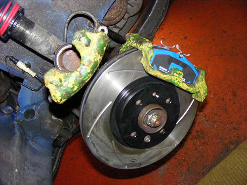

New brakes fitted
030 by h3ppy, on Flickr
EBC blue stuff pads and Godspeed discs, some good reviews so thought i would go away from the DS2500 crowd and try them out! Will let you know how i get on with them!

They cost the same as what i got all that for!
If these arent that good thats what i will be getting!
  clio 182
Have a look in the Godspeed section mate, they sent out free sets for people to review and alot of the scooby/evo lads are apparently running these! We will soon see though, once i have been round the hill again i will post up a review!

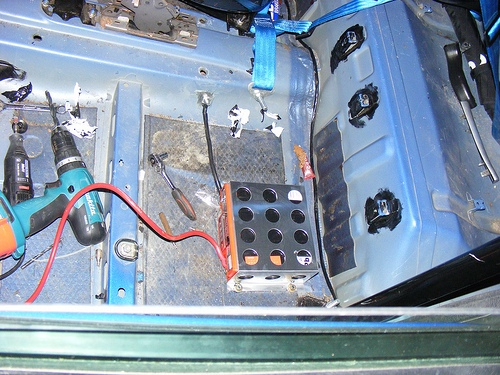

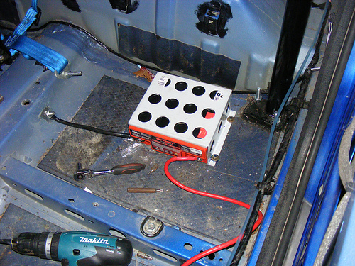

update time

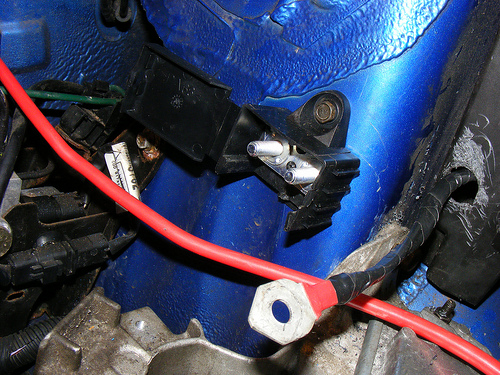

relocating battery using aquamarine box and odeyssey 25
hole through bulkead and cables moved in engine bay fuse box (excuse the marks around it, worlds worst holesaw was used)
Aqua marine joint box mounted
014 by h3ppy, on Flickr
Cables all joined up
Battery fitted behind passenger seat (tar will be removed at a later date)
032 by h3ppy, on Flickr
Carbon doorcards on, i used self tapping screws and black caps so i can get into the door again. Rubber door handle FTW!
Induction set up on, 172 airbox with ITG filter! (poor pics i know)
028 by h3ppy, on Flickr

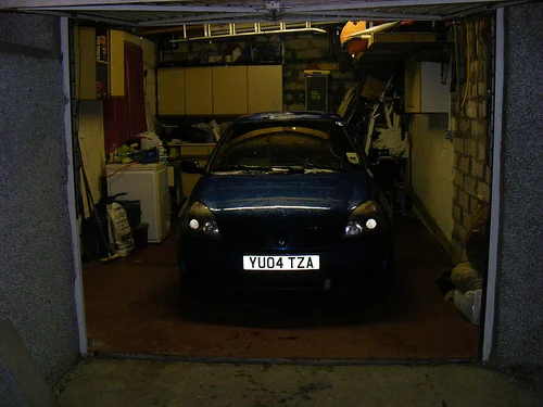

And out the Garage!
035 by h3ppy, on Flickr

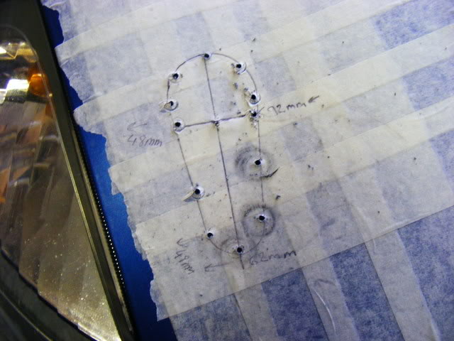

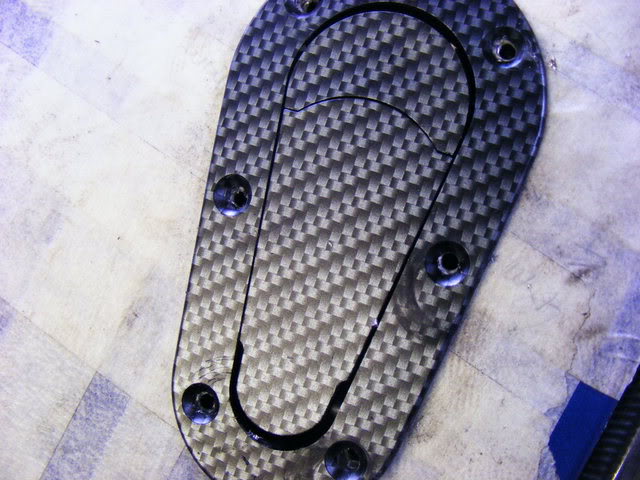

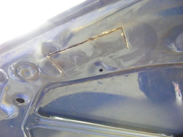

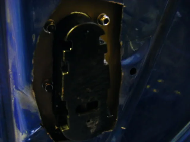

Next up was fitting my aerocatches in the bloody snow! Will let the pics do the talking, i may write a guide on it if i get time!
Did i say it was snowing when i was doing this!!
Anyway they are all done and im happy!
