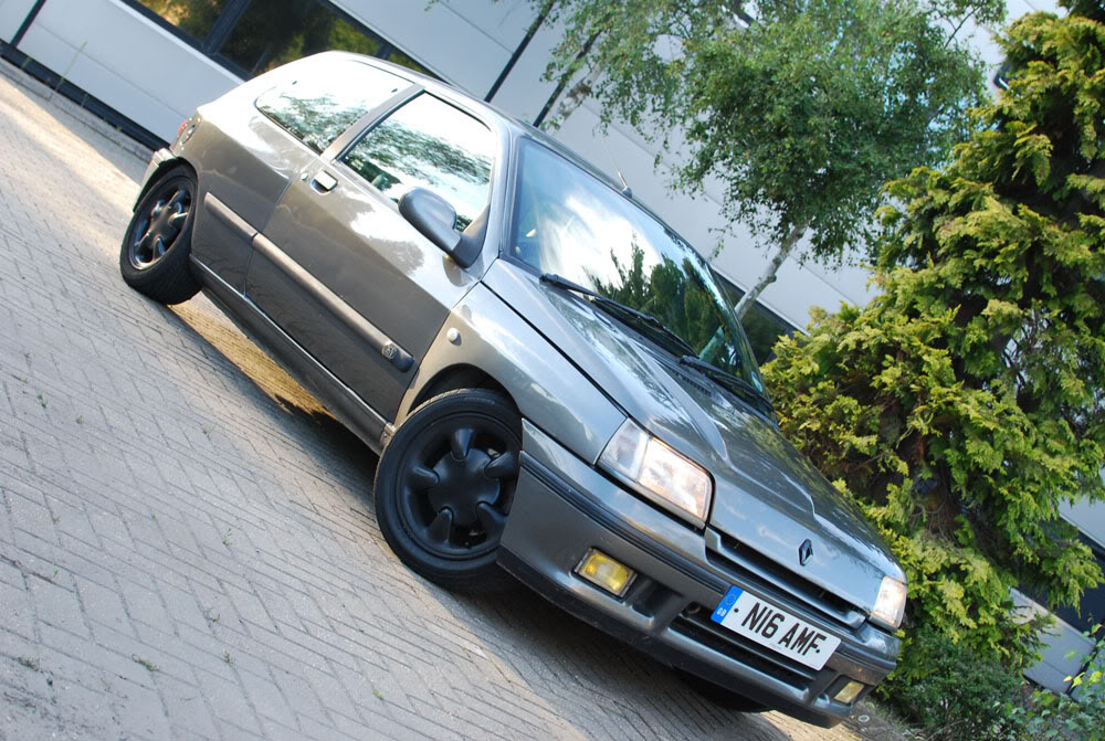

Hello all! recently got a grey valver and I thought I'd share with you updates with the car in this here thread.
As I bought the car:
not in the worst condition either, few rust patches but nothing to major, she was only bought as a toy as im due a company car :)

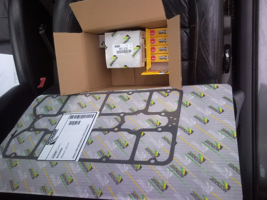

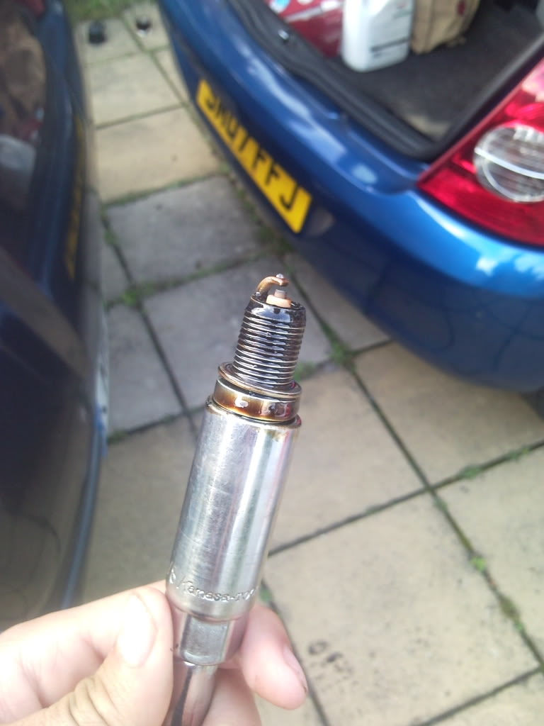

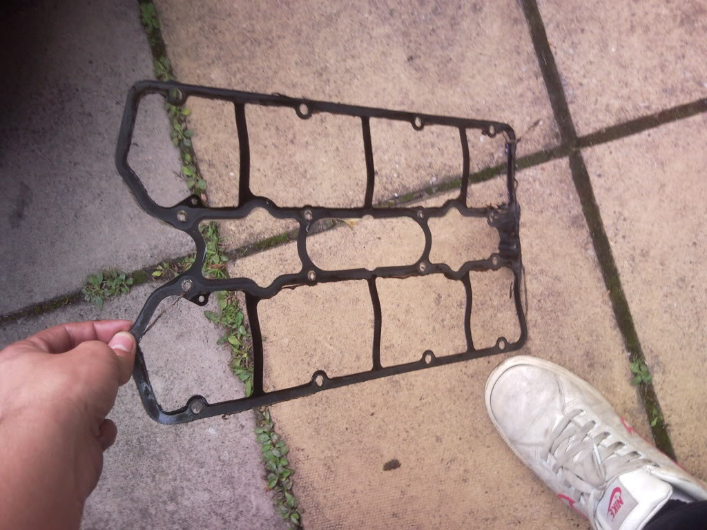

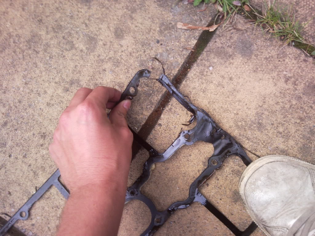

first things first, after a quick run the enginge liked to have a bit of a fit and felt like it wanted to stall and would be very jolty and unpredictable, after a bit of research I found out that I wasnt the only one to have this problem, so a new rocker cover gaskit was ordered, as was new plugs, rotor arm and dizzy cap.

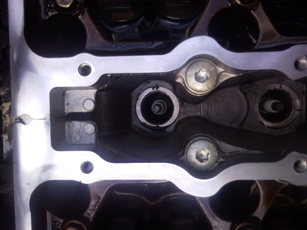

The old gaskit was hmmmm a bit old, and split
spark plugs were swimming in oil,
so cleaned out the spark plug housing and put the new plugs in.

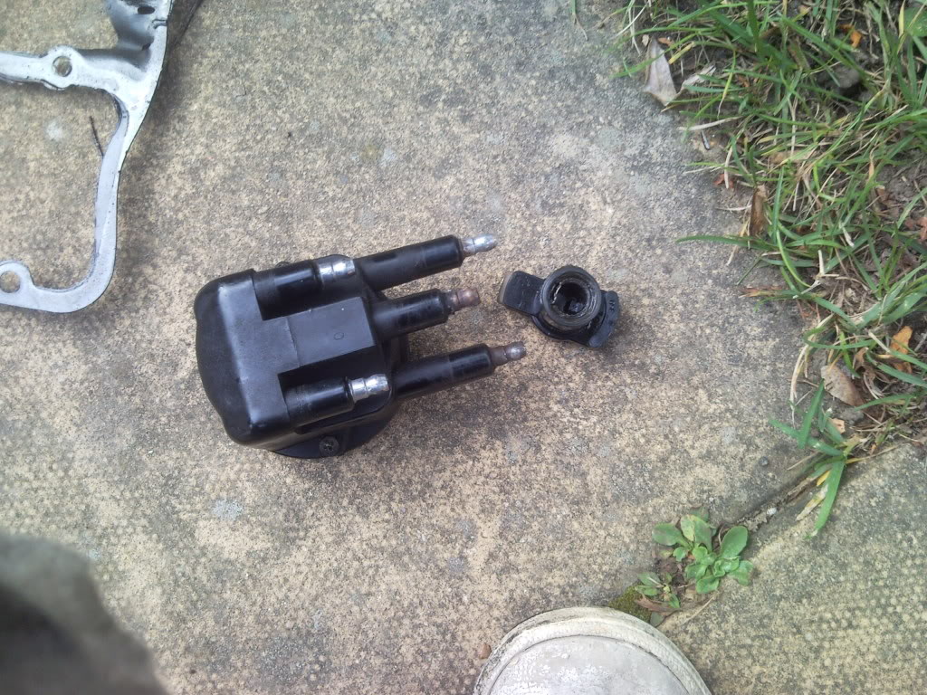

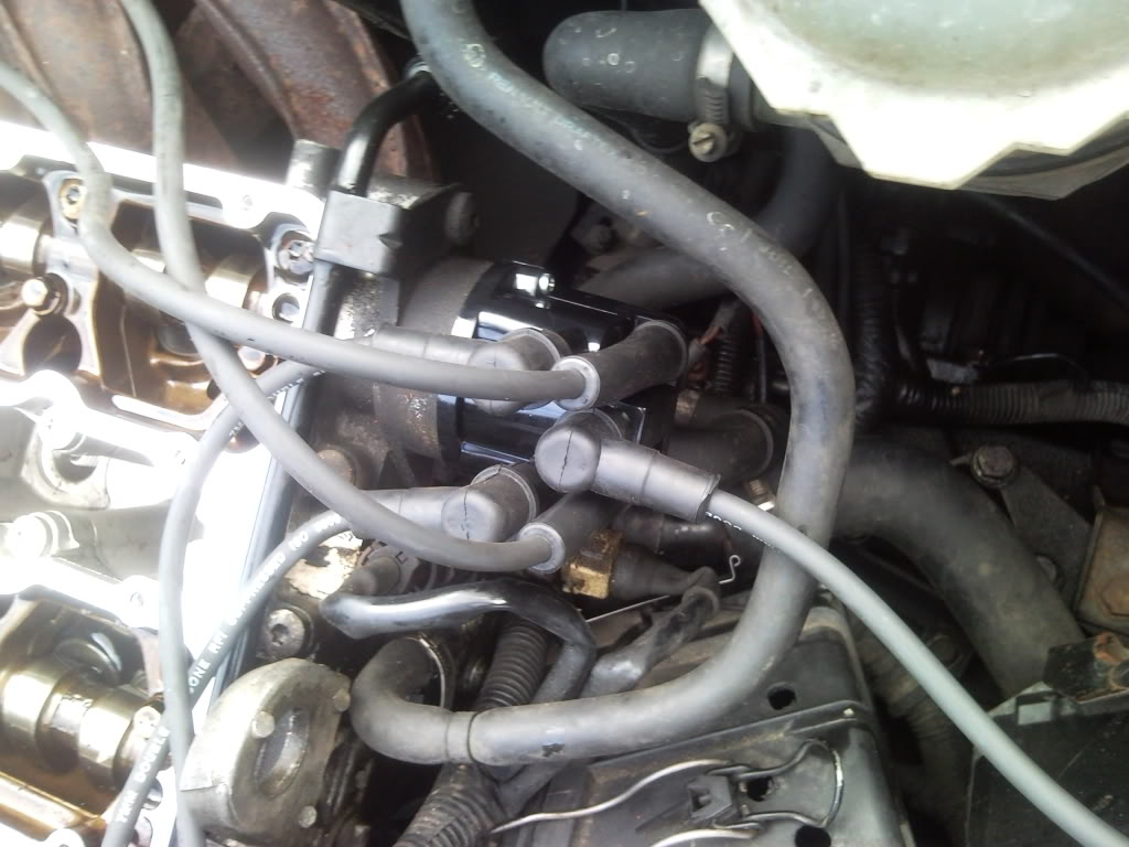

Old dizzy and rotor arm:
and the new one on :approve:
She now runs so much smooother!

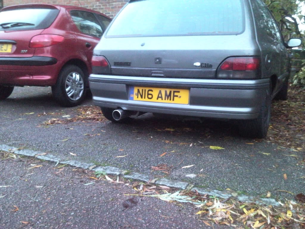

relitivly small update for you, Clutch was fixed, went to test it, got half way down the road and the car came to a halt along with a massive bang, a week later and it was back up and running :) fly wheel sensor had got dirty and wasnt working properly, so fixed that and also got round to adding some aditions i had bought.

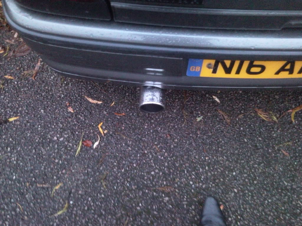

Magnex cat back system was put on as the old system was a home made side exit, ghetto but awsomes, flames n tings! a hell of a lot quieter and much more bareable for day to day driving! still pops and flames too :)
may need a bit of tweeking to get it sitting exactly in the middle of the recess tho.

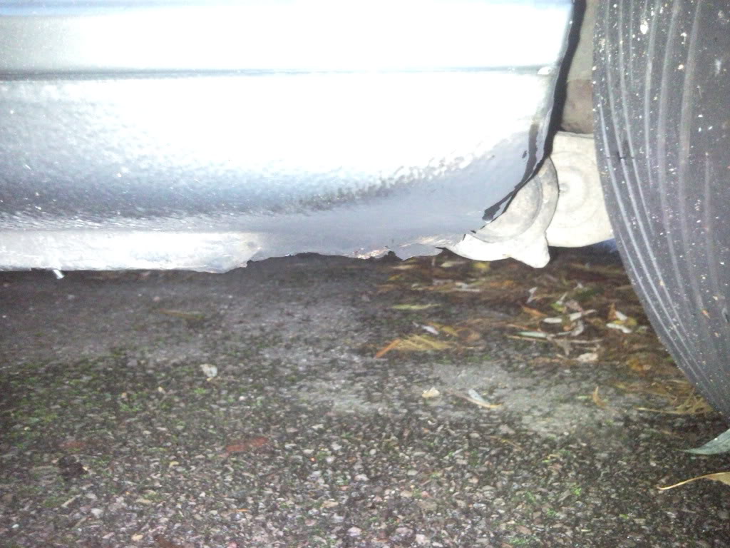

and the mess the old one left!

that looks like a mongoose exhaust a magnex has an oval back box. mongoose's sound awesome but fit like a pile of s**t and bang on the rear beam.
glad you sorted it out.
  Petrol Blue 182.
mongoose! thats the one lol doh! i was trying to think and couldnt lol, yeah it rattles if i have some one in the back lol, cheers for the help btw with the problem :)

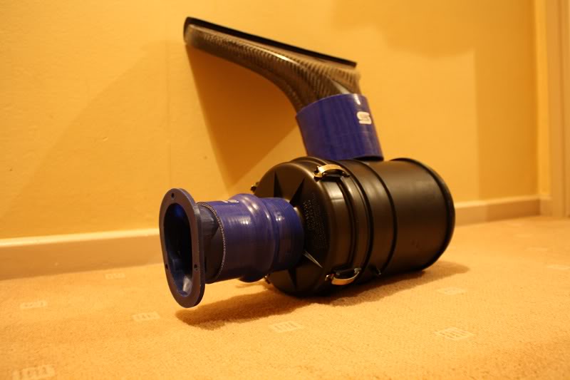

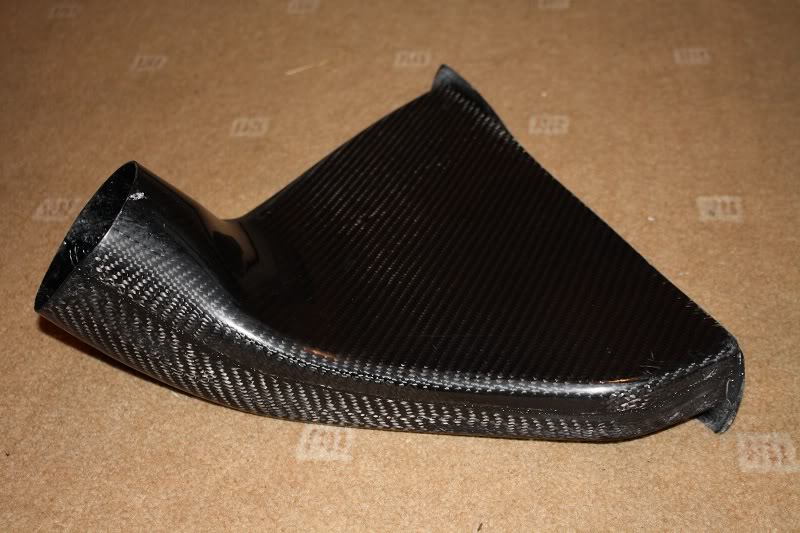

got a set of turbines today :) curtasy of nick 172 cup! and will hopefully have all the pieces needed for my Group N rally induction set up by x-mas! gota wait for the parts to be shipped from france :(
  R14 CUP
You can get them made up yourself, there is a thread on WC about the scoups that fit in the scuttle, and you can just use a v6 airbox.

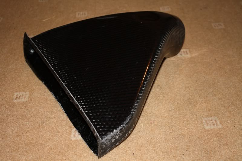

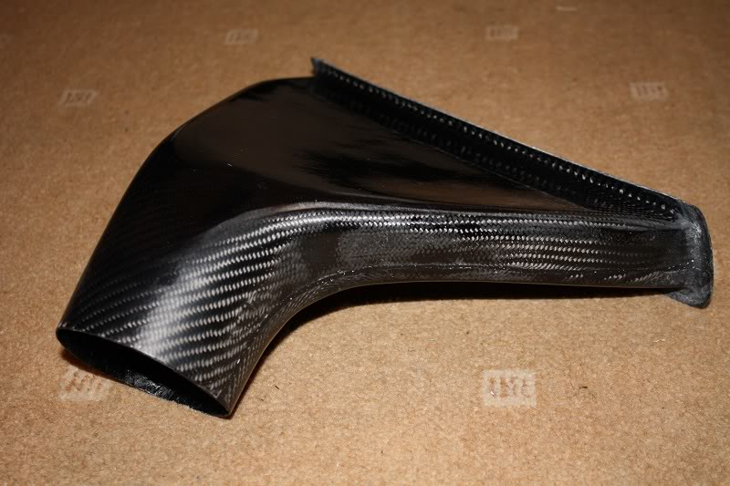

got it from wests on here £63 :) the scuttle scoop still smells of fibreglass lol im getting high pmsl, theres only one problem with it, looks like it took a dent on the bend, you can see it in the pics, shame but still well worth the money! going to have to give the engine bay a spruce up now!
Thats very cheap! Cheaper than what my mate can get them for me and he 'says' that its cost price plus 5%! Just find a local guy off clio16valver and ask to borrow his cat! Cheeky but you only need it for one day, seeing as your not paying for the MOT then you could get him beers as a thank you!
Also Ryan, when you get that airbox have you got an aftermarket filter for it? If so any chance I could have the standard? ;) Need a new filter for my Ph1 airbox on the Meg!

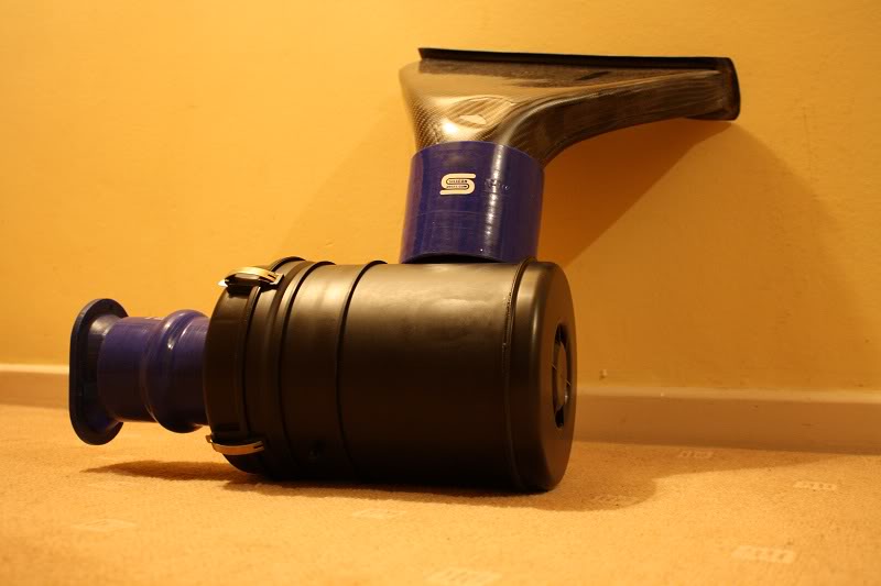

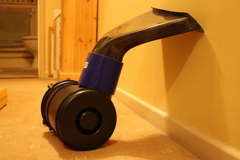

Air box came today, thank you West Renault! awsome service :)
few pics of it assembled, just need a few more pieces of the puzzle now and shell be ready :evil:

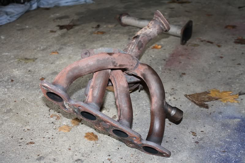

working for the RR now mate :( so wont be going unfortunatly, mots still a no go, put a cat on today but still failed on emisions :S has a blow from the manifold so gna have to sort that and re try

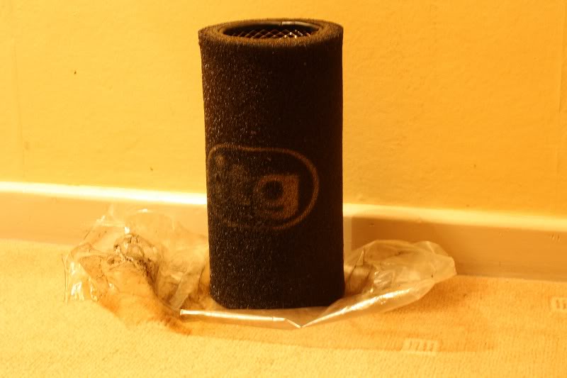

got my ITG filer threw in the post today aswell :)

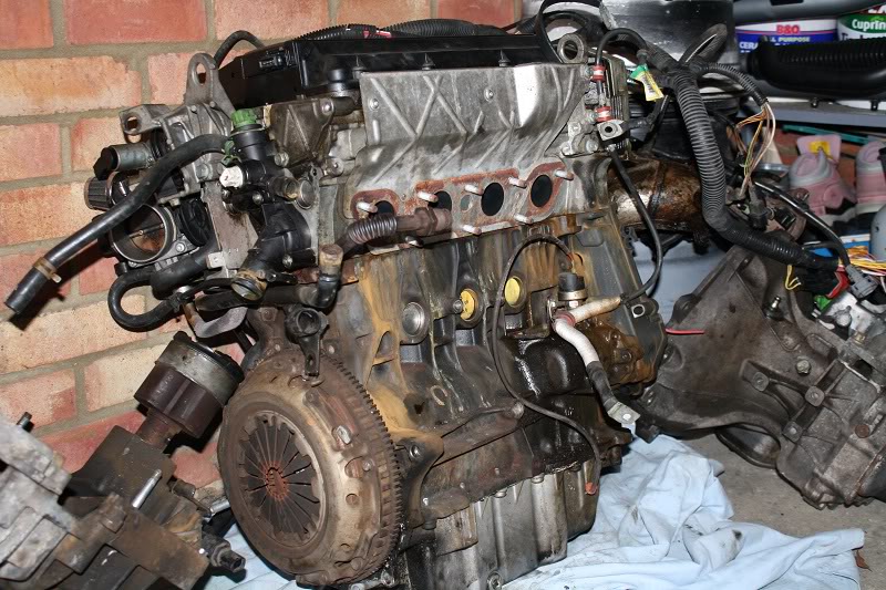

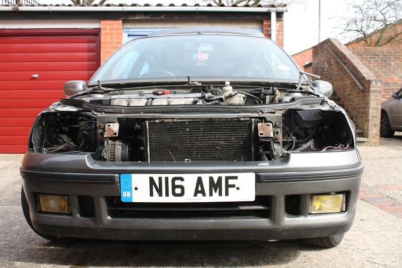

picked this up thursday evening.
only had an hour this morning to make a start....

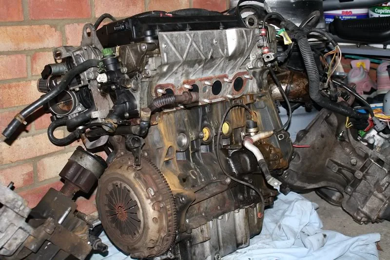

massive thanks to nick172cup for the engine and box. this will keep me busy for the next couple of months!
Struggler
  Ph1 track 172
ahh ic, are the megane f7r's much different from the williams F7r's?? as it looks like you have a completely spherical throttle body on that!
  Petrol Blue 182.
bigger valves in the head for more tourque, and a chain driven oil pump, oh and it runs off coil pack, not dizzy
Struggler
  Ph1 track 172
that sounds much better than the williams engine!
what sort of power do they push??
