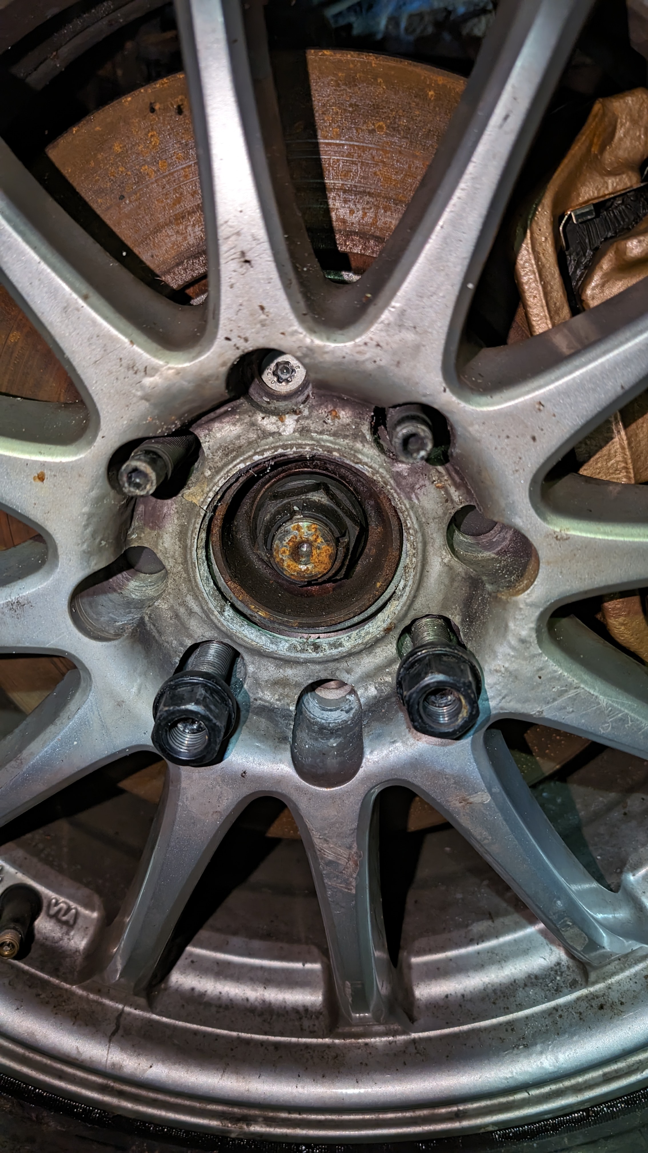

Got a super cheap set of alloys off Facebook and ordered some semi slicks. The specs of the alloys seemed perfect, 15", 6.5 inch wide and et38. They are multi fit 4x100 and 4x108 so didn't see an issue with them.
Test fitted them tonight "just incase" and shock horror there's an issue. The bore where the wheel nuts go are too narrow for my pms stud and nut kit!
Any issue with me getting narrower wheel nuts? And what's the thread? M12?

Found a decent set of spline drive wheel nuts. Steel as well tested to 400nm of torque according to the ad.
I'll update if I get any issues
