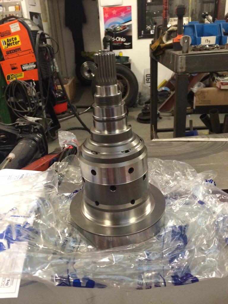

I just took delivery of this little beauty, which is getting fitted in to box on Friday, before I take the car over.
Looks like a reasonably straight forward fit. a bit of machining to fit a couple of ball bearings, to hold it in place.

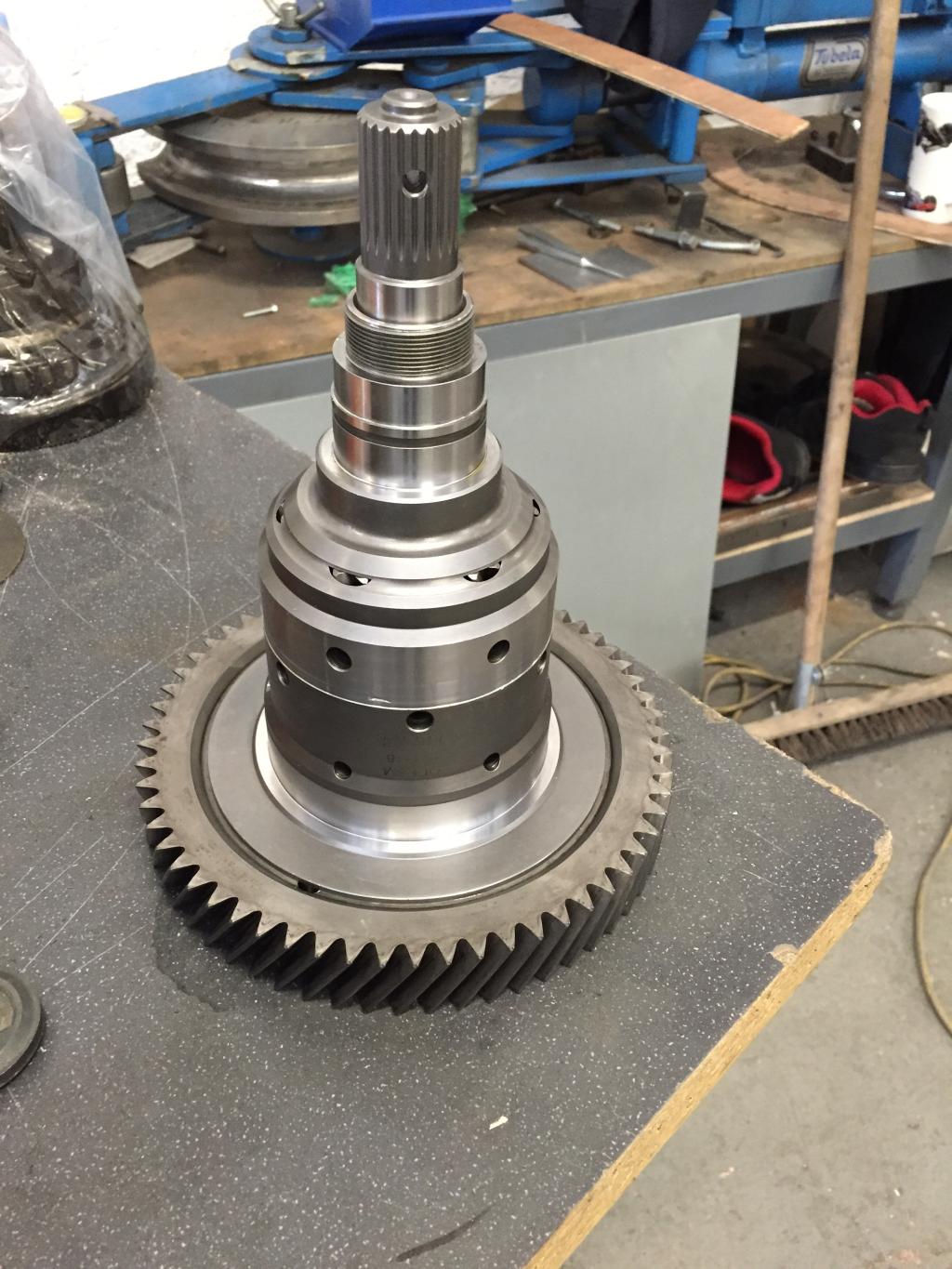

The crownwheel is also glued on with some special stuff when Quaife fit the crownwheel for you mate.
They usually do that as part of the price? Or at least they do when I've supplied them.

We got the crown wheel fitted to the Quaife LSD, and got it back this morning

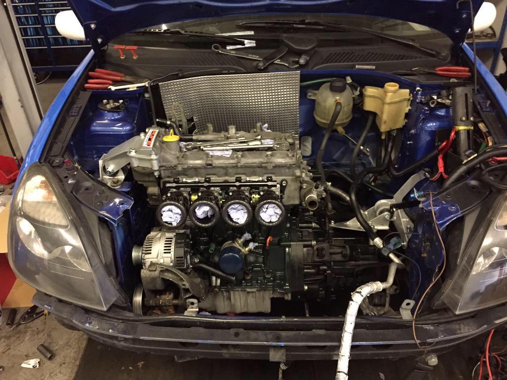

We went for Titan Throttle Bodies in the end, which are fitted, and will be sorted properly when the engines in, with the new loom and ECU. Also having all the electrics move in to the front, out of the bay.

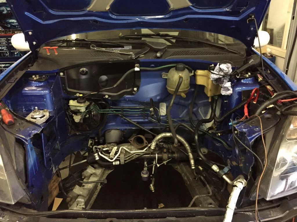

A good days progress.

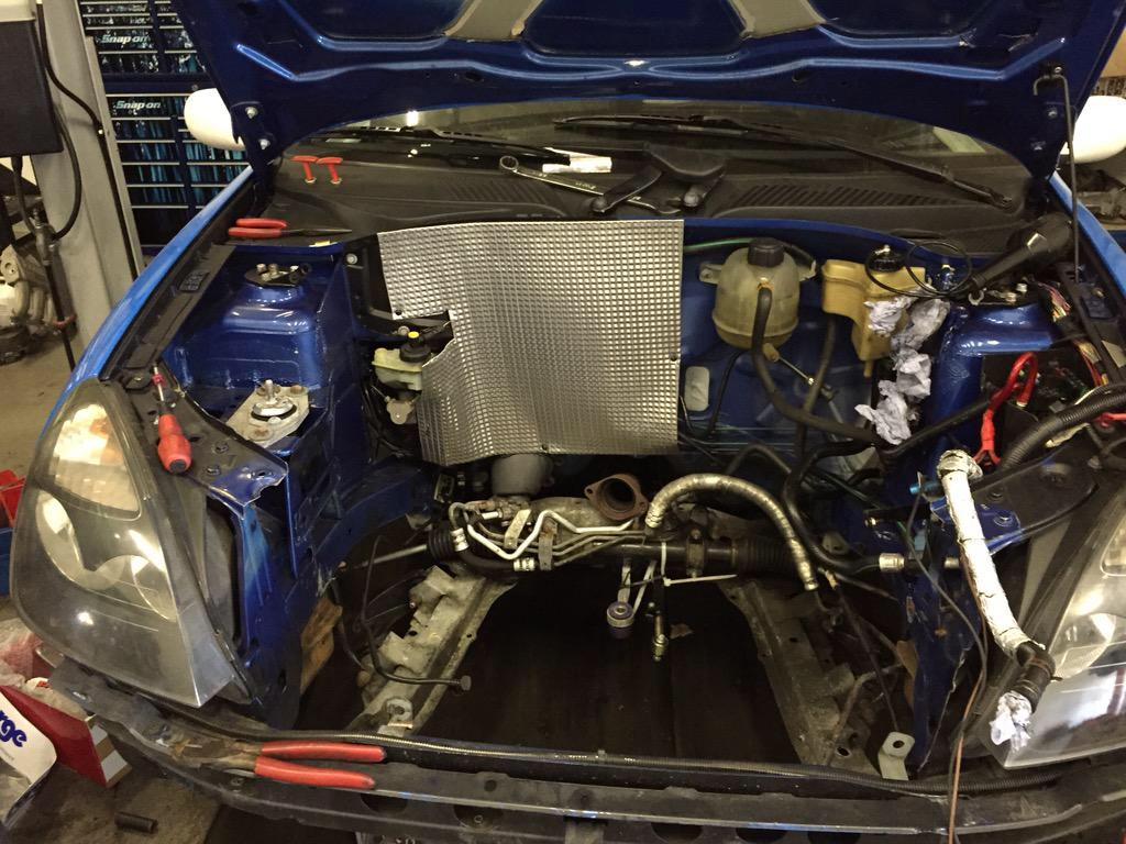

Firstly, we had a quick tidy up of the engine bay. It wasn't actually in a bad way, just a spring clean really.
Then, we fit a heat shield for the break pipes.
Then get the engine in! Went in nice and easily, and the PMS engine mounts are an awesome bit of kit! I know I've not driven with them on, but they just fit perfect and incredibly solid!

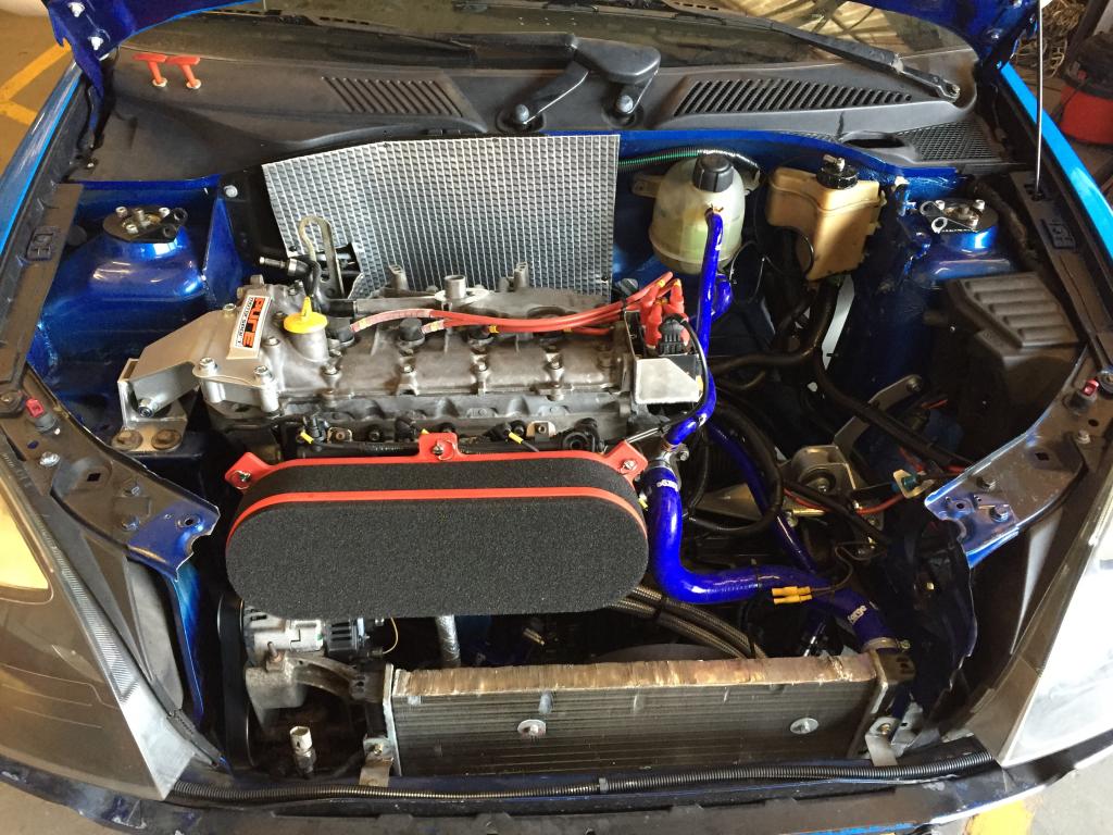

Still plenty to do. A new engine loom is going in at the moment, ready for the new ECU and map. Also moved the bulk of the electrics through to the front, to keep them away from water, and allow easier access.
I was suprised by how much of the the old loom that we cut out! If I estimated, I'd say about 60% has gone! It really does make these things look a lot less complicated when there are less wires!
After today, I feel confident that it'll be ready for Saturday's Tricolore Trophy Launch day. Won't be running at full pelt, as the fresh engine needs a bit of a run in. It'll have a couple of hours on the Dyno, as I obviously can't take it on the roads!

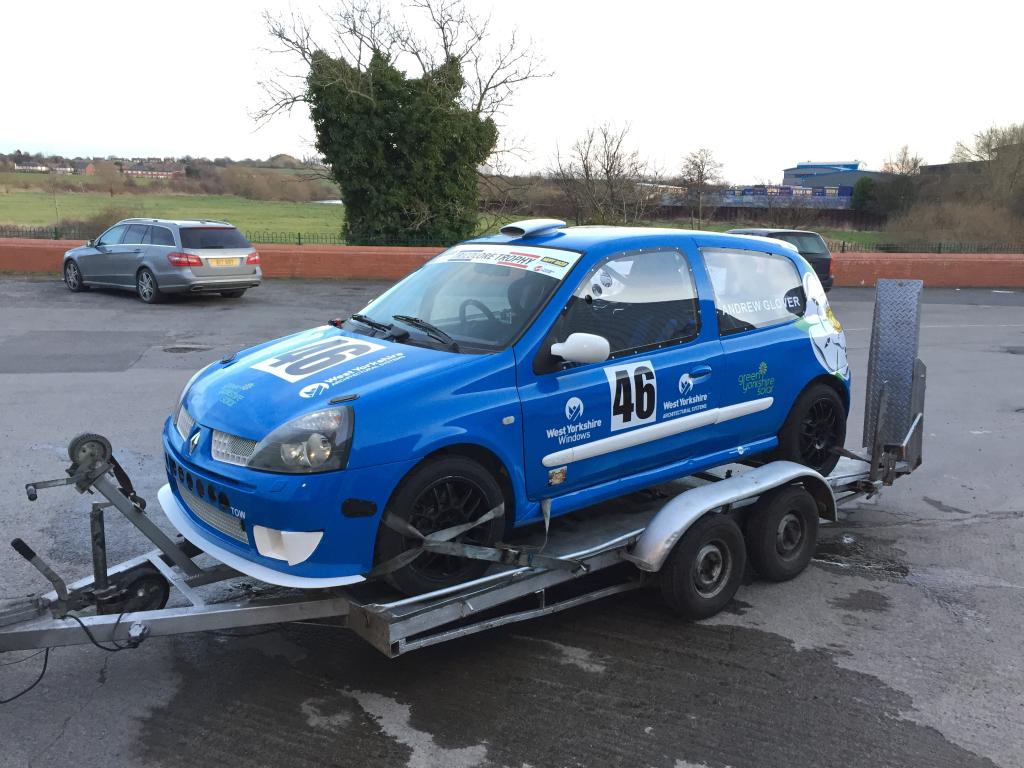

Firstly, got the car back from RS, all finished and ready to go. We limited it to 6000 rpm, as it'd only had an hour or so on the dyno, to get a bit more running in done at Rockingham.
The Titan Bodies, look the dogs! I feel you lose so of the look with the filter on, but the carbon really does make the engine look good!
We got the car back to our garage, got the springs changed, and fitted the spare seat, ready for some track fun!
I must say, I think the car looks really good!
