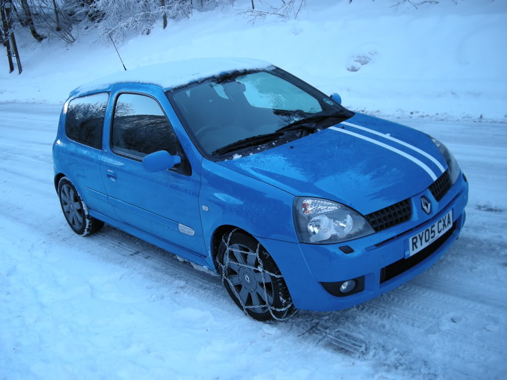

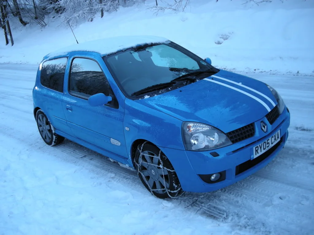

just getting about - i'd use chains if they'd fit :)
I've drove around Europe - did a lot in Switzerland and it's law there.
Chains do fit.....
I got it down to 2 mins per side for fitting in the end.

where did you get the chains from? do they not scratch the allows?
I got them from Halfrauds, only £55.
There is some potential for them to scratch the alloys, but they haven't yet.
I don't keep my car showroom clean, so i'm not fussed about scratches anymore.
