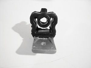

Im sure the standard OE eibach springs on the front and the cup rears are just as good as the cook sports.
Try looking at the centre exhaust hanger as it might be burst and the cat might be hanging low.
Renault have changed the hanger from a black rubber as shown to red.
I actually purchased one so have a new one line around so might change it for the sake of it.
