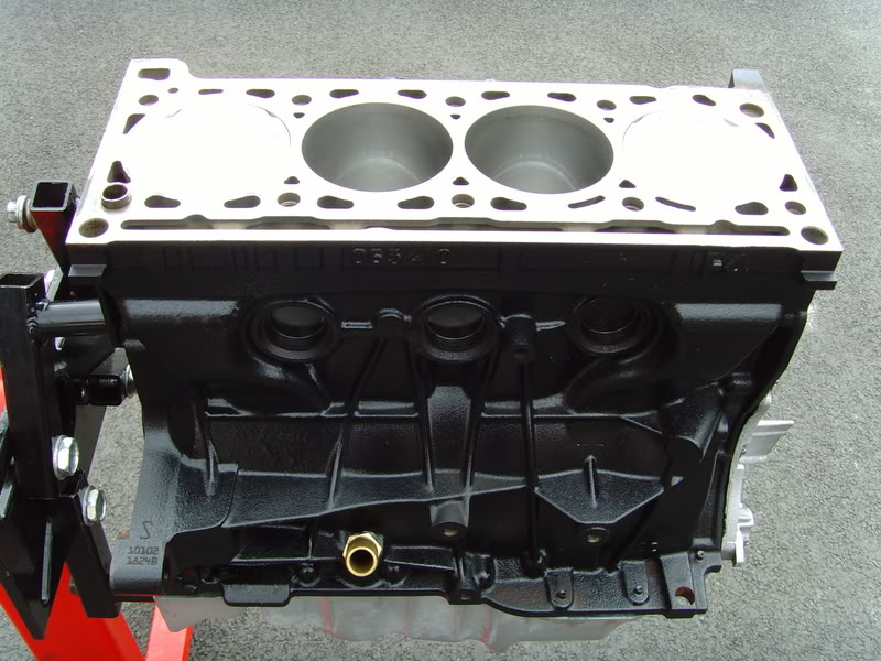

Mines directly on the back of the block putting it in line with the starter but on the other side of the block. It was done by ktec not got any pictures though sorry.
  Trophy,R26,GSXR1000

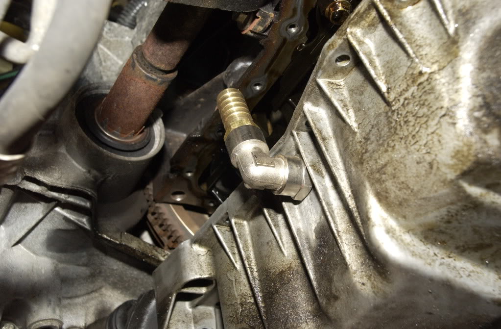

most common options,
  182/RS2/ Turbo/Mk1
Cheers! Going to go with the sump method, if that 90 degree fitting male ended and threaded into the sump?
The sump isnt really think enough to just tap and expect it to hold, so instead you will normally put a nut on the inside.
  Clio T 314hp c43 AMG
Ktec supplied it with there older kit, iirc it's just a household plumbing union, and you can tap directly into the sump without any issues as its not under any stress.
  172 cup, Impreza P1
I'm going to do what's on the second pic but get a weld on an10 fitting. Your drain should have a free flow into the sump but I found the level of the sump to be slightly higher if you return to sump so trying something different this time.
