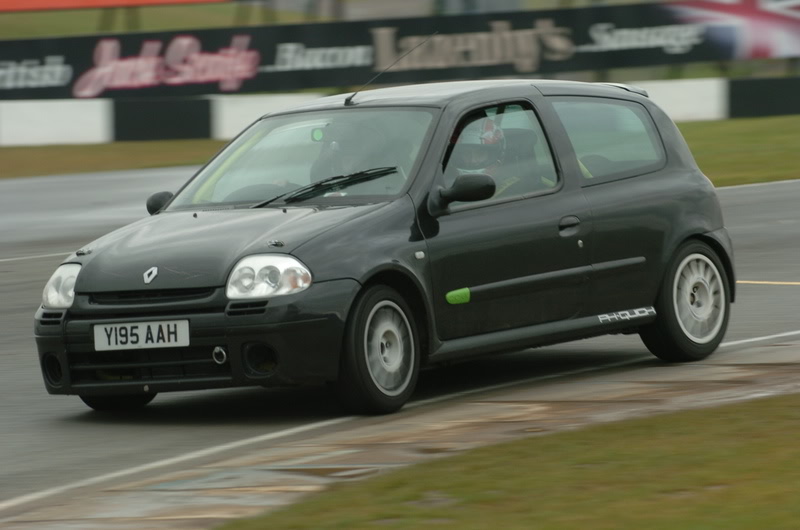

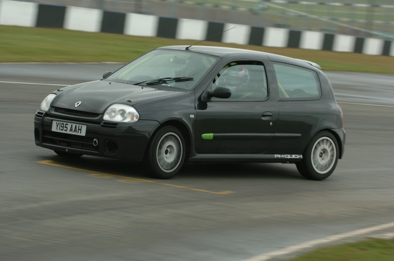

look at these pics! the front seems to be all over the place :S but the back looks planted
that was on fronts 225 lb rear 325 lb
  Mk2 172
the front is at a good hight, you can get your whole hand between the arch but it still has a good rake angle. when you jack the car up the shock only sets a futher 2 -3". so there is plenty of travel in the insert too
i will give the springs a try.. £56 a pop though :( i may get the car to leda? maybe they have differnt springs i could try etc, save me buying loads of others.
I seriously think your runnin out of suspension travel. Raise it up a tad. You got nothing to lose. Also make sure the back is stiffer than then the front. If its not then theres your problem!!!

il give it a bash tonight, the back is defo stiffer, its on 9 clicks and the springs are 100lbs harder
  Mk2 172
fronts too soft. 225lb bit low. 325 rears. too excessive. also depends on quality of suspension!!!
