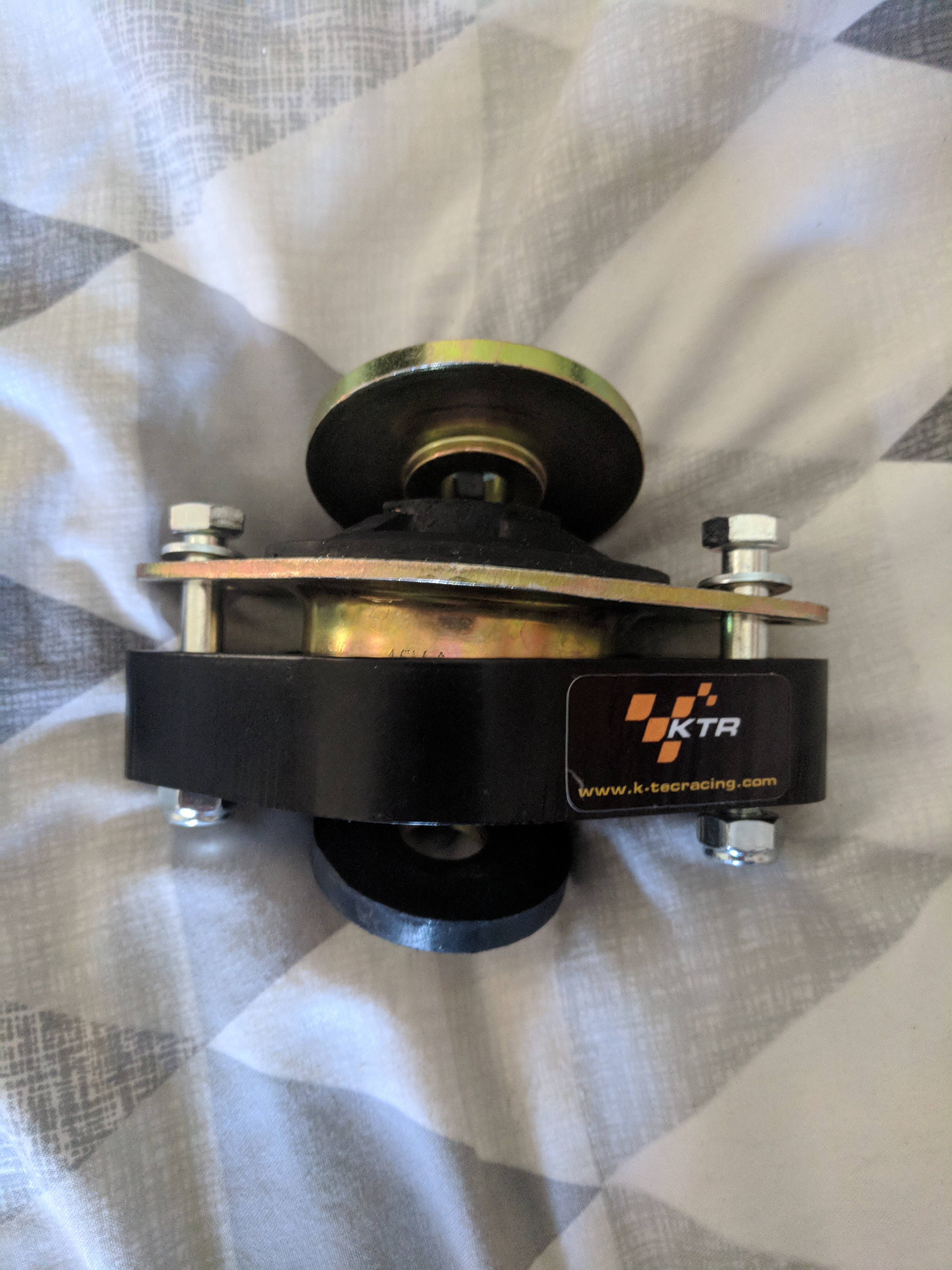

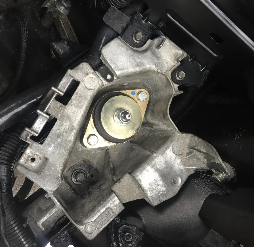

Has anyone run into a problem with some "float" in their vibra-technics gearbox mount? Effectively when everything is tight, there is some up/down play of the mount.
The problem i seem to have is that the spindle gearbox mount is too long, and the large washer on the top of the mount bottoms out on a larger diameter section of this spindle and tightens against that rather than the mount itself leaving it a bit loose.
Unfortunately i got this mount in 2011 just before the car was garaged and only just notice getting the engine out this weekend.
There is a chance this came off my MK1, does anyone have any experience with the interchangeability of these?
Struggler
  Ph1 track 172

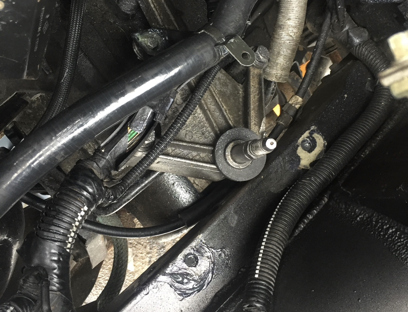

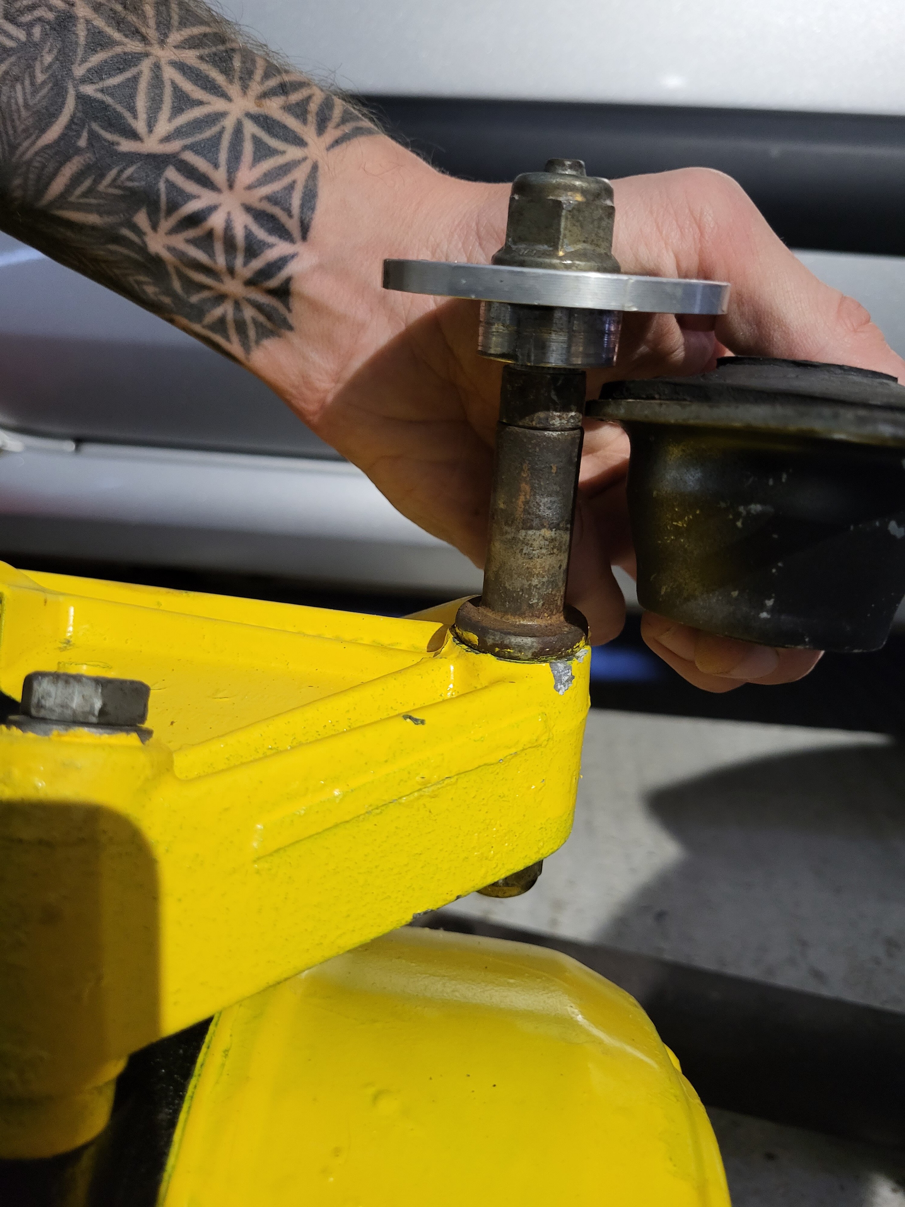

Adding a pic and a vid of the problem.
I wonder if i am missing a lower washer similar to the top to space out a bit?

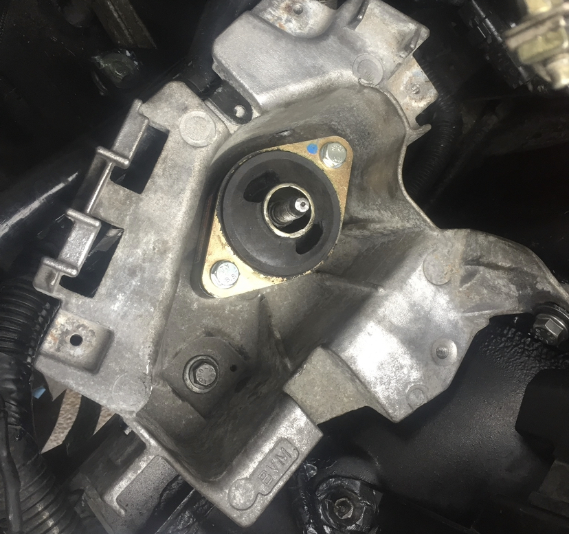

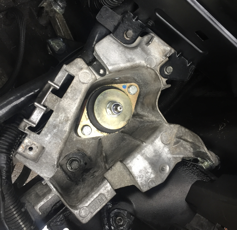

Mr Underhill
Just wracking my brain as to whether there’s a metal spacer or washer at the bottom. I don't think it did tbh.
Here’s my installation
Mine had a washer above the nut. No issues with play.
Struggler
  Ph1 track 172
ahh, this might be the answer to my woes. I wonder if I'll be able to get my hands on just this lower part or if i will be pushed to get a whole new mount.
