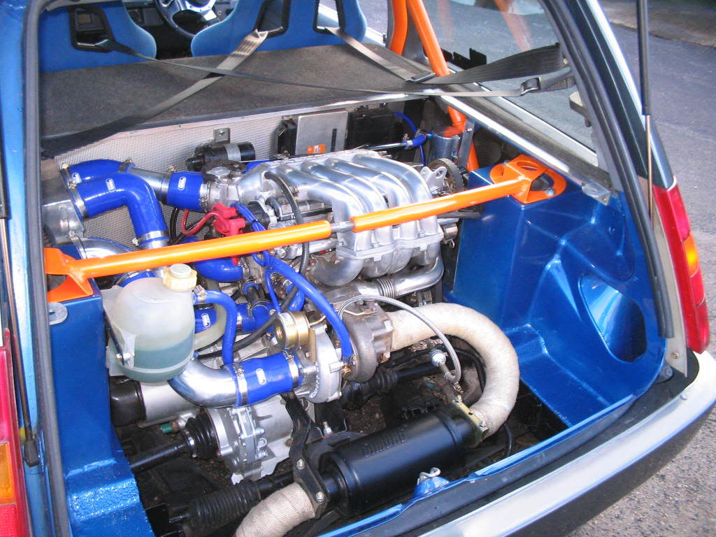

if you ever need any in depth tuning advise just PM me mate, i had a highly tuned 480 lump in my RWD/mid engined R5GTT
norm
Is Haz still about Norm? I remember 200bhp+ being mentioned!
AII mate haz is a good mate of mine:)....hes doing alot more car spraying these days as obviously theres more money to be earned:)
my B18ft was running cirra 260hp with 1.4 bar of boost, so yeah certainly allot of power to be had:cool:
haz's 5 is pushing near 300 these days, hes gone posh to! hes resprayed his 5 merc gray with a floresant orange body kit:cool:

^^ spent around 8k on the blue 5 mate:)
