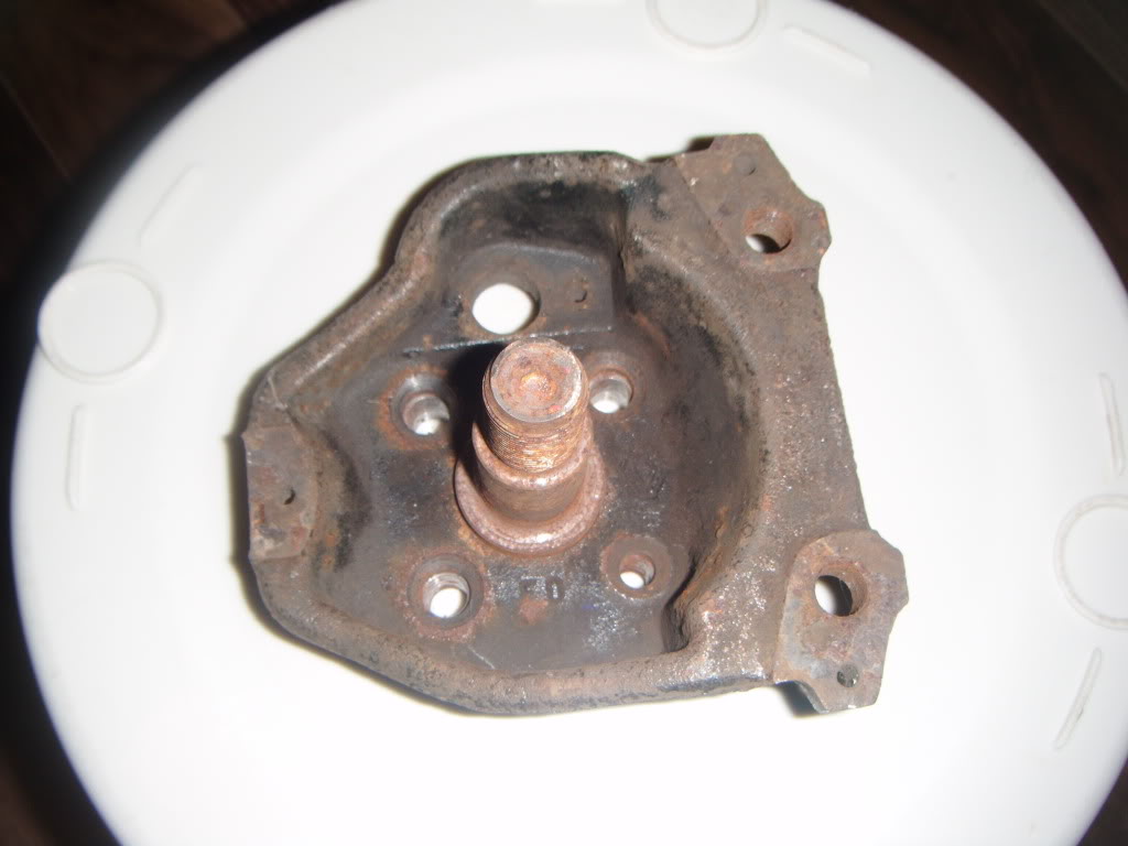

Managed to get pics of the stub shaft and I'm pretty sure its the NS I have. Its been in the garage for a year or so and Ive never fitted but looks in good nick other than some surface rust which will rub up ok.
Before you buy any you should take yours apart as the stub can come out the housing. You may be able to see where it is bent and get it straightened?
Anyway, here is the pics:
Let me know if you're still interested.

It is one piece but only as the stub shaft part is pressed it to the carrier part. I think the bolts are where its strength comes from.

Just had a check - not had chance to get the caliper/disc off yet but I think that one looks like a drivers/OS side, given the position of the axle compared with the caliper mount and also the large (non countersunk) hole being at the bottom rather than the top. Thanks though!
  172 cup, Impreza P1
I've checked mate next to mine and it is definitely the passenger side. The stub axle is free to be put in either side, I may have just put it in the wrong way in the pic.

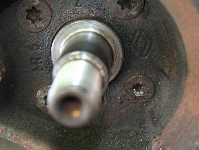

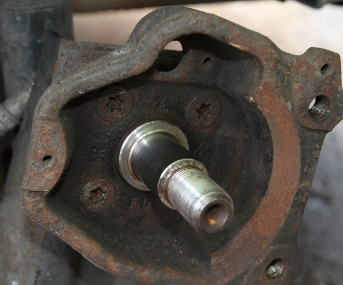

Got part way through then remembered what a mess one of the stub axle bolts was (not me officer!) - decided to re-assemble and fight it again another non-rainy evening, and order some new bolts...
This is what I've got though (yours is a NS then Cupman - sorry for the confusion there):

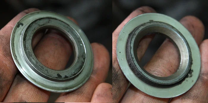

And here's the spacer that sits between the bearing and the stub.
Looks to me like the stub axle should have a matching taper to the washer..? It doesn't sit at all well with the taper facing the bearing, so surely the taper has to face in towards the beam... If the beam had a matching taper that would help keep the hub nut tight too.
Edit: Can't quite tell from your pic Cupman, but that axle doesn't look quite the same as the (almost certainly) incorrect one I have on the car at the moment. There also appears to be a very small gap around the base of the one on my car, whereas the one in your pic fits well. Looks like changing the stub might be the way to go, if I can get that fecked bolt out.
Jack - whereabouts are the rear axle bushes you mentioned? Edit again: Found what they look like, but not sure where they are located... trying to find exploded diagrams of the rear end now: http://cgi.ebay.co.uk/RENAULT-CLIO-MK2-1998-2005-REAR-AXLE-MOUNTING-BUSH-X-2-/230510025776

Indeed - pretty sure the stub has been changed for an incorrect one in the past, in the process raping the bolts. 2 are fine, 1 is 'ok', but the M8 one is buggered. Trying to hunt a replacement at the mo but proving tricky - time to get bummed by the local Renault stealers methinks!

http://www.cliosport.net/forum/attachment.php?attachmentid=61294&d=1313086488
called deflectors iirc and i think the do sit flat to the bearing, mine shattered on fitting my rear discs so bought new 1s

The deflectors are meant to have the tapered side facing inwards, they shatter if you try and do up the hub nut with them the wrong way round.
