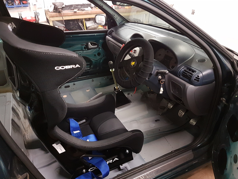

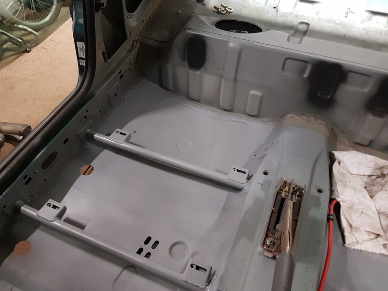

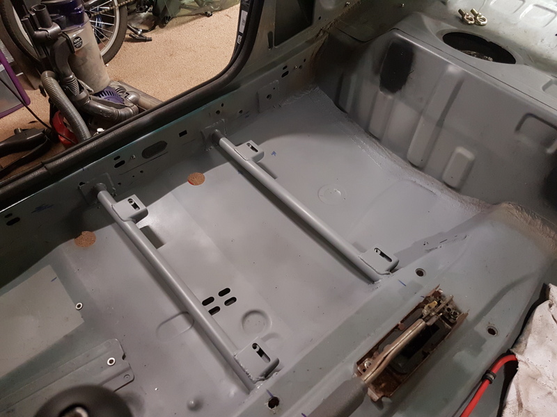

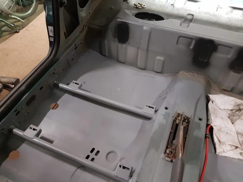

Those with weld in seat rails, have you managed to get the seat centred with the steering wheel?
Pictures of people rails and side mounts would be helpful
vroomtshh
  Seat Ibiza Cupra TDi
The seat is centred with the wheel no problem on mine. But the pedals aren't centred with the wheel and it's not the comfiest to drive for long periods.

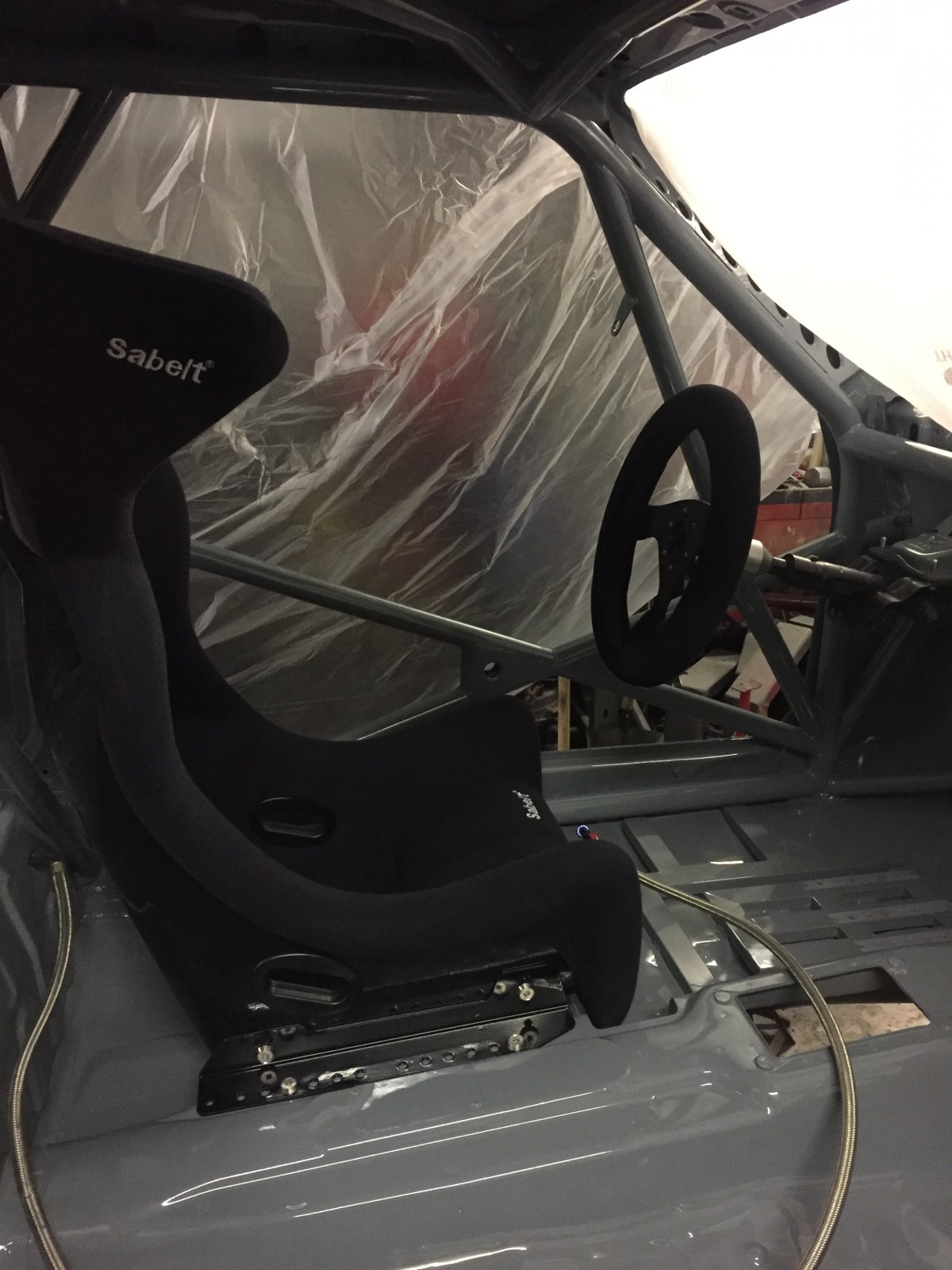

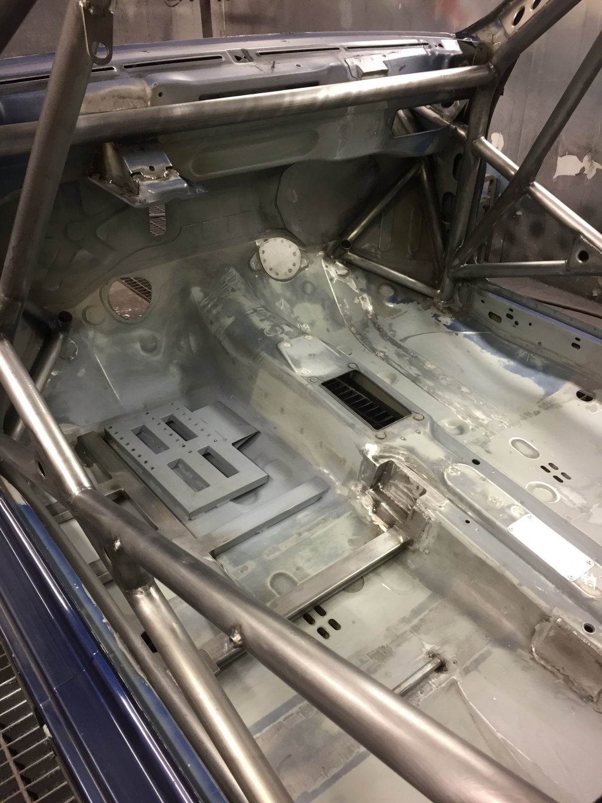

  Amg A class, M3 CSL
We cut into the tunnel to get the seat lower. Used the 2 fixings on the tunnel to mount on inside and standard seat rail on the outside on the cage.
