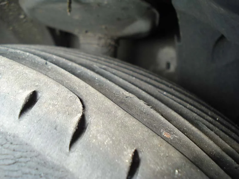

After my first stint on a race track today, I noticed that my tyres did not really look too good. The tread looks, erm, not very healthy (see picture, it looks and feels actually worse in reality). This is the front left tyre, which is the one that gets used most on that track. It had probably around 150 to 200 miles on it. Only some of those driven on the track, mostly around town and Autobahn driving. The front right doesn't look nearly as bad, but the large long tread blocks also have a sort of zigzag shape. That one had around 1800 miles on it before I used it on the track for the first time. This occurs only on the outside half of the tread, on the inside the tread blocks are more or less level and plane. Rears are just fine. Is this normal? Am I overusing my tyres? Is there something wrong with them?
Btw, these are Goodyear Eagle F1 GSD3s, in case you couldn't tell. They're the German made ones.
P.S.: On the front left tyre it's also obvious that I'm driving on large portions of the side wall aparantly. I'll try and upload a picture of the side wall tomorrow.

that's just normal wear and tear after a track day that's why i have two sets of tyres one for track and one for the road
  Clio 172 ff
That's normal? No way. I haven't seen anything like that on anybody elses car. Maybe I need to take a better picture... This can't be normal.

Mine get worse than that from just roundabouts over here too fast mate. Well, the front left does anyways.
As said above, just have seperate wheels, some for road some for track.
it 100% normal my brother has done the same damage to his ones and the michelin pilot exalto pe2 i have seen from one track day the hole side wall warn out to the point where the michelin man was completely missing .
my self personally i run toyo r888 size 205 45 r15 of track use .
  megan R26.R number 006
you may consider getting your camber set to -2 degrees of camber instead of the -1 degrees of camber that is your stranded camber setup the extra camber will help with the wear on your side walls .

looks like you didn't reduce the tyre pressure. Overheating from what it looks like.

I always thought overheating was more likely to occur when tyre pressure is too low. I had the pressure set to 32psi cold on that day. Not sure what it went up to, but it was at over 40 a few minutes after the stint. Is that too high?
Edit: Wouldn't too low tyre pressure increase the side wall flex and therefore make the wear on the side wall even worse?

you'll get sidewall wear regardless, if you're gunning it on track you'll find tyres pressures going up around 20 psi. Higher pressure = higher temp.
the tyres are meant to run at sub 45 psi iirc, reducing the psi would have taken them to around say 22 psi when cold but optimal when warm.
This is why F1 et al have tyre warmers - the tyres aren't up to the correct pressure. It's not just a grip thing ( their ride hight is too low when cold).

wear like that's going to have been affected by lots of things - eg. the tyre (are Goodyears up to the abuse? some good road tyres just aren't), the pressures, the style with which the car's been driven (power-on understeer=bad!), the harshness of the track surface (some are much harder on tyres than others), etc.
also - don't use new tyres - the tread blocks are obviously taller on a new tyre and you get much more tread squirm and can even rip the tread blocks off

Thx for your help guys. I suppose it's in fact mainly due to the tyres and my driving. I was driving rather hard and not very disciplined yesterday and did indeed have some rather high slip angles coming out of some of the turns. Also on the german Touristenfahrerforum quite a few people said the Goodyears are not good for track use.

You're talking about the 'lip' that's formed on the edge of the treadblocks giving it a slightly higher point?
I've experienced that on many of my track and road tyres when used on track.
Spoke to some tyre sprecialist at the Festival of Speed last year and he said it was nothing to worry about. He implied it was because they were being used well, and it's the surface of the tyre 'rolling-up' to the edge of the treadblock where it stays.
Over-driving wouldn't show this build up as the greater slip-angle would rip this build up off as a marble.
Looks like you're exploring your slip-angle without going beyond it and causing damage to me.

As much as I like to hear that :), I'm not convinced that this is really the case. On the picture it doesn't really look as bad as in reality. But who knows, maybe you're right. I'll have a closer look at them and maybe try to take a better picture.
