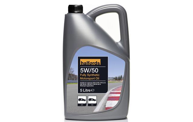

Done an oil and filter change with my 5/50 , I previously quoted 10/50 sorry beg ur pardon.
Cold start 4 bar oil pressure , happy with that

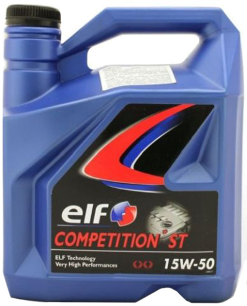

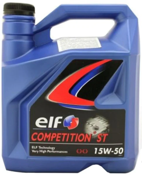

IMG_1125.JPG I use Elf 15w50 Competition ST oil in mine, its down to what purpose your using you car for, Use the same oil in my Escort and Sierra Cosworth and my Impreza type-r....
