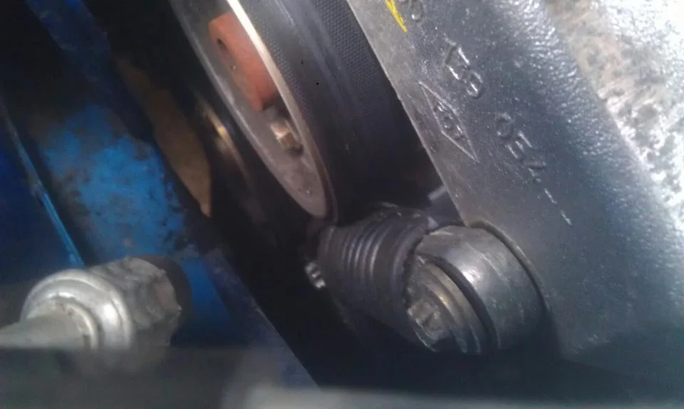

What is this? and why is it rubbing my cambelt?
Breamy
Just heard a strange noise. What is this?
Seems to be rubbing my cambelt :(
Breamy
Ah nowhere near as bad as i thought then.
Still a pain in the arse!
History says it was changed last year!
  2014 Clio 200t edc
Garage probably did te same as mine did when I bought my 182, and changed just the belt!!
Breamy
Ye strange little squeek. hense why i looked. Just need to work out how im gonna get it to the garage!
  Changes to often
i would get it recoved to a garage, wouldent risk driving it,or even starting it, the cost of a snapped cambelt dosent bare thinking about, compared to a small price to get it recoverd to a garage
  53 Clio's & counting
Definately do not drive it until it's fixed = make sure the garage changes the tensioner as well as the belt.
  Iceberg 172cup
Massive Bump... I've got same problem although my tensioner is only 4 months old and done no more than 1000 miles.. Was it your tensioner shot or something else?
